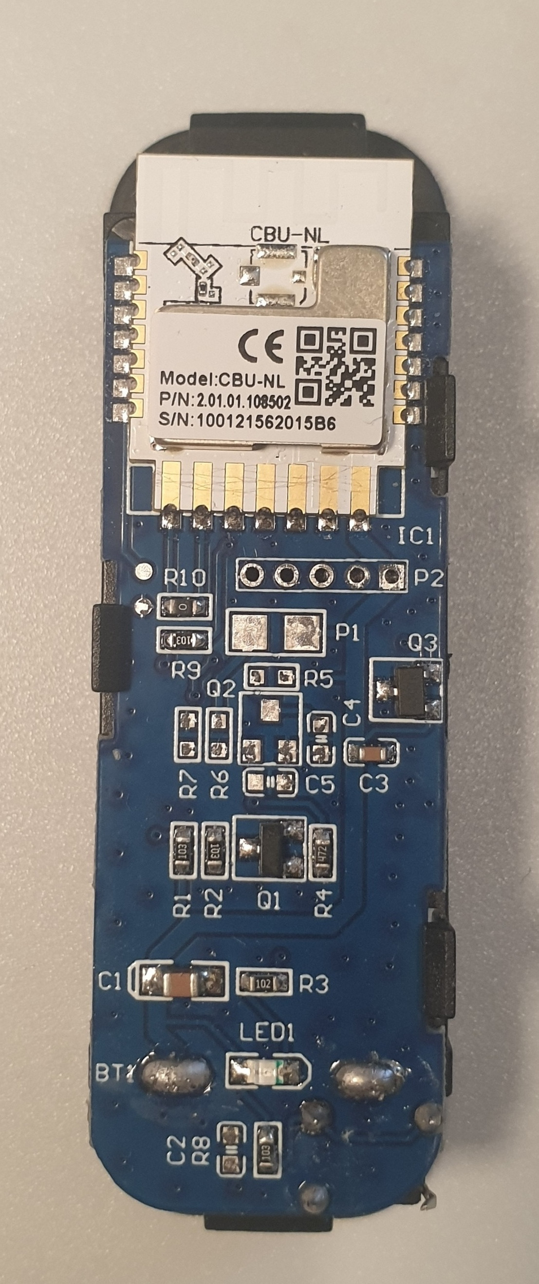

  • Configuring the 19JWT-B BK7231N door sensor for DeepSleep and Smart Life use, with custom pin mapping for this cheap variant.
  • LED uses P15, the magnetic field sensor P22, the battery relay P20, ADC P23, and the button P14 with a 10k pull-up resistor R8.
  • Firmware update works through P2 with 2 mm spacing; the header order is TX P2-5, RX P2-4, CEN P2-3, GND P2-2, VCC unused.
  • The button is not added to the config yet, and this version lacks capacitor C2.

Pins
- LED on P15
- MagnetField Sensor on P22
- Battery Relay on P20, ADC on P23
- Button on P14. Has 10k pull up resistor (R8). Plus place for capacitor C2 (but no capacitor in this cheap version)
(I didn't add Button to config yet)
Config and Battery settings
Firmware update
Close-up of a circuit board with connected wires.
Firmware update can be done via P2, no soldering needed. Step is 2mm, so normal 2.54mm pins cannot be soldered. But 2.54mm wires are good for firmware update.
Pins from left to right:
- TX (orange) - P2-5
- RX (yellow) - P2-4
- CEN (grey) - P2-3
- GND (green) - P2-2
- VCC (not used) - P2-1

p.kaczmarek2 12 Jan 2024 22:25
The configuration seems to be missing a button. Do you know which pin is used for button? This can be handy for emergency wakeup feature that we plan to add soon. [Read more]
CMY 12 Jan 2024 22:46
I was sure that button is Reset Button and wired to some CEN or reset. But you are right: Button on P14. Has 10k pull up resistor (R8) I can't check config because my unit was burned by accident. [Read more]

ferbulous 09 May 2024 07:57
Hi, how is the battery life so far? And how quick does it update the open/close status I have a similar one like this but i haven’t flash it yet [Read more]
levsha 26 Jan 2025 22:42
I have this device configured. Everything works well with HomeAssistant. Except one problem: it doesn't turn off WiFi, so it drains a battery just within couple of days. I guess I missed something. Sorry,... [Read more]
p.kaczmarek2 27 Jan 2025 05:43
Do you when DoorSensorWithDeep sleep driver shown as running on your main device page? [Read more]
levsha 27 Jan 2025 08:49
Nope: "0 drivers active". My understanding it should have started automatically? Oh, also "incomplete boots: 1" - could that be the hint of the problem? https://obrazki.elektroda.pl/8427425900_... [Read more]
p.kaczmarek2 27 Jan 2025 10:41
Maybe you have disabled "Autostart drivers" flag. You can also start driver manually in short startup command or via autoexec.bat [Read more]
levsha 27 Jan 2025 17:02
Looks like it, "Autostart drivers" flag was somehow set. I don't remember setting it explicitly. It was probably set because I was trying various configs. So I've reset the sensor to initial settings... [Read more]
