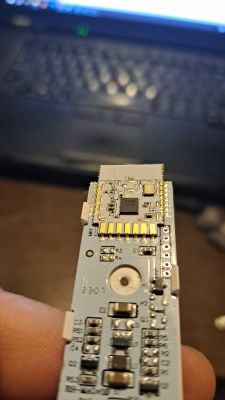

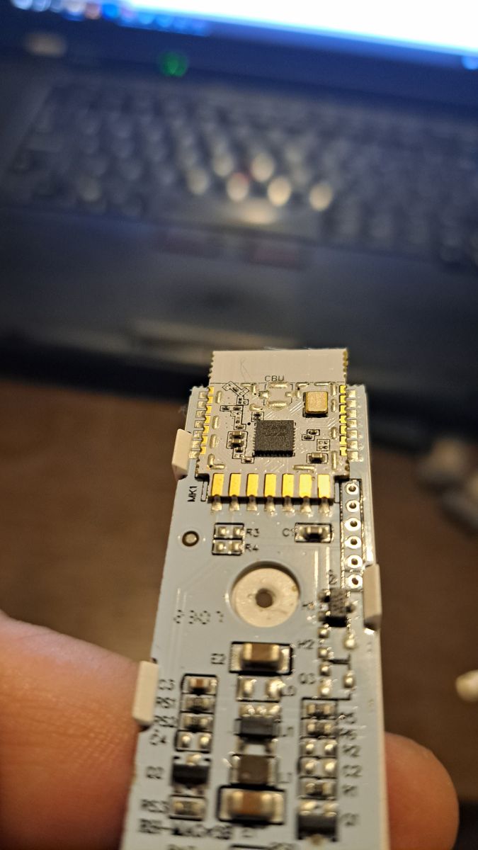

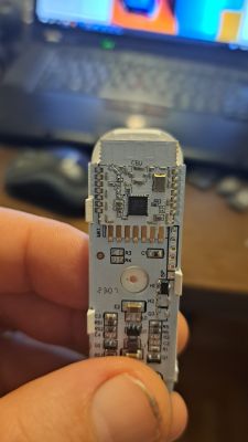

    Hi there,
    first and most important: thank you VERY MUCH for all your work you did! :)
    Then I have a question concerning this
    https://www.aliexpress.com/item/1005004699218...o.order_list.order_list_main.5.48335c5fWLFsjO

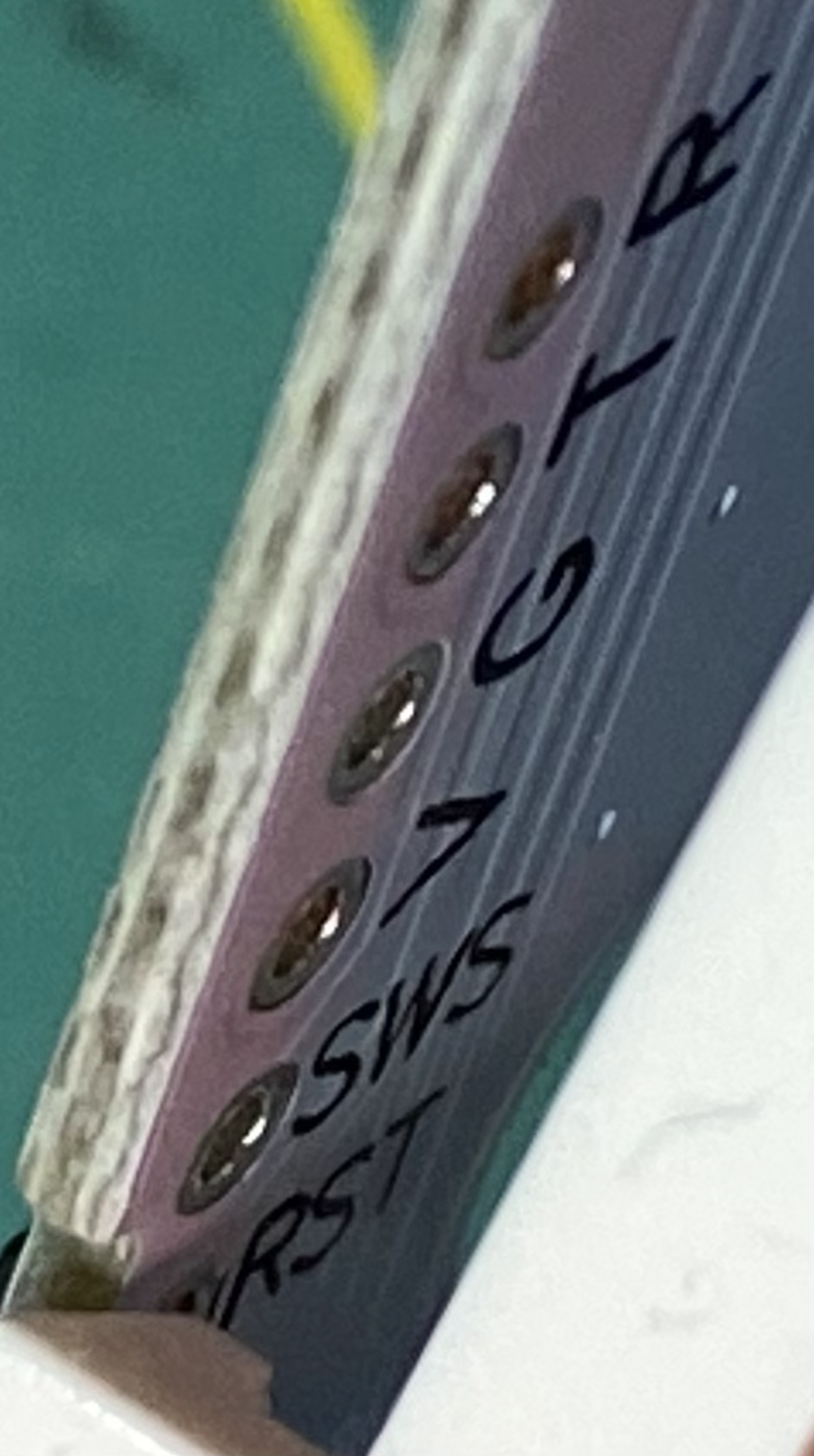

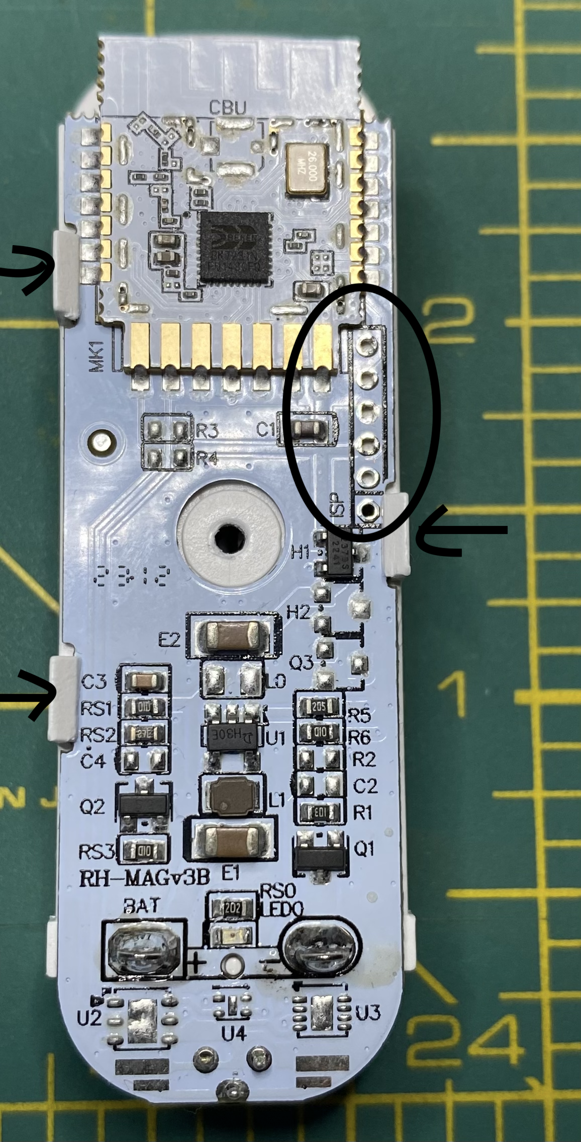

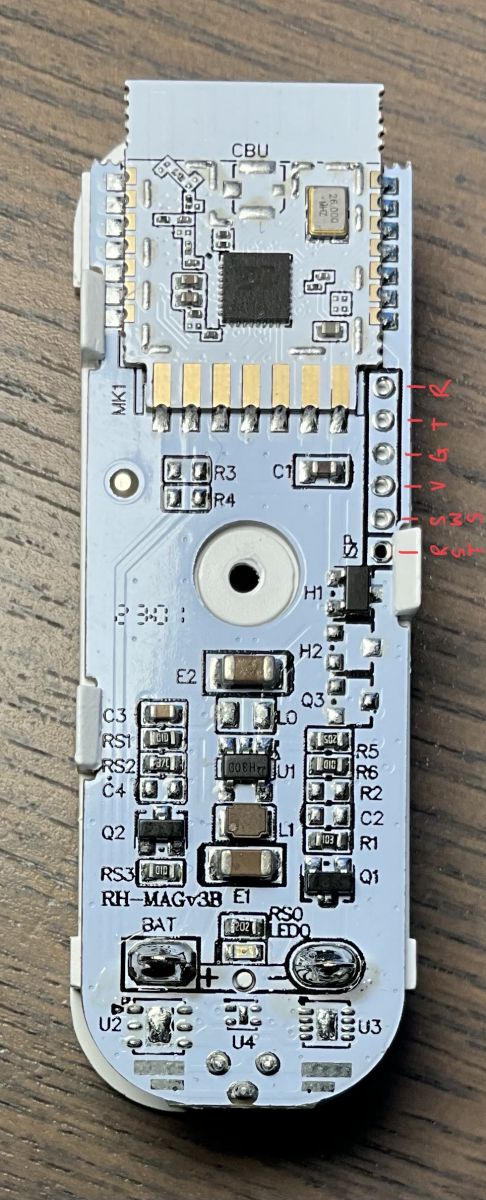

    TUYA door and window sensor. It comes with a BK7231N (pic1) soldered onto a board like this (pic2). Now, as you can see, I can't easily access the backside with RX and TX as you did. And as I plan to use 22 such sensors all around the house, desoldering and resoldering each one would take me YEARS as I am a really newbie - willing but with not much soldering experience.

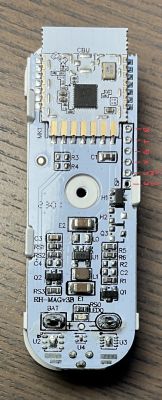

    Now I hope you either have any other idea how to access the BK´s RX/TX PiNs .... ooooor maybe the shown contacts on the right side of the board (pic2) could be helpful? They are (marked in red) on the downside marked (as you can see on the pic)
    RST, SWS, V, G, T, R
    Any idea if maybe the BK´s RX / TX are directed to any of these?
    Your help would be really appreciated!
    Gramais

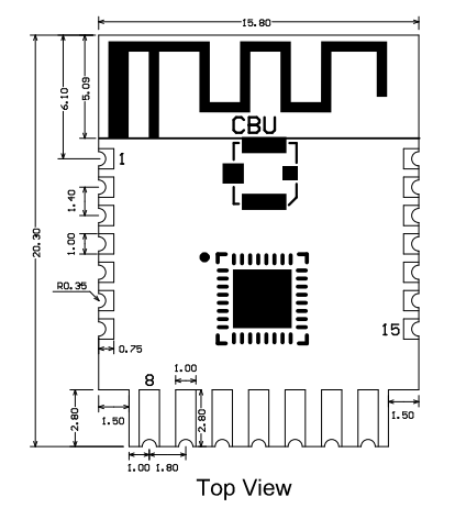

  • CBU pinout shows UART1 and UART2 connections
    #2 20486243
    Posts: 14767
    Rate: 12908
    Hello, I will try to help you... hmm... why do you think this device is problematic?
    It's not WB2L/WB2L_M1/CB2L.. it's CBU. It's very easy to flash.
    [BK7231N/CBU] Door sensor without TuyaMCU - how to connect to UART RX/TX
    Pin numberSymbolI/O typeFunction
    1P14I/OCommon GPIO, which can be reused as SPI_SCK (Correspond to Pin 11 of the IC)
    2P16I/OCommon GPIO, which can be reused as SPI_MOSI (Correspond to Pin 12 of the IC)
    3P20I/OCommon GPIO (Correspond to Pin 20 of the IC)
    4P22I/OCommon GPIO (Correspond to Pin 18 of the IC)
    5ADCI/OADC, which corresponds to P23 on the internal IC (Correspond to Pin 17 of the IC)
    6RX2I/OUART_RX2, which corresponds to P1 on the internal IC. (Correspond to Pin 28 of the IC)
    7TX2I/OUART_TX2, which is used for outputting logs and corresponds to P0 of the internal IC (Correspond to Pin 29 of the IC)
    8P8I/OSupport hardware PWM (Correspond to Pin 24 of the IC)
    9P7I/OSupport hardware PWM (Correspond to Pin 23 of the IC)
    10P6I/OSupport hardware PWM (Correspond to Pin 22 of the IC)
    11P26I/OSupport hardware PWM (Correspond to Pin 15 of the IC)
    12P24I/OSupport hardware PWM (Correspond to Pin 16 of the IC)
    13GNDPPower supply reference ground
    143V3PPower supply 3V3
    15TX1I/OUART_TX1, which is used for transmitting user data and corresponds to Pin 27 of the IC. For the MCU solution, please refer to CBx Module.
    16RX1I/OUART_RX1, which is used for receiving user data and corresponds to Pin 26 of the IC. For the MCU solution, please refer to CBx Module.
    17P28I/OCommon GPIO (Correspond to Pin 10 of the IC)
    18CENI/OReset pin, low active (internally pulled high), compatible with other modules (Correspond to Pin 21 of the IC)
    19P9I/OCommon GPIO (Correspond to Pin 25 of the IC)
    20P17I/OCommon GPIO, which can be reused as SPI_MISO (Correspond to Pin 14 of the IC)
    21P15I/OCommon GPIO, which can be reused as SPI_CS (Correspond to Pin 13 of the IC)
    Test pointCSNI/OMode selection pin. If it is connected to the ground before being powered on, enter the firmware test mode. If it is not connected or connected to VCC before being powered on, enter the firmware application mode. Correspond to Pin 19 on the internal IC.
    As you can see, TX1 and RX1 are easily accessible.
    By the way, please check where the mentioned pads for goldpins connect, and post information here. It might be useful for some people, but I'd already try guessing that R stands for RX and T for TX. Then G is Ground, V is Voltage...
    Then you can most likely configure it like here:

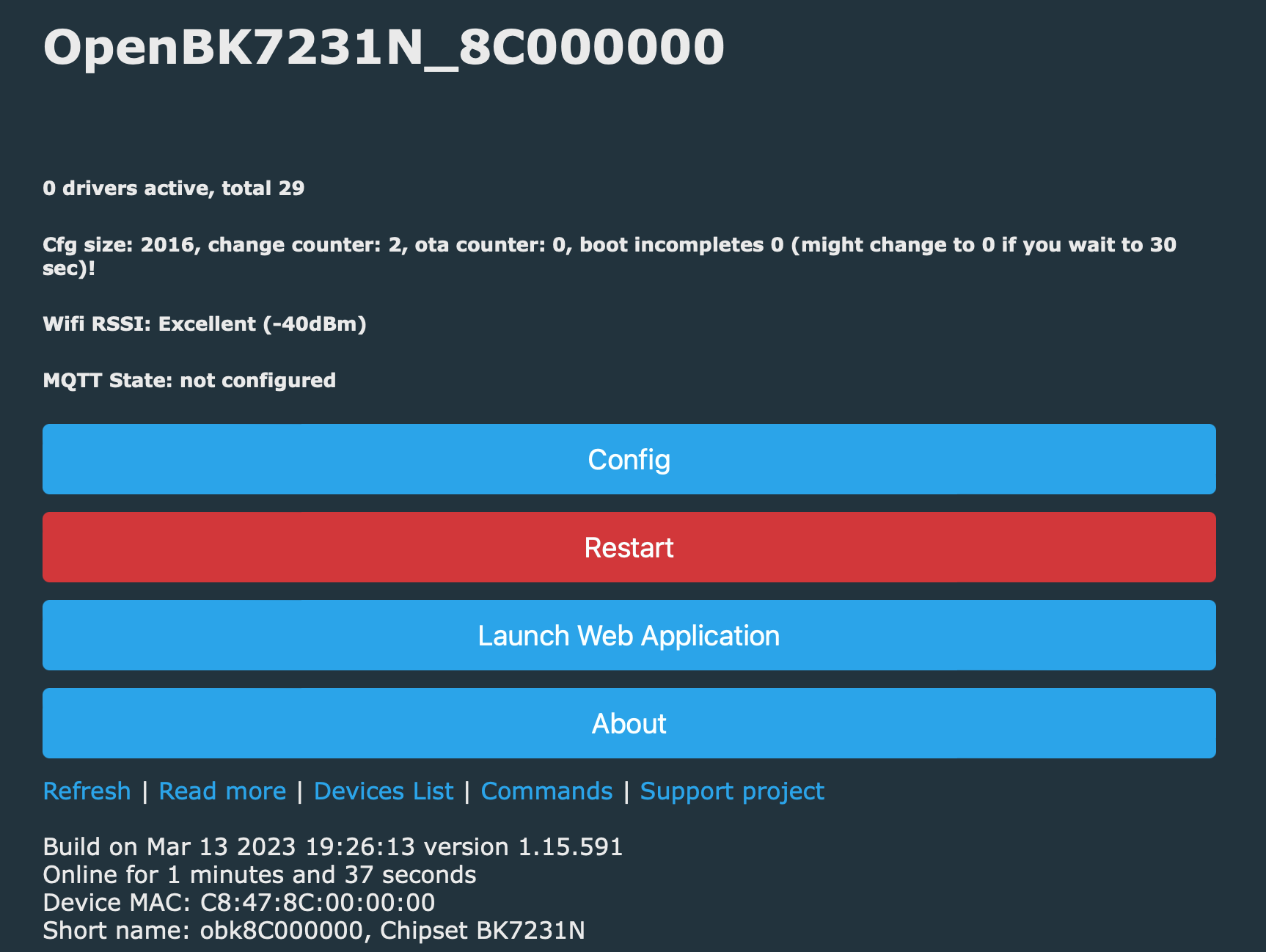

    Take a look at this:
    Welcome to the world Newby-Born-OpenBEKEN!
    So YES - YIPPPEEE, it worked! :)
    Followed this post...
    https://www.elektroda.com/rtvforum/topic3874289-180.html#20252165
    ... in which there was described a similar situation:
    - reading (backup) possible
    - baudrate issues same
    - writing not possible
    ALL as described above and in that post.
    Aaaand this post even became identical as I read he used a MacBook Pro (as me). So the ONLY thing I changed was connecting the USB-UART-Dongle to my RASPBPI. Result:
    user@raspberrypi:~/hid_download_py $ python3 uartprogram OpenBK7231N.bin -u -d /dev/ttyUSB0 -w -s 0x0 -b 460800
    UartDownloader....
    programm....
    Write Successful: |##################################################|[ 9.14k/s]
    So this similarity is surely no conincidtance and clearly a macOS issue. At least users should be warned or GitHub code should be updated. If I can help to finde out the reason: let me know what I can do!

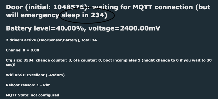

    Okay, tried to set it up as described:
    P24 (PWM4) Btn => 1
    P26 (PWM5) DoorSensorWithDeepSleep => 0
    Saved and rebooted, but how can I check before adding to HA if it works?
    How can I check if I used the correct PINs?
    Can I see sensor state results in the web frontend?

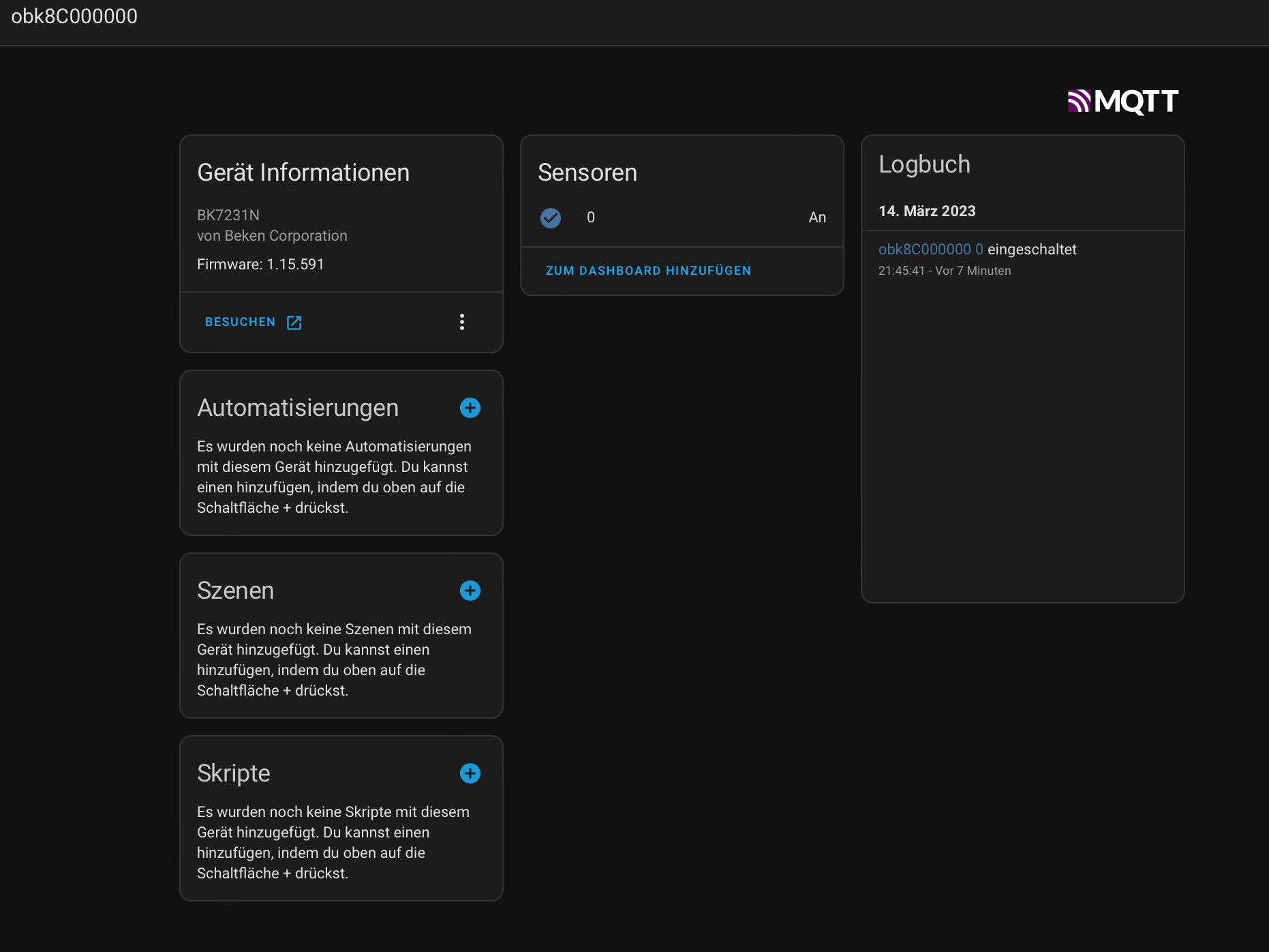

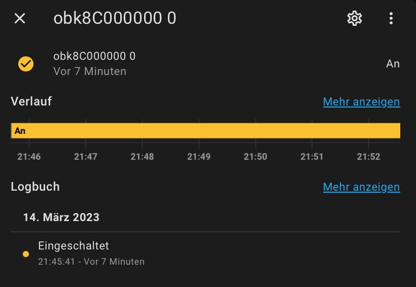

    And there is actually one issue: it loses WiFi connection. No ping or web request wakes it up....
    Needs there anything else to be configured?
    Added after 36 [minutes]:
    I am asking this because the sensor publishes a state correctly via MQTT that is displayed in HA but does not change: so I suppose that I have maybe chosen the wrong PINs? This suits the fact that the device falls asleep, loses WiFi connection and does not come back even if physically triggered: so there is no wake up command from a recognized sensor state change, right?
    When looking at the board picture (in my very first post) the magnetic contact sensor is marked as "H1" - is that helpful?
    Any suggestions?

    Device has to fall asleep in order to prolong battery life. Otherwise it would discharge battery in a day. While asleep, the website has to be offline, otherwise it wouldn't sleep. The only thing that can wake up correctly configured device is a button or sensor event.
    The problem seems that you have selected wrong pin for button and the sensor. Now you have to put out batteries, wait several minutes or more for capacitors to discharge, because they can still hold current, and then finally put batteries again and quickly disable DoorSensor pin and driver. Then reboot.
    Once you are sure that device is not running door sensor anymore, carefully investigate which GPIOs are really used for button and for sensor.
    You can try setting a dInput role for each pin and checking which one reacts to door magnet.
    The correctly configured device should wake up on both door sensor and button events.

    2 choice :
    - With multimeter in diode you check which pin of the hall sendor is conected to cbu
    - thru webapp, as p.k say assign each pwm pin to dinput with different channel and check wich one pass from 1 to 0 when you close or open the door :)

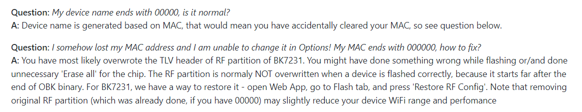

    Btw it looks like @gramais has cleared RF partition and lost MAC?
  • #17 20491673
    gramais
    Posts: 48
    Why that: why do you think I cleared RF and lost MAC?
  • #18 20491691
    Posts: 14767
    Rate: 12908
    @gramais please read our FAQ:
    https://github.com/openshwprojects/OpenBK7231T_App/blob/main/docs/faq.md
    Those two questions:

    Guys, I found the correct settings
    1. Sensory → Configure module:
    P16 DoorSnsrWSleep_nPup
    P20 Btn
    P23 BAT_ADC
    P26 WifiLED
    1. Flagi → Configure general/flags:
    X 10 [MQTT] Broadcast self state on MQTT connect
    X 35 [HASS] Deactivate avty_t flag for sensor when publishing to HASS (permit to keep value). You must restart HASS discovery for change to take effect.
    X 37 [WiFi] Quick connect to WiFi on reboot (TODO: check if it works for you and report on github)
    mqtt:
      binary_sensor:
      - unique_id: "long name sensor"
        name: "short name sensor 0"
        state_topic: "short name sensor/0/get"
        qos: 1
        payload_on: 1
        payload_off: 0
  • #25 20638508

    It already works automatically adding to HA, but it shows the reverse status. When the sensor is open it shows that it is closed, and when the sensor is closed it shows that it is open

    Can you please advise how to reduce/change sleeping time. [BK7231N/CBU] Door sensor without TuyaMCU - how to connect to UART RX/TX
  • #30 20643558
    Posts: 14767
    Rate: 12908
    Hello, do you want to reduce the emergency sleep time when there is no MQTT, or the generic sleep delay that happens when [b]MQTT is connected?
