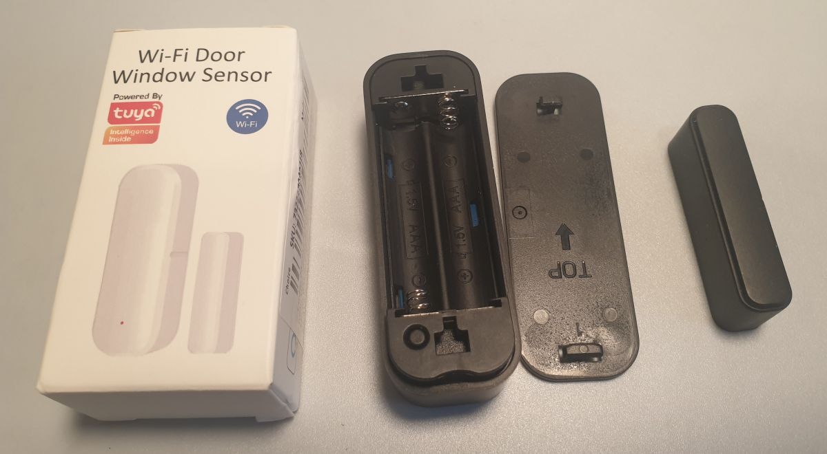

  • Configuring the 19JWT-B BK7231N door sensor for DeepSleep and Smart Life use, with custom pin mapping for this cheap variant.
  • LED uses P15, the magnetic field sensor P22, the battery relay P20, ADC P23, and the button P14 with a 10k pull-up resistor R8.
  • Firmware update works through P2 with 2 mm spacing; the header order is TX P2-5, RX P2-4, CEN P2-3, GND P2-2, VCC unused.
  • The button is not added to the config yet, and this version lacks capacitor C2.

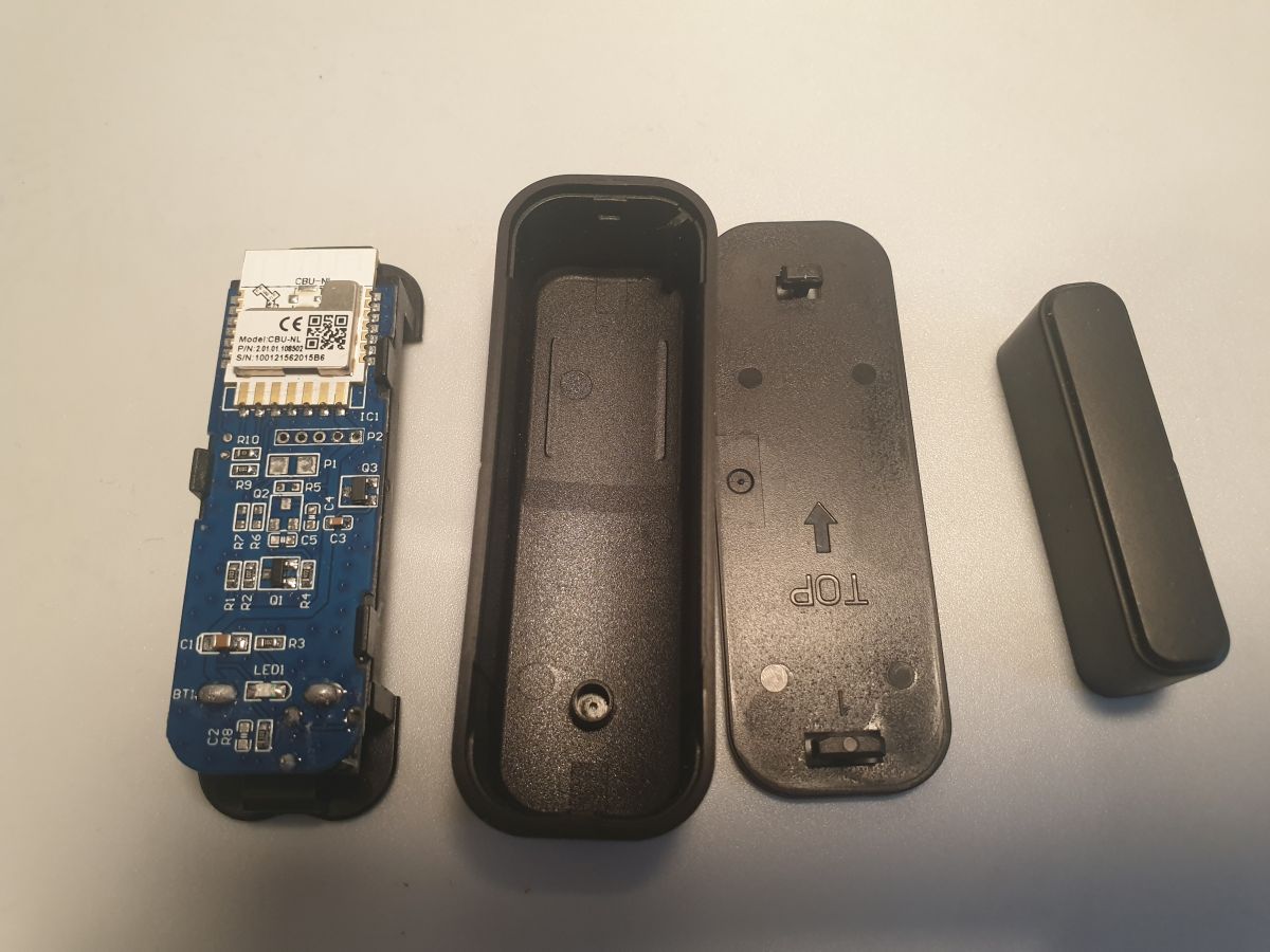

  • Electronic module on a blue circuit board with visible components and a CBU-NL model sticker.
    Tuya Wi-Fi door and window sensor with open casing showing battery compartment, and closed unit with branding on the packaging. Close-up of a door sensor circuit board with three casing elements. WiFi Smart Door Magnetic user manual with Alexa logo and specification details.

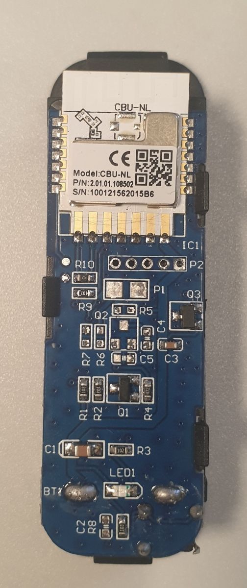

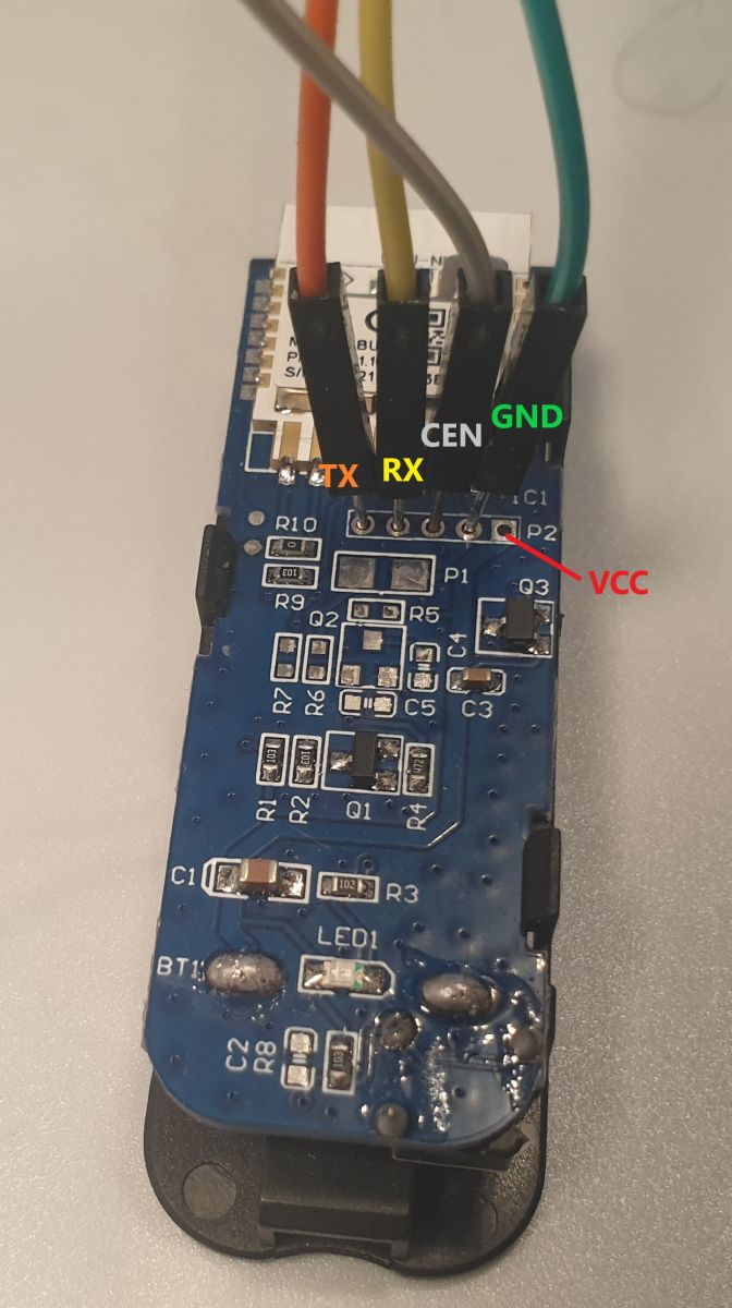

    Pins
    - LED on P15
    - MagnetField Sensor on P22
    - Battery Relay on P20, ADC on P23
    - Button on P14. Has 10k pull up resistor (R8). Plus place for capacitor C2 (but no capacitor in this cheap version)
    (I didn't add Button to config yet)
    Config and Battery settings

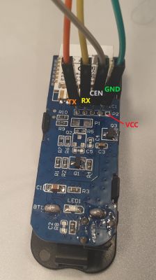

    Firmware update
    Close-up of a circuit board with connected wires.
    Firmware update can be done via P2, no soldering needed. Step is 2mm, so normal 2.54mm pins cannot be soldered. But 2.54mm wires are good for firmware update.
    Pins from left to right:
    - TX (orange) - P2-5
    - RX (yellow) - P2-4
    - CEN (grey) - P2-3
    - GND (green) - P2-2
    - VCC (not used) - P2-1

    The configuration seems to be missing a button. Do you know which pin is used for button? This can be handy for emergency wakeup feature that we plan to add soon.
  • #3 20906259
    CMY
    Posts: 6
    I was sure that button is Reset Button and wired to some CEN or reset.
    But you are right:
    I can't check config because my unit was burned by accident.

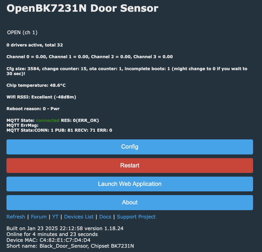

    Do you when DoorSensorWithDeep sleep driver shown as running on your main device page?
  • #11 21411993
    levsha
    Level 4  
    Nope: "0 drivers active". My understanding it should have started automatically?
    Oh, also "incomplete boots: 1" - could that be the hint of the problem?

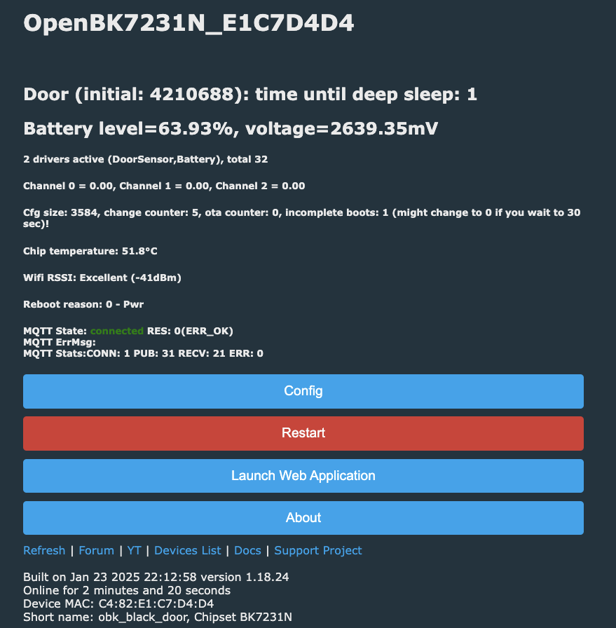

    Screen of the OpenBK7231N sensor with status information and configuration options.
  • #12 21412131
    Posts: 14637
    Help: 655
    Rate: 12649
    Maybe you have disabled "Autostart drivers" flag. You can also start driver manually in short startup command or via autoexec.bat
  • #13 21412559
    levsha
    Level 4  
    Looks like it, "Autostart drivers" flag was somehow set.
    I don't remember setting it explicitly. It was probably set because I was trying various configs. So I've reset the sensor to initial settings and reconfigured it again.
    DoorSensor started now:

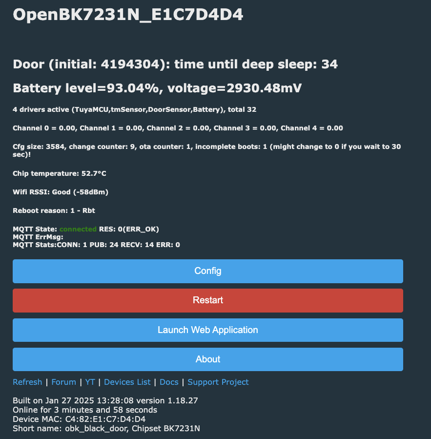

    However with this configuration the sensor never came back after it went to sleep, doesn't matter how many times I've tried to trigger open/close.
    So i've tried this configuration: https://www.elektroda.com/rtvforum/topic4026894.html#20896810 (internal board is exactly the same, just the case color is different).
    With that configuration addtionally TuyaMCU and tmSensor drivers are starting (that I guess is right for this sensor):
    Screenshot of a device interface showing status and configuration information.
    With this configuration it wakes up now.
