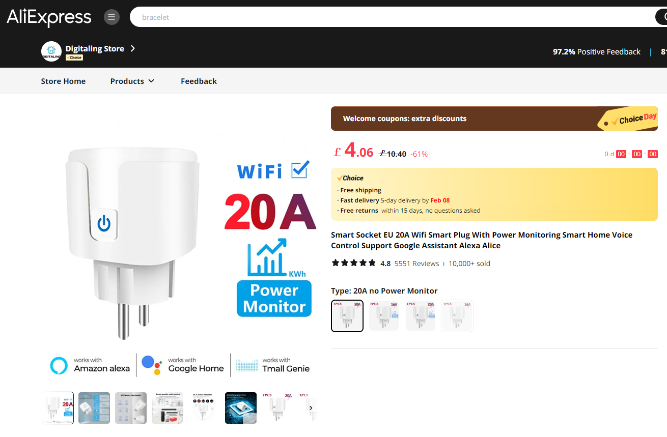

This one looked like it might be slightly different to the many variants of this device I've seen around (not one I've bought before anyway). It is from the Digitaling store on Ali Express and boasts 20A working current, though further down the page it says 16A. The relay is marked as 20A at 120v and 250v but that datasheets I can find seem to suggest 15A max. It also has a Belling BL0937 power monitoring chip.
White smart plug on AliExpress page labeled with WiFi and 20A.
This is the appearance of the unit and packaging

Why does this AliExpress smart plug claim 20A in one place and 16A in another, and how should the relay's real current rating be verified?
The listing conflicts because the product page and relay markings do not agree on one trusted current limit. The author saw 20 A in one part of the listing, 16 A lower on the page, and a relay marking that suggested 20 A at 120 V and 250 V, while a found datasheet pointed closer to 15 A max. In practice, verify the exact relay part marking on the board first, then compare it against the relay’s own datasheet rather than the store headline. [#20940181]
