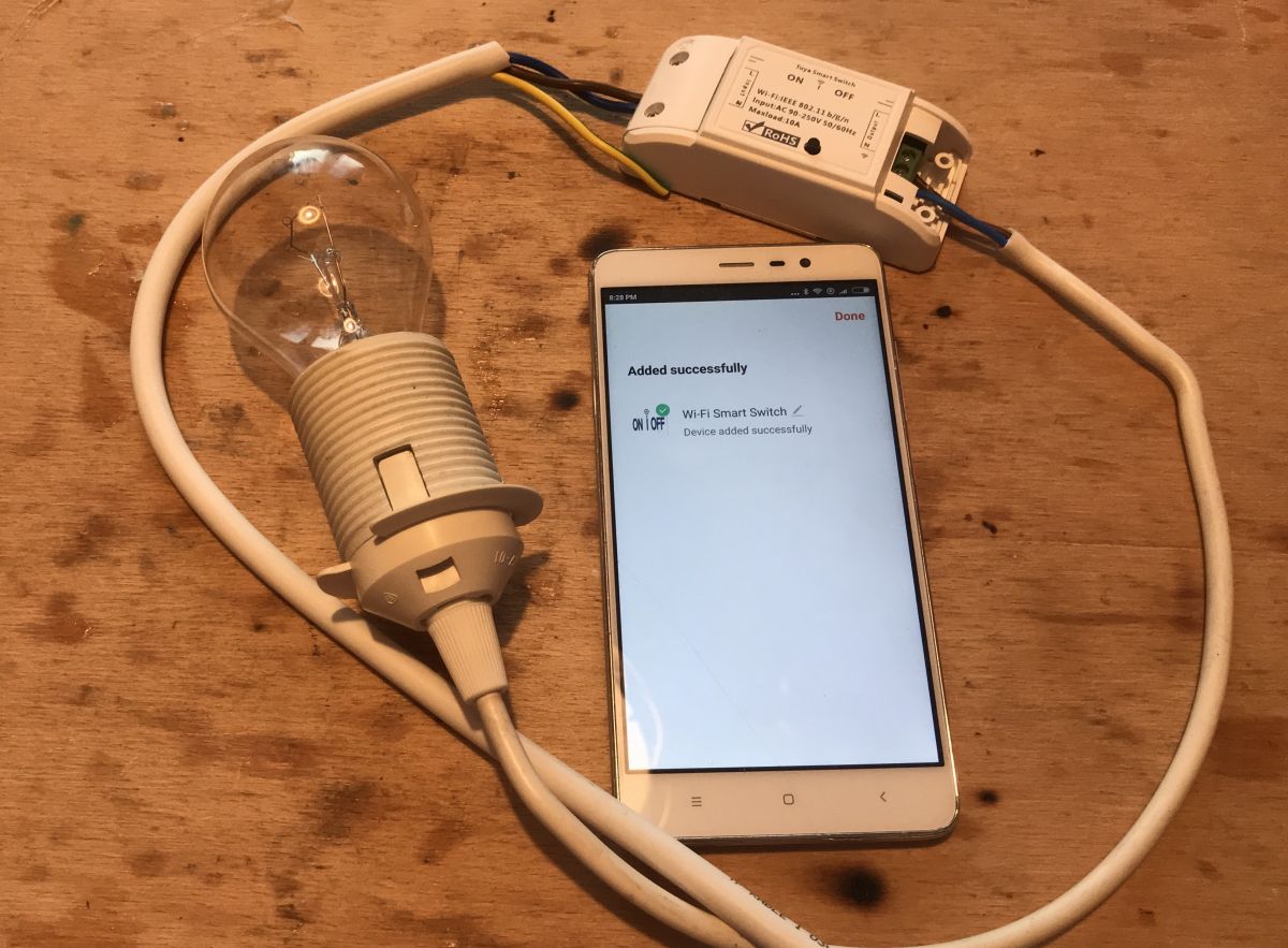

    Pairing with the Tuya application
    I've covered pairing in detail in previous topics in this series. Here, too, it went flawlessly, it was enough to put the device into the reset state (press the button for more than 5 seconds) and then via the Tuya application (after creating the account and confirming the email) select its type, enter information about our WiFi network and confirm the pairing.
    Tuya Smart WiFi relay on T102_V1.1 / RTL8710BN - test, interior, diagram
    Everything in the application is standard, you can do scenarios, automations, etc.

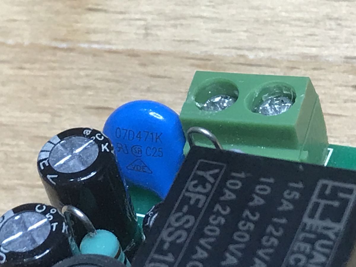

    Plate:
    Tuya Smart WiFi relay on T102_V1.1 / RTL8710BN - test, interior, diagram Tuya Smart WiFi relay on T102_V1.1 / RTL8710BN - test, interior, diagram Tuya Smart WiFi relay on T102_V1.1 / RTL8710BN - test, interior, diagram
    Varistor protecting the system against overvoltage (07D471K):

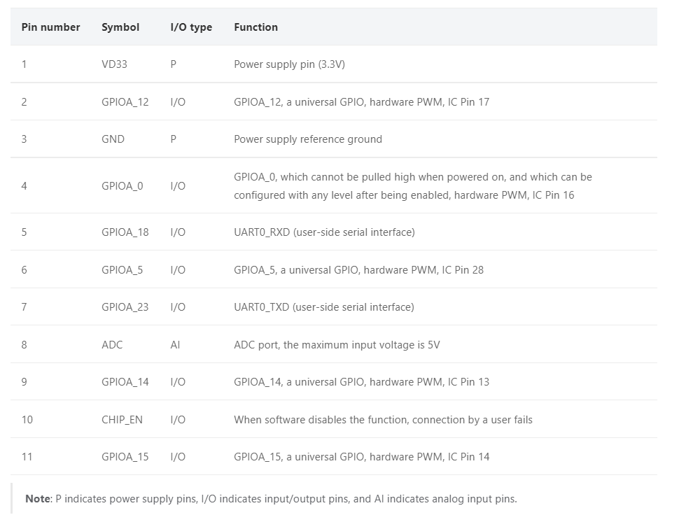

    Its parameters:
    Pinouts and roles of pins:
    There are also UART pins:

    Only this 3.3V supplies the T102_V1.1 module with RTL8710.
    Pin IO14 is connected to the transistor with the J6 code (I suspect it is S9014) through the R6 resistor limiting the base current and the R7 resistor acting as a pull down.
    The IO0 pin is just for the LED (informs about the relay status and the pairing status).
    Pin IO5 is a button with a pull up resistor R5 and surprisingly with a capacitor C8 which probably reduces the problem of contact vibration.
