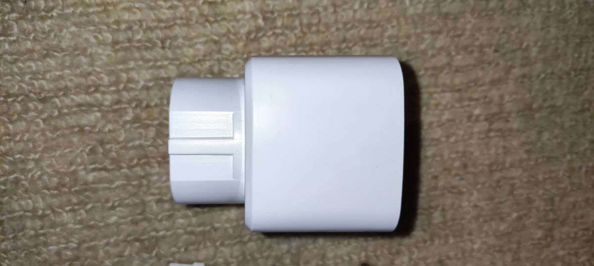

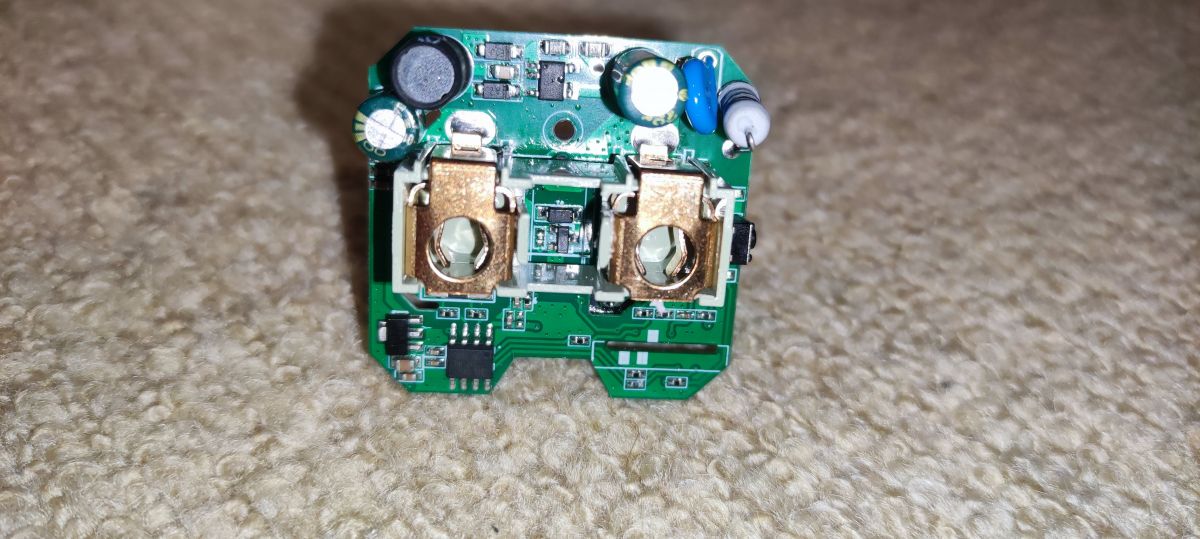

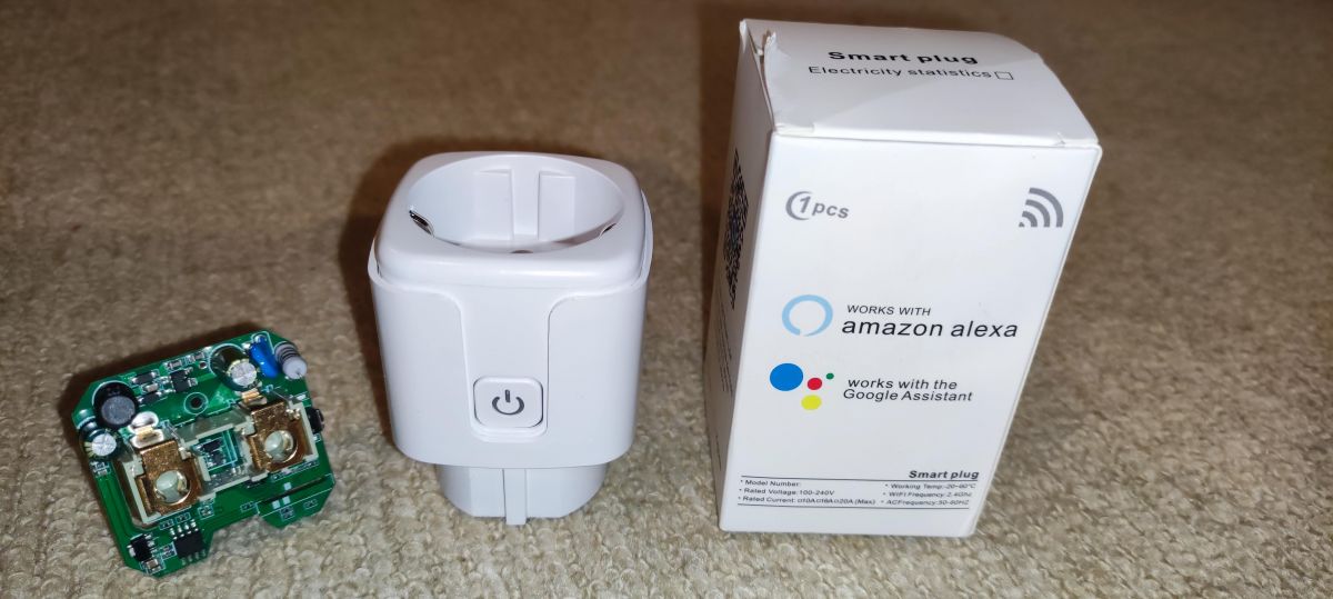

  • This one looked like it might be slightly different to the many variants of this device I've seen around (not one I've bought before anyway). It is from the Digitaling store on Ali Express and boasts 20A working current, though further down the page it says 16A. The relay is marked as 20A at 120v and 250v but that datasheets I can find seem to suggest 15A max. It also has a Belling BL0937 power monitoring chip.
    White smart plug on AliExpress page labeled with WiFi and 20A.
    This is the appearance of the unit and packaging
    Disassembled smart plug with box in the background. View of a disassembled electronic device with a visible socket and plug on a carpet. White plastic adapter on a carpet background. Smart Socket EU 20A Wi-Fi device packaging.

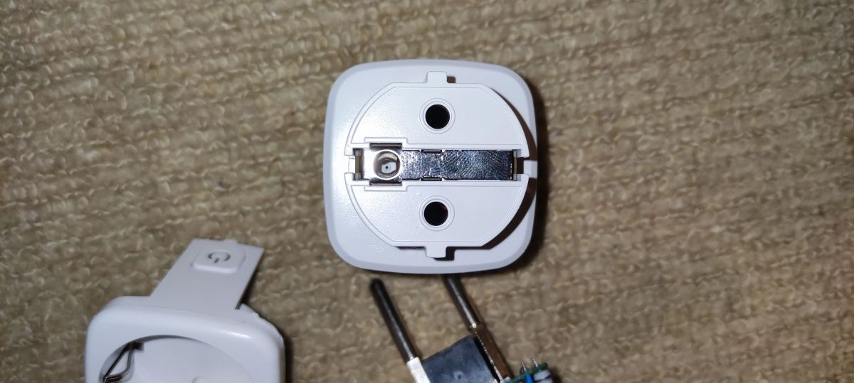

    I opened the unit with a G-clamp, moving the clamp around and tightening until I heard cracking in enough places to be confident the glue had lost the battle and the unit would fall apart. Inside is the main PCB and a nice, not-so-often seen, T102_V1.1 with RTL8710BX chip alongside an external 16mbit/2megabyte flash module from GigaDevice. Detailed information about the T102_V1.1 can be seen in this post here https://www.elektroda.com/rtvforum/topic3815120.html#19504258.

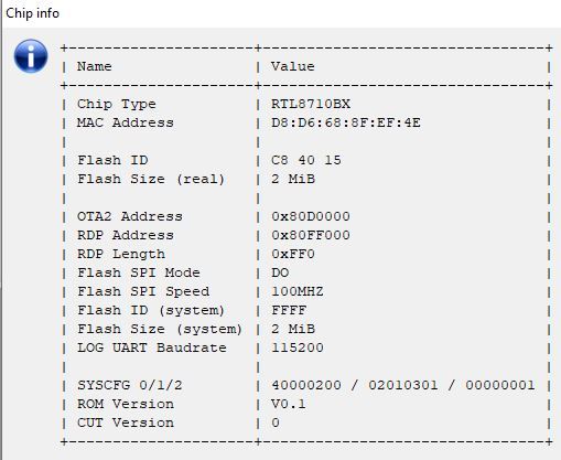

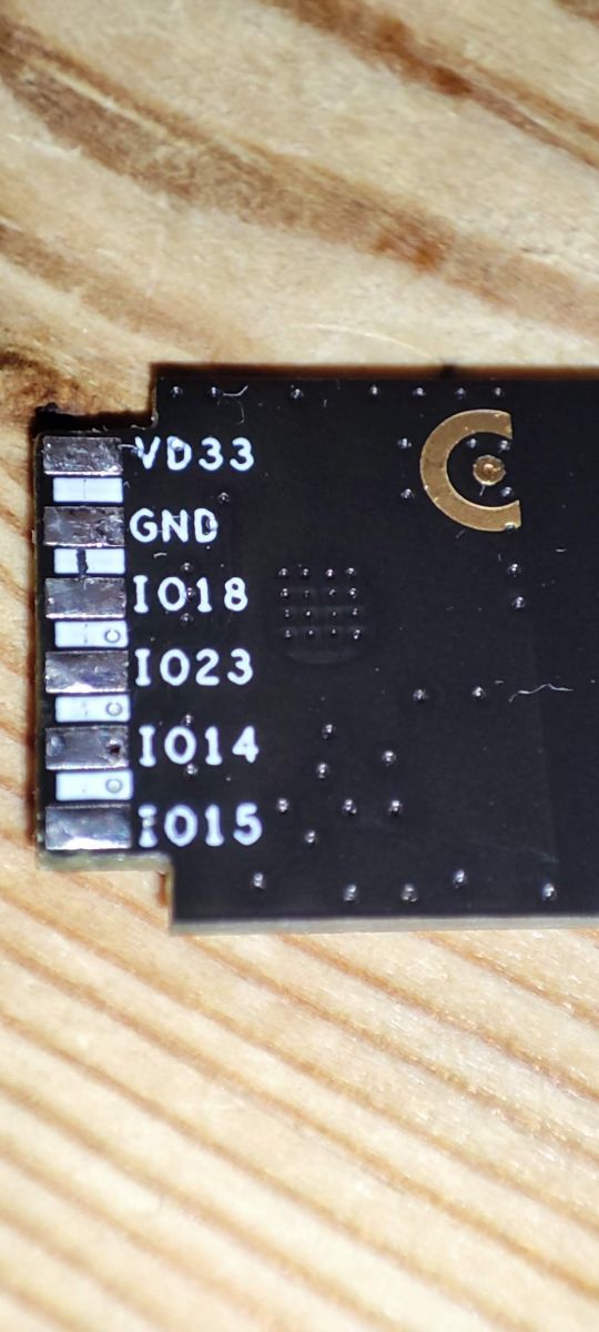

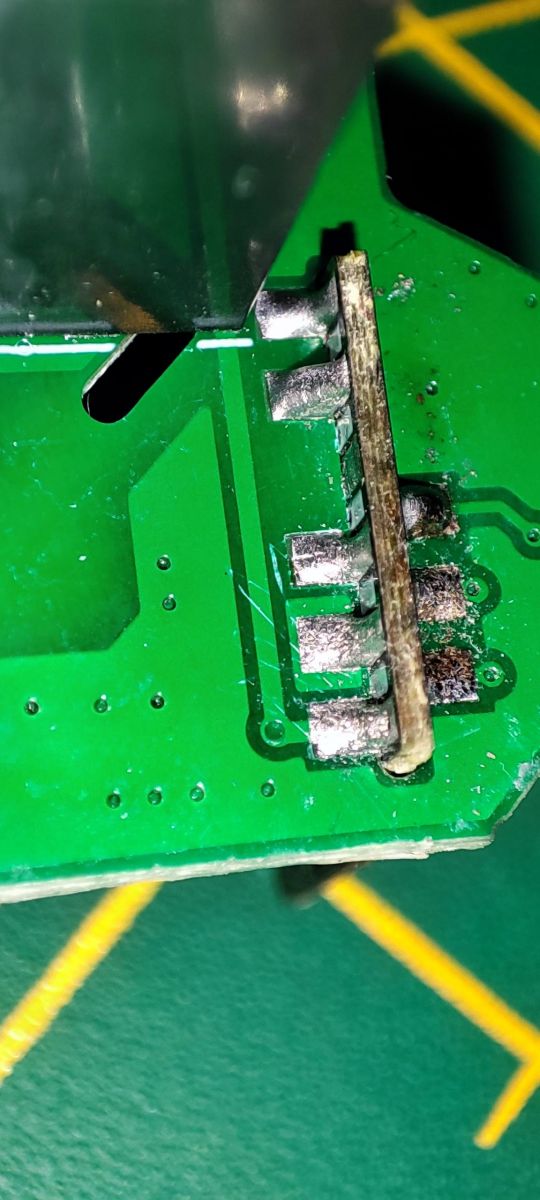

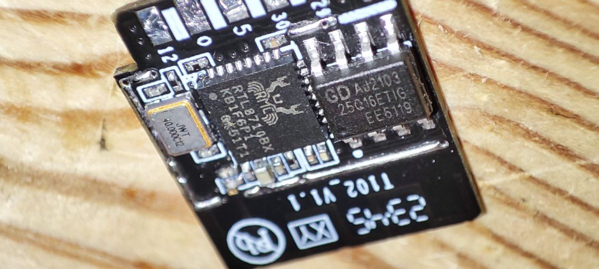

    I know OpenBeken doesn't currently support the RTL chips but I wanted to see if I could at least grab the boot log and maybe the factory firmware and make it available for analysis.
    Through some Googling I found that TX needs to pulled to ground for the chip to enter boot mode. Then remove GND from TX to be able to flash/read firmware. With that in mind I unsoldered the whole module and put it into boot mode, with TX pulled low at power-on, before removing GND from TX.
    Some chip info:
    Screenshot displaying RTL8710BX chip information
    Without TX grounded at power-on I collected the boot log

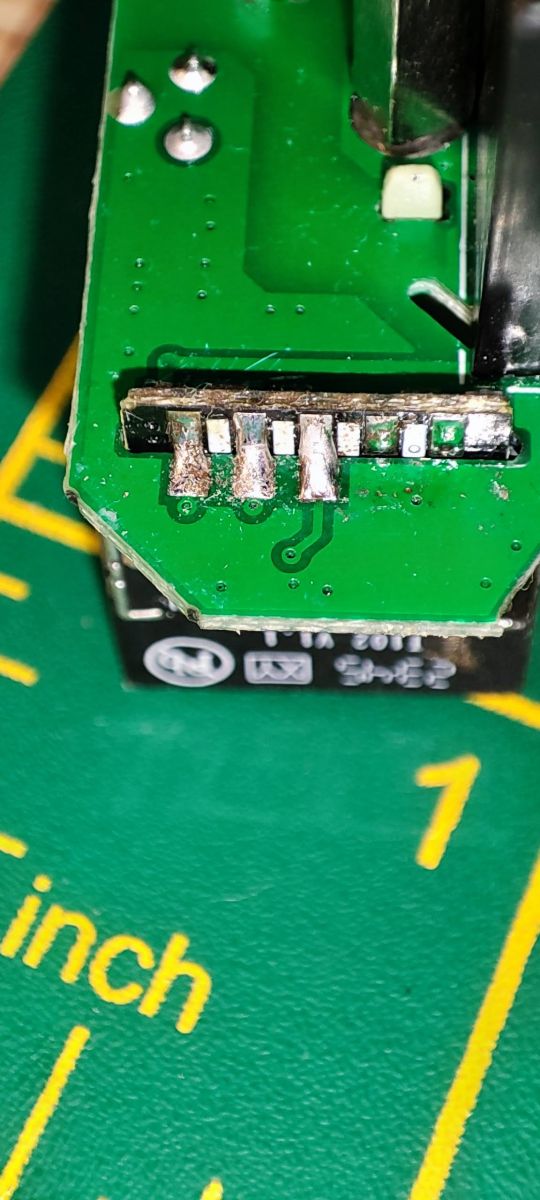

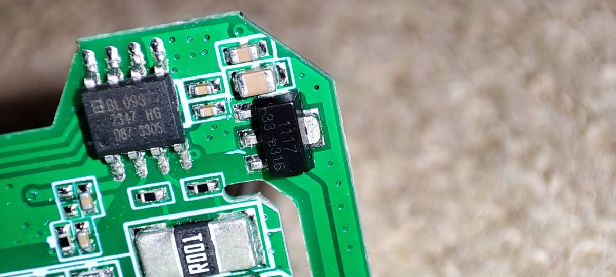

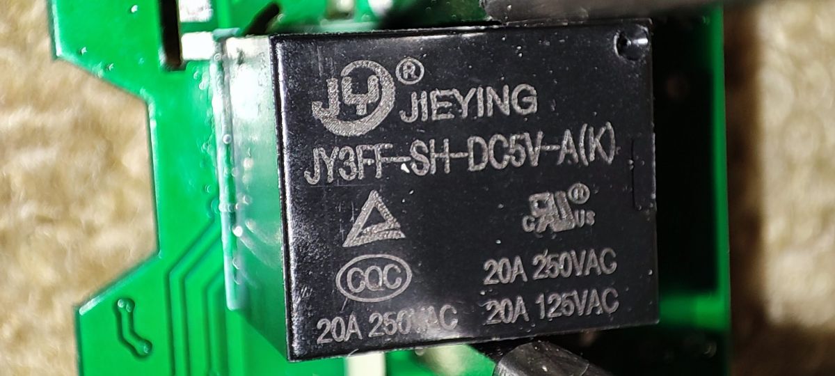

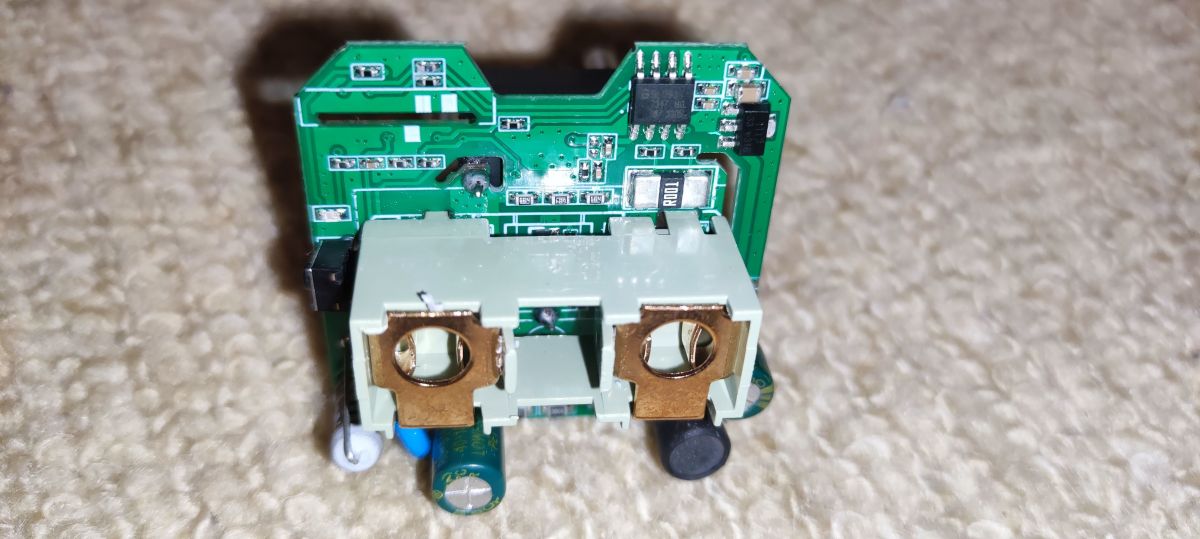

    A collection of interior pics:
    Close-up of the interior of an electronic device showing PCB elements. Close-up of a PCB with electronic components and soldered connections. Close-up of an electronic component with visible connector labels: VD33, GND, IO18, IO23, IO14, IO15. Close-up of an electronic module with RTL8710BX and GD25Q16 chips visible. Interior of a disassembled electronic device with a visible PCB and components. Photo of an open electronic device showing the PCB and components on a carpet. Internal view of a PCB with electronic components. Close-up of a PCB with integrated circuits, including BL0937. Close-up of JIEYING JY3FF-SH-DC5V-A(K) relay on a PCB. Image of the interior of an electronic device showing a connector on a PCB with labeled connection points.
    • RTL8710BX_T102_V1.1_fw.bin (2 MB) You must be logged in to download this attachment.
    • RTL8710BX_T102_V1.1_efuse.bin (256 Bytes) You must be logged in to download this attachment.

    Module swap needed for OBK or Tasmota support
    #2 20940868
    Posts: 14755
    Rate: 12878
    I am very happy to see you've got RTL! I've started already a WIP fork for BN version in the past, I just had no time to develop it futher, you can look here:
    https://github.com/openshwprojects/OpenRTL8710BN
    But I will be looking into that and BX version soon , hopefully. I've already got chips from the donators, so I just need some time...
    However, as I said, LN882H got the priority:
    [LN882H] [WL2S] Elivco 20A BSD34 EU Power Monitoring Plug [BL0937]
    For now, if you want to run OBK, you'd need to swap module, or alternatively, if you want to run Tasmota (cause it's compatible with OBK Device groups etc) you could do a swap to ESP02S.
    I'll let you know when some testing is needed.
  • WifiLED should be mapped to P1

    template updated in device list. P1 should be WifiLED because there's a second blue LED fixed to the relay behaviour for on/off status
