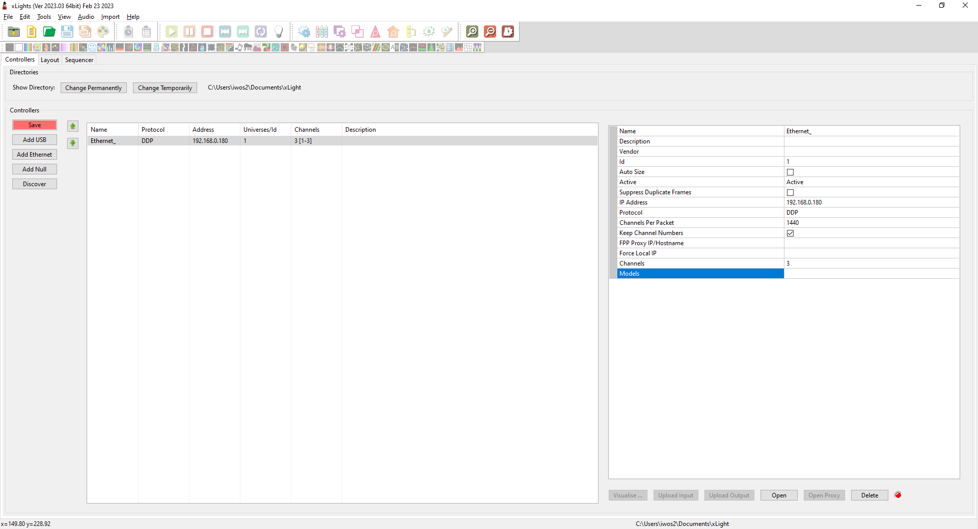

How to send DDP data? There are many tools that support DDP, and it`s just as easy to send DDP packets from your own program, but one of the more popular ways to create and manage animations is xLights : :
xLights allows you to combine independent LEDs into groups, create advanced effects, arrange them freely in 2D and 3D space and configure them on the timeline.
To send data to a device, you only need to know it IP address . In this case, it is worth using a fixed IP or IP reservation, otherwise after restarting the router our LEDs may get mixed up...

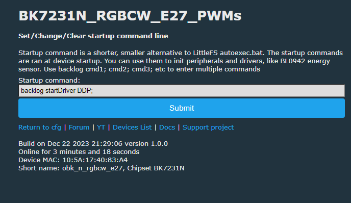

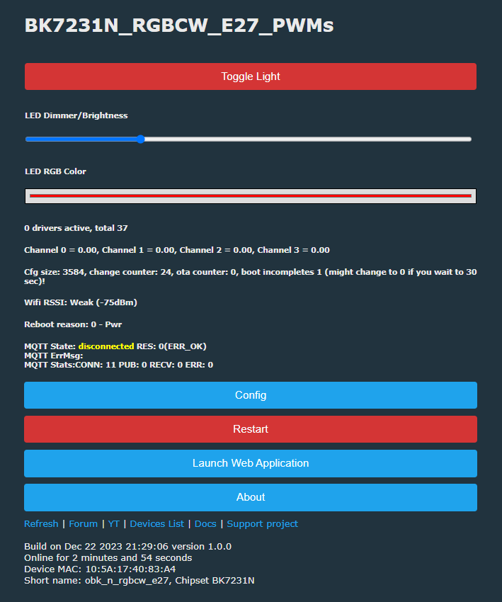

As for the device itself, I will use an LED lamp from OpenBeken:
On the side OBK turn on the driver DDP : :
It is best to enter this in the startup command so that the controller starts every time you reboot. After that, we restart the device:

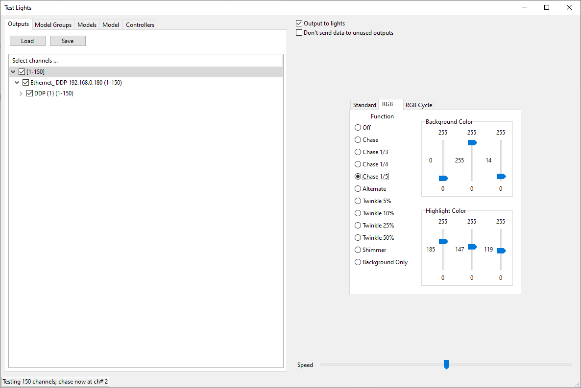

Then, on the xLights side, we open the Test options from Tools:

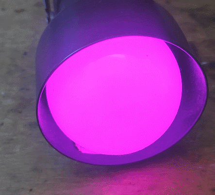

We mark the channels of our lamp and make sure on the OBK side whether the lamp is turned on.
As a result, the LED plays a test animation:
Of course, the video only shows a test animation, we can send any combinations we want from xLights, but more about that in the xLights topic.

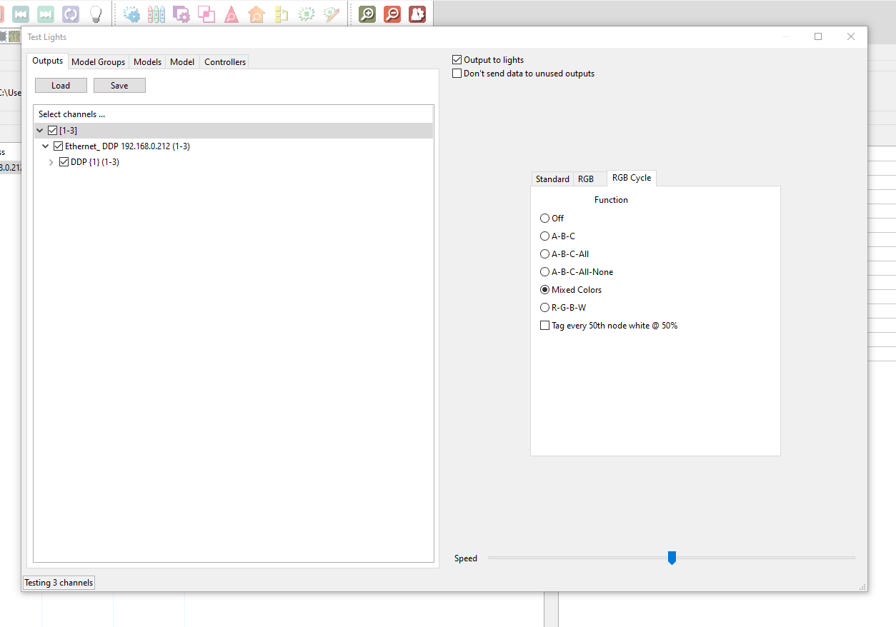

I configured the bulb in Xlights with only 3 channels RGB here is the log:
Info:DDP:Packet: 41030001000000000003FFFFFF, Length: 13 [Read more]
06 Dec 2024 09:05
Now we can do comparison. So, there is one more byte and length is one more higher.
410F0001000000000004000000FF
So, what is your OBK JSON template currently? Do you want... [Read more]

21337805[/pHiostid] Hi, I tried version 1.17.795 with Xlights and enable DDP driver, now channel 4 (W) works !!! on the standard test of the individual channels of Xlights, but if I do the test... [Read more]
It should be very easy to check this. Flash the "DDP dump again: https://github.com/openshwprojects/OpenBK7231T_App/pull/1457 And then do A-B-C-ALL cycle and copy packets data to forum. Then it will... [Read more]
when I do the RGB Cycle test by selecting A-B-C-ALL A (Red) is activated together with channel 4 which is White, so maybe this test is only for 3 RGB channels: https://obrazki.elektroda.pl/4625245700_1733923884_thumb.jpg... [Read more]
Well, if that's the content of sent packets, then there is no suprise that OBK behaves in such a way. I would rather expect the RGB test to send packet with 3, not 4 colors. You can see 04 (hex 4) in the... [Read more]
yes, I still have to study Xlights, now I just have to figure out which GU10 with DDP is best for me to buy, I would prefer something with a fairly narrow light beam [Read more]
