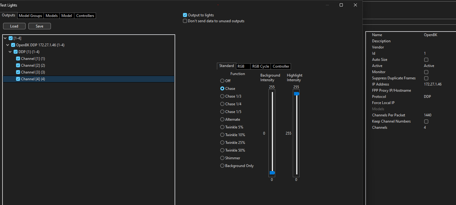

    Then, on the xLights side, we open the Test options from Tools:
    User interface of a lighting test program using DDP technology.
    We mark the channels of our lamp and make sure on the OBK side whether the lamp is turned on.
    As a result, the LED plays a test animation:

    This is the test packet log sent by Xligths setting up the 4 channel GY gu10 RGBWW bulb
    CHANNEL 1 RED is ok
    Info:DDP:Packet: 41080001000000000004FF000000, Length: 14
    CHANNEL 2 GREEN is ok
    Info:DDP:Packet: 410B000100000000000400FF0000, Length: 14
    CHANNEL 3 BLU is ok
    Info:DDP:Packet: 410D00010000000000040000FF00, Length: 14
    CHANNEL 4 WHITE the light bulb remains black
    Info:DDP:Packet: 410F0001000000000004000000FF, Length: 14
    Screenshot of a lighting test software interface showing channel configuration.

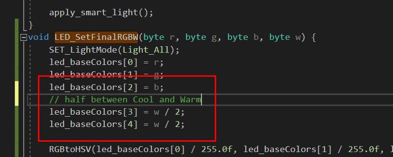

    tech1977 wrote:
    I would like it to go white around 4000k so half between WW and CW
    Hmm:
    Screenshot of source code for the LED_SetFinalRGBW function with a highlighted section calculating values for Cool White and Warm White channels.

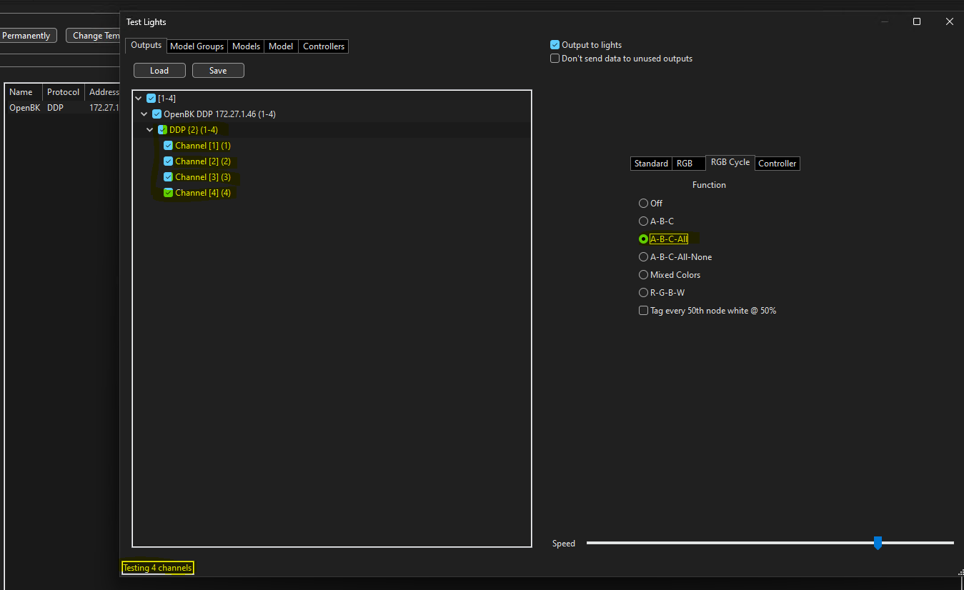

    tech1977
    Posts: 29
    Hi,
    sorry for the delay, as soon as I can I'll test it and let you know
  • #16 21343303
    tech1977
    Posts: 29
    [postid]21337805[/pHiostid]
    Hi,
    I tried version 1.17.795 with Xlights and enable DDP driver,
    now channel 4 (W) works !!! on the standard test of the individual channels of Xlights,
    but if I do the test RGB cycle A-B-C when it should display only red A lights up red together with white;
    even with the cycle A-B-C-All on A lights up red together with white, the other colors are correct;
    I am not an expert in Xlights (I am a beginner) but I do not think this is normal behavior, can someone help us with Xlights?

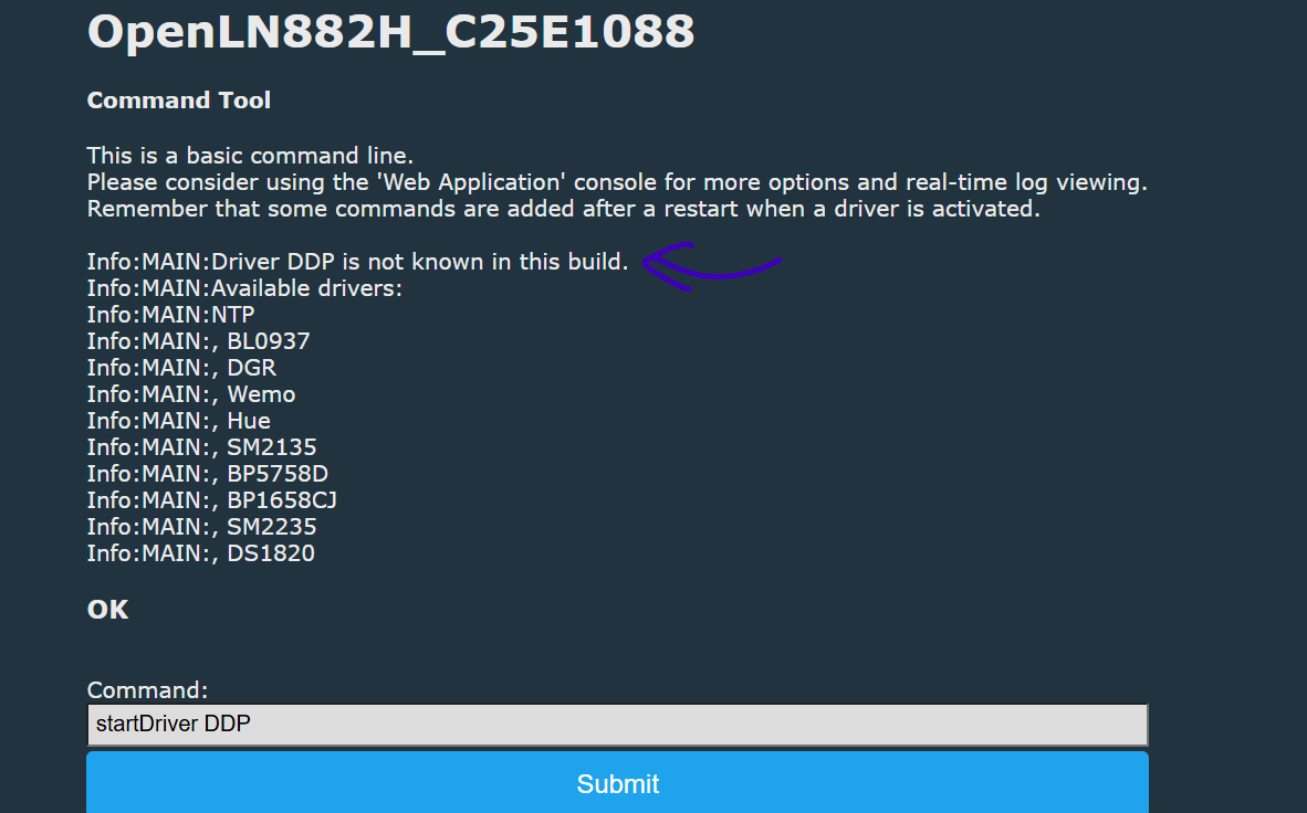

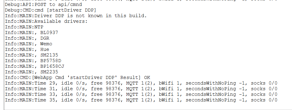

    Does the compilation under LN882H support DDP ??
    I have uploaded and despite adding the driver to the config, after a reboot DDP does not start.
    Is it possible to do something about this?
    Screenshot of the Command Tool showing a message about DDP driver not supported. .

    Please type "startDriver DDP" at the command line (not in autoexec.bat, but at runtime) and we will find out.
    If DDP is not enabled, then you need to enable DDP in obk_config.h:
    System online builds OpenBeken - firmware compilation for all platforms on Github .

    When I type in the logs I get something like this:
    View of system logs with a list of available drivers and connection status. .

    Well there is no this driver in the build. Eventually I can include the build with DDP for you....
    https://github.com/openshwprojects/OpenBK7231T_App/pull/1475
    Do you know what to do next?
    You can probably also use:
    https://github.com/openshwprojects/OBKotaTool

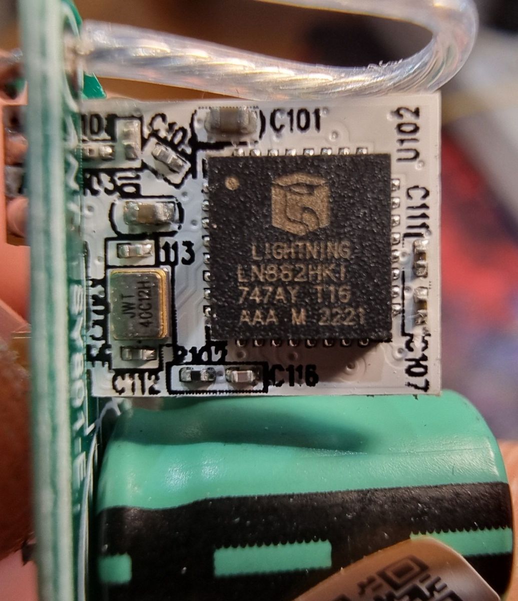

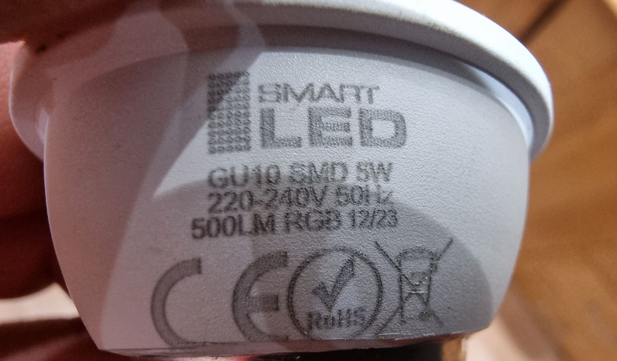

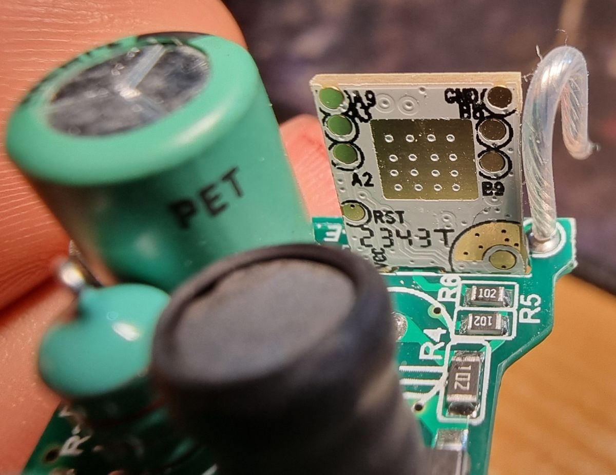

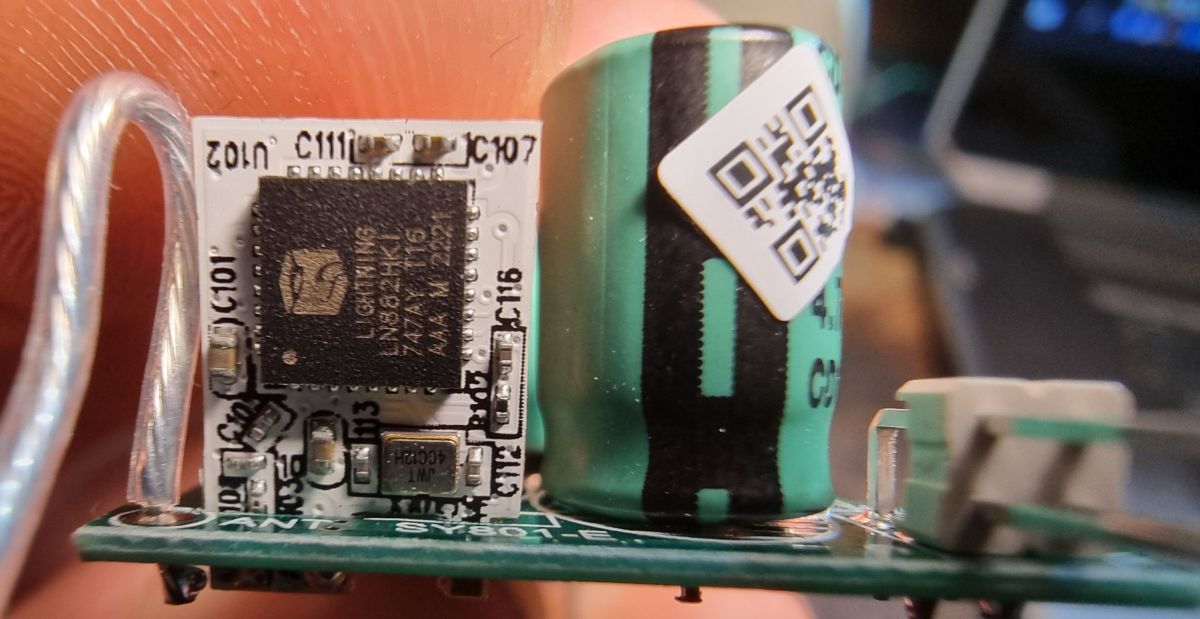

    BTW - what device do you have on the LN882H?
    #25 21358155
    mashgsm
    Posts: 236
    Help: 5
    Rate: 26
    After uploading the compilation you prepared, everything works as expected.

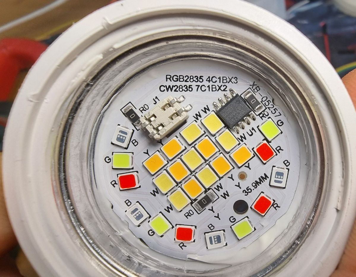

    This is a regular 5W Smart 500lm GU10 LED bulb, which always had a BK7231 sitting in it. Having recently purchased 5pc to further expand my home lighting, this new chip came along and I had no experience with it before. The board also has no name, the pins I figured out how to connect by analogy to other boards with this chip. I checked and the date on the housing on the new ones where this chip sits is; 12/23, and where BK was 09/23.
    A circuit board with a chip against a finger, showing board markings and a PET capacitor. Interior of a 5W Smart LED bulb 500lm GU10 showing the circuit board and chip. Close-up of an LED circuit board with a chip and capacitor. Close-up of a Smart LED 5W GU10 bulb with technical markings. Close-up of a circuit board with a chip labeled as Lighting LN862HK1. .

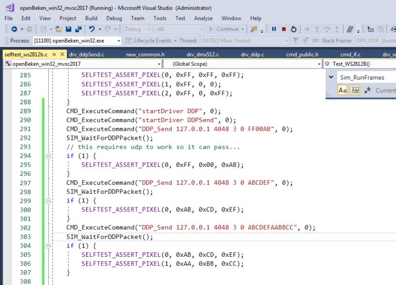

  • #29 21647952
    Posts: 14580
    Help: 654
    Rate: 12604
    I will check this soon. I'm looking into improving DDP in OBK right now. Currently, I'm adding support for DDP sending:
    Visual Studio screenshot with code testing DDP packet sending in OpenBeken project
