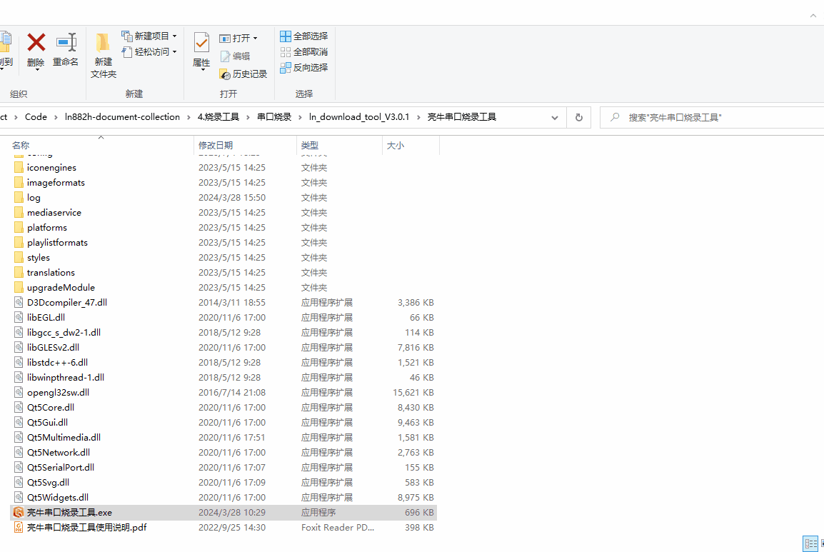

I've been looking through some of the Lightning Semi bits again recently. I saw a couple of UART flashers in the ftp/gitee dumps a couple of months ago and wondered about them again.
I've also been in contact with someone at Lightning Semiconductor who has kindly sent me the latest Windows GUI flasher for LN882H chips as well as a handy GIF and a translation of the main UI, There is no English version of the program but the steps are all pretty self-explanatory.
I know we already have a command line tool wrapped in a Python script we can use to dump/flash firmware (see the full LN flashing guide here) but it's always nice to have the option of using something with a GUI. The GUI flasher does not support dumping existing firmware, only flashing new.
I attach version 3.0.1 of the program. The older version we have is 1.0.5.
Launch and flashing GIF supplied by contact
Screenshot of the LN Download Tool folder with files and directories.
