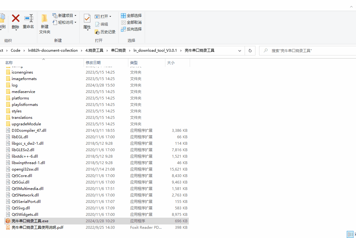

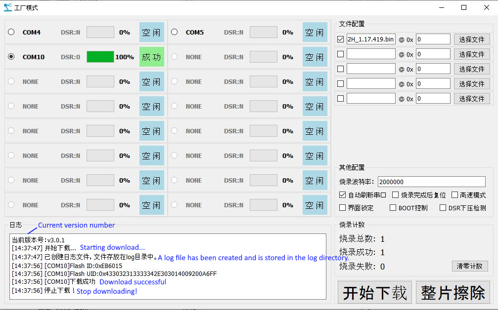

  • I've been looking through some of the Lightning Semi bits again recently. I saw a couple of UART flashers in the ftp/gitee dumps a couple of months ago and wondered about them again.

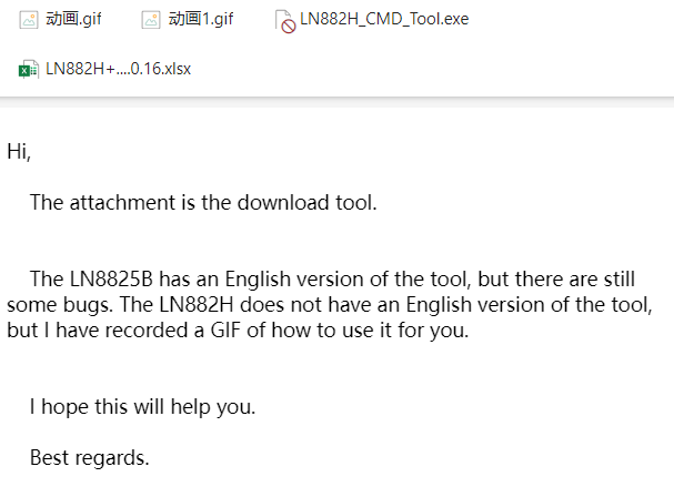

    I've also been in contact with someone at Lightning Semiconductor who has kindly sent me the latest Windows GUI flasher for LN882H chips as well as a handy GIF and a translation of the main UI, There is no English version of the program but the steps are all pretty self-explanatory.
    I know we already have a command line tool wrapped in a Python script we can use to dump/flash firmware (see the full LN flashing guide here) but it's always nice to have the option of using something with a GUI. The GUI flasher does not support dumping existing firmware, only flashing new.
    I attach version 3.0.1 of the program. The older version we have is 1.0.5.
    Launch and flashing GIF supplied by contact
    Screenshot of the LN Download Tool folder with files and directories.

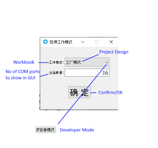

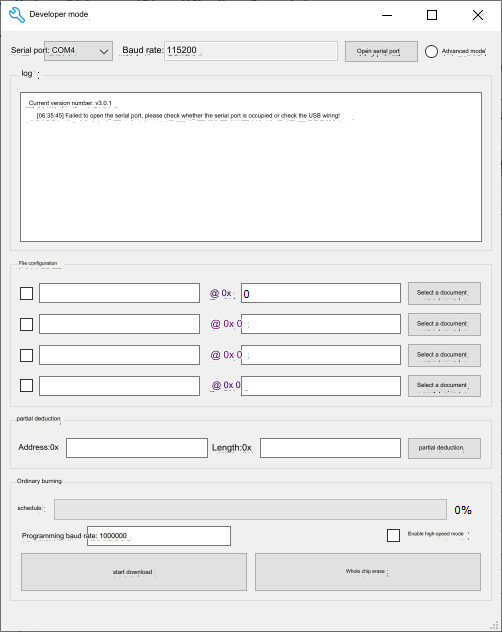

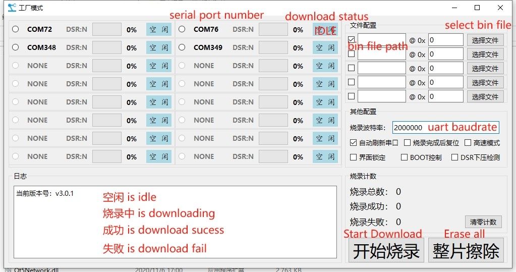

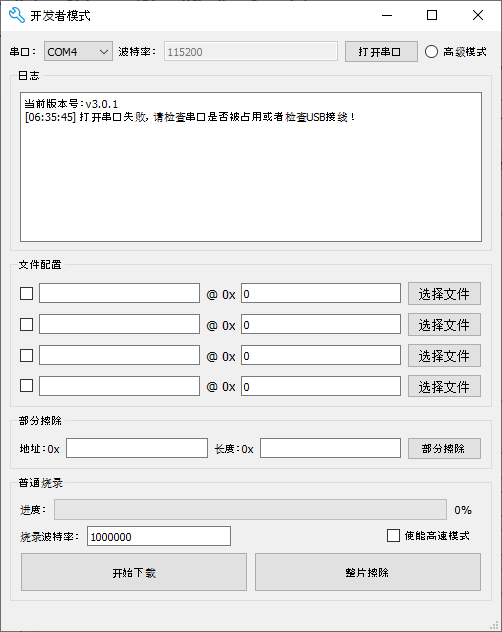

    A rough translation of the first window
    Screenshot of the main Windows GUI interface for a flashing program.
    I've not yet explored the developer mode GUI.
    Translation of main GUI supplied by contact
    Screenshot of the flasher GUI program interface version 3.0.1.

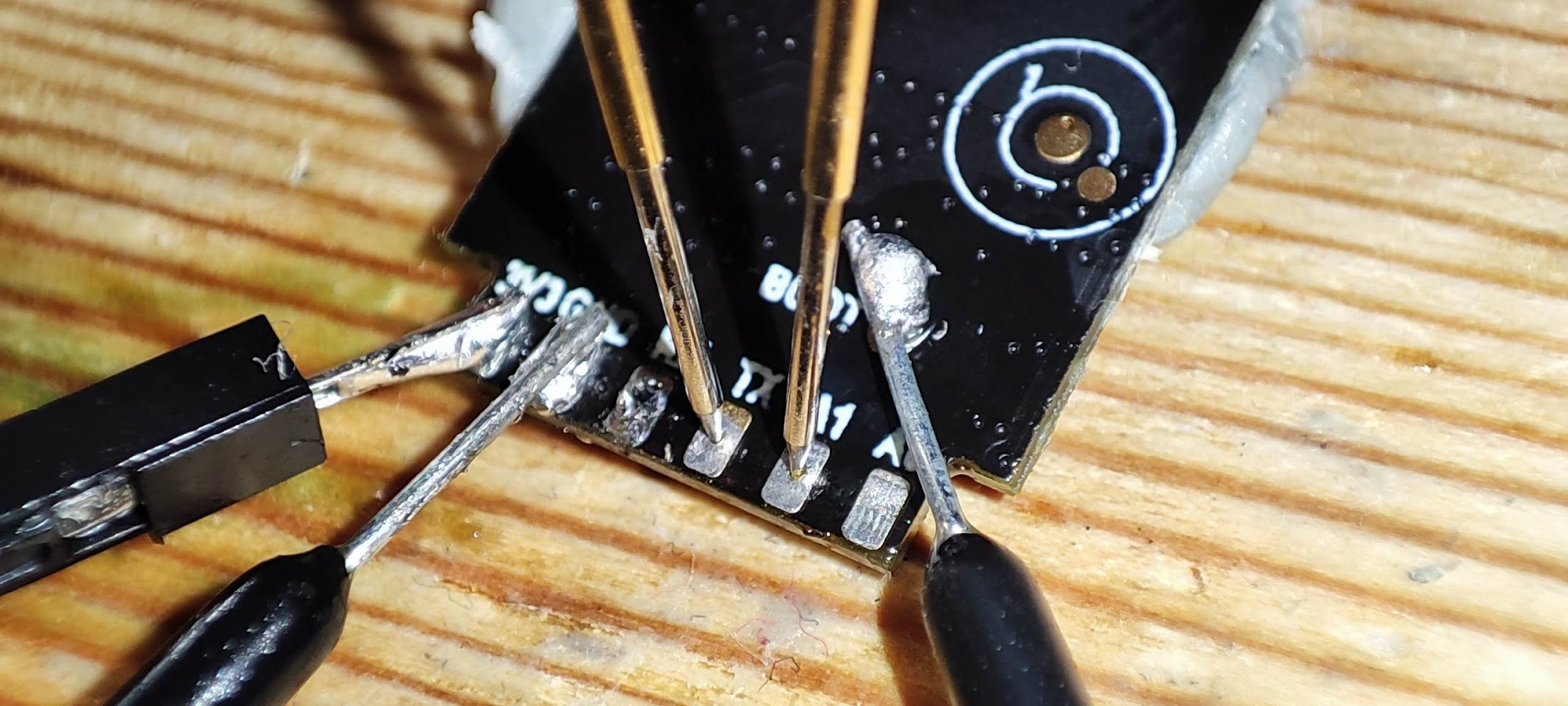

    Onto my experience. All the steps needed to put the LN chip into UART download (flashing/programming) mode still apply, which is in summary:
    My test setup with an LN-02 (LN882HKI) module
    Close-up of an LN-02 module with wires connected to the pins.
    At this point the GUI flasher can be used to download OpenBeken OpenLN UART firmware onto the device. My test was successful on first attempt. This is my completed flash with some added translations.
    Screenshot of GUI flasher software interface for Windows.

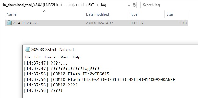

    A log file is output to \log subdir of the main program
    Screenshot of a text file log from the flashing process using In_download_tool_V3.0.1.

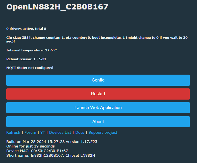

    After disconnecting the grounded BOOT/GPIOA9 pad and power cycling the module, the OBK AP started broadcasting, as expected
    Wi-Fi signal icon with the text OpenLN882H_C2B0B167.
    and
    OpenLN882H user interface showing device status.

    Screenshot of an email with attachments and content about the LN882B and LN882H download tool.

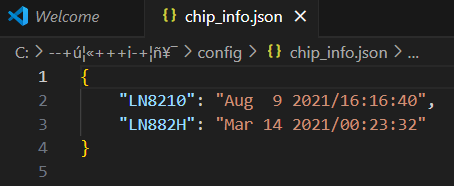

  • #7 21027497
    Posts: 5236
    Help: 449
    Rate: 918
    divadiow wrote:
    Just LN882Hxx as far as I know
    I haven't actually tried it on LN8825B. I will at the next opportunity.
    and maybe LN8210 if this file is any indicator
    Screenshot of chip_info.json file in Visual Studio Code.

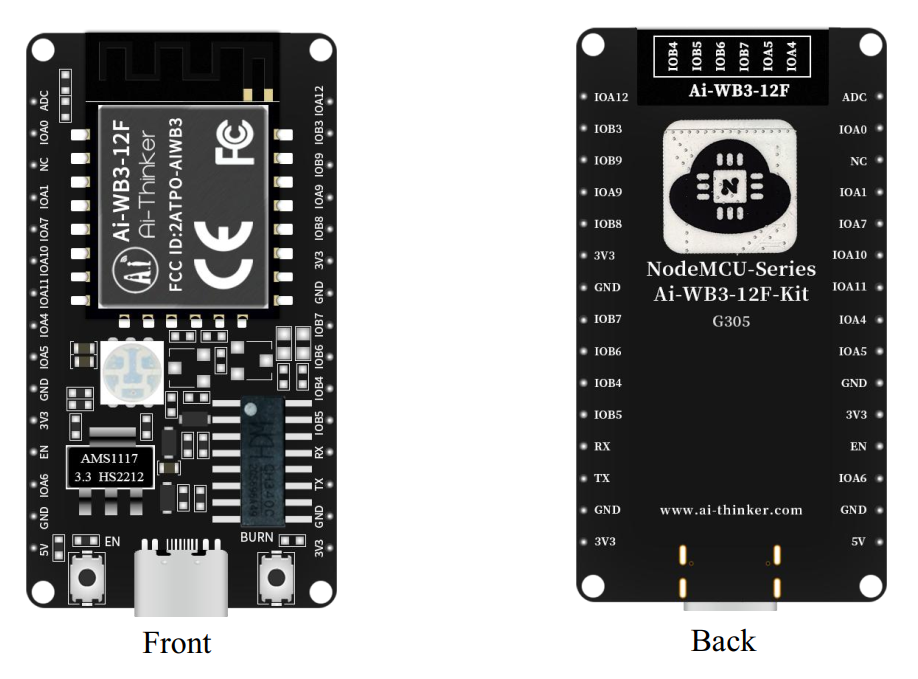

    I don't recall seeing this before. Ai-Thinker have an LN882H dev board. The Ai-WB3-12F-Kit.
    Front and back of the Ai-Thinker LN882H Ai-WB3-12F development board.
    • ai-wb3-12f-kit_v1.0.0_specification.pdf (635.24 KB) You must be logged in to download this attachment.

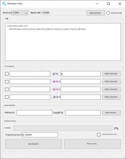

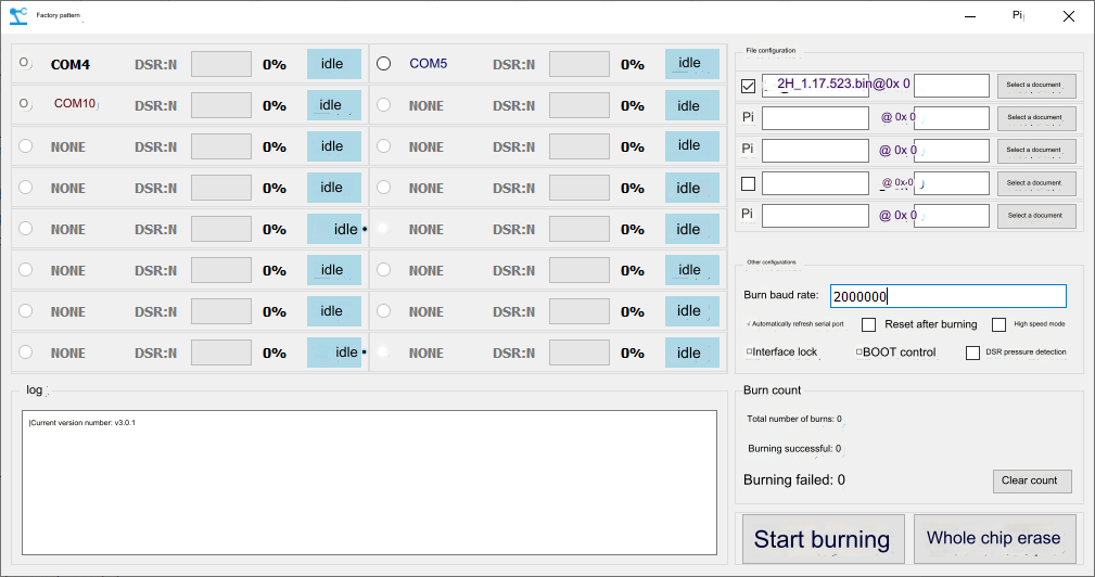

    Improved translations for the flashing GUI screenshots
    #12 21038316
    Posts: 5236
    Help: 449
    Rate: 918
    some slightly nicer translations. Google Translate output text size/resolution could be better though.
    Chinese user interface with work mode options and a confirmation button. Software interface with fields for selecting operating mode and equipment quantity.
    User interface of a program with a list of COM ports and binary file settings. Screenshot of software for configuring COM ports.
    Chinese dialog box with a dropdown menu and a confirmation button. User interface with operating mode and equipment quantity selection.
    Screenshot of an application interface in Chinese. Screenshot of developer mode interface showing user configuration for serial port setup.
    Password entry dialog box with Chinese text and OK and Cancel buttons. Dialog box requesting a password with a warning that Burn test mode is for internal use only!.

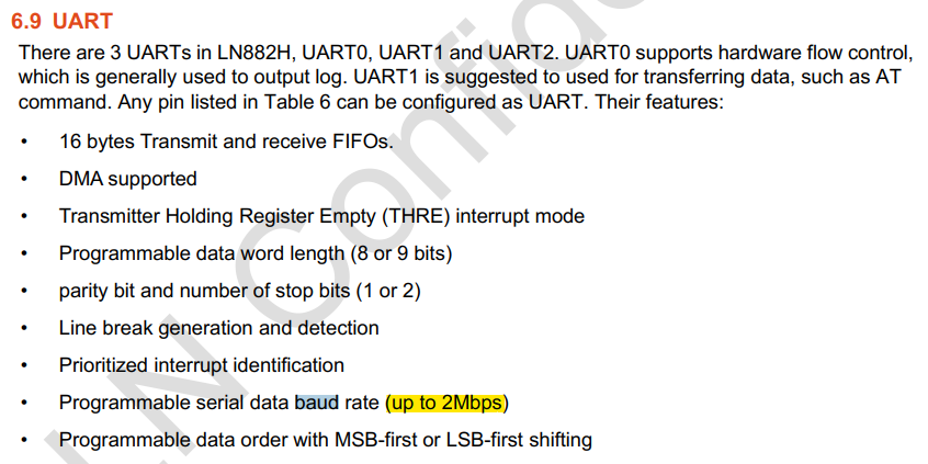

    OK. Where are you seeing statement of 921000 as being the correct baud in official documentation?
    I've been flashing successfully at 2000000 and I note this in the LN882H datasheet
    Excerpt from documentation on UART in LN882H highlighting the maximum data transfer rate of 2 Mbps.

    I have just tried flashing multiple times with the original stated speed unsuccessfully and them follow the bound rate defined in the command line tool process and got it flashed the first time.
  • #16 21212990
    Posts: 14794
    Rate: 12941
    Slower baud rates are more reliable. When flashing fails, lowering the baud rate is the first thing to try.
  • #17 21216101
    kodacy
    Posts: 6
    >>21212990 Yes and I agree, but did not know this chip could accept different baud rates

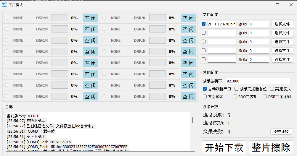

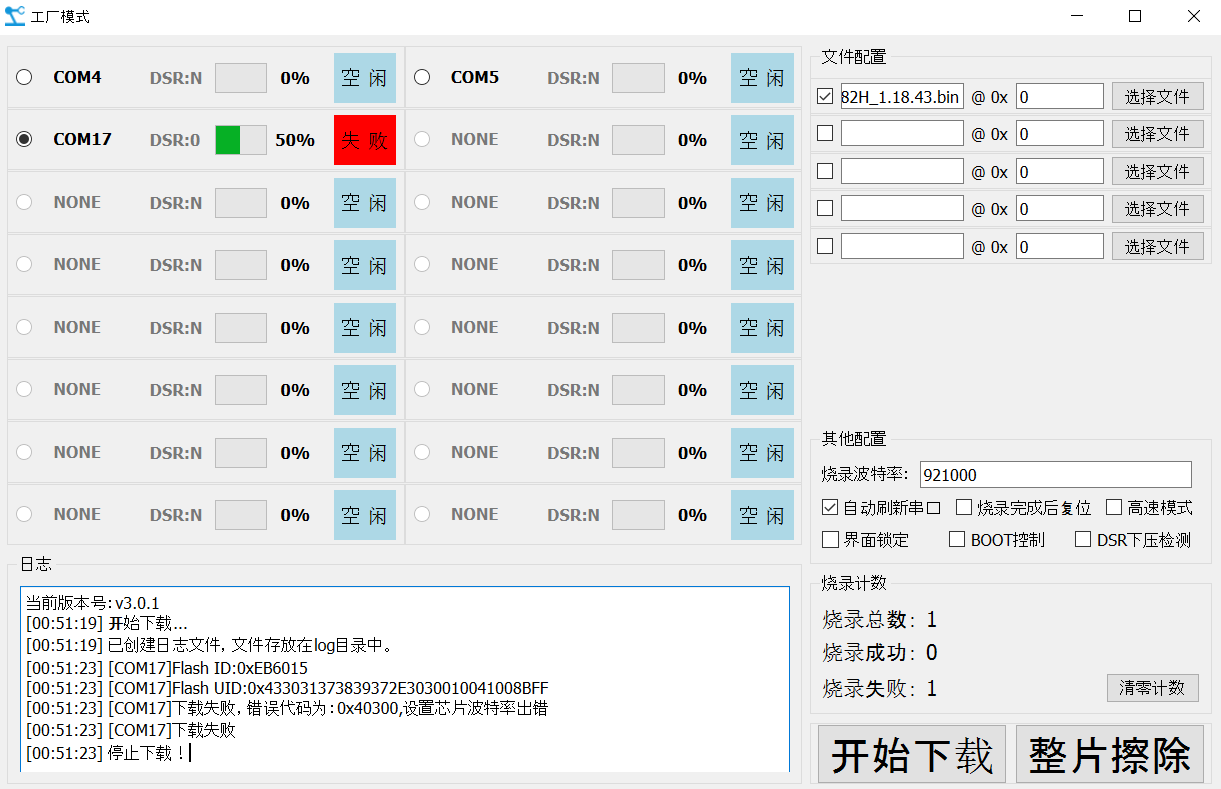

  • Baud rate setup error during Tuya socket flashing
    #20 21451846
    Powl654
    Posts: 9
    Any ideas thats wrong?I also have a problem with not getting this Tuya socket flashed. It's my first Tuya device. In the past I only flashed ESPs with Tasmota. So OpenBeken is completely new to me.
    This ist the message I get:
    当前版本号:v3.0.1
    [00:51:19] 开始下载...
    [00:51:19] 已创建日志文件,文件存放在log目录中。
    [00:51:23] [COM17]Flash ID:0xEB6015
    [00:51:23] [COM17]Flash UID:0x433031373839372E3030010041008BFF
    [00:51:23] [COM17]下载失败,错误代码为:0x40300,设置芯片波特率出错
    [00:51:23] 停止下载!
    Screenshot of a program managing COM ports and binary files.
  • #21 21451893
    Posts: 14794
    Rate: 12941
    How did you connect flasher?
    Have you tried alternate method?
    https://www.elektroda.com/rtvforum/topic4096854.html
  • #22 21452668
    Posts: 5236
    Help: 449
    Rate: 918
    Are your wires too long maybe? Also, try lower bauds..
  • Windows flashing command fails to start on COM17
    #23 21453392
    Powl654
    Posts: 9
    I soldered approximately 60cm long an thin wires on the socket as described here.
    Those wires are connected to at least 20cm long dupon male-female cables which are hooked up to the CH340. The 3.3V power supply is made by the "FTDI" I use for uploading the .bin file.
    I am using Win10 to flash the socket. So I also tried the with
    LN882H_CMD_Tool.exe COM17 download flash 921000 0x0 OpenLN882H_1.18.43.bin
    But for a split second a sreen pops up (which I cant read) and nothing else is happening.
  • #24 21453573
    rufus4
    Posts: 65
    Rate: 9
    So there are 80cm in total if I do get this right. This probably is the problem. Try to shorten the total cable length to 20cm.
  • #25 21453816
    Powl654
    Posts: 9
    Yes, it was at least 80cm.
    It worked after shortening the wires an reducing the speed to 921000!
    Thanks to all for your help!
