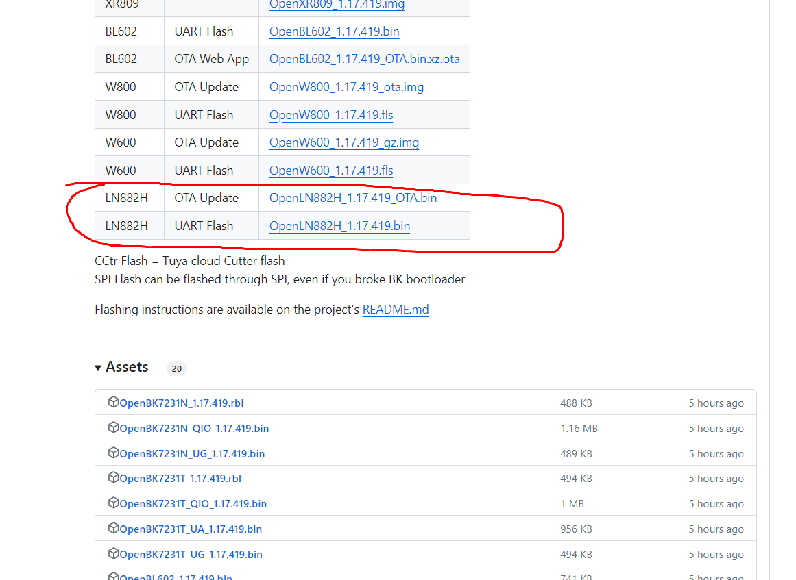

    2024-01-20 UPDATE
    Now OpenBeken OTA on OpenLN882H is working. Futhermore, builds are now public, see:
    https://github.com/openshwprojects/OpenBK7231T_App/releases
    Screenshot of a file list for OTA and UART Flash updates for LN882H, highlighting OpenLN882H_1.17.419_OTA.bin and OpenLN882H_1.17.419.bin options.
    OTA can be done via Web App, OTA tab, just drag and drop OTA file on the field and click start button.

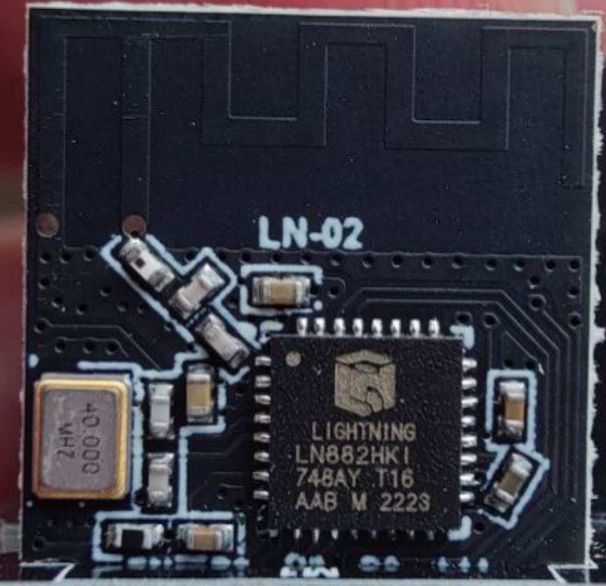

  • #7 20923875
    voodoopt
    Posts: 30
    cozilife smart switch
    Close-up of an integrated circuit marked LIGHTNING LN882HKI.
  • #8 20924030

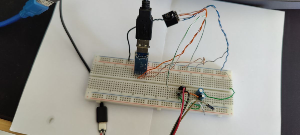

    I can't flash the chip, try with 3 different programmers
    -> Arduino Nano with CH340
    -> Prolific USB-to-Serial Comm Port (USB to TTL)
    -> ESP programer (USB-SERIAL CH340)
    I use with AMS1117 3.3 800mah for separate power with capacitors
    I can check through Putty that it gives output but I can't get anything readable. (even used different speeds)
    In applications I cannot read or write with any of bk7231flasher_1.1.6 or LN882H_CMD_TOOL or even bk_writer1.60
    When I try to use the BOOT with GND pin it doesn't do anything.
    Even when I use putty output.
    It's easier to restart with the USB cable source
    What am I doing wrong?
  • #13 20933023
    Posts: 14767
    Rate: 12906
    How your setup looks like?
    Why are you trying to flash LN882H with BK7231 flasher or bkWriter? It's not a BK7231. It will not work. You need to use the tool I mentioned in the flashing guide.

  • #15 20933029
    Posts: 14767
    Rate: 12906
    Do you know that after every attempt, even if it fails, you need to disconnect whole setup from power, while keeping boot on GND all the time?
    If you try to flash, and it fails, then it will lock itself up until you do power off/on again.

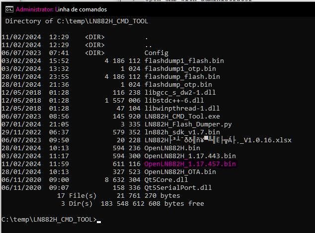

  • #19 20942445
    voodoopt
    Posts: 30
    I've tried everything, I always get the error
    with and withtou admin command line
    C:\temp\LN882H_CMD_TOOL>LN882H_CMD_Tool.exe COM21 download flash 2000000 0x0 c:\temp\LN882H_CMD_TOOL\OpenLN882H.bin
    Fail. Error downloading file.

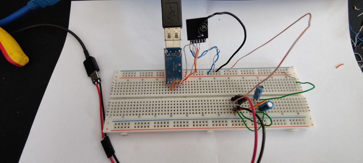

    Breadboard with various connections and wires connected to USB ports.
  • #20 20942455
    Posts: 14767
    Rate: 12906
    I'd start with shortening the wires. We already had cases where BK7231 flashing was failing due to the too long wires between USB to UART converter and WiFi module.
  • #21 20942638

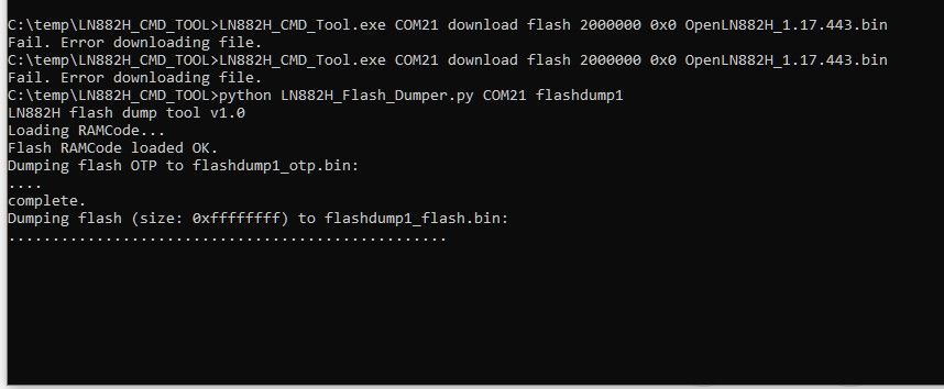

    voodoopt
    Posts: 30
    Breadboard with a USB module and various connected wires.
    even with small cables, same error.
    As I said, I managed to do the DUMP the other day, can you check if it was done correctly?
    same setup
    Screenshot of a console showing errors during download and successful flash dumping.
    • flashdump_flash.bin (3.99 MB) You must be logged in to download this attachment.
    • flashdump_otp.bin (1 KB) You must be logged in to download this attachment.

  • #27 20954724
    eikclan
    Same problem here, when I try to flash the chip I get "Fail. Error downloading file.".
    Any ideas on how to fix this issue?
  • #28 20955839
    voodoopt
    Posts: 30
    I can dump with and without capacitors
    only with an AMS1117 3.3v
    Now writing I always have the same error "Fail. Error downloading file."
  • Flashing only works once after reboot with boot pin set
    #29 20955856
    Posts: 14767
    Rate: 12906
    Can you please provide step by step information how do you get to that error?
    I've tried on two devices so far and it worked literally on the first try.
    Things to keep a note for:
    - choose the correct binary file for flashing, not the OTA file!
    - try running flasher as admin
    - make sure that the binary file is in the same directory where you are
    - keep wires short
    - flashing procedures work ONLY ONCE after reboot with boot pin set, after every failure or anything, you HAVE TO disconnect and reconnect power again, preferrably whole circuit, because it's possible for circuit to "power itself" without VDD via UART lines (! ! !)
  • Flash download fails after RX/TX activity
    #30 20955951
    voodoopt
    Posts: 30
    reboot computer
    all stuff are disconnected
    connect UART usb to check COM port
    open CMD with administrator
    go to my location c:\temp\LN882H_CMD_TOOL
    Windows command prompt screen showing a list of files in the C:\temp\LN882H_CMD_TOOL directory.
    Disconnect USB UART and External power USB with AMS1117 3.3v
    wait 1 min for discharge everyting
    than run command on Command line with administrator
    LN882H_CMD_Tool COM21 download flash 2000000 0x0 OpenLN882H_1.17.457.bin
    blink RX 4seg then TX 1seg then stop everithing
    after some secons get error
