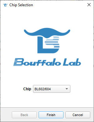

Backup
Download BouffaloLabDevCube-vxxxx.zip from https://dev.bouffalolab.com/download. Unzip and run BLDevCube.exe.
Choose BL602/604 chip
Bouffalo Lab chip selection window with BL602/604 chip selected.
