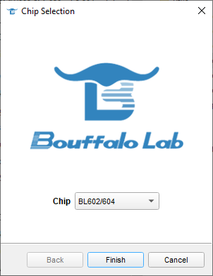

    Download BouffaloLabDevCube-vxxxx.zip from https://dev.bouffalolab.com/download. Unzip and run BLDevCube.exe.
    Choose BL602/604 chip
    Bouffalo Lab chip selection window with BL602/604 chip selected.

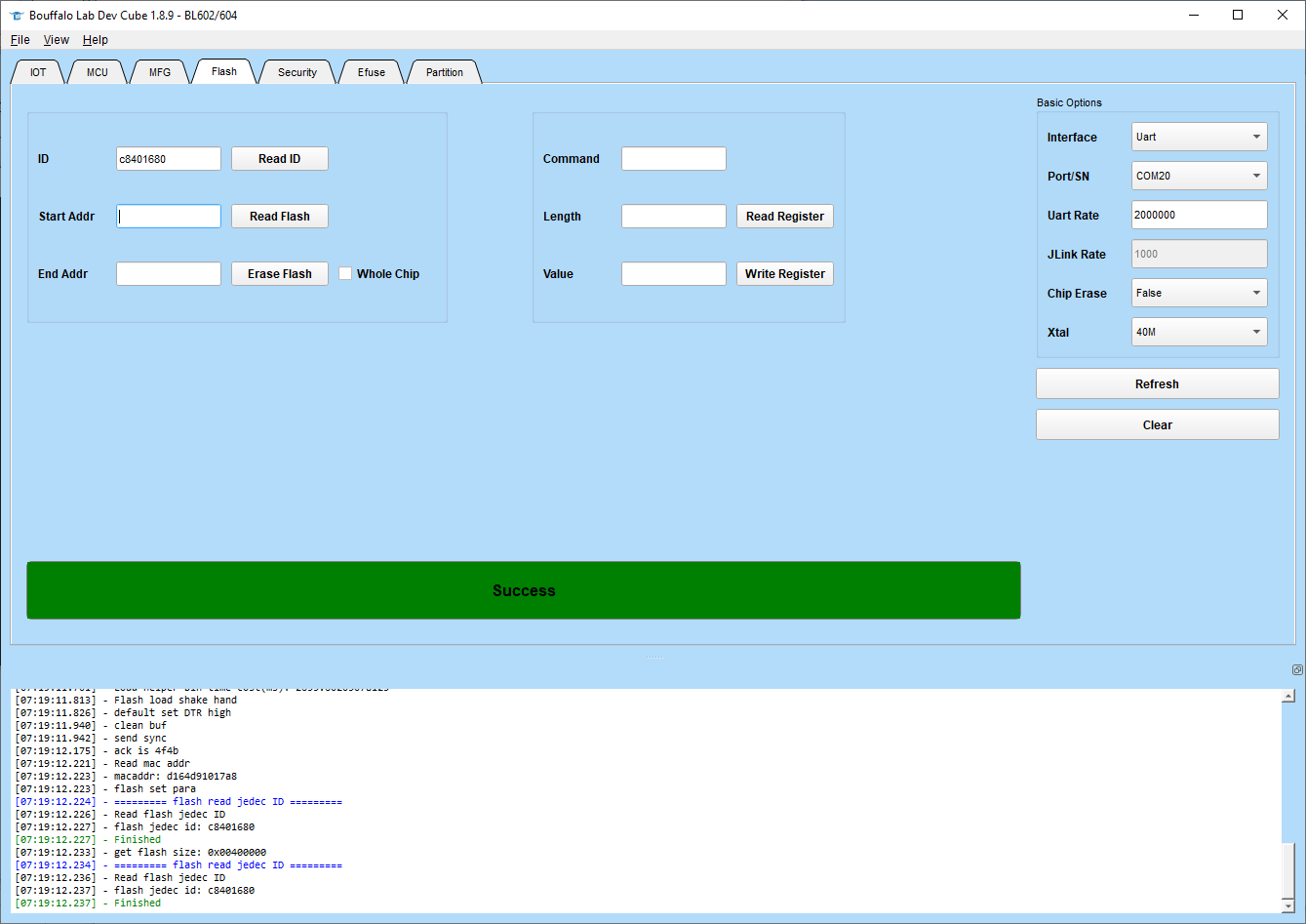

    On the Flash tab ensure the correct COM (Port/SN) is selected and the uart rate is 2000000. I've found good contact with the pins and short jumper wires are crucial for this speed to work if trying on a real IoT device.
    You can use the Read ID button to test communication first if needed.
    Bouffalo Lab Dev Cube software interface with Flash tab open and success message at the bottom.

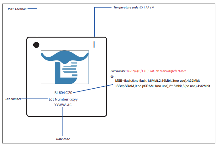

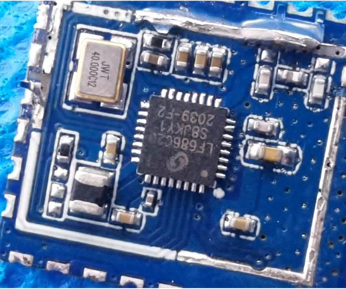

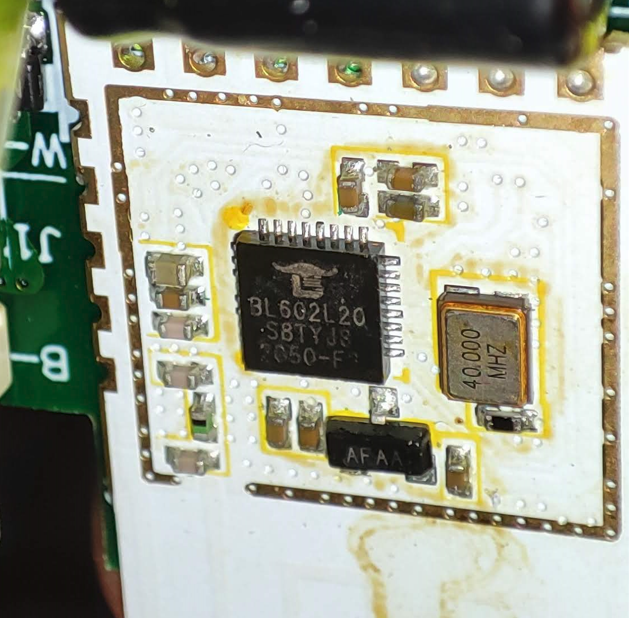

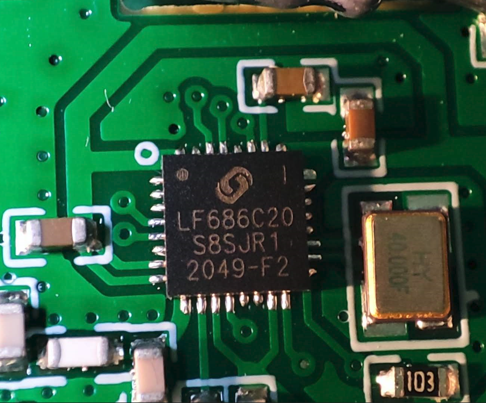

    This step will also show you the size of the flash. Most devices I see on the forums appear to be 2mb. The WB2 board is 4mb. You'll need to know the size shortly.
    The flash size can also be determined by the silkscreen print on the IC. The key is
    Schematic drawing of BL604C20 chip with annotations.
    eg:
    Close-up of LF686C20 chip on a circuit board. Close-up of a BL602L20 module on a printed circuit board.
    LF/BL602C10 = 1 megabyte / 8 megabit
    LF/BL602C20 = 2 megabyte / 16 megabit
    LF/BL602C40 = 4 megabyte / 32 megabit
    I've only seen LF602C20 in the wild so 1mb and 4mb are just assumptions following the naming convention.

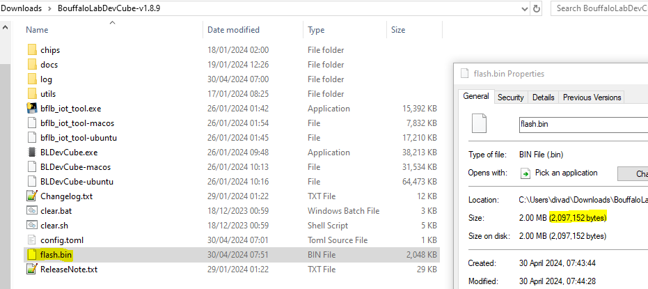

    To begin dump enter start and end addresses according to chip size. Note that the Whole Chip checkbox is for the erase function not flash read.
    After clicking read flash and a successful handshake it should dump a flash.bin file to same location as the BLDevCube.exe. The total bytes should match above.
    Screenshot of the BouffaloLabDevCube folder with the highlighted flash.bin file.
    You've successfully backed-up the device's firmware.

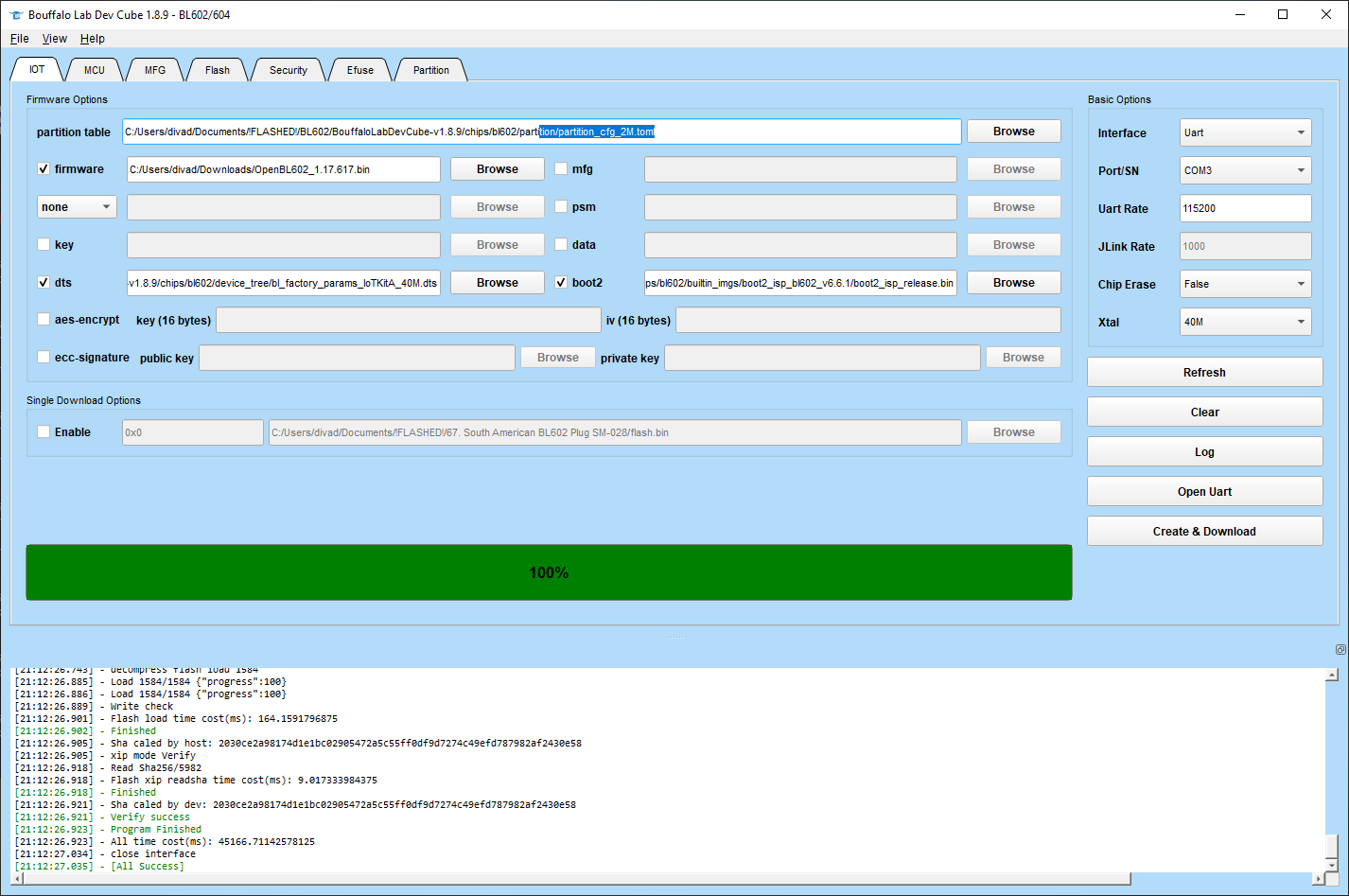

    Restore

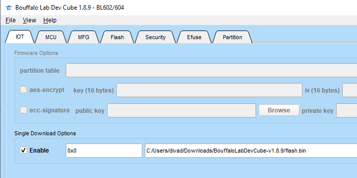

    To restore a firmware, switch to the IOT tab and check Enable under Single Download Options. Keep the start address 0x0 and browse to the bin dump you want to flash.
    Bouffalo Lab Dev Cube interface with single download option enabled.
    Put device into download mode again with BOOT pin method then click Create & Download. It should begin flashing. It'll erase the flash before it writes.
    Screenshot of Bouffalo Lab Dev Cube with Flash tab and 100% progress.
    After success you can click Open Uart to watch your firmware boot!

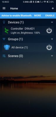

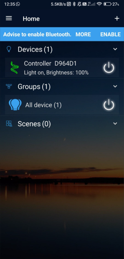

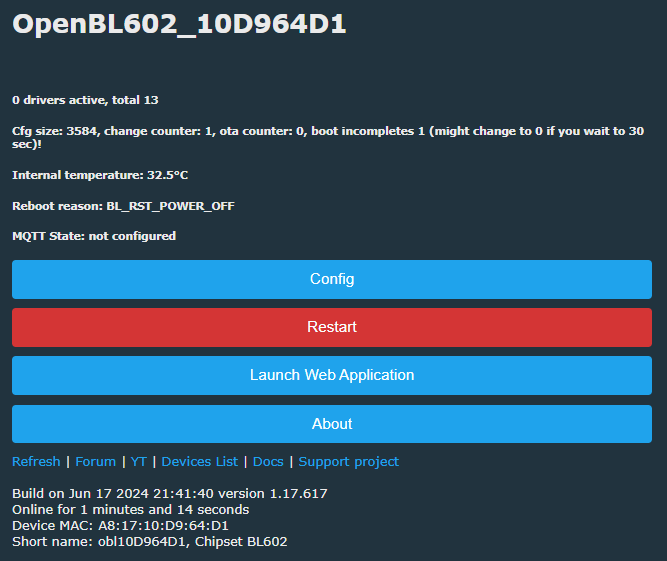

    I have successfully flashed quite a few BL602 dumps onto the dev board and all have booted and were pairable using Cozylife/Tuya/Magic Home apps, depending on what device they came from. They'll detect as a bulb/relay/whatever. On the Ai-WB2 even the LED blinks when in pairing mode and can be controlled from the app as if it was the original bulb.
    View of an IoT control app with a list of devices and groups.

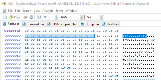

    If your backup doesn't boot or you found a backup online and are unsure if it'll work, a little indicator the file is OK is that the starting bytes appear to always be this when viewed in HxD
    Screenshot of hex editor with flash.bin file open
    I have only tested backup/restore on the dev board to date, so please experiment at your own risk and give some feedback in this thread.

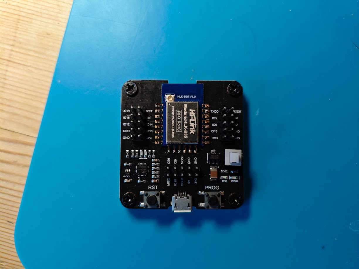

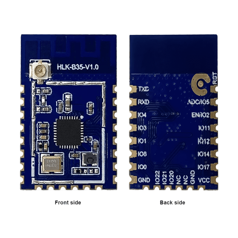

    I didn't know there were any Leapfive LF686 modules out there. This is new (and the B36 W800) - to me anyway.
    The Hi-Link HLK-B35:
    Comparison of two Hi-Link WiFi Bluetooth modules B35 and B36.
    Hi-Link HLK-B35 module, front and back view.
    Close-up of an electronic module labeled LF686 on a blue PCB.
    https://www.hlktech.net/index.php?id=969&cateid=728
    https://fccid.io/2AD56HLK-B35
    • HLK-B35_User-manual-5512253.pdf (1.13 MB) You must be logged in to download this attachment.

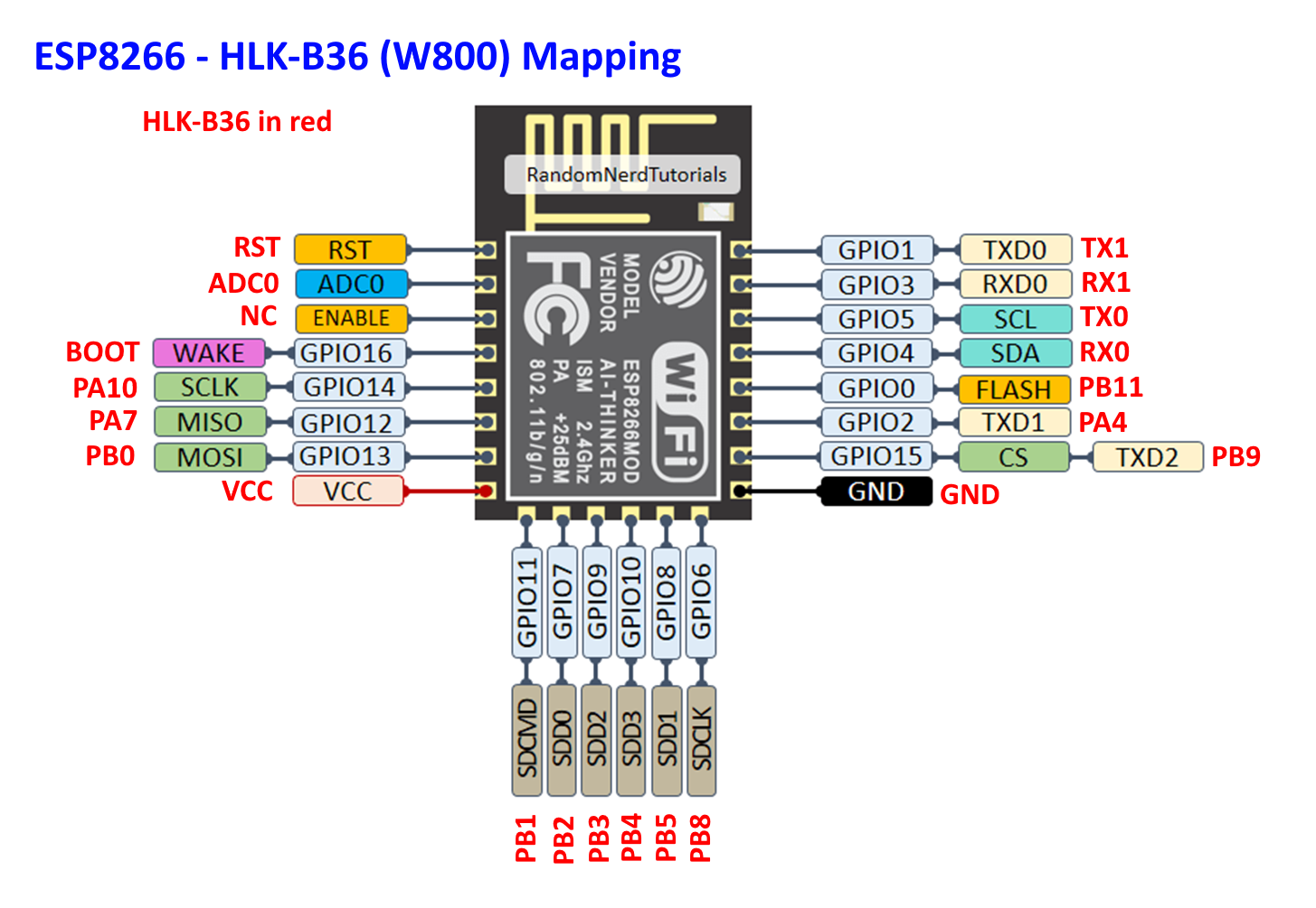

    and a mapping for the ESP8266 to HLK-B36 (W800-B400)
    Diagram showing pin mapping from ESP8266 to HLK-B36 (W800).

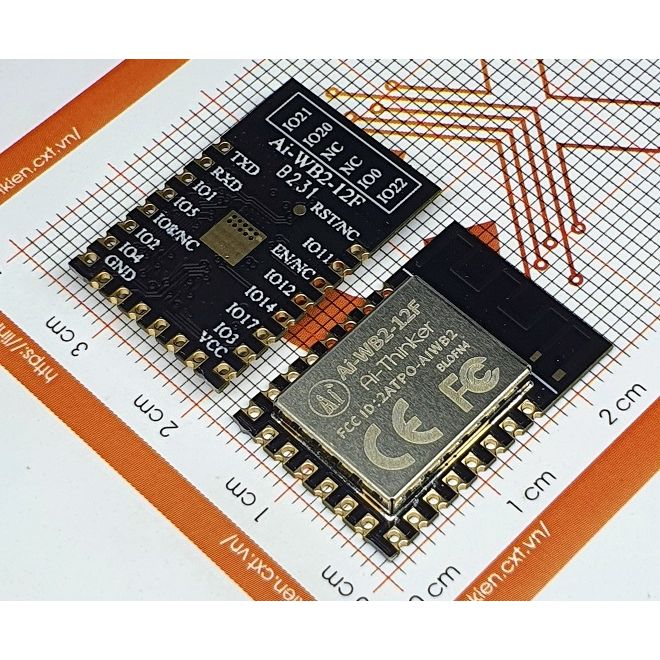

    sir! I have an ai-wb2-12f module, as far as I know, inside it is also a BL602 chip, so I tried to flash the OpenBL602_1.17.649.bin file but got an error. I can still read the chip ID and backup FW as usual. Two AI-WB2-12F modules lying on graph paper. Is that module not suitable for this FW?
    here is the error:
    [01:14:05.645] - ========= flash read jedec ID =========
    [01:14:05.647] - Read flash jedec ID
    [01:14:05.647] - flash jedec id: 5e401680
    [01:14:05.647] - Finished
    [01:14:05.650] - get flash size: 0x00400000
    [01:14:05.651] - Program operation
    [01:14:05.651] - DealingIndex 0
    [01:14:05.651] - ========= programming d:\bouffalolabdevcube-v1.9.0\chips\bl602\img_create_iot\img_single.bin to 0x00000000
    [01:14:05.655] - flashcfg did not match first
    [01:14:05.659] - flashcfg does not match again
    [01:14:05.660] - ErrorCode: 0040, ErrorMsg: BFLB FLASH CFG NOT FIT WITH BOOTHEADER
    [01:14:05.660] - Burn Retry
    [01:14:05.660] - 0
    [01:14:05.660] - Burn returned with failed retry
  • Standard flash starts at 0x10000, preserving bootloader
    #13 21166602
    Posts: 5212
    Help: 446
    Rate: 914
    Yes, the AI-WB2-12F is a 4mb BL602.
    The OpenBeken BL602 file OpenBL602_1.17.649.bin is for flashing using the standard method, not the single download option - https://www.elektroda.com/rtvforum/topic3889041.html - so your BLDC will look like this
    Bouffalo Lab Dev Cube interface with loaded configuration and operation log.
    This should flash from 0x10000, leaving the existing bootloader in tact on the AI-WB2-12F.
    The single download option flashing from 0x0 is for when you have a complete flash backup, one that contains the bootloader too.
    Does your AI-WB2-12F have any output at present when booted?
  • Flash config mismatch when writing BL602 firmware
    #14 21169262
    daoviethung1992
    >>21166602
    sorry sir! Now I have free time! When I bought it I didn't know if it had a bootloader or not, I tried it and there wasn't any output when booting. I have researched this module, as you said it has 4M flash memory, and it is external flash memory, not internal flash memory. and I also have the complete FW file backed up from the ewelink 4ch relay circuit (BL602L20 chip - 2M internal flash memory) I tried flashing it with The single download option flashing from 0x0 and it gives an error:
    [01:38:11.315] - flash jedec id: 5e401680
    [01:38:11.316] - Finished
    [01:38:11.319] - get flash size: 0x00400000
    [01:38:11.319] - Program operation
    [01:38:11.320] - DealingIndex 0
    [01:38:11.320] - ========= programming d:\bouffalolabdevcube-v1.9.0\chips\bl602\img_create_iot\img_single.bin to 0x00000000
    [01:38:11.324] - flashcfg did not match first
    [01:38:11.328] - flashcfg does not match again
    [01:38:11.329] - ErrorCode: 0040, ErrorMsg: BFLB FLASH CFG NOT FIT WITH BOOTHEADER
    [01:38:11.329] - Burn Retry
    [01:38:11.329] - 0
    [01:38:11.329] - Burn returned with failed retry.
    Maybe I will try removing the module's cover to see the chip details and remove the external memory.

    i've just flashed this to mine https://www.elektroda.com/rtvforum/topic4063490.html
    and it boots and is detected by the eWelink app. then I flashed it to OBK using the non-single mode and I now have an OpenBL602 AP and:
    Screenshot of the OpenBL602 interface displaying various information and options.
