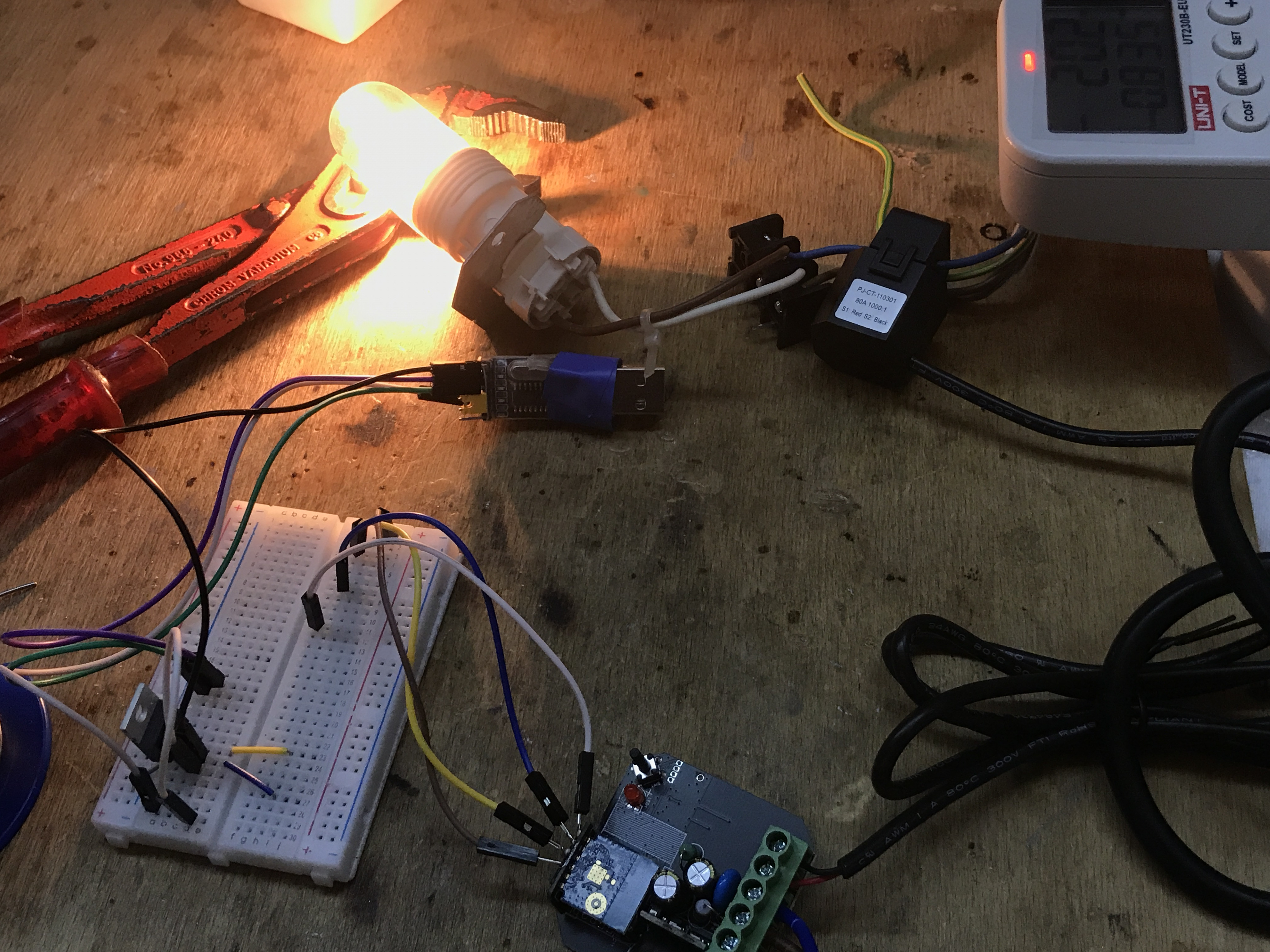

Test setup with a current meter and a lit bulb
I invite you to analyse a current/voltage/power meter working normally with the Tuya ecosystem. Here I'll test it with the manufacturer's app, analyze its MCU communication protocol with the WiFi module, and then try to change it's batch to OpenBeken, which I'll configure accordingly for this purpose.

This time I'm not uploading the firmware straight away, but I'll start by looking inside anyway...

Uploading OpenBeken
The UART1 port is used both for programming and for communication with the MCU, so the WiFi module has to be soldered out:
Close-up of a PCB with a CB2S module and electronic components. Close-up of a circuit board with visible electronic components. Circuit board of a power meter with CB2S module next to it
We solder the power supply, RX and TX, according to the instructions of our flasher:
Close-up of an electronic module connected to a breadboard with colored wires. Electronic module with visible connections and components.
Flasher will not discover the configuration of this device, as it is based on TuyaMCU. We need to write an autoexec.bat where we map the dpID from the TuyaMCU to the OBK channels. Searching for the dpID is mentioned in related topics, although here I used tuyaMcu_sendQueryState , and more precisely I manually sent the same package ( uartSendHex 55AA0008000007 ):

From the above log you can read out what dpIDs (data identifiers) with types and values were sent to us by the MCU. That's how I know that dpID 18 has a value of 77 (probably current), dpID 19 177 (power?) and dpID 20 is 2403 (here we know in advance that voltage). Just need to select the multipliers and map this to the channels in the OBK...
So I wrote a script:
startDriver TuyaMCU
tuyaMCU_setBaudRate 115200
tuyaMcu_defWiFiState 4
// request full state from time to time (every 10 seconds, -1 repeats - forever)
addRepeatingEvent 10 -1 uartSendHex 55AA0008000007
// dpID 20 is voltage * 0.1
setChannelType 1 Voltage_div10
linkTuyaMCUOutputToChannel 20 val 1
// dpID 18 is current * 0.001
setChannelType 2 Current_Div1000
linkTuyaMCUOutputToChannel 18 val 2
// dpID 19 is power * 0.1
setChannelType 3 Power_Div10
linkTuyaMCUOutputToChannel 19 val 3
The above script creates three channels (power, current and voltage), maps the dpID from the TuyaMCU to these channels, additionally forces a WiFi state of 0x04 (we simulate a connection to the cloud) and additionally periodically sends a state refresh request to provide us with the most recent measurements.
Result:
Screenshot of the OpenBK7231N control panel.
NOTE - without default WiFi state 0x04, at first the LED on the device was red and then flashing, but the device would not give measurements. After setting the default WiFi state to 0x04 this diode went off and the measurements appeared.

Additionally it is worth running the TuyaMCU queue in flags and adding to autoexec.bat powersave 1 .
Summary
After changing the firmware and uploading my autoexec.bat you can already pair this device with Home Assistant via automatic Discovery in OBK . The whole thing already works locally, without the cloud.
The device works satisfactorily, but could at least show a bit more data. I couldn't find any more interesting dpIDs, the device doesn't report anything else.
You could consider trying to rewire BL0942 directly to the WiFi module, the MCU would then have to be removed. This would also allow for self-calibration already in the OBK itself, but it's hard for me to even determine if this is a plus or minus - the factory calibration isn't that bad, although I haven't done any comparative measurements in this particular case.
