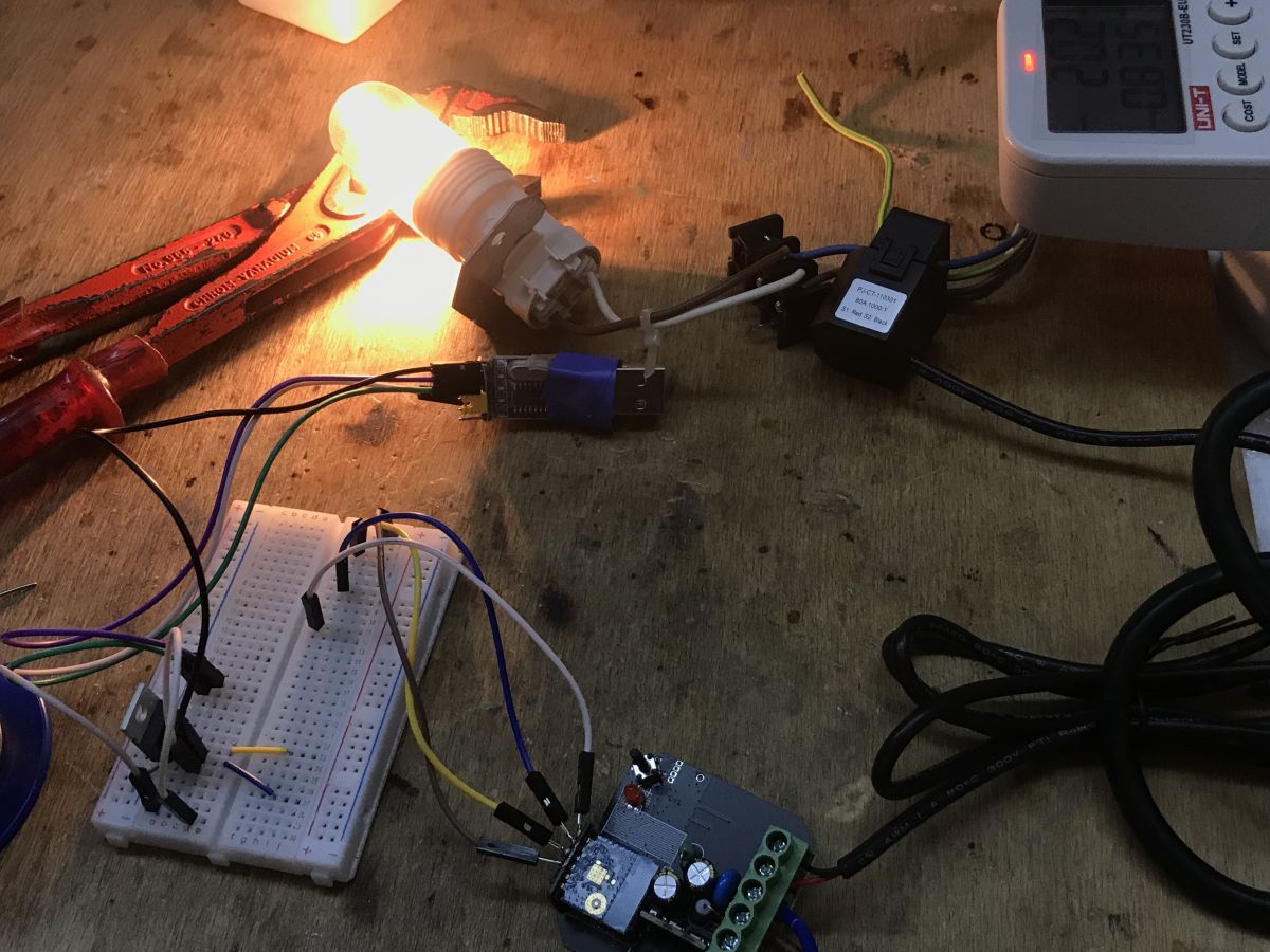

  • Test setup with a current meter and a lit bulb
    I invite you to analyse a current/voltage/power meter working normally with the Tuya ecosystem. Here I'll test it with the manufacturer's app, analyze its MCU communication protocol with the WiFi module, and then try to change it's batch to OpenBeken, which I'll configure accordingly for this purpose.

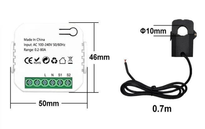

    Dimensions:
    Current meter with dimensions labeled and measurement cable

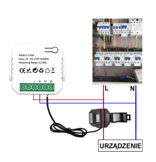

    Mounting:
    Power meter connection diagram with distribution board

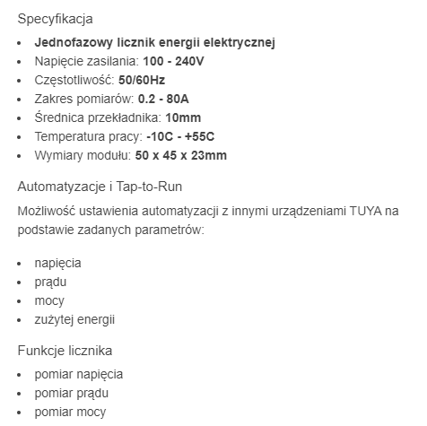

    Specification:
    Tuya electric energy meter specifications.

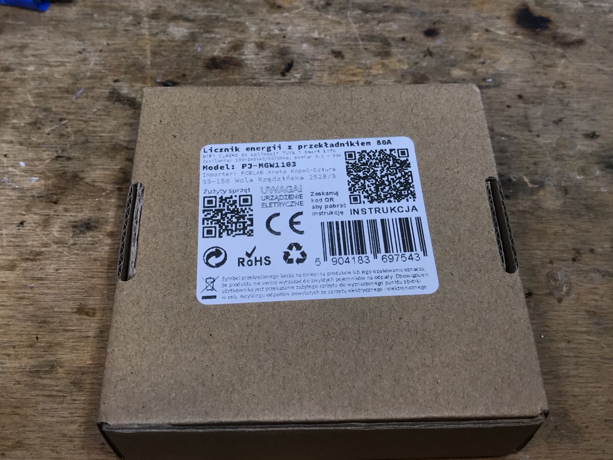

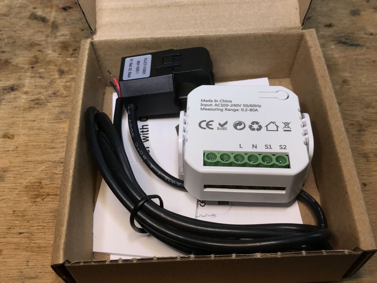

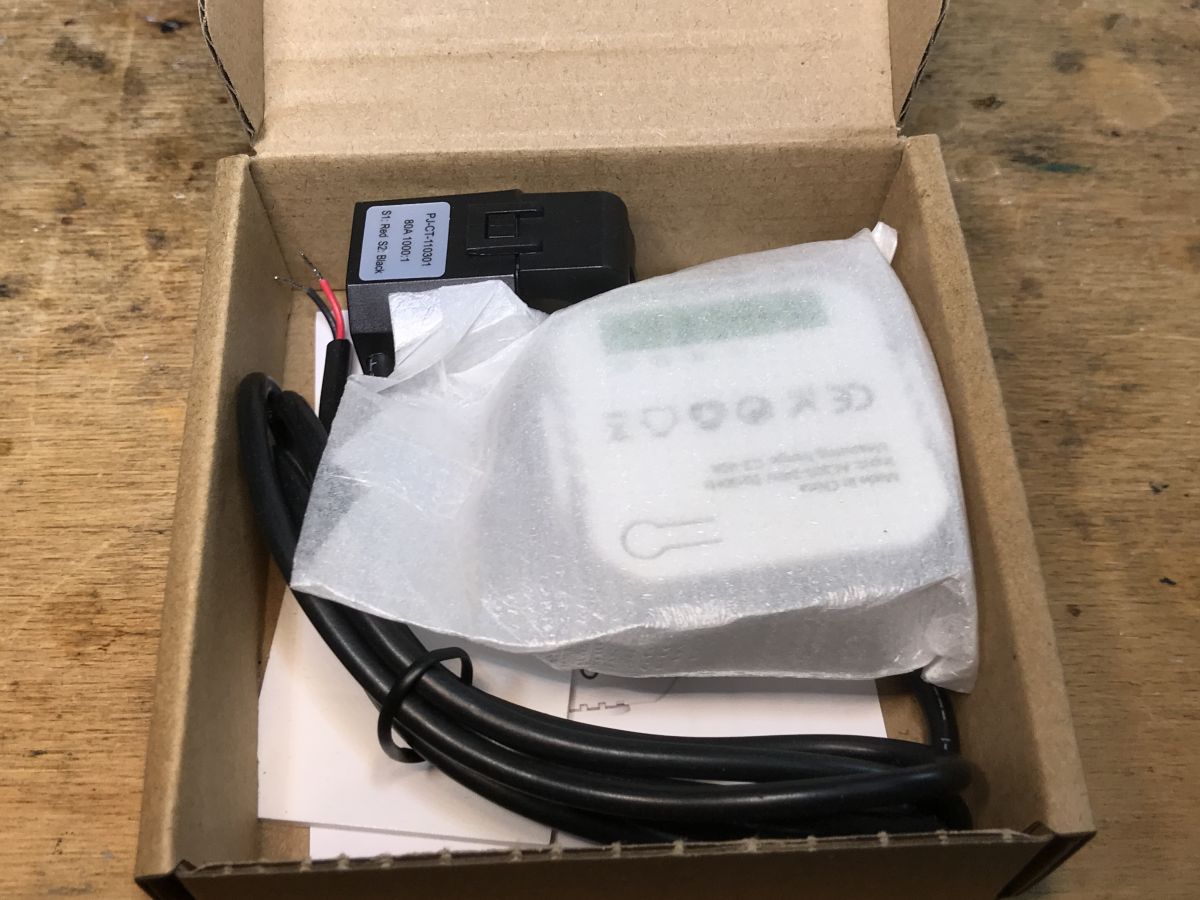

    In practice you get a box like this:
    Box containing PJ-MGW1103 energy meter Box of the PJ-MGW1103 power and voltage meter with a specification label on top.
    Contents:
    Measuring device in a box. Current and voltage meter in a box.

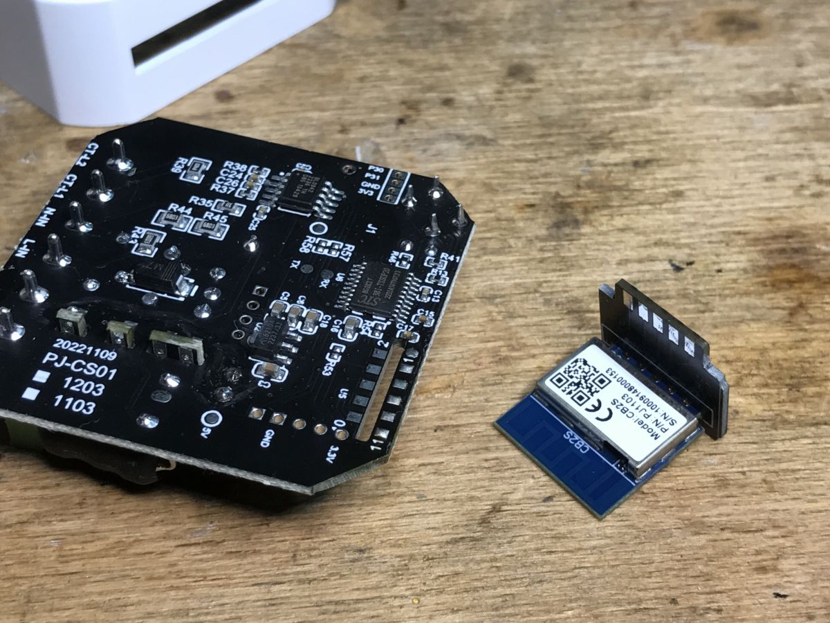

    This time I'm not uploading the firmware straight away, but I'll start by looking inside anyway...
    Interior of PJ-MGW1103

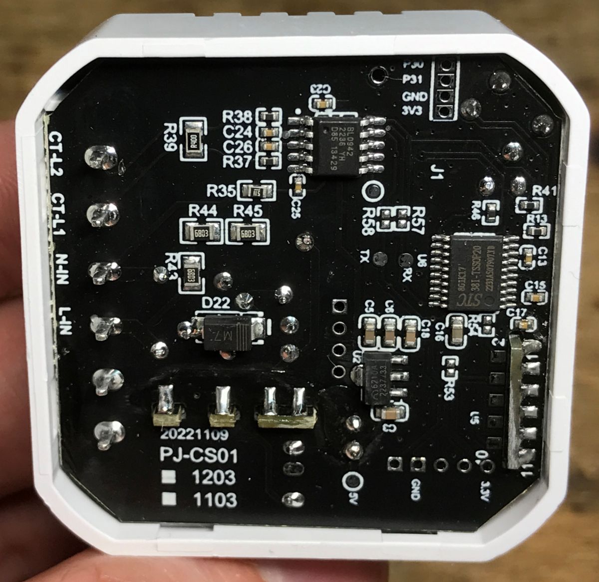

    We remove the cover:
    Close-up of a circuit board with visible electronic components, including the BL0942 chip. Interior of the PJ-MGW1103 device with electronic components.

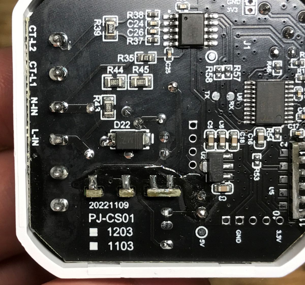

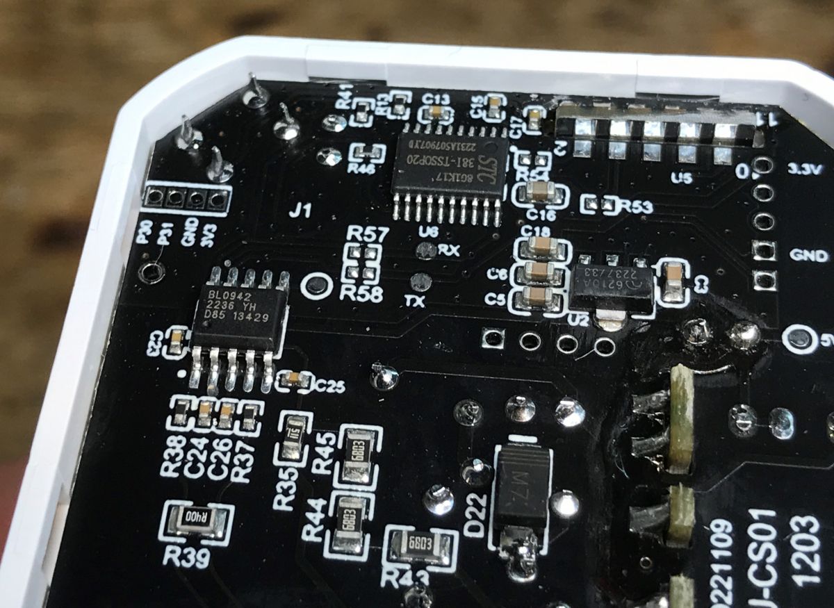

    Inside you can see BL0942 for energy measurement, but it is connected not to the WiFi module, but to a nearby MCU - here STC 381-TSSOP20 8G1K17.
    Close-up of the PCB of the PJ-CS01 device with visible electronic components.
    Platform designation:
    20221109
    PJ-CS01
    [] 1203
    [] 1103
    Face-to-face view:
    View of the interior of the PJ-MGW1103 device with electronic modules and components. Close-up of a circuit board with a soldered electronic module and LED.
    You can see the free space after the relay, this product does not have a relay, it just performs the measurement.

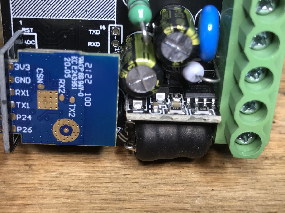

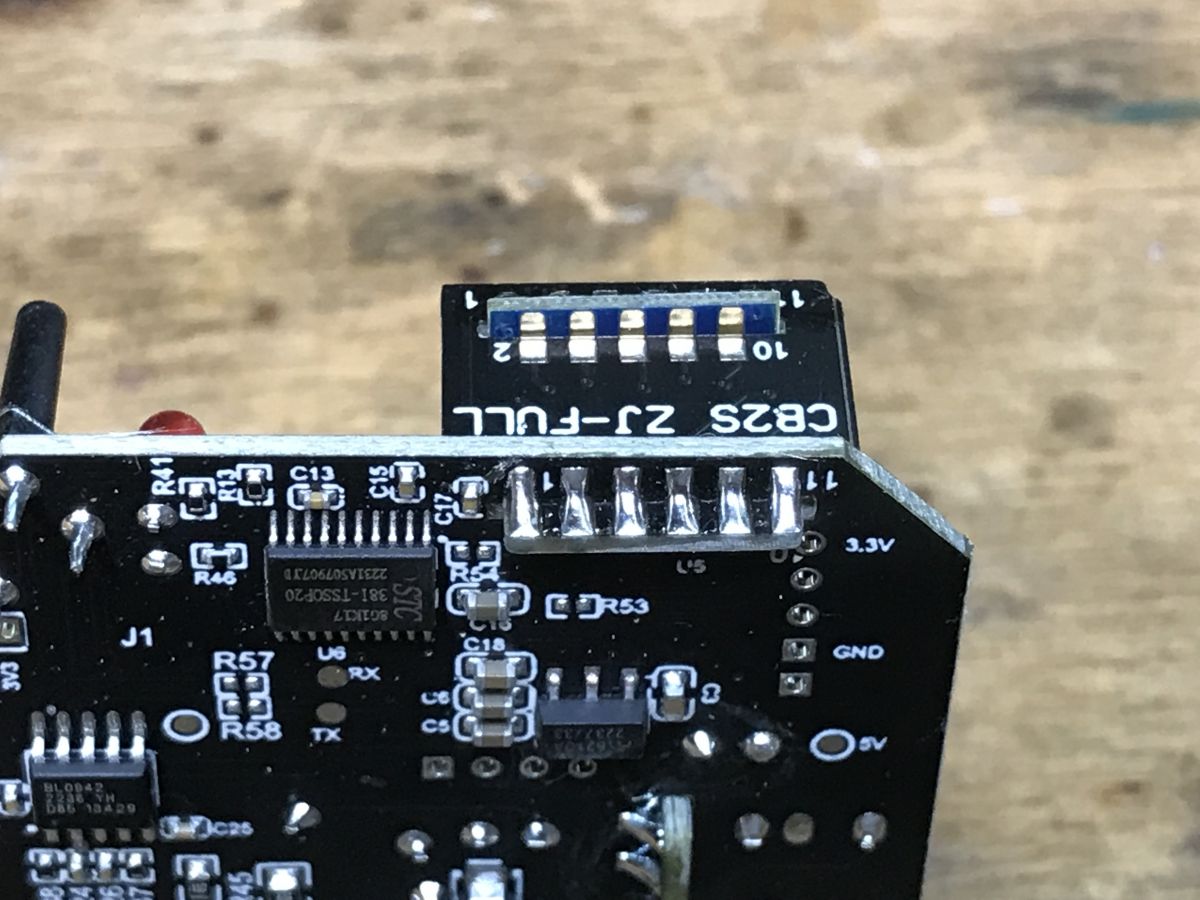

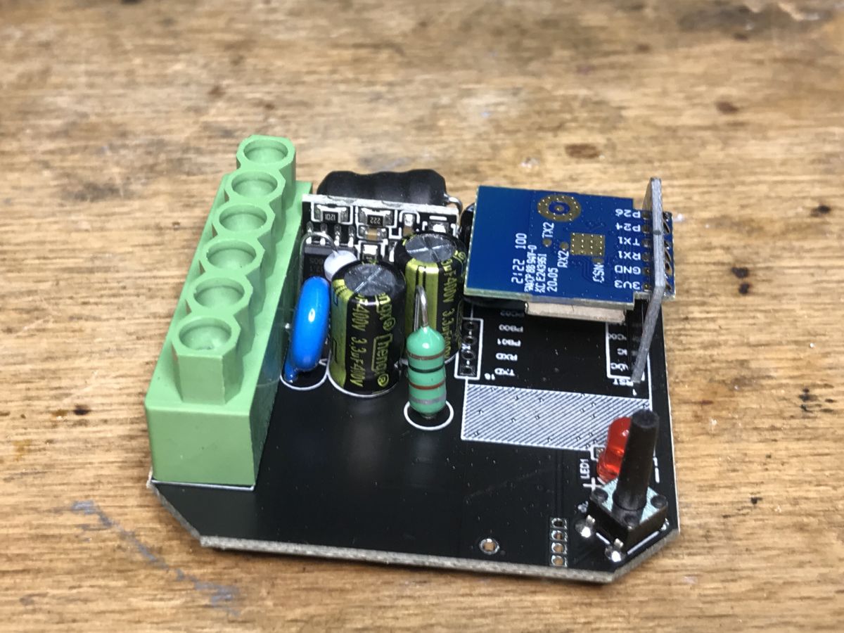

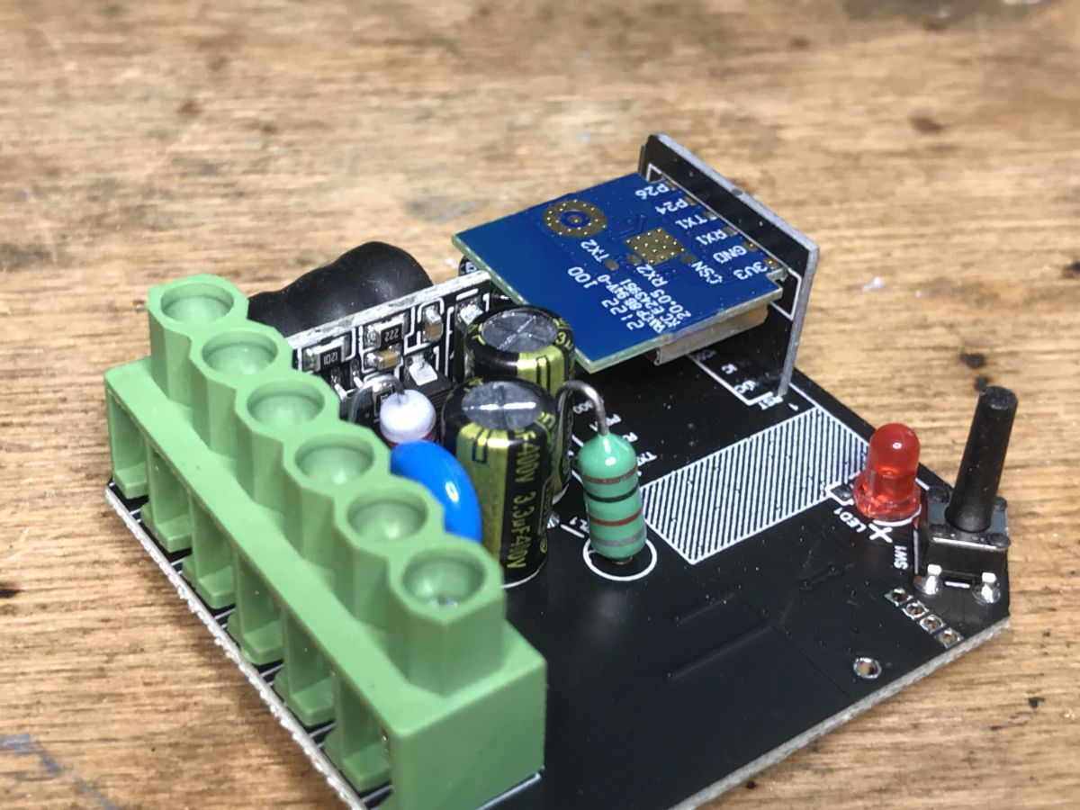

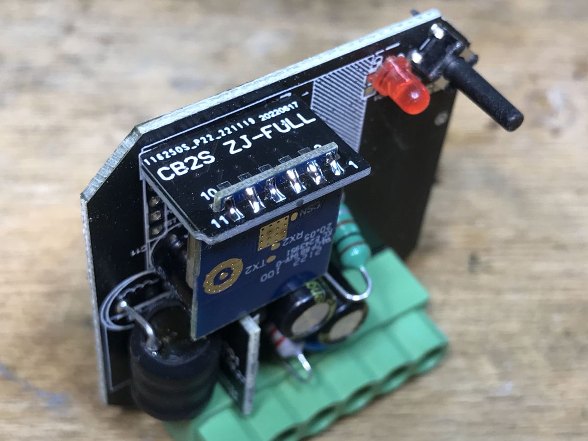

    The WiFi module here is CB2S, it is based on BK7231N:
    7b21879a. CB2S WiFi module with BK7231N chip on a circuit board Close-up of electronic module with wires and components

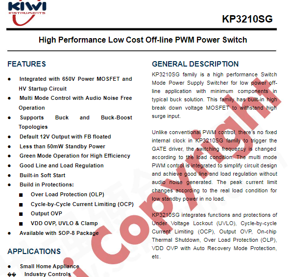

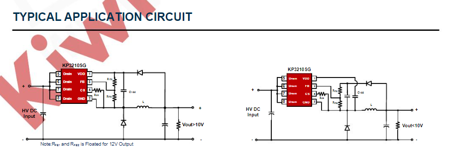

    You can also see the KP3210SG module soldered transversely into the main PCB here.
    KP3210SG datasheet - PWM switch
    This means we have a non-isolated inverter here:
    Typical application circuit diagram featuring KP3210SG.

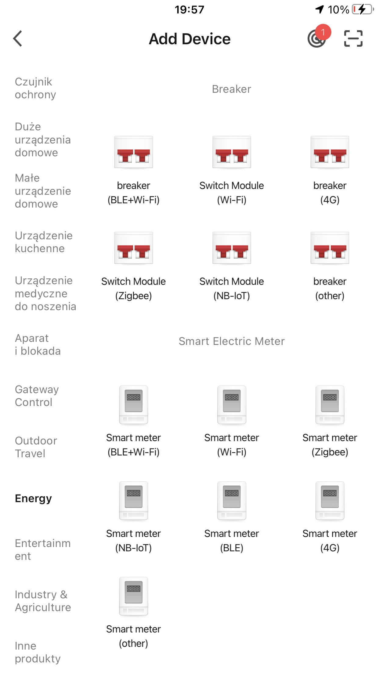

    Test with Tuya application
    Intercepting TuyaMCU communications is discussed in the separate topic mentioned at the beginning. The whole process requires a high degree of care, as you cannot simply connect the UART from this device to our computer, there is then a risk of a short circuit. However, it is possible to use galvanic isolation for the UART, there are various modules available for purchase for this on the web.
    The process requires two USB to UART converters, as we are tapping both TX->RX and RX->TX (two lines), the whole thing is about performing operations in the Tuya application and watching what happens.

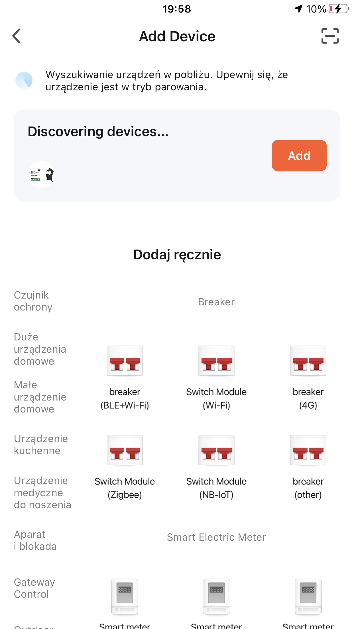

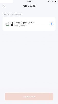

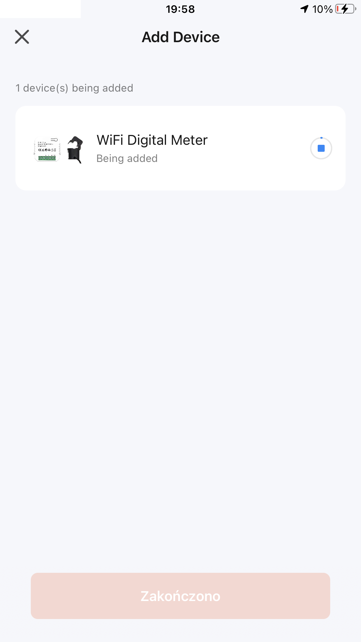

    So we start with the pairing:
    App screen for adding devices with various smart meter options. App screen for pairing Tuya devices.
    Thanks to Bluetooth you don't even have to manually pair like in the days of ESP, the phone detects the new device by itself.

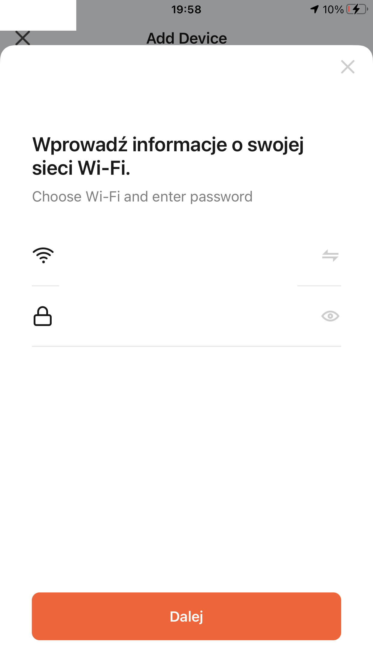

    We enter our WiFi data, etc:
    App screen with a Wi-Fi information input form.

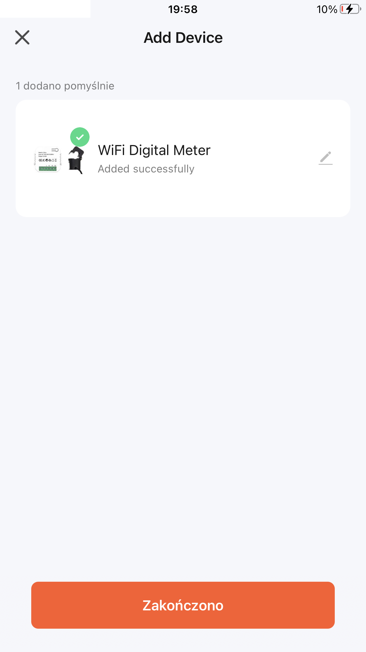

    Pairing:
    Mobile app screen showing the addition of a WiFi Digital Meter. App screen for adding a device with WiFi Digital Meter successfully added.

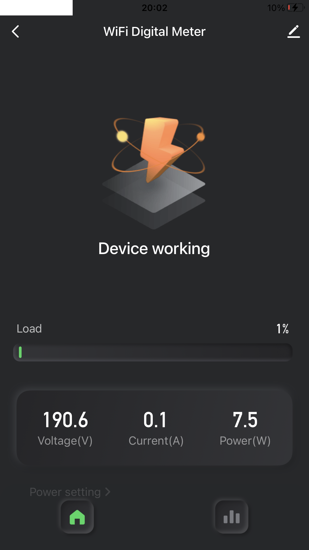

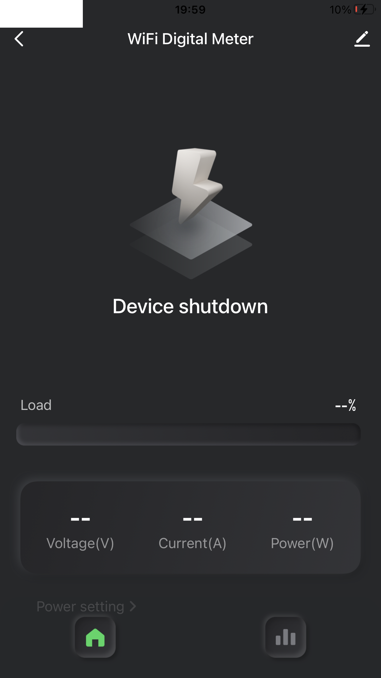

    After all, we are greeted by a rather unusual and modest panel. Strangely enough without a relay:
    App screen of WiFi Digital Meter indicating device shutdown
    The panel shows measurements of power, current and voltage:
    WiFi digital meter app screen displaying voltage 190.6V, current 0.1A, and power 7.5W.

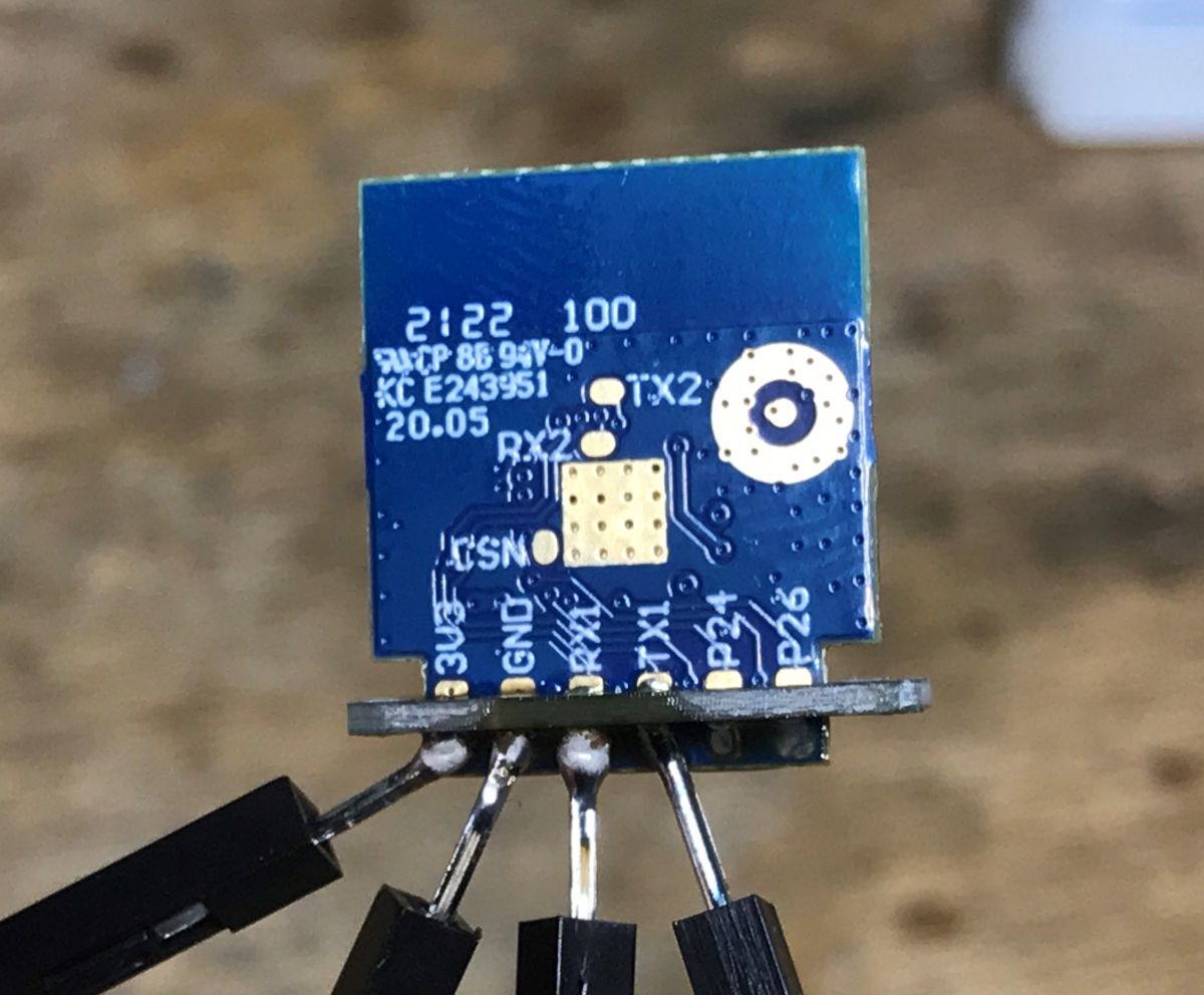

    Uploading OpenBeken

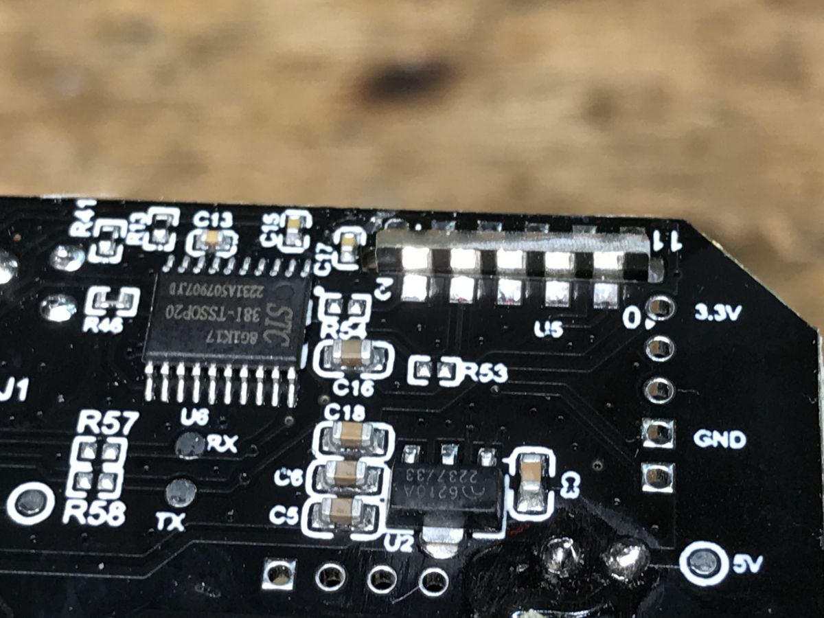

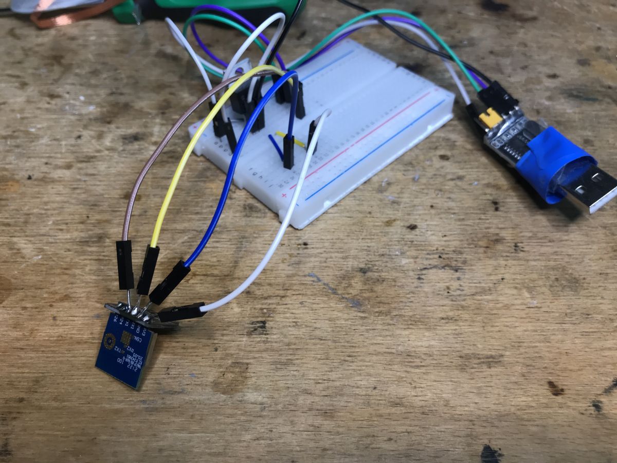

    The UART1 port is used both for programming and for communication with the MCU, so the WiFi module has to be soldered out:
    Close-up of a PCB with a CB2S module and electronic components. Close-up of a circuit board with visible electronic components. Circuit board of a power meter with CB2S module next to it
    We solder the power supply, RX and TX, according to the instructions of our flasher:
    Close-up of an electronic module connected to a breadboard with colored wires. Electronic module with visible connections and components.
    Flasher will not discover the configuration of this device, as it is based on TuyaMCU. We need to write an autoexec.bat where we map the dpID from the TuyaMCU to the OBK channels. Searching for the dpID is mentioned in related topics, although here I used tuyaMcu_sendQueryState , and more precisely I manually sent the same package ( uartSendHex 55AA0008000007 ):

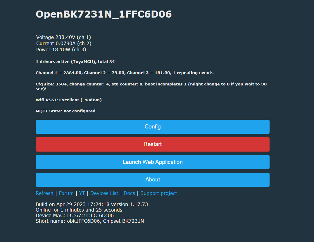

    So I wrote a script:
    startDriver TuyaMCU
    tuyaMCU_setBaudRate 115200
    tuyaMcu_defWiFiState 4
    // request full state from time to time (every 10 seconds, -1 repeats - forever)
    addRepeatingEvent 10 -1 uartSendHex 55AA0008000007
    // dpID 20 is voltage * 0.1
    setChannelType 1 Voltage_div10
    linkTuyaMCUOutputToChannel 20 val 1
    // dpID 18 is current * 0.001
    setChannelType 2 Current_Div1000
    linkTuyaMCUOutputToChannel 18 val 2
    // dpID 19 is power * 0.1
    setChannelType 3 Power_Div10
    linkTuyaMCUOutputToChannel 19 val 3

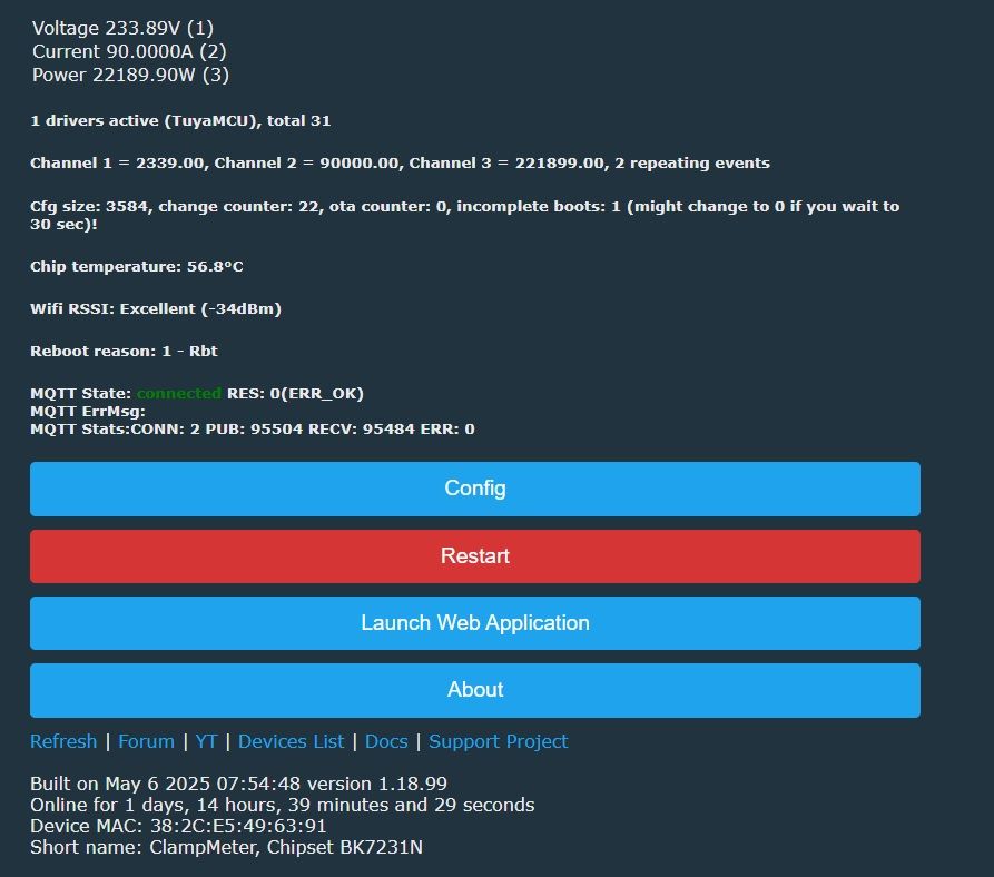

    The above script creates three channels (power, current and voltage), maps the dpID from the TuyaMCU to these channels, additionally forces a WiFi state of 0x04 (we simulate a connection to the cloud) and additionally periodically sends a state refresh request to provide us with the most recent measurements.
    Result:
    Screenshot of the OpenBK7231N control panel.
    NOTE - without default WiFi state 0x04, at first the LED on the device was red and then flashing, but the device would not give measurements. After setting the default WiFi state to 0x04 this diode went off and the measurements appeared.

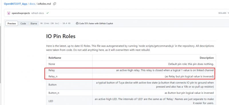

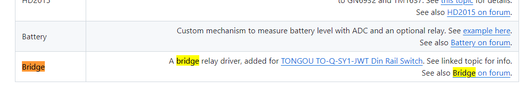

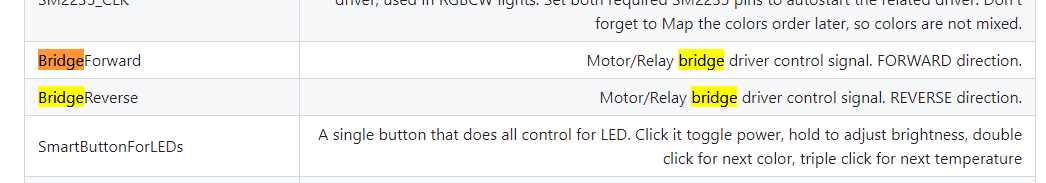

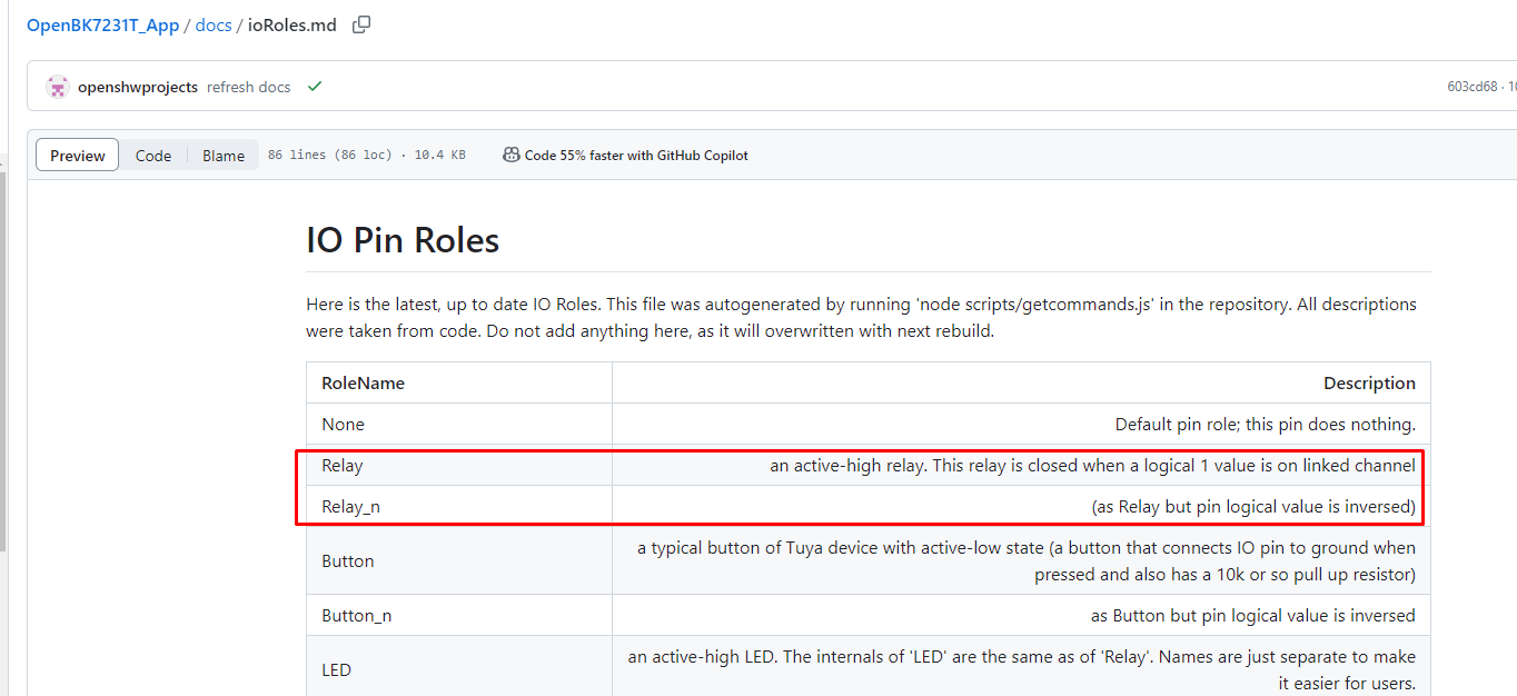

    gregor_pn wrote:
    In this particular switch is a bistable relay controlled by GPIO 24 and 26 alternating + o - depending on what state you want. I had a configuration with something that held the state by holding power on this input and hence the problem.
    There is a driver for this:
    https://github.com/openshwprojects/OpenBK7231T_App/blob/main/docs/drivers.md
    Fragment of a table highlighting the Bridge option related to a relay driver.
    The appropriate GPIO roles must be set:
    https://github.com/openshwprojects/OpenBK7231T_App/blob/main/docs/ioRoles.md
    Fragment of documentation with a list of GPIO roles and their descriptions.

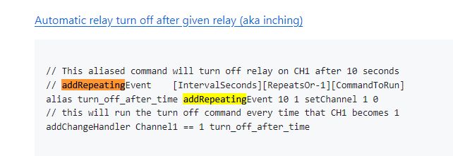

    gregor_pn wrote:
    How to force it to momentarily just give a pulse to the corresponding GPIO when a button is pressed (programmatically from the menu too)?
    If you want to script manually then you have examples here;
    Screenshot with an example script for automatically turning off a relay after a specified time.
    gregor_pn wrote:
    what the difference between Rel and Rel_n is.... well I had to guess what the author meant. ;)
    The explanation is here:
    Screenshot showing GPIO pin roles documentation in OpenBK7231T.

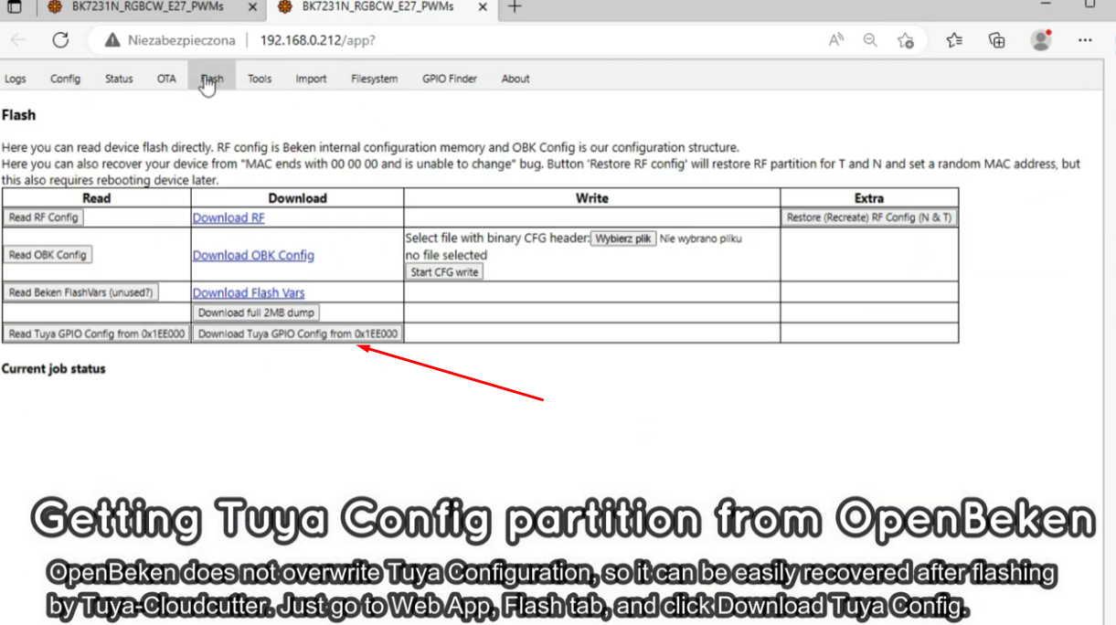

    But wait, after all, Tuya's JSON is not lost after uploading the firmware. He is there all the time, even after uploading OpenBeken. Unless you performed on chip erase all ?
  • #8 21078689
    gregor_pn
    Posts: 110
    Help: 16
    Rate: 30
    If you can tell me how to download it I will be happy to do so.
    I have not done EraseAll
  • #9 21078739
    Posts: 14655
    Help: 655
    Rate: 12662

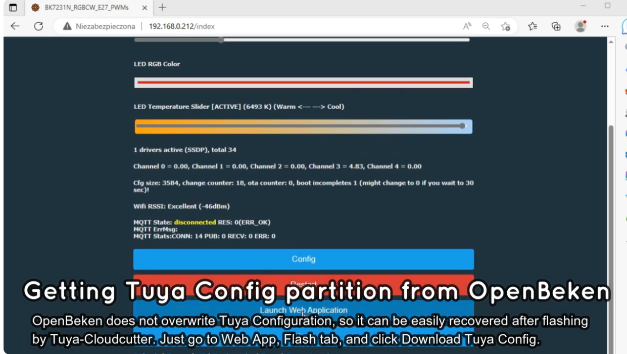

    can you show me the JSON of Tuya from this device? Instructions: https://www.youtube.com/watch?v=WunlqIMAdgw&ab_channel=Elektrodacom
    OpenBeken software interface for configuring LED RGB settings. Screenshot of the OpenBeken panel showing the Flash section with an option to download Tuya config. .

    I have a PJ-1103 and i managed to screw it up. Maybe you can help me recover it.
    First I made a backup of the original tuya firmware using your nice software flasher.
    Then I flashed the latest openbk firmware, then I manually ("Execute custom command" menu) run each line of code from your script. Because I then got weird values reported, (only the voltage was accurate, current/power was wrong, showing about 380W with no sensor connected) I decided to flash back the original firmware. It was then the moment I realized I screw something up. Even with the original firmware it would show weird values.
    Now I have on it openbk firmware but only the voltage reading is correct. The current stay at a fixed 90.0000A ! (current sensor is connected)
    Is there a change to repair this device?
    PS: I'm a newbie at this.
  • #21 21546985
    Posts: 14655
    Help: 655
    Rate: 12662
    The script should be put in autoexec.bat , not just ran once via command line. If you ran it via commandline and reboot, then it won't run again after reboot. It has to be in autoexec.bat, because autoexec.bat is automatically run after each reboot. So, for a start, please try putting our script in autoexec.bat, then save, then do full power off and power on, and then check how your device behaves.

    Hello mister p.kaczmarek2.
    Thank for your reply. I forgot to mention that at this time I have the script in autoexec.bat
    this is in my script:
    PowerSave 1
    startDriver TuyaMCU
    // dpID 18 is current * 0.00001
    This is the homepage of the device:
    Control panel of a ClampMeter device showing voltage, current, and power measurements.

    So probably your piece has different dpIDs for current and power. You need to connect a known load, like 60W bulb, and then use tuyaMcu_sendQueryState to query all dpIDs, and then manually check each value and guess which dpID may be current, which may be power, etc.
