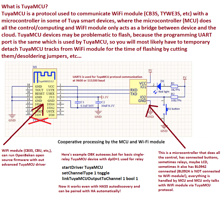

How do I map the PJ-MGW1103 CT-clamp meter’s TuyaMCU datapoints and interpret the BL0942/CB2S connections?
This meter is best treated as a TuyaMCU device: the Wi‑Fi module talks to a separate MCU over UART, and the BL0942 is not directly driven by the Wi‑Fi chip, so OpenBK should use the TuyaMCU driver rather than the BL0942 driver [#20590482][#20591181][#20527903] For the original single-clamp captures, the working readings were dPID 20 = voltage, dPID 19 = power, and dPID 18 = current, with the Tuya app’s “maximum power” setting being sent to the MCU as a configuration value rather than just a UI-only percentage [#20527903] For later working OpenBK configs, users reported that 9600 baud was required on some units, sometimes with the CEN/reset trace disconnected to stop the MCU from resetting the Wi‑Fi module [#21429711] A full two-clamp mapping was posted: voltage on dPID 112, current on 113/114, power on 101/105, frequency on 111, power factor on 110/121, energy on 106-109, plus calibration/reporting DPs on 116-129 [#21041947][#21114187] If you want faster updates, the MCU can be polled with `tuyaMcu_sendQueryState`, and the reporting rate itself is exposed as dPID 129 [#20882643][#20882899][#21114187]

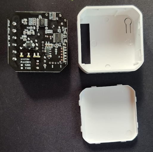

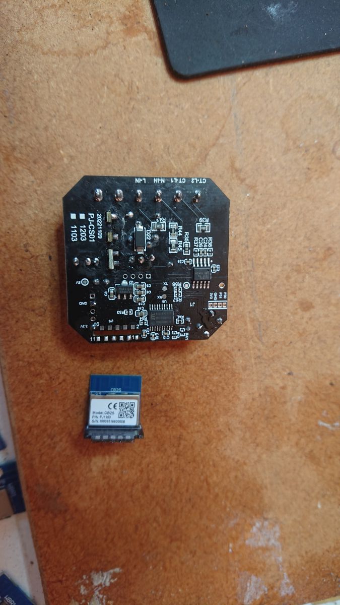

    Teardown of this energy meter from AliExpress.
    Exploring the Inner Workings of PJ-MGW1103 CT-Clamp Energy Meter: Tuya, BL0942, CB2S Components

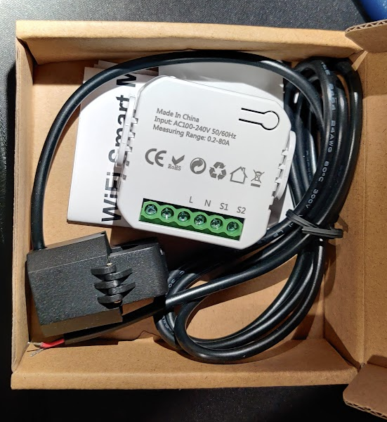

    The device comes with CT clamp:
    The back of the plastic case is secured with some small plastic tabs; it was removed easily with a small blade:

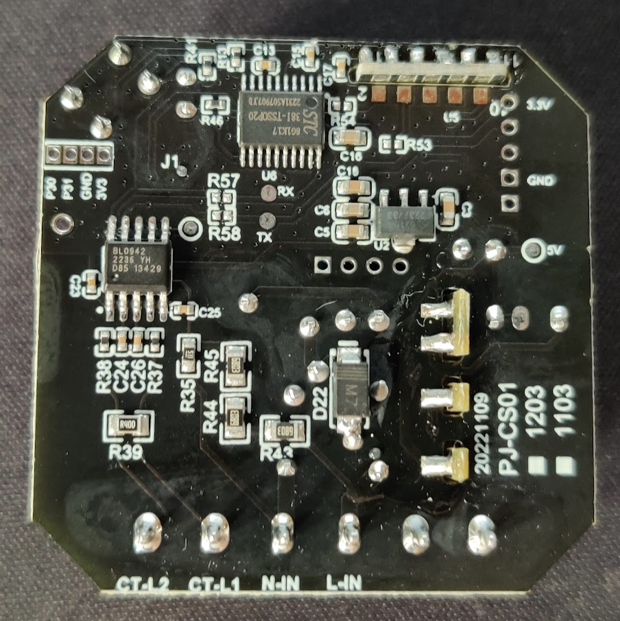

    The main board with Tuya and BL0942 visible:

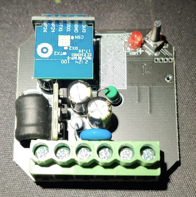

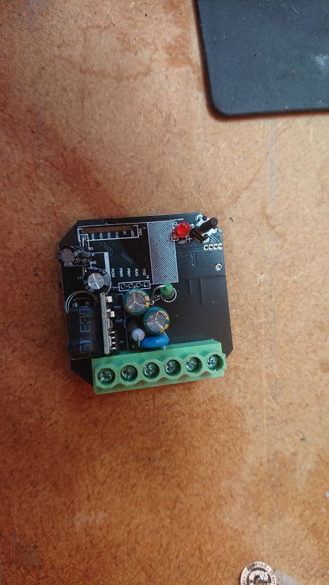

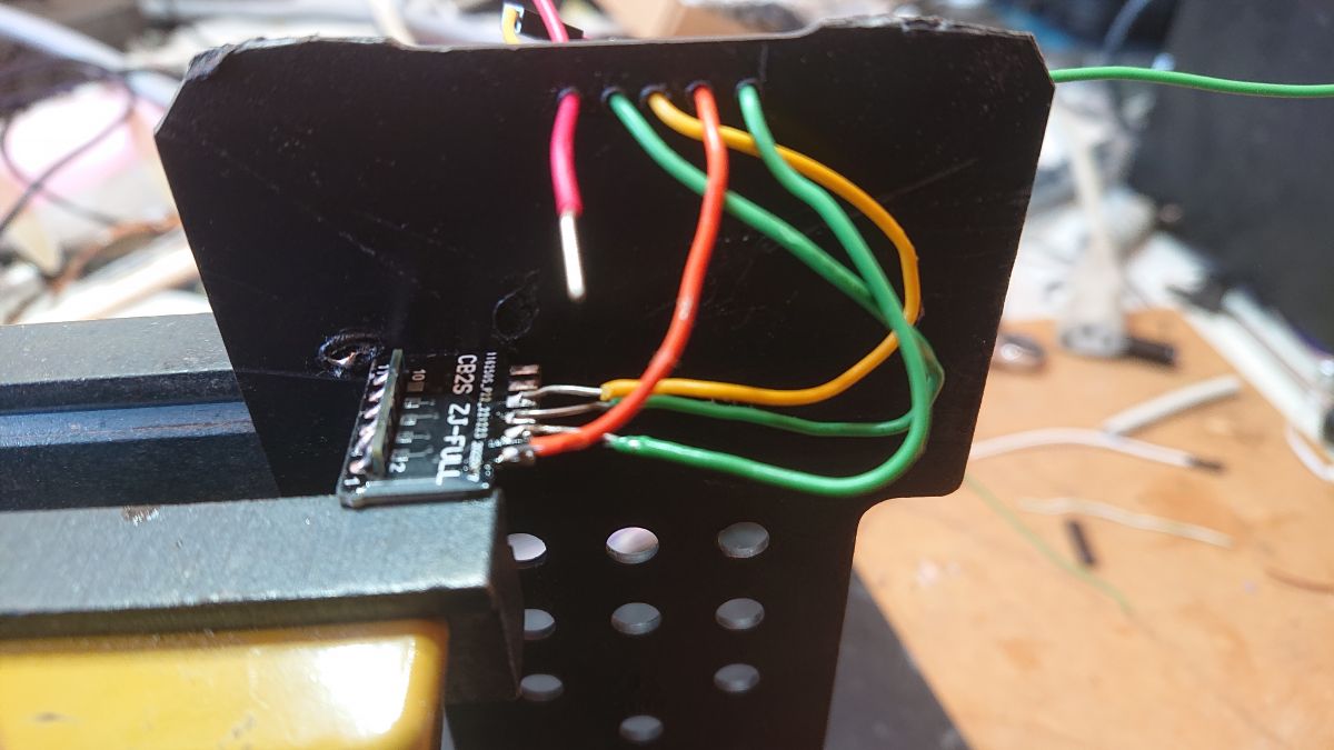

    Reverse side with CB2S and power electronics visible. There is also a push button and a light:
    The push button and LED are both connected to the Tuya.
    The only signals from the CB2S to the mainboard are TX/RX, and also P24 + P26. I can't find the function of P24/26, I suspect they're only soldered to secure the chip in place.
    Here is a recording of the Tuya comms:
    BAUD: 115200

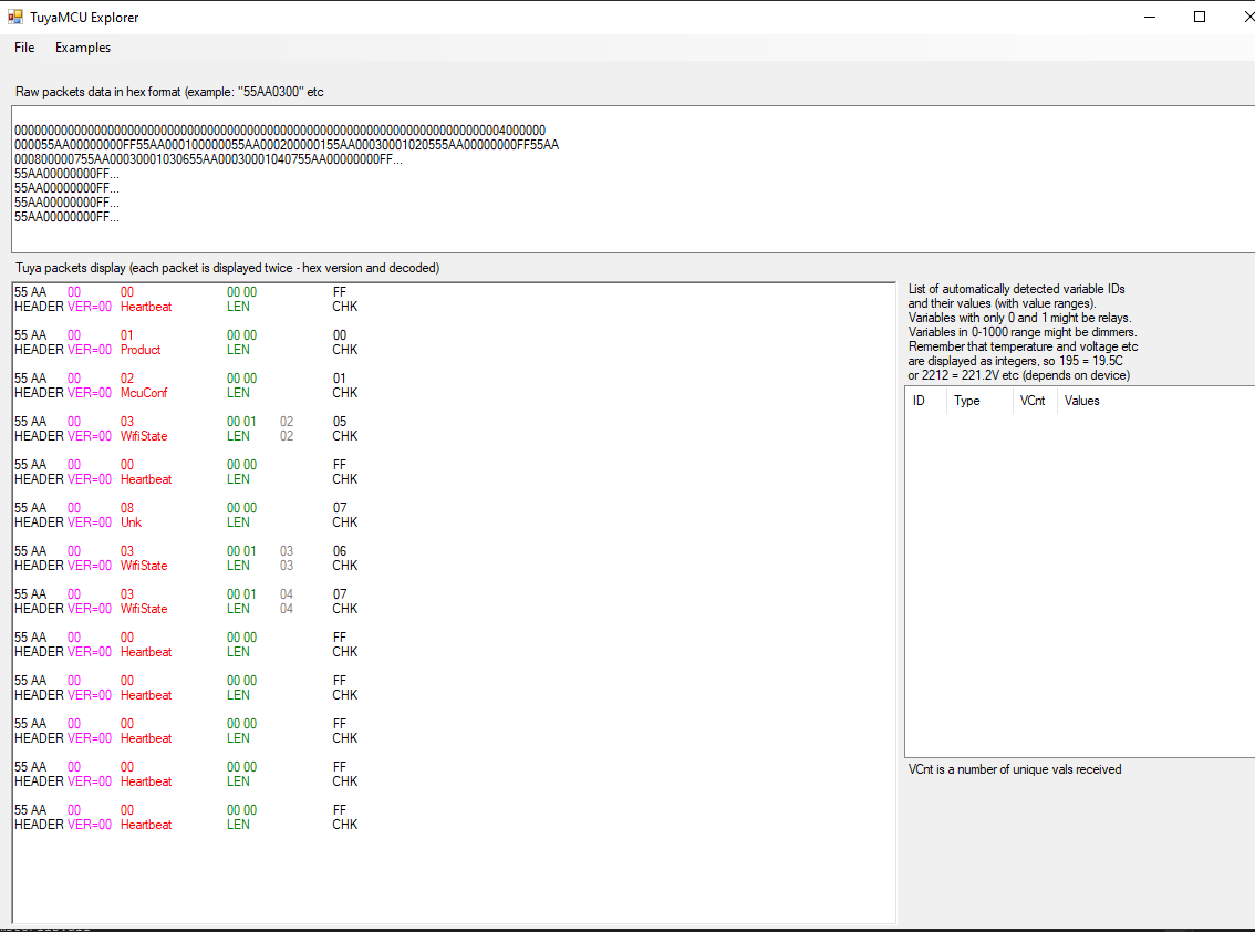

    TX:
    00000000000000000000000000000000000000000000000000000000000000000000000004000000
    000055AA00000000FF55AA000100000055AA000200000155AA00030001020555AA00000000FF55AA
    000800000755AA00030001030655AA00030001040755AA00000000FF...
    55AA00000000FF...
    55AA00000000FF...
    55AA00000000FF...
    55AA00000000FF...

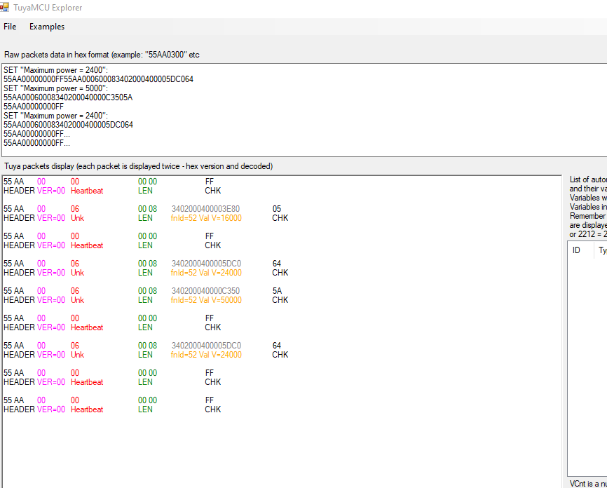

    SET "Maximum power = 1600":
    55AA00000000FF55AA000600083402000400003E8005
    SET "Maximum power = 2400":
    55AA00000000FF55AA000600083402000400005DC064
    SET "Maximum power = 5000":
    55AA00060008340200040000C3505A
    55AA00000000FF
    55AA00000000FF...
    55AA00000000FF...
    The stock software allows one configuration detail, it has "Set maximum power" and you choose a value in watts, and the software will then show the current power draw as a percentage of that value.
    Surprisingly, this isn't just a UI detail in the app; when changing the maximum power value, data is transmit to the Tuya for reasons I can't guess... perhaps it performs the calculation internally and returns the percentage to the wifi module to transmit?
    Decoded Tuya UART dump and identified likely power and voltage registers

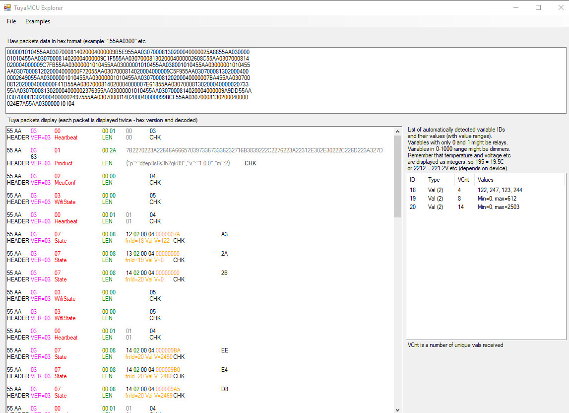

    Thanks, that's like a late Christmas, your teardowns are great and very useful, I love analyzing those packets.
    Let's see what we've got here:
    BAUD: 115200
    Energy readings approx:
    248-250V 0.1A ~60.8W
    RX:
    000000000000000000000000000000000000000000FF0000FC000055AA03000001000355AA030100
    2A7B2270223A22646A66657039733673336232716B3839222C2276223A22312E302E30222C226D22
    3A327D6355AA030200000455AA030300000555AA03000001010455AA03070008120200040000007A
    A355AA0307000813020004000000002A55AA0307000814020004000000002B55AA030300000555AA
    030300000555AA03000001010455AA0307000814020004000009BAEE55AA03070008140200040000
    09B0E455AA0307000814020004000009A5D855AA03000001010455AA03000001010455AA03070008
    14020004000009AFE355AA0307000814020004000009BFF355AA0307000813020004000002608C55
    AA03000001010455AA0307000814020004000009B9ED55AA0307000814020004000009C7FB55AA03
    000001010455AA0307000814020004000009B5E955AA03070008130200040000025A8655AA030000
    01010455AA0307000814020004000009C1F555AA0307000813020004000002608C55AA0307000814
    020004000009C7FB55AA03000001010455AA03000001010455AA038001010455AA03000001010455
    AA0307000812020004000000F72055AA0307000814020004000009C5F955AA030700081302000400
    0002649055AA03000001010455AA03000001010455AA03070008120200040000007BA455AA030700
    0812020004000000F41D55AA0307000814020004000007E61855AA03070008130200040000020733
    55AA0307000813020004000002376355AA03000001010455AA0307000814020004000009A9DD55AA
    0307000813020004000002497555AA03070008140200040000099BCF55AA03070008130200040000
    024E7A55AA030000010104
    ID 18 has values 122, 247, 123, 244 - idk what's that
    ID 19 is from 0 to 612, isn't it power divided by 10? The bad thing is that you turned off power and I am not sure... but most likely it's power
    ID 20 from 0 to 2503... voltage? Again, not sure why is there a 0?
    Here is a decoded dump:
    Spoiler:
    55 AA 03 00 00 01 00 03
    HEADER VER=03 Heartbeat LEN 00 CHK

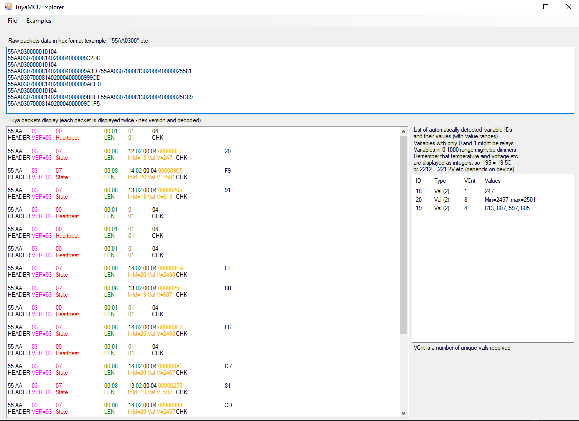

    incremental reports (few seconds apart):
    55AA030000010104
    55AA0307000812020004000000F72055AA0307000814020004000009C5F955AA03070008130200040000026591
    55AA030000010104
    55AA030000010104
    55AA030000010104
    55AA0307000814020004000009BAEE55AA03070008130200040000025F8B
    55AA030000010104
    55AA0307000814020004000009C2F6
    55AA030000010104
    55AA0307000814020004000009A3D755AA03070008130200040000025581
    55AA030700081402000400000999CD

    Well, ID 19 oscillates around 600, ID 20 between 2457 and 2501. It might confirm it's voltage and power.
    ID 18 is 247, what may that be?
    Maybe I am wrong and one of them is a current?
    Yup...
    Let's assume resistive load.
    60/250= 0.24smth
    So it's voltage, current and power. Just which one is which.
    TX:
    55AA00000000FF...
    55AA00000000FF...
    55AA00000000FF...
    55AA00000000FF...
    Mostly nothing
    55AA00000000FF
    55AA00000000FF...
    55AA00000000FF...
    Ok, now what is that?
    It sets fnID 52 to 16000, then 24000, then 50000, then 24000 again.. I can't see anything else happening here.
    Do we need a relay control as well?
    So far, we have found a current, a voltage and power channels.
    I also need a test with a 120W load or 30W load because... I am not sure which one is current and which one is voltage.
    Or maybe we can guess by precision?

    #3 20365414
    TurkeyMan
    Posts: 59
    Rate: 9
    Yes, I bought a 60W incandescent light bulb for testing these with a resistive load :)
    I think the voltage was high today, ~250V, high sun, lots of solar. I guess the small number was current?
    I don't know why the SmartLife app reported current as 0.1A, because it's a resistive load, and as you show, 60/250 = 0.24.
    So, 18 is mA, 19 is W*10, 20 is V*10? Seems plausible, except those early readings of ~120mA aren't right...
    What's odd here is that it doesn't seem to report cumulative Wh... which means you can't measure energy... slow poll rates will miss high frequency fluctuation, and the total energy will accumulate error.
    Maybe it's reporting energy since the last poll? Maybe that's why 18 is jumping 122, 247, 123, 244? Maybe the report rate is not perfectly regular?
    Hmmm, okay, so 60Wh/hr == ~0.016Wh/second. Those messages are reported a few seconds apart... maybe there's a scaling factor that makes that make sense...? Maybe you sum them for total energy consumption?
    There's no relay in this device. It's just a meter... and as a dedicated meter, I'm really surprised it doesn't accumulate kWh internally for accurate energy reporting!
    On the TX line; "mostly nothing" except that `08` packet... any idea? Doesn't look important, but you don't seem to have a record of that packet type in your software...
    I have no idea what fnId 52 is supposed to be for! How will we configure items of configuration, to expose values that will be transmit to the mcu?
    For instance, I feel like a quality configuration for this device will create an integer value called "Maximum power", given some bounds like 0-80000, and then transmit the value to Tuya if the user changes it. Can we do that now?
    It's something for initialization, but we have logs saved so I don't worry about it now:
    Command Word Description
    0x00 Heartbeat detection.
    0x01 Query product information.
    0x02 Query the working mode of the Wi-Fi module.
    0x03 Report the network connection status of the device.
    0x04 Reset the Wi-Fi module and switch the network configuration mode.
    0x05 Reset the Wi-Fi module and select a network configuration mode.
    0x06 Deliver DP commands.
    0x07 Report DP status.
    0x08 Query the device initialization status.
    0x0a (Optional) Start OTA upgrade.
    0x0b (Optional) Transmit the OTA upgrade package.
    0x1c (Optional) Obtain the local time.
    0x0e Test the Wi-Fi function (product testing command)
    You can map any OpenBeken to any TuyaMCU dpID. You can then set this channel with "setChannel 15 80000" command and driver will automatically forward the value to TuyaMCU.
    OpenBeken doesn't need to know the exact channel meaning, it's flexible, it just forwards data. It's designed to be scriptable.
    I have also attached the original Tuya firmware for reference.
    • readResult_BK7231N_QIO_2023-25-2--15-45-37.zip (1.04 MB) You must be logged in to download this attachment.

  • Suggested OBK autoexec for TuyaMCU setup
    #16 20528771
    Posts: 14791
    Rate: 12937
    Okay, it seems you're an OBK beginner. So, you should start with the following autoexec:
    startDriver TuyaMCU
    tuyaMcu_setBaudRate 115200
    tuyaMcu_defWiFiState 4
    The baud rate setting was taken from one of the posts above. If you read the topic carefully, you will see a report about baud rate 115200 used there.
    The default WiFi state makes device think (TuyaMCU device) it is always paired.
    Okay, please try this autoexec and give log again, so we can check if you are receiving something

    #18 20528897
    Posts: 14791
    Rate: 12937
    As you can see, you are receiving the data now. Now you need to figure out the correct interpretation for dpIDs.
    So now you should see our docs:
    https://github.com/openshwprojects/OpenBK7231T_App/blob/main/docs/README.md
    and see channel types.
    And update your autoexec:
    startDriver TuyaMCU
    setChannelType 2 Voltage_div10
    setChannelType 3 Power_div10
    // linkTuyaMCUOutputToChannel dpId variableType tgChannel
    //ch 2(dpid 20) voltage
    linkTuyaMCUOutputToChannel  20 1 2
    //ch 3(dpid 19) power watts
    linkTuyaMCUOutputToChannel 19 1 3
    Now save this, and reboot, and you should get voltage and power reading, assuming that the dpIDs are correct. Can you check?
    There is much more to read, but we need to guess dpIDs.

  • BL0942 data goes through TuyaMCU, not WiFi
    #23 20590482
    Posts: 14791
    Rate: 12937
    mfmoro wrote:
    Yup. Is there a way to send the full serial output to mqtt so I can dump it easily for long time?
    Nope, but we can try to add something like that. Currently Web App log is a way to go.
    elektradi wrote:
    1. Need to cut any PCB tracks to flash it?
    Most likely yes.
    elektradi wrote:
    2. Does it help look at tasmota's code for BL0942?
    We have very good BL0942 driver, but it is not used here. BL0942 is not connected to WiFi module. It connects to TuyaMCU. This is TuyaMCU device, and we have TuyaMCU support, so everything comes down to decoding dpIDs so we can receive data and display it on GUI and forward to MQTT.
  • #24 20591051
    elektradi
    Posts: 21
    I'm confused. There are:
    1. MCU
    2. BL0942
    3. Wifi module? What is this? Isn't the wifi module part of MCU?
    @mfmoro can share how you flashed? Desolder?
  • #25 20591065
    mfmoro
    Posts: 7
    Yes I desoldered the pad between the main board and the vertical pass-through board and soldered the rx, tx, gnd and 3V3 to a serial board to program it.
    You don't need to detach the board only desolder it.
  • #26 20591130
    Posts: 14791
    Rate: 12937
  • Asking whether CB3S contains both MCUs and BL0942 link
    #27 20591161
    elektradi
    Posts: 21
    @elektradi TuyaMCU devices have two separate "brain", one is WiFi module, second is an extra MCU:
    https://developer.tuya.com/en/docs/iot/tuya-c...-serial-port-access-protocol?id=K9hhi0xxtn9cb
    I see. Thank you for the clarification!
    I just to make this work first, are the TuyaMCU and wifi module both on that tiny detachable CB3S module?
    If I replace CB3S with an ESP8266, does it the ESP8266 talk directly to the BL0942?
  • TuyaMCU is the STC chip, BL0942 can be wired directly
    #28 20591181
    Posts: 14791
    Rate: 12937
    TuyaMCU is the STC chip here:
    There is no need to remove anything, but if you really don't want to use TuyaMCU protocol, you can remove the MCU and wire BL0942 directly to CB3S and use OpenBeken.
    OpenBeken can emulate Tasmota features very well, most of the commands and JSON format are compatible, Tasmota device groups are also compatible, so you get ioBroker, etc compatibility out of the box.
