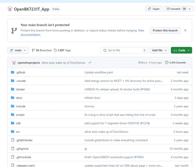

1. Preparing workflow

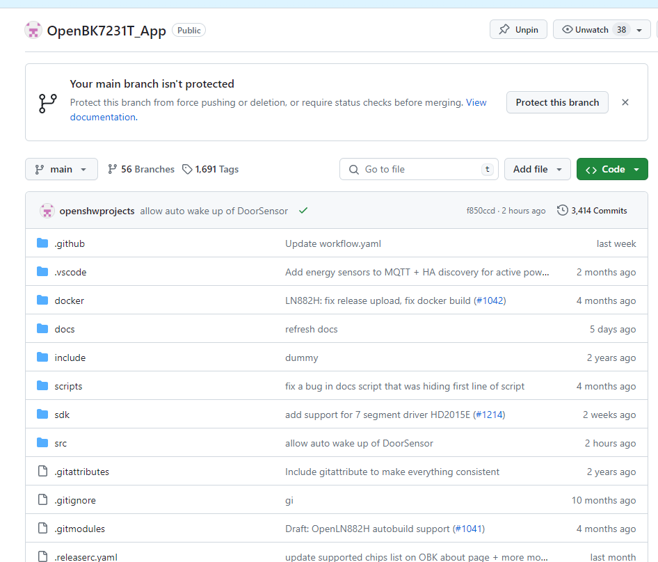

Ok, so first go to our repository on Github:
OpenBK7231T_App repository page on GitHub.

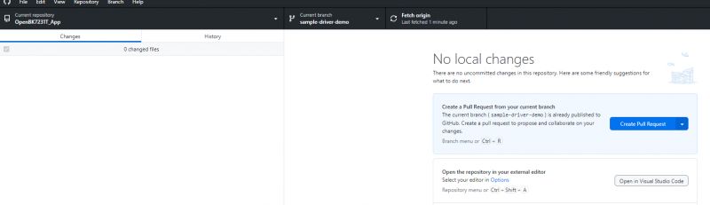

Make a fork and open a pull request like you would usually do. It's easiest to do it with Github gui. If you are not sure how, check the Git documentation and tutorials.
Screenshot showing the Github Desktop interface with the OpenBK7231T_App repository open.
This will allow you to get online builds in PRs:
https://github.com/openshwprojects/OpenBK7231T_App/pulls
Once your PR is accepted, you will be able to get binaries for all platforms as described in:

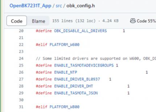

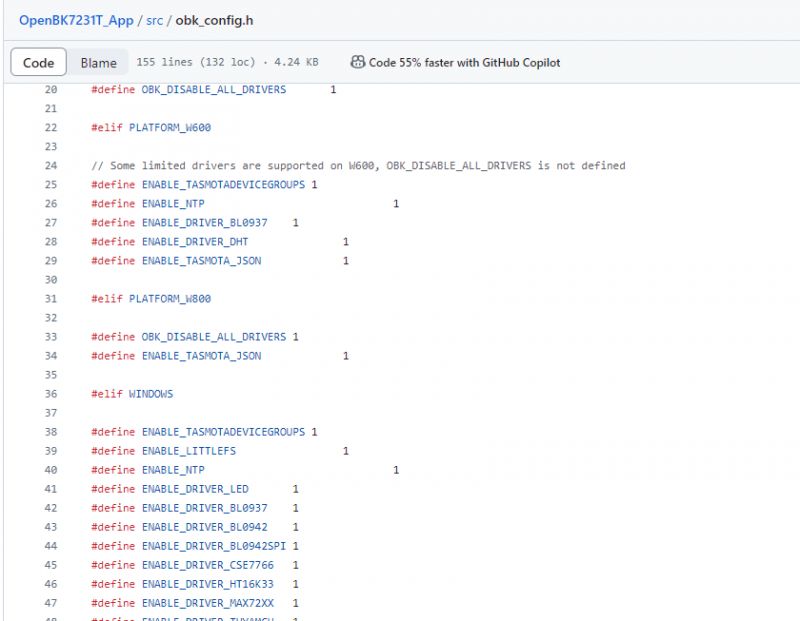

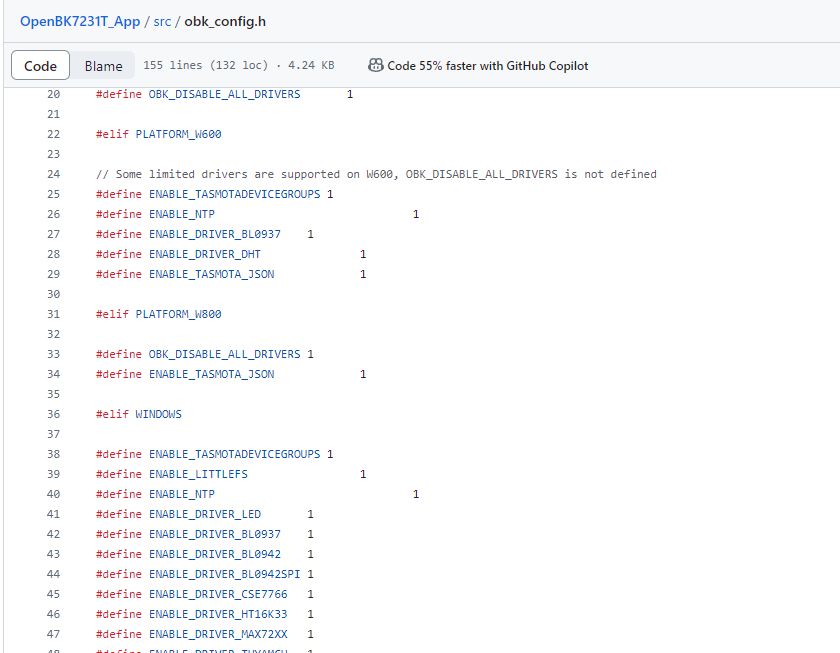

2. Preprocessor define for a driver
All drivers should have a #define in obk_config.h:
https://github.com/openshwprojects/OpenBK7231T_App/blob/main/src/obk_config.h
This allows us to turn them on and off for each platform.

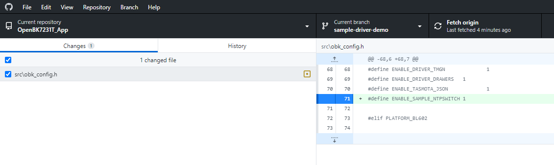

Let's create a define for our driver. Let's say that I will be developing it on Windows Simulator for now. So, in the #ifdef WINDOWS section, let's add our own new define:
Screenshot of the obk_config.h file from the OpenBeken repository on GitHub.
Our diff so far:
Screenshot of a code editor showing a change in the obk_config.h file

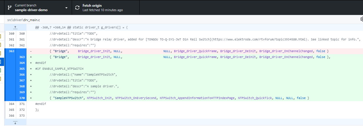

3. Main drivers table entry
Now let's modify drv_main.c:
https://github.com/openshwprojects/OpenBK7231T_App/blob/main/src/driver/drv_main.c
We need to add an entry to drivers array. Whole entry should be in preprocessor block. We also need to fill the documentation entries.
Screenshot of a code editor showing modifications in the `drv_main.c` file, where an entry for the new driver `SampleNTPSwitch` has been added.
A driver has:
- name
- init function
- every second update function
- quick tick update function
- http index display function
- and some other less often used functions, like shutdown function or channel change callback.
So next we can create those function in separate new file and add their declarations to drv_local.h

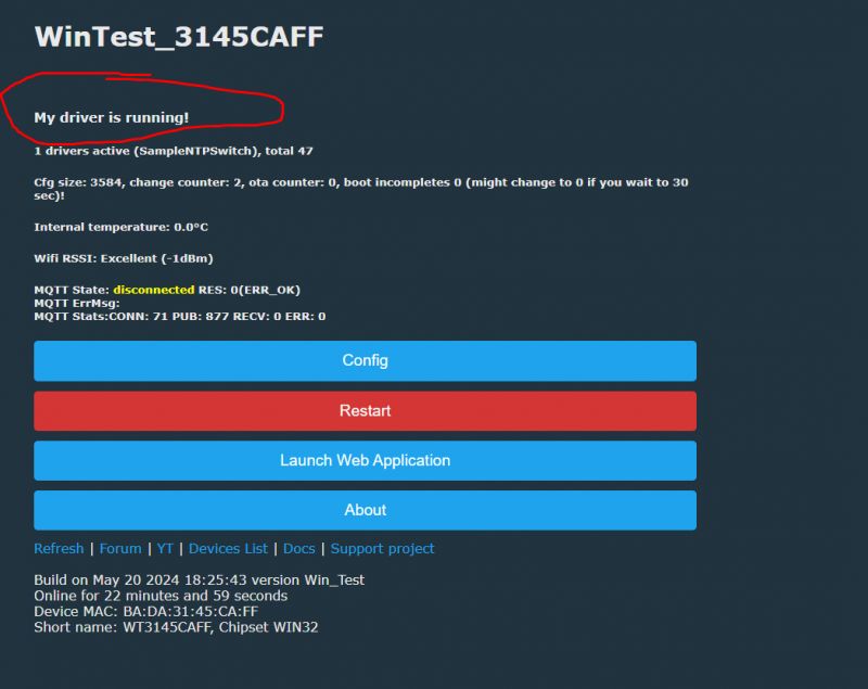

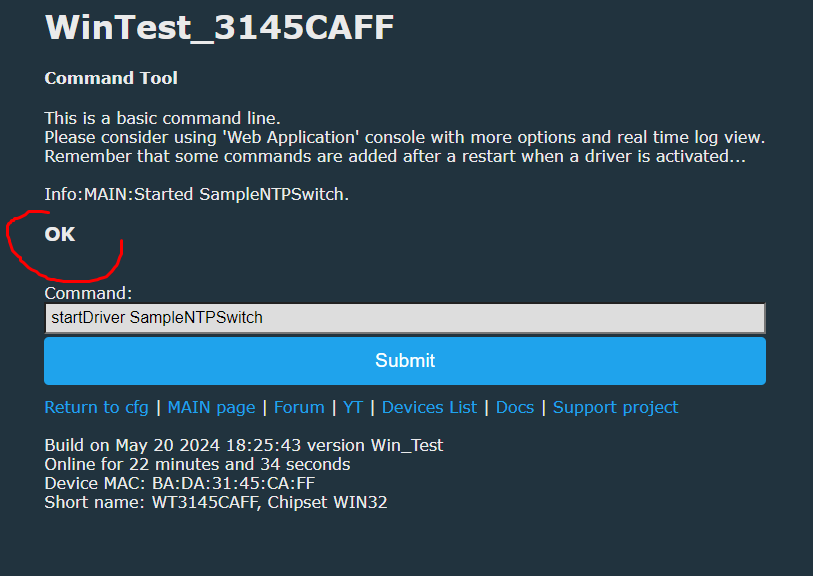

Let's build and flash firmware for our chosen platform and try starting the driver:
startDriver SampleNTPSwitch
You should get "OK" reply:
Command tool panel with startDriver SampleNTPSwitch command and OK message

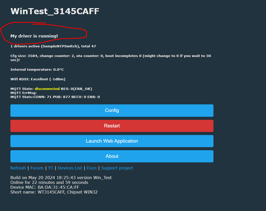

You should also get text on main panel:
A webpage displaying My driver is running! at the top with several buttons at the bottom.

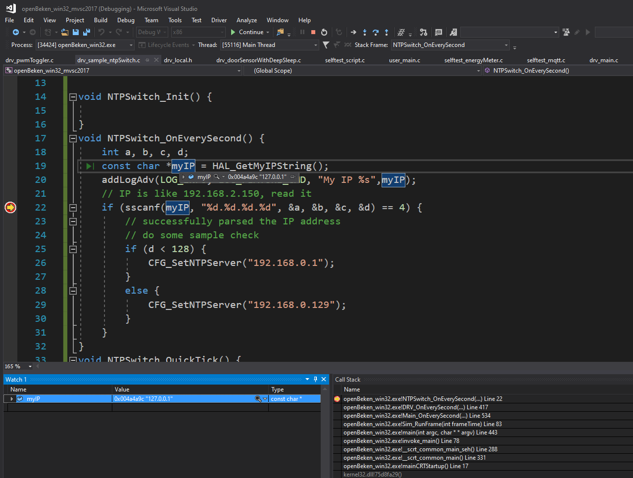

6. How to debug drivers (on Windows)?
OpenBeken can run on Windows, along with device simulator.
So if you run our MSVC projects, you can put breakpoints in drivers:
Screenshot of Visual Studio with OpenBeken driver source code
This way you can:
- see variable values
- see current call stack
- pause or resume execution, also manually step in/out the calls
This can substantially reduce your testing and development time.

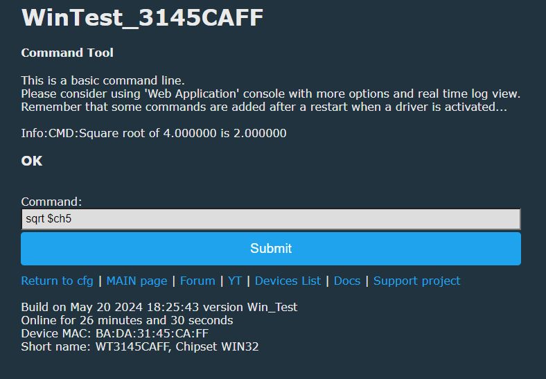

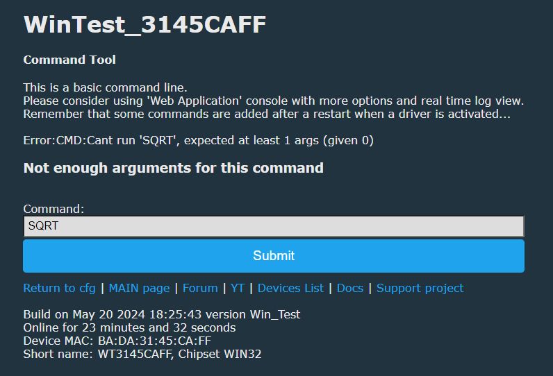

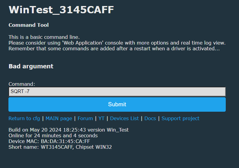

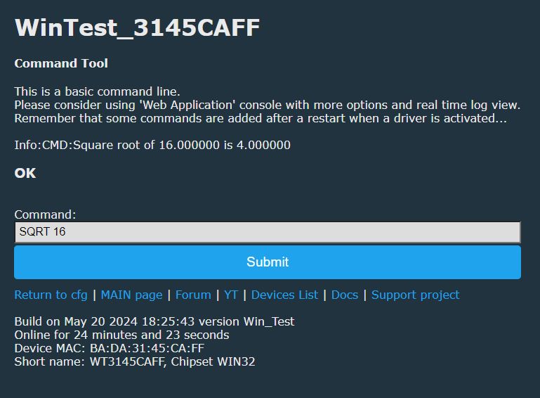

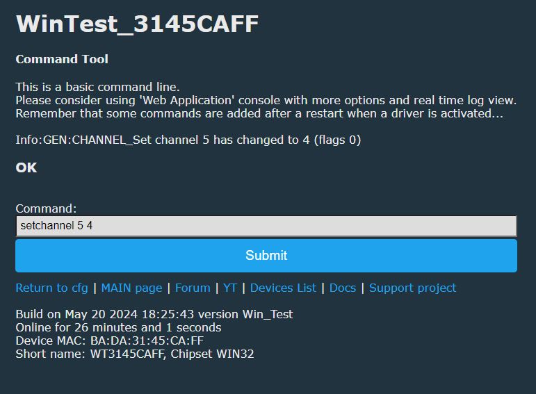

7. How to make drivers scriptable?
The best way is to use console commands. Console commands can be invoked via autoexec.bat, HTTP interface or even by MQTT. Creating a new command is very simple:
Code: C / C++
This way you cam get a console/script command with a full arguments testing.
Screenshot of a command entry tool with an error
Command Tool interface displaying Bad argument error message.
Screenshot of command tool WinTest_3145CAFF showing the result of the SQRT 16 command.
Of course, channel value can be also used as an argument.
Screenshot showing the WinTest command tool with a sample command.
Command tool interface for WinTest_3145CAFF

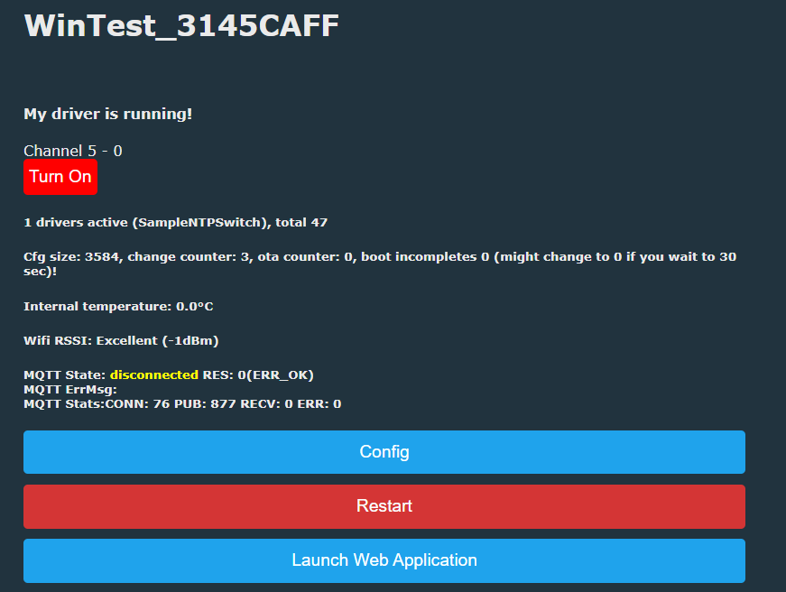

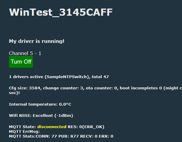

9. How to make custom Web page interface?
Per-driver main HTTP page callback can be used also to get user input. You can easily create HTML forms that way. For this example, I will create a simple button that will just toggle the channel 5:
Code: C / C++
Clicking the button toggles channel 5 value:
Screenshot of the OpenBeken user interface with a sample driver.
Custom driver SampleNTPSwitch running on WinTest_3145CAFF
