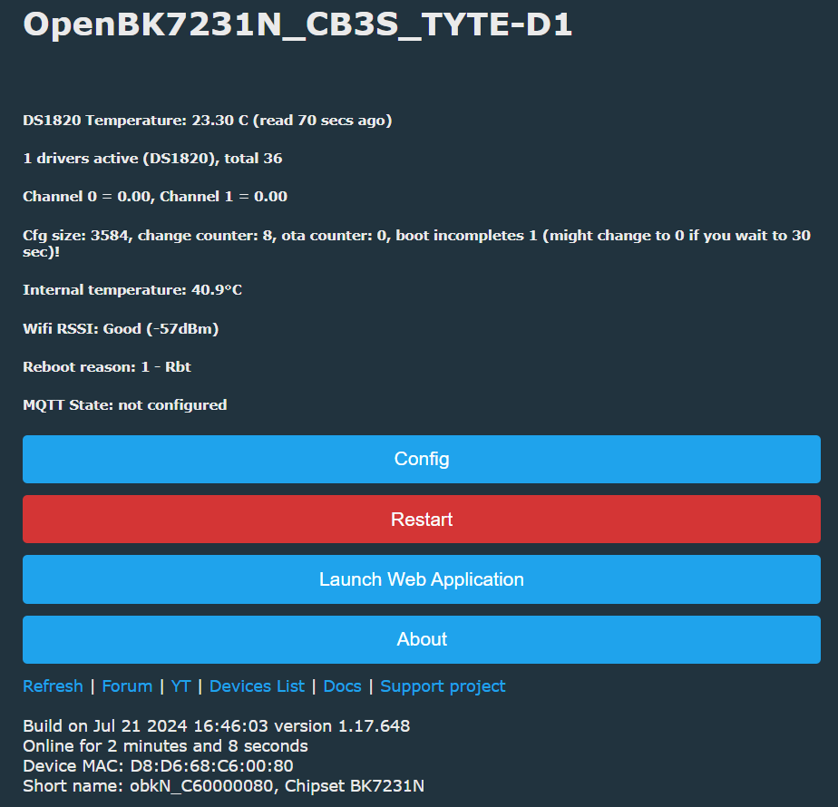

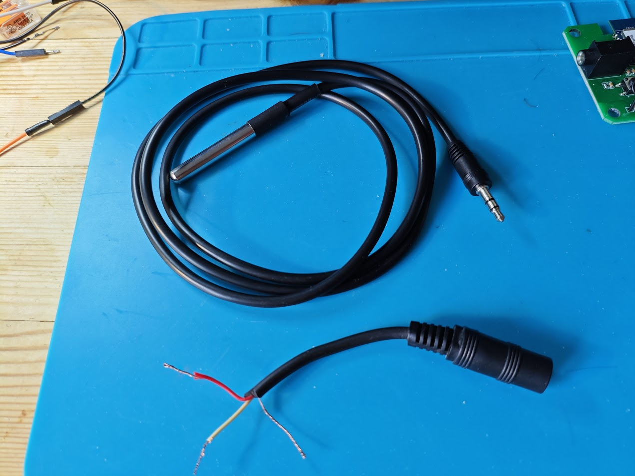

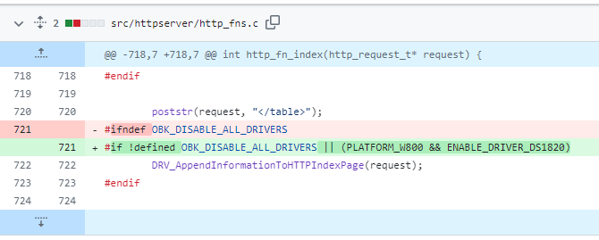

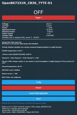

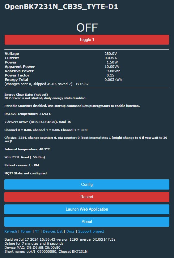

  • usleep2 workaround enables DS1820 readings on BK7231N, W800, LN882H
    #13 21154775
    max4elektroda
    Posts: 758
    Help: 49
    Rate: 189
    Since I was working on this some month ago (and didn't get it to work) I also played with this.
    So I am quite a big distance behind this full approach, but also a tiny bit ahead:
    I have a (very very simple) code working (after I finally found out, where my code didn't work):
    It was "usleep()" which didn't work as expected.
    I ended up in adopting the "usleep2" from DHT code for BK7231N, W800 an LN882H.
    https://github.com/MaxineMuster/OpenBK7231T_App/tree/DS1820
    With my "usleepds" I managed to get readings from the three devices I own (BK7231N, W800 an LN882H).
    O.k., I had to do some ugly stuff to get a driver working with W800 (with "#define OBK_DISABLE_ALL_DRIVERS"), too ;-)
    This is how it looks like (define pin in config page and then start driver:
    Info:MAIN:Time 234, idle 195090/s, free 64024, MQTT 0(14), bWifi 1, secondsWithNoPing 1, socks 3/38
    Info:MAIN:Time 235, idle 386760/s, free 75720, MQTT 0(14), bWifi 1, secondsWithNoPing 1, socks 2/38
    Info:CFG:DS1820 - asked for conversion - Pin 11
    Info:MAIN:Time 236, idle 196018/s, free 75720, MQTT 0(14), bWifi 1, secondsWithNoPing 1, socks 2/38
    Info:CFG:DS1820 - Pin=11 temp=+24.31
    Info:MAIN:Time 237, idle 192953/s, free 75504, MQTT 0(15), bWifi 1, secondsWithNoPing 1, socks 3/38
    Info:MAIN:Time 238, idle 191097/s, free 64024, MQTT 0(15), bWifi 1, secondsWithNoPing 1, socks 3/38
    Info:MAIN:Time 239, idle 207035/s, free 75720, MQTT 0(15), bWifi 1, secondsWithNoPing 1, socks 2/38
    Info:MAIN:Time 240, idle 194557/s, free 75720, MQTT 0(15), bWifi 1, secondsWithNoPing 1, socks 2/38

  • Merged fix while skipping #ifdef and WiFi time change
    #21 21157011
    Posts: 14782
    Rate: 12920
    nops are so fast that for loop introduces extra overheat and skews the calculation.
    I will just merge current version.
    However, first I will strip this, we need to think about a better approach in the future, but it's not a top priority:
    Screenshot of a code snippet on GitHub showing a change in a preprocessor condition in the http_fns.c file.
    Added after 15 [minutes]:
    Ok merged:
    https://github.com/openshwprojects/OpenBK7231...mmit/c95eea43736902193dc877fc53a7617cc2f10853
    I skipped the #ifdef and WiFi time change

    Posts: 5222
    Help: 449
    Rate: 918
    will do. im just making a little 3.5mm jack thing so I can test on any platform
    Cable with DS1820 sensor and 3.5 mm jack on a blue mat.
    https://www.elektroda.com/rtvforum/topic4062365.html#21158223
    Added after 34 [minutes]:
    >>21158363
    im afraid it's still jumping about. ~86 degrees is a new fave to jump to
    Display of the OpenBK7231N device web interface showing operational parameters, including temperature, voltage, power, and WiFi status.
    Added after 5 [minutes]:
    ive cleared all assignments and only set DS18B20 so no BL0937 driver starts. jumps to 53 sometimes.
  • #26 21162859

  • DS1820 on pin 26 fails reset and CRC checks
    #29 21163106
    Posts: 5222
    Help: 449
    Rate: 918
    User interface of OpenBK7231N_CB3S_TYTE-D1 displaying temperature information and configuration options.
  • #30 21163116
    max4elektroda
    Posts: 758
    Help: 49
    Rate: 189
    That's not too good.
    Could you please try the output of usleepds with sensor disconnected?
    Maybe my factor won't work on your device...
    Sorry
