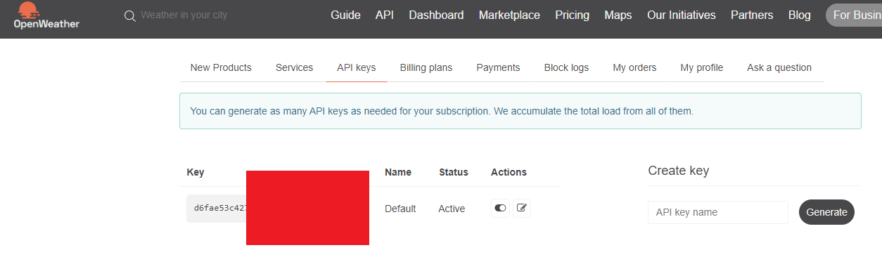

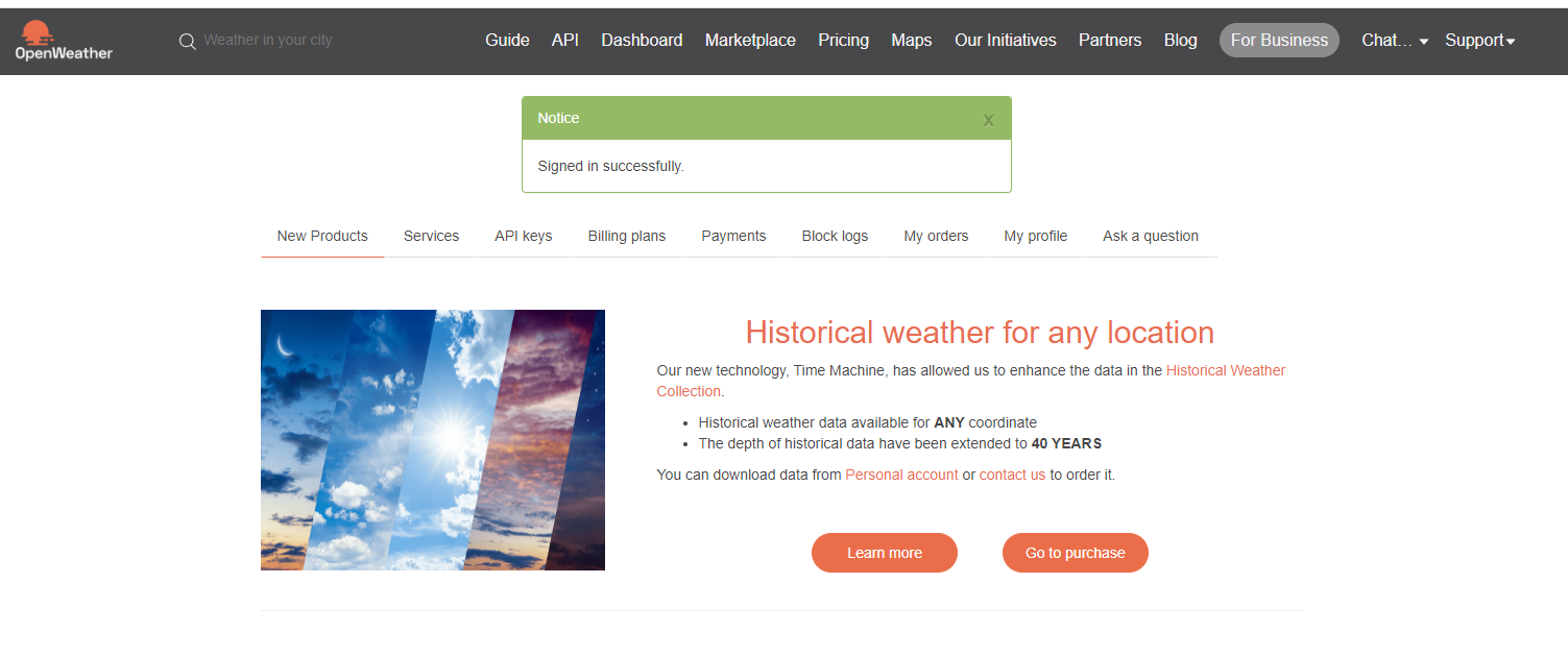

Step 2 - Registration .
So we create an account on openweathermap and according to the instructions on this page we get the API key:
Our key will be visible in the API Keys, after a while it should have a status of "Active", but this is deceptive - more on that in a moment.

It is simply that the API key, although marked as active, needs some time to "propagate" to the service provider's servers/CDN, so we just have to wait. When I did this type of project for the first time, I was heavily surprised to find the bug in-house and then find out that it was worth the wait.
Only after some time will the JSON download correctly for us:

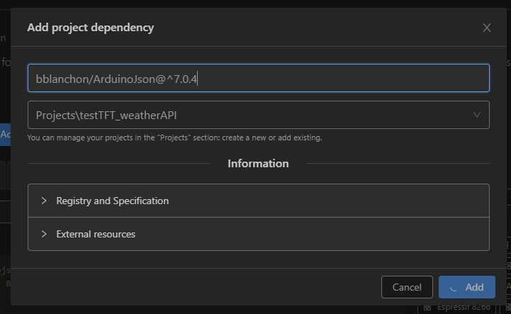

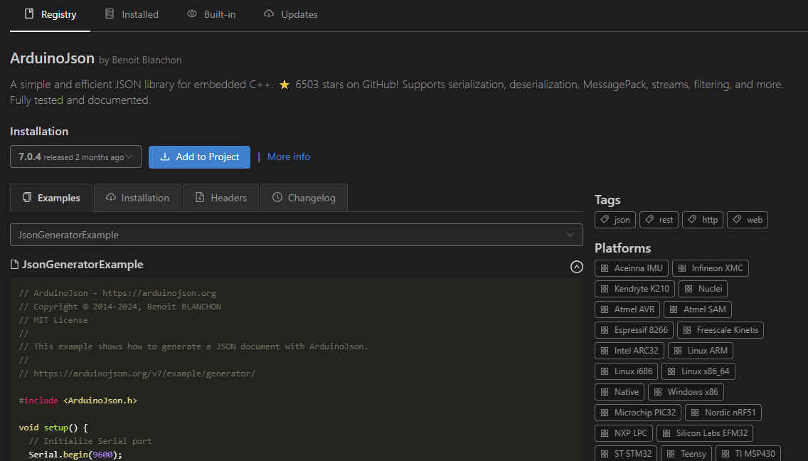

Step 4 - Arduino JSON .
Now we need to parse this text in JSON format somehow. After all, we're not going to manually write a parser that respects brackets, commas and nested objects. We have a ready-made library for this - the ArduinoJSON library, downloadable via PlatformIO:
I leave the installation itself without much comment, I have shown it in detail several times.
Now we need to convert our received text (String) into a JSON representation that is convenient to process.
We use the DynamicJsonDocument class, a class that uses heap memory, but we'll skip the details of how it works. The main thing is that it allows us to dynamically match any object and field of the received JSON text, such as "message":

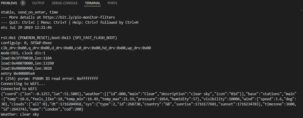

Still let's take a look at some JSON not from the documentation examples, but downloaded by me at the time of writing the code. Here is an excerpt from the console log:
{"coord":{"lon":21.0118,"lat":52.2298},"weather":[{"id":802,"main":"Clouds","description":"scattered clouds","icon":"03d"}],"base":"stations","main":{"temp":25.39,"feels_like":25.11,"temp_min":22.44,"temp_max":27.19,"pressure":1010,"humidity":43},"visibility":10000,"wind":{"speed":3.09,"deg":230},"clouds":{"all":40},"dt":1716205773,"sys":{"type":2,"id":2032856,"country":"PL","sunrise":1716172416,"sunset":1716229901},"timezone":7200,"id":756135,"name":"Warsaw","cod":200}
Weather: scattered clouds

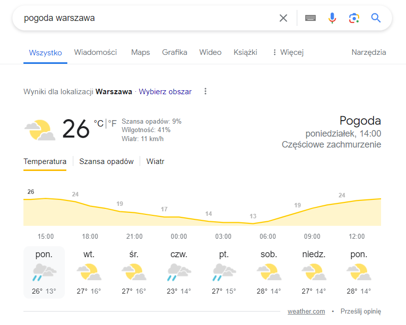

And let's compare with the result from Google:
It more or less agrees. The system works!
