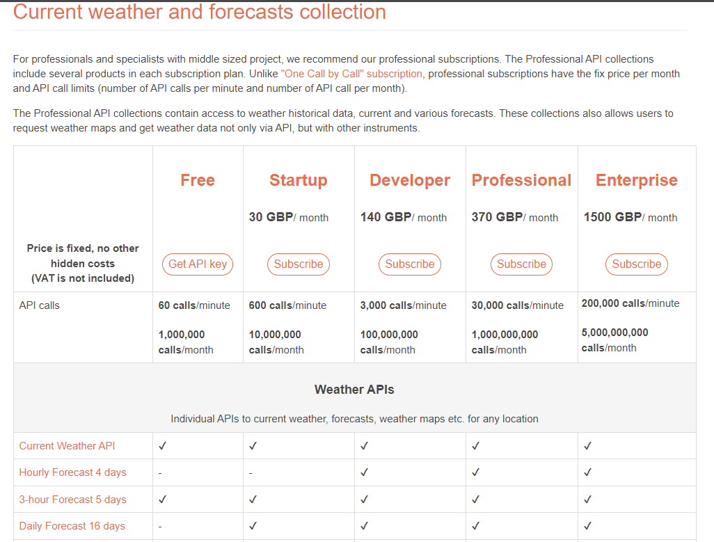

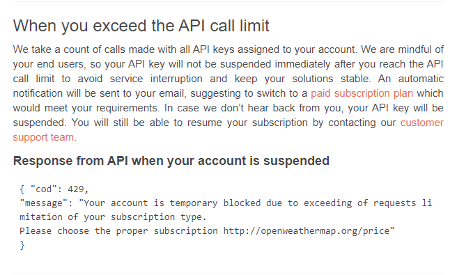

    Yes, you can check any location. The key is not assigned to a location and your location is not checked in any way at the registration stage.
    The only thing that limits you is the query limit, which can be checked in the documentation:
    ESP32 and touch display - tutorial part 4 - weather from the internet, API, JSON .
    Link: https://openweathermap.org/full-price
    So if you want to play around, then a free key is enough, but if you already want to make a product then you will already start to exceed the limits and then:
