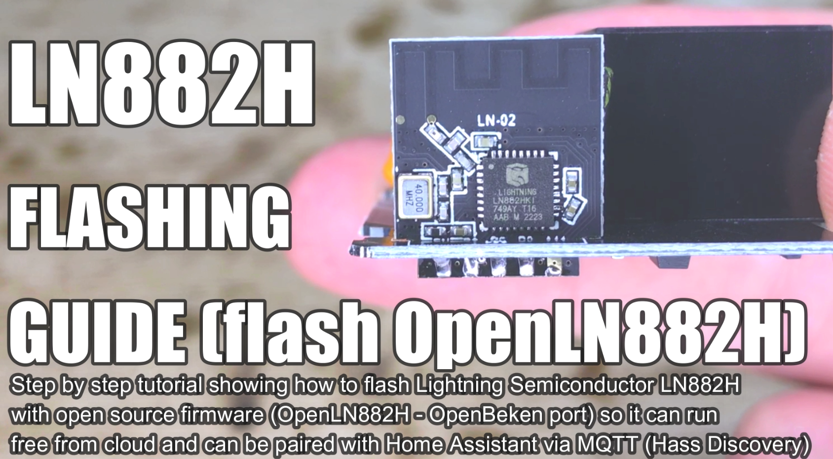

Close-up of an LN882H electronic module with text explaining the flashing process.
Here's a step by step guide showing LN882HKI flashing process along with soldering. LN882HKI can be easily flashed with OpenBeken port and run cloudfree, it can be also paired with Home Assistant. Our LN882H firmware also supports new features and sensors, like DHT11 or SSDP discovery, that can be later enabled via OBK scripting.
LN882 flashing is very similiar to ESP8266, you just need to ground one BOOT pin and then new firmware can be flashed via UART.
Here's detailed guide:
We also have a text guide for the same process. See:
English guide:
How to flash LN882H with open source Tasmota/Esphome style firmware - backup procedure included
Polish guide:
Jak sflashować LN882H oprogramowaniem OpenBeken aby uwolnić od chmury
Update 2026
As of 2026, this platform read/write is also supported by our flash tool:
The connection (soldering, wires), is the same, but you can use our tool instead of the legacy one.
Please check it out and use it instead of legacy tools, let us know how it works for you!

stefanmandl1 04 Jan 2025 11:32
I wrote a flashing tool for Linux. https://github.com/mandl/LN882Loader [Read more]
p.kaczmarek2 04 Jan 2025 11:34
That's very nice! How did you know the UART protocol details? I didn't research it yet, so I don't know if it's documented, or available somewhere, or did you have to reverse-engineer it? @divadiow... [Read more]
divadiow 04 Jan 2025 12:29
I'll give it a spin. A better, faster, LN882H flash READ option would be cool too if that could be added. [Read more]
p.kaczmarek2 04 Jan 2025 12:38
He seems to have this in main: #h.readFlash() which resolves to: def readFlash(self): self.ser.write(bytes(b'flash_read 0x0 0x1000\r\n')) msg = self.ser.readline() ... [Read more]
divadiow 04 Jan 2025 13:19
:) https://obrazki.elektroda.pl/7985689700_1735993103_thumb.jpg https://obrazki.elektroda.pl/3756362700_1735993187_thumb.jpg Ubuntu 24.04.1 LTS [Read more]
p.kaczmarek2 04 Jan 2025 13:32
Try to edit main file to run that mentioned h.readFlash() command and let's see what you'll get? [Read more]
divadiow 04 Jan 2025 15:07
not entirely sure how you mean to achieve that. I went into a GPT hole.. https://obrazki.elektroda.pl/8229946100_1735999555_thumb.jpg looked like it was doing something but it wasn't ... [Read more]
p.kaczmarek2 04 Jan 2025 15:39
I've checked his code futher and it seems that LN882H is using YMODEM protocol for UART communication: https://en.wikipedia.org/wiki/YMODEM It may be relatively easily to implement it in our flasher... [Read more]
stefanmandl1 04 Jan 2025 16:33
Hello @p.kaczmarek2, all my work is based on reverse engineering. I didn't find any documentation about the protocol. I found a new command for flash dumping ... fdump Regards and happy hacking... [Read more]
divadiow 04 Jan 2025 17:23
cool. will have a play when I am back home. I have Windows laptop and LN882H with me but py script doesn't seem to be playing ball at the moment. I'm curious about what you reverse-engineered. was it... [Read more]
p.kaczmarek2 04 Jan 2025 17:28
Well, there are at least 3 options, he could have: - captured communication with UART sniffer or separate USB to UART tool or Sigrok etc etc - decompiled flashing tool that runs on PC with IDA pro or... [Read more]
