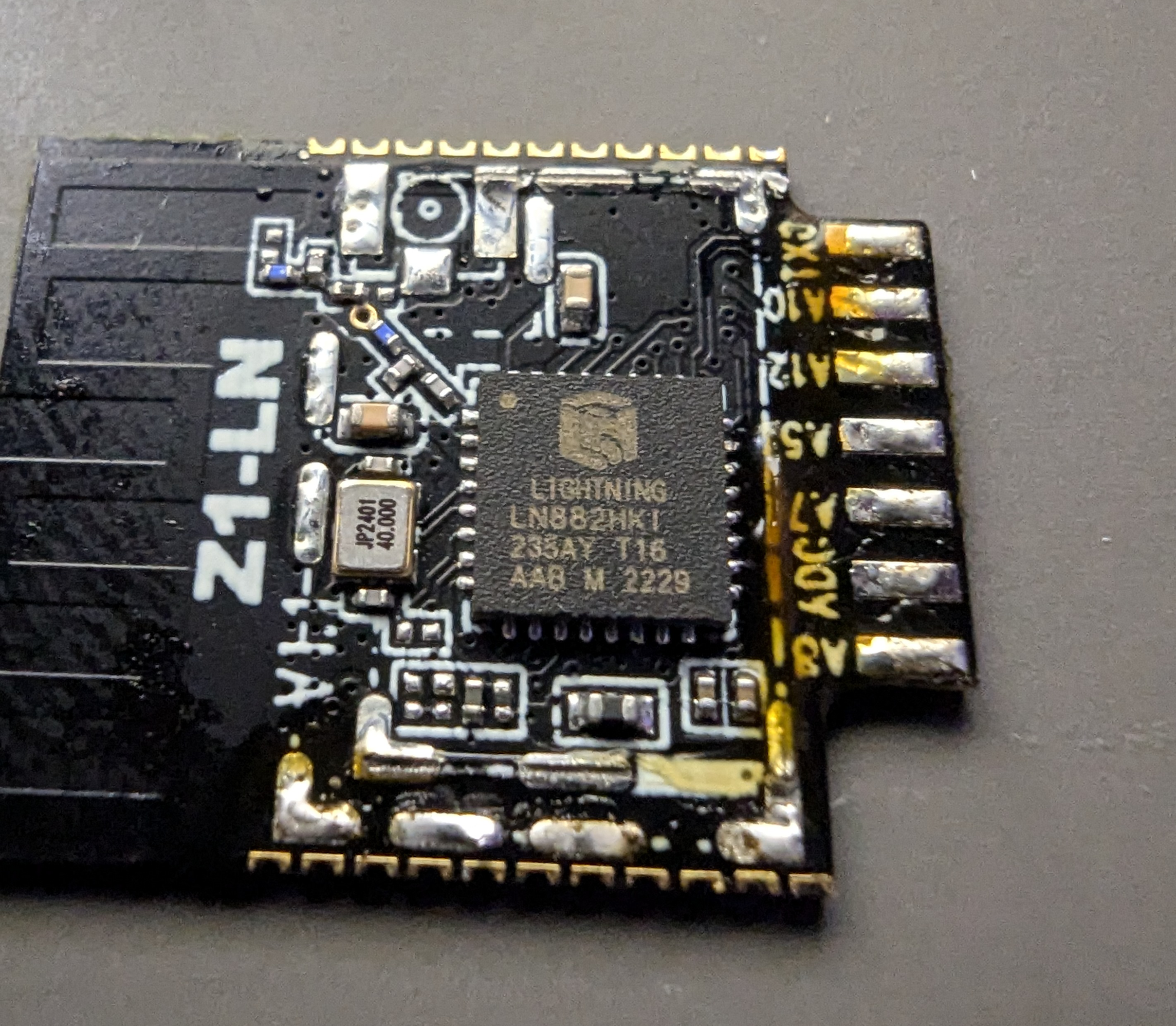

    Here's a step by step guide showing LN882HKI flashing process along with soldering. LN882HKI can be easily flashed with OpenBeken port and run cloudfree, it can be also paired with Home Assistant. Our LN882H firmware also supports new features and sensors, like DHT11 or SSDP discovery, that can be later enabled via OBK scripting.
    LN882 flashing is very similiar to ESP8266, you just need to ground one BOOT pin and then new firmware can be flashed via UART.

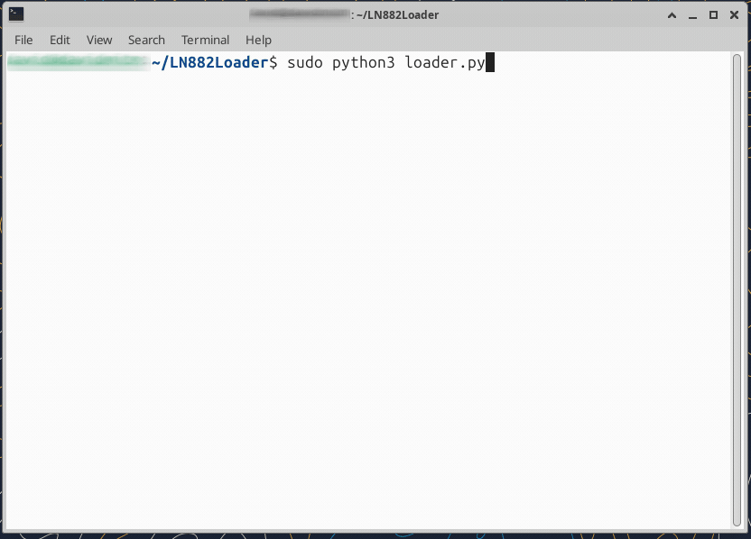

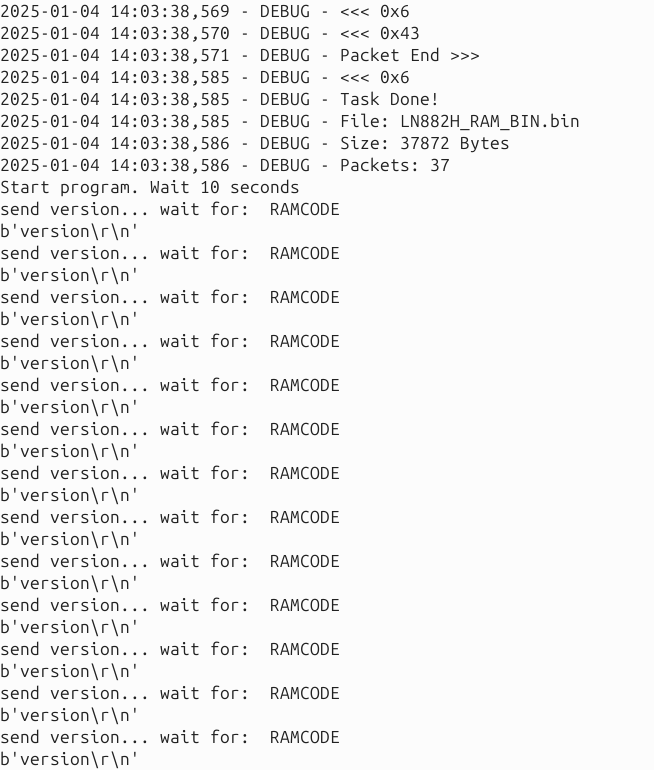

  • #6 21376484
    Posts: 4835
    Help: 420
    Rate: 851
    Terminal in Ubuntu 24.04.1 LTS with a command to run a Python program. User interface displaying information about the OpenLN882H_C25E1088 device.
    Ubuntu 24.04.1 LTS
  • #7 21376509
    Posts: 14390
    Help: 650
    Rate: 12313
    Try to edit main file to run that mentioned h.readFlash() command and let's see what you'll get?
  • #8 21376644
    Posts: 4835
    Help: 420
    Rate: 851

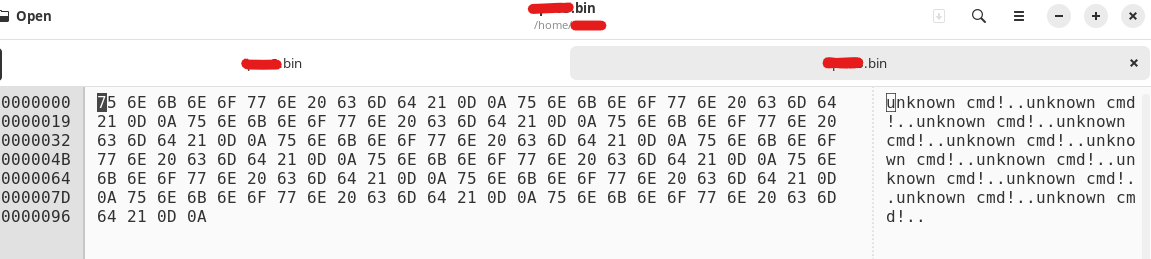

    not entirely sure how you mean to achieve that. I went into a GPT hole..
    Screenshot showing debug logs from a file transfer process, with messages about task completion and waiting for RAMCODE.
    looked like it was doing something but it wasn't
    Screenshot of a hex editor with a binary file displayed as hex and text.
    maybe OP @stefanmandl1 is working on it ;)

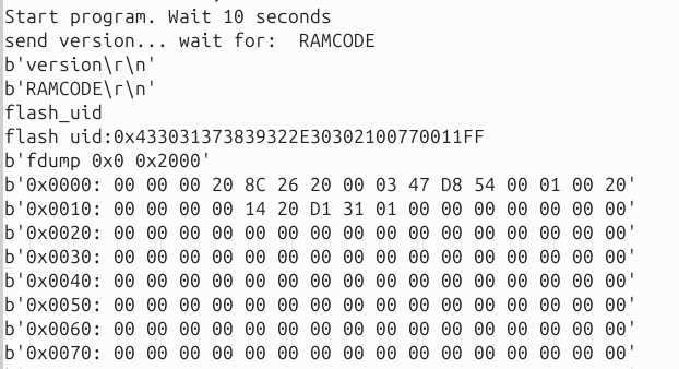

    all my work is based on reverse engineering. I didn't find any documentation about the protocol.
    I found a new command for flash dumping ... fdump
    Regards and happy hacking ...

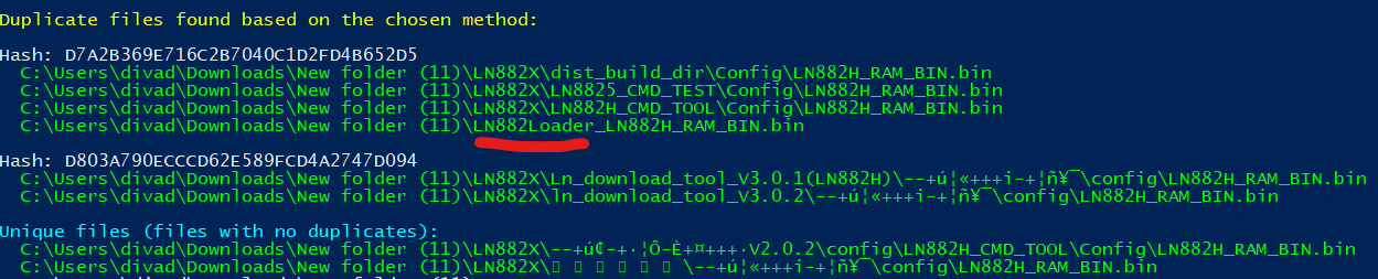

    cool. will have a play when I am back home. I have Windows laptop and LN882H with me but py script doesn't seem to be playing ball at the moment.
    I'm curious about what you reverse-engineered. was it LN882H_RAM_BIN.bin?
    If so, I notice I have 4 unique versions of that file in all my SDK and tool repo folders. I wonder what the differences are...
    Screenshot showing a search for duplicate binary files on Windows.
    List of binary files LN882H_RAM_BIN.bin with different modification dates.

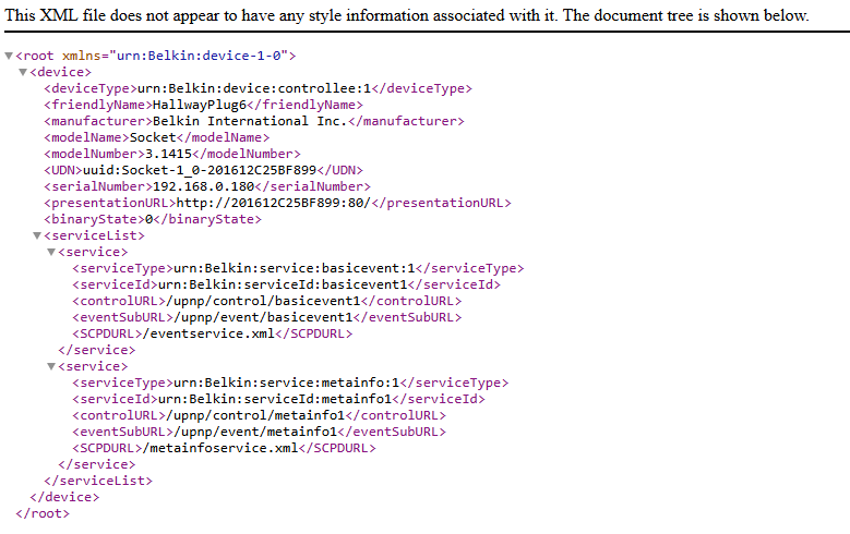

  • #13 21377361
    jhatter55
    I am looking for help with the Wemo driver for the LN88H. I have started the service and it shows in the setup.xml file but Alexa will not discover it. Wemo support has been successfully discovered by Alexa on some devices I have with the BL602 clip.
    Extract from an XML file showing the configuration of a Wemo device with type and service information.
  • #14 21377399
    insmod
    Posts: 1353
    Help: 160
    Rate: 425

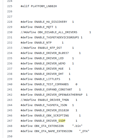

    >>21377361 You need SSDP support (alongside startdriver ssdp), and it is not currently enabled on LN.
  • #15 21377443
    Posts: 14390
    Help: 650
    Rate: 12313

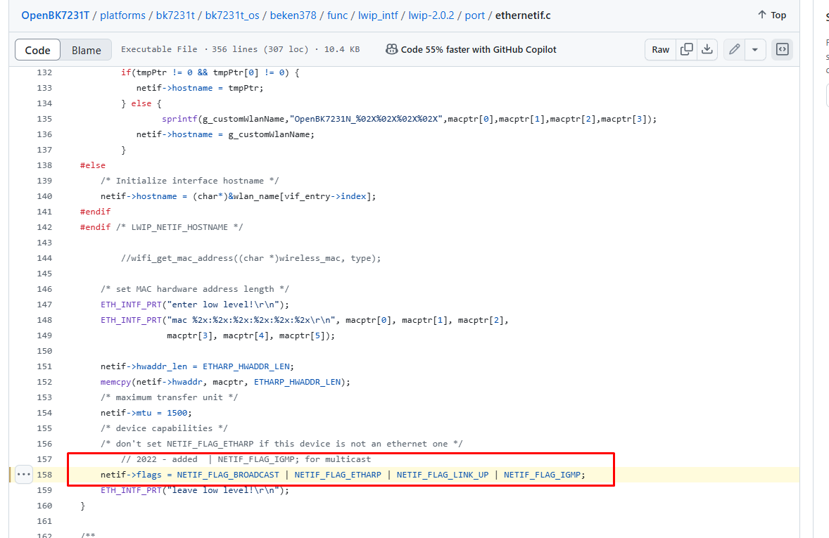

    My memory must be failing me, didn't you ask the same question recently? Or maybe I'm wrong...
    Anyway, SSDP requires IGMP Flag:
    Code snippet with highlighted IGMP flags line in ethernetif.c file on GitHub.
    It seems that it can be added there:
    https://github.com/openshwprojects/OpenLN882H...wip-2.1.3/src/port/ln_osal/netif/ethernetif.c
    However... the #define LWIP_IGMP is already set?
    Well if that's the case, then we only need to enable the driver. Let's try:
    https://github.com/openshwprojects/OpenBK7231T_App/pull/1493

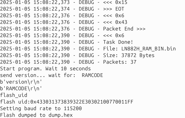

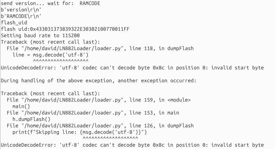

  • #17 21378212
    Posts: 4835
    Help: 420
    Rate: 851
    >>21376767
    @stefanmandl1 what are the args to dump to file?
    Added after 17 [minutes]:
    ah. uncomment h.dumpFlash()
    Screenshot showing terminal command results related to flash memory reading.
    Added after 3 [hours] 1 [minutes]:
    I've had a play.
    The attached, coupled with the rest of the git content, appears to work downloading from LN882H to a file called dump.hex
    This is a paired-down test that will only dump
    Code: Python
    Console screenshot showing the debugging and data transfer process from flash memory.
    fdump address range expanded to cover 2mb. It takes approximately 14 minutes to dump 2mb, despite self.ser.baudrate = 115200 being set. Any higher and the script errors with:
    Screenshot of a UnicodeDecodeError message in a Python script while decoding a message.
    I erased my LN after dump, flashed Tuya factory, then reflashed the LN882Loader backup back to the board - it booted OpenBK in AP mode and contained the small customisations I made before dump - a working backup - the state it was left before backup.
    So I guess:
    -is 115200 (2mb/14 mins= ~20,000bps?) really the fastest we can get
    -how can the OPs loader.py be modified to offer the user the option to backup flash and choose a filename
    -is the way in this modified script even good? it was done with GPT :)
    • loader.zip (2.05 KB) You must be logged in to download this attachment.

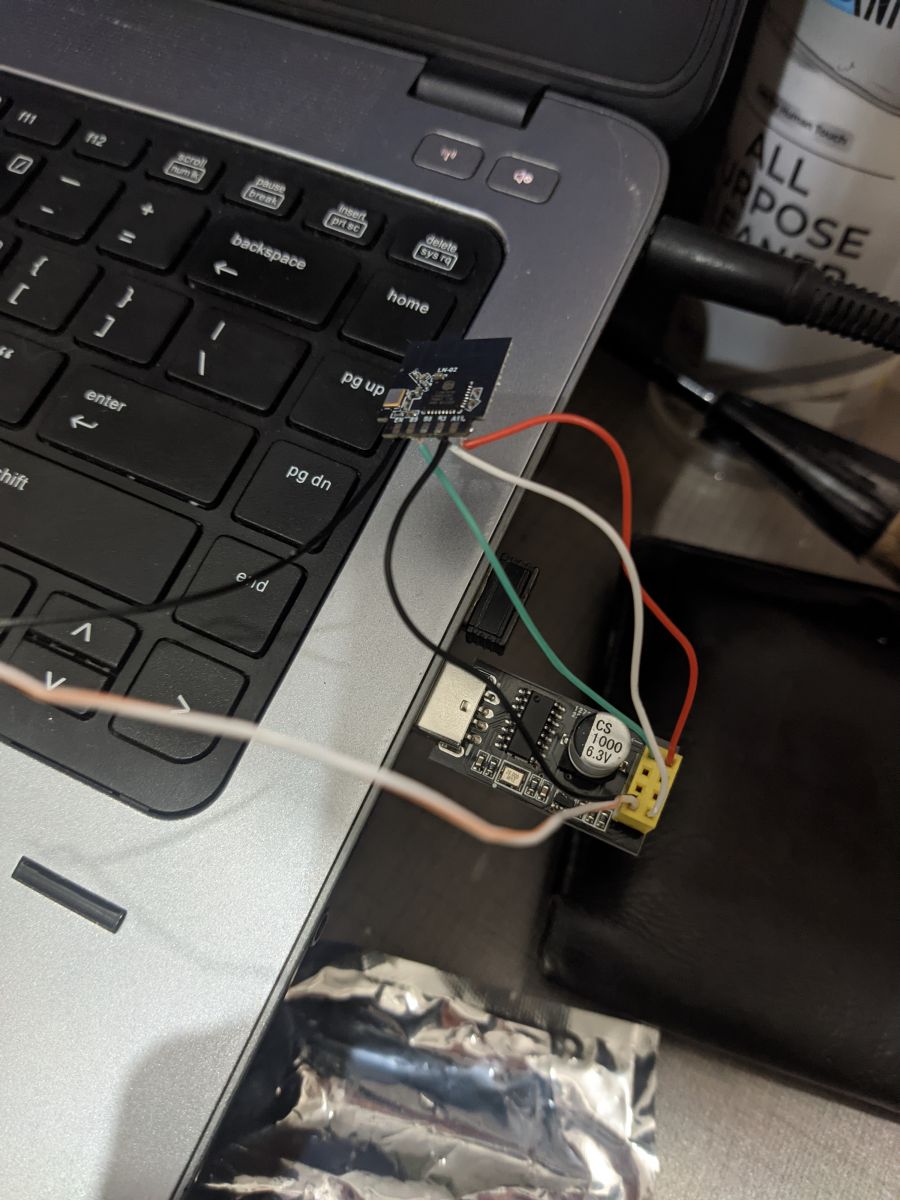

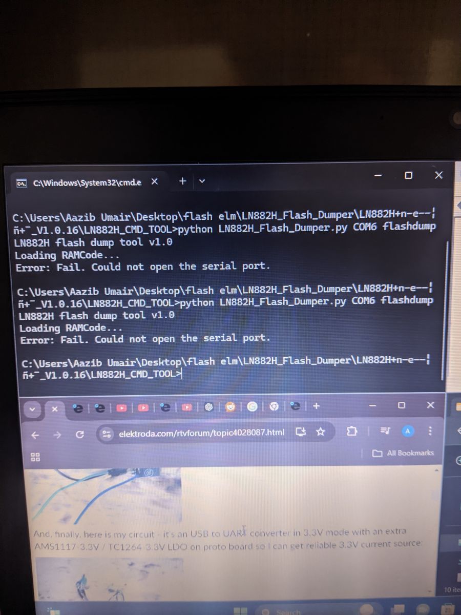

  • #22 21391484
    aaziumair
    I have been trying to flash using this USB to uart adapter. It has a 3.3 v output. I didn't use a 3.3v supply like originally done in the tutorial. I keep getting this error
    Computer screen showing an error message when trying to use a USB to UART converter.
    Added after 6 [minutes]:
    This is the USB to uart converter
    USB to UART adapter connected to a laptop with colored wires.
  • #23 21391539
    Posts: 14390
    Help: 650
    Rate: 12313
    Are you sure that your COM port is COM6?
    Maybe you have some software installed that takes control over COM port, like Cura (3D slicer)?
  • #25 21391661

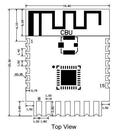

    Posts: 14390
    Help: 650
    Rate: 12313
    It has,,, non-standard TXD pin placement?
  • #26 21391694
    Posts: 4835
    Help: 420
    Rate: 851
    v. interesting. all those pads along the edges. are they NC or functional I wonder
  • #27 21391708
    Posts: 14390
    Help: 650
    Rate: 12313
    It looks a bit like CBU module:
    Top view of an electronic module with dimension markings and the label CBU.

    About the sources...
    It's technically just a binary downloaded from: https://images.tuyacn.com/smart/embed/package/vscode/data/ide_serial/tyutool_cli.tar.gz
    Interestingly when it fails, it sometimes leaves a python stack trace.
    Running:
    $ strings tyutool_cli | grep import
    import sys; sys.stdout.flush();                 (sys.__stdout__.flush if sys.__stdout__                 is not sys.stdout else (lambda: None))()
    import sys; sys.stderr.flush();                 (sys.__stderr__.flush if sys.__stderr__                 is not sys.stderr else (lambda: None))()
    there's even some traces of python
    It turns out it's just python byte-compiled and packaged into an executable.
    It can be unpacked with:
    $ git clone https://github.com/extremecoders-re/pyinstxtractor.git
    $ cd pyinstxtractor
    # it only worked partially with a different python version, it has to match the python used in the binary
    $ python38 pyinstxtractor.py tyutool_cli
    [+] Processing tyutool_cli
    [+] Pyinstaller version: 2.1+
    [+] Python version: 3.8
    [+] Length of package: 9832132 bytes
    [+] Found 55 files in CArchive
    [+] Beginning extraction...please standby
    [+] Possible entry point: pyiboot01_bootstrap.pyc
    [+] Possible entry point: pyi_rth_inspect.pyc
    [+] Possible entry point: pyi_rth_multiprocessing.pyc
    [+] Possible entry point: pyi_rth_pkgutil.pyc
    [+] Possible entry point: tyutool_cli.pyc
    [+] Found 798 files in PYZ archive
    [+] Successfully extracted pyinstaller archive: tyutool_cli
    You can now use a python decompiler on the pyc files within the extracted directory
    $ cd tyutool_cli_extracted
    $ ls
    base_library.zip    importlib_metadata-8.5.0.dist-info  lib-dynload    liblzma.so.5         libssl.so.1.1  pyiboot01_bootstrap.pyc  pyimod03_ctypes.pyc          pyi_rth_pkgutil.pyc   struct.pyc
    certifi             libbz2.so.1.0                       libexpat.so.1  libmpdec.so.2        libuuid.so.1   pyimod01_archive.pyc     pyi_rth_inspect.pyc          PYZ-00.pyz            tyutool_cli.pyc
    charset_normalizer  libcrypto.so.1.1                    libffi.so.7    libpython3.8.so.1.0  libz.so.1      pyimod02_importers.pyc   pyi_rth_multiprocessing.pyc  PYZ-00.pyz_extracted  yaml
    For decompiling .pyc files, decompyle3 worked well (2 files failed to decompile):
    $ mkdir -p src/tyutool/
    $ decompyle3 -o src tyutool_cli.pyc
    $ decompyle3 -r -o src/tyutool PYZ-00.pyz_extracted/tyutool/
    A snippet from an interesting file:
    $ cat src/tyutool/flash/ln882h/ln882h_flash.py | grep -A20 'def check_ram_mode'
        def check_ram_mode(self, times=2, timeout=1):
            data = "version\r\n"
            self.reset()
            self.send_data(data.encode("utf-8"))
            uart_rx_byte = self.read_line(times, timeout)
            self.log.debug(f"check_ram_mode receive: {uart_rx_byte}")
            if "RAMCODE".encode("utf-8") in uart_rx_byte:
                return True
            return False
        def get_flash_uuid(self):
            data = "flash_uid\r\n"
            self.reset()
            flash_uid = self.read_line(2, timeout=1)
            if len(flash_uid) >= 30:
                return flash_uid
            return False
        def flash_set_addr(self):
            data = "startaddr 0x0\r\n"
    src/tyutool/flash/ln882h/ram_bin.py contains a binary similar to LN882H_RAM_BIN.bin.

    jhatter55 wrote:
    >>21377443 Sorry for the late response and yes you answered me before in the old thread and I provided some info but then the thread was moved so I asked again. So I saw your proposed change to enable SSDP. I guess I would have to compile against that change? I'm currently not setup to do that. I flashed the latest firmware but SSDP still isn't an option.
    I'm pretty sure that SSDP was enabled on LN882h last week:
    https://github.com/openshwprojects/OpenBK7231...mmit/a5b536b0d514624114cf91a8c45a1cc5dded1307
    Screenshot of source code for platform LN882H with various enabled options.
    @niterian Are you looking for other tools because flashing does not work for you? Then please show your connections. I don't think that the tool is at fault.
