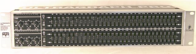

    witam
    roznica cenowa miedzy jednym a drugim to 60-70zl
    a o to one
    Comparing BEHRINGER FBQ6200 vs FBQ3102: Features, Price Difference & Value
    Advantages of the FBQ6200:
    Professional dual 31-band stereo Graphic Equalizer
    62 bands total
    Made for or both live and studio applications
    Revolutionary Feedback Detection System instantly reveals critical frequencies and can also be used as an Audio Analyzer
    Dedicated mono subwoofer output with adjustable crossover frequency
    Built in low pass and high pass crossover filters removes unwanted frequencies and noises from PA speakers, and subs
    Eliminates un-wanted vibrations and floor shaking frequencies from your sound
    Highly accurate 8-digit LED output metering
    Dedicated limiters with gain reduction meters for each channel
    Protects your sound system from distortion and work overload
    Pink noise generator provides test signals for equalizing your sound system to any acoustics in any hall
    input gain control for easy level setting
    Ultra low-noise audio operational amplifiers offer outstanding sound performance
    Servo-balanced inputs and outputs with 1/4" TRS and gold-plated XLR connectors
    Relay-controlled bypass with an auto-bypass function during power failure (AKA: failsafe relay)
    Illuminated faders
    Detent potentiometers
    Illuminated switches
    Shielded toroidal power transformer for ultra low-noise performance
    High-quality components and exceptionally rugged construction ensure long life
    Conceived and designed by BEHRINGER Germany
    Rugged all metal Chassis
    High quality illuminated 45mm faders and illuminated switches
    Advantages of the FBQ3102:
    Professional 31-band 2U rack mount stereo Graphic Equalizer
    Highly accurate 12-digit LED output metering
    Illuminated faders
    High quality illuminated faders and illuminated switches
    czy lepiej dolozyc te smieszne pieniadze do tego lepszego modelu 6200 bo zakladam ze bedzie lepszy czy darowac sobie bo nie uslysze tej roznicy nawet i wziasc model 3100?

    Please note that the FBQ6200 has longer sliders (you will be able to set it more precisely), in addition it has a built-in limiter and a pink noise generator.
    FBQ6200 is taken from these two chances.

    You asked if you will hear the differences between these models.
    I emphasize that I have not worked on any of them, so I do not know, but I suspect you will not hear the difference. However, it is worth to add those as you wrote a funny money, because of these other functions (limiter, pink noise generator), you can not use them, but if they were once needed, they are (as to their quality behringer does not enjoy the best opinion, but this is another matter).
