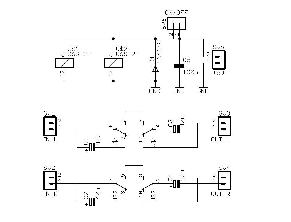

    Description of the modification
    Diagram of an additional module:

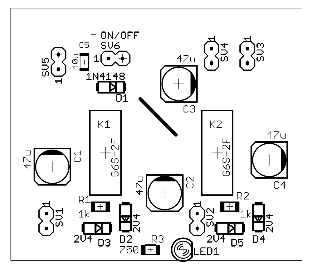

    Placement of elements on the board:
    A way to get the Behringer UMC202HD card
    Below in the PDF attachment with the mosaic of the tile.

    List of necessary elements:
    SMD relay OMRON G6S-2F 5V (or equivalent) - 2 pcs,
    SMD capacitor 47uF 16V, preferably bipolar - 4 pcs,
    SMD capacitor 1206 100nF - 1 pc,
    SMD diode 1N4148 - 1 pc,
    Additionally, you will need: a single-section switch, goldpin pins (standard 2.54mm pitch), a piece of a thin two-core cable.

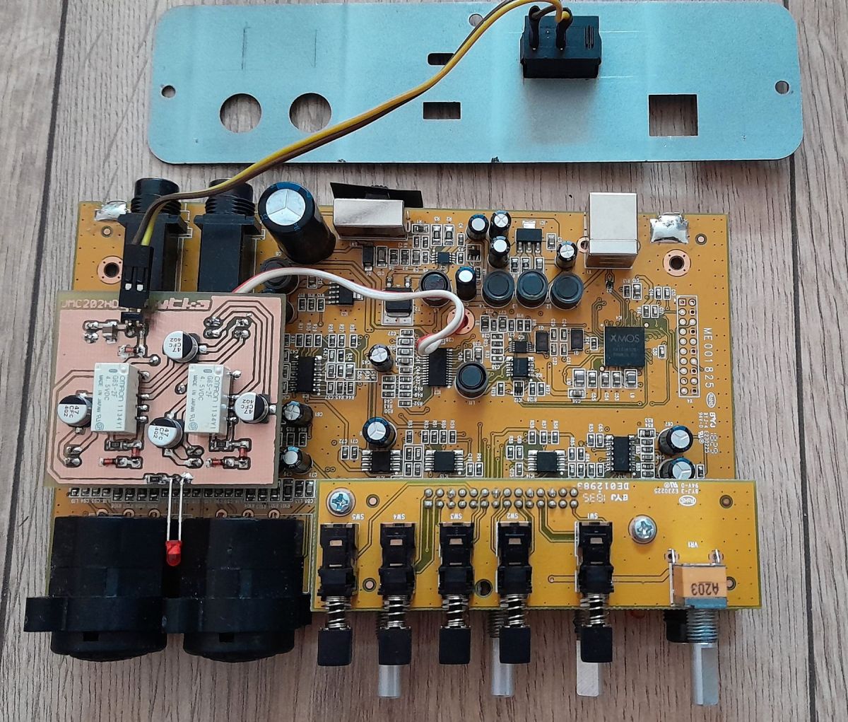

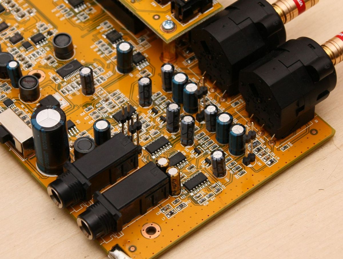

    Modification steps:
    - Remove the following electrolytic capacitors from the card motherboard: C81, C85, C34, C35
    - In place of the capacitors, solder long pins (Gold-pin)
    A way to get the Behringer UMC202HD card A way to get the Behringer UMC202HD card
    - On the previously installed pins, mount and solder the assembled module.
    A way to get the Behringer UMC202HD card A way to get the Behringer UMC202HD card A way to get the Behringer UMC202HD card A way to get the Behringer UMC202HD card
    - Connect the + 5V power supply to the module. I propose, as I did, from the bottom of the board to the pins of the C7 capacitor
    - install the card function switch in the rear housing panel. The ON position enables modification-shortened input path. An example of a photo montage. The switch should be connected to the connector on the added module.
    Rear view of the device after modification
    Before trying to work, I suggest you check the correctness of all steps!

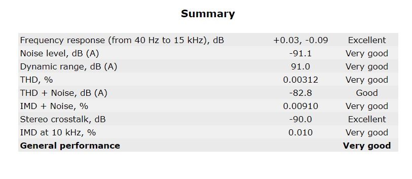

    When the switch on the back wall is turned on, the card has a new functionality (shortened input path), while when it is turned off, it is compatible with the original version.
    Below, in the appendix, the full test result showing the differences, the green diagram in the appendix marked with the annotation V2, is the result with the attached modification.
    And here is a summary, showing the differences in the results of the test.

    Cool modification, can you take more detailed photos of the PCB? I am curious what operational amplifiers etc. are there.

    I really like your patent with the removal of the capacitors, adding goldpins in their place and using them at the same time as a signal capture and construction element :)
    Integrated circuits (not all, let's say only from the audio path) present in this device
    - operational amplifiers are mainly quad AD8694 - 4 pcs (input amplifiers - IC9, signal symmetrization for ADC - IC8, filter and output buffer - IC11, headphone amplifier - IC13), but also NJM2122 - 2 pcs (it looks like they also work in amplifiers input), and 4580 - 1 pc (it looks like it works in the polarization system - artificial ground).
    - ADC / DAC chip is CS4272,
    - DSP and USB support - XMOS SK1814,
    - keys to the Monitor function - HEF4066.
    krisRaba wrote:
    (...) adding goldpins to it and using them simultaneously as a signal interceptor and a construction element
    Considering all the aspects, what I wanted to do, how much space was available, etc., I came to the conclusion that this was the best solution.

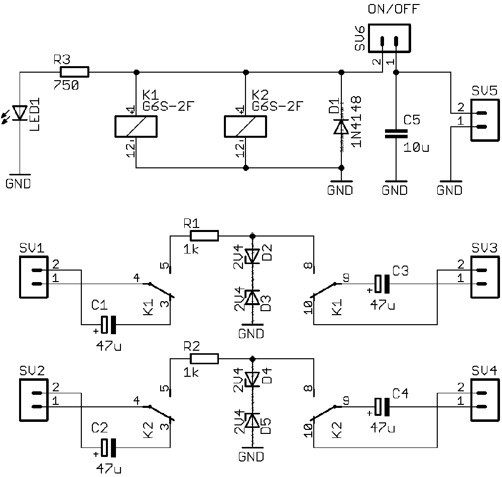

    The topic is quite old, but there has been some update to my modification that I would like to share. Maybe someone else will find it useful.
    The first version of the modification unfortunately had neither an indicator of its activation nor a protection circuit.
    Unfortunately, I have to confess that some time ago, in a moment of absentmindedness, I applied too high a voltage to the card's input (with the input path shorted out), with the result that I burnt the AD8694 circuit.
    So another modification was created to limit such an experience.
    Here is the new schematic:
    Circuit diagram of a modification with indicator and Zener diode protection. .
    As you can see, a modest protection circuit on Zenar diodes has appeared here, as well as an indication that the circuit is switched on.
    Arrangement of components on the board:
    PCB layout with protection circuit and indicator. .
    The assembly of this module inside the card is the same as before, with the only exception that now, in addition, a hole with a skylight has appeared on the front of the card.
    Updated electronic board with protective components. .

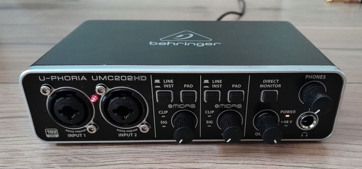

    Behringer U-PHORIA UMC202HD audio interface with visible indicator light. .
