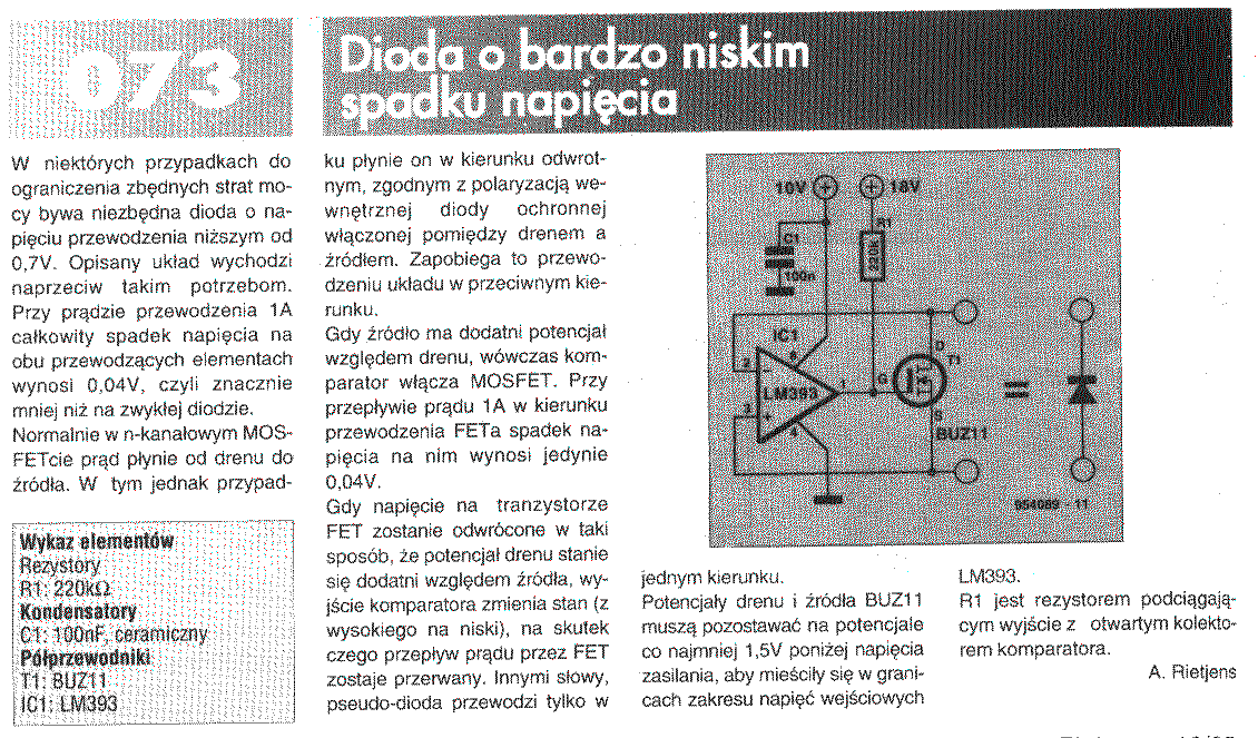

    Rectifiers are made without voltage drop. It is a split transformer, where mosfets are turned on instead of 2 diodes. These mosfets are controlled by comparators powered by another traditional power supply. You can meet such miracles in very expensive power amplifiers.

    It is true with MOSFETs (approximately - the best ones have a resistance of about 3 milliohms),
    only it's not a diode anymore, and requires a few volts to be driven at the gate.

    As I will remember, I will throw here a schematic of such a "diode" on the MOSFET from the Elector. Maybe that will clear things up a little.
    Regards.

    And here is this MOSFET control chip, which imitates a diode with a low voltage drop.
    Regards.
