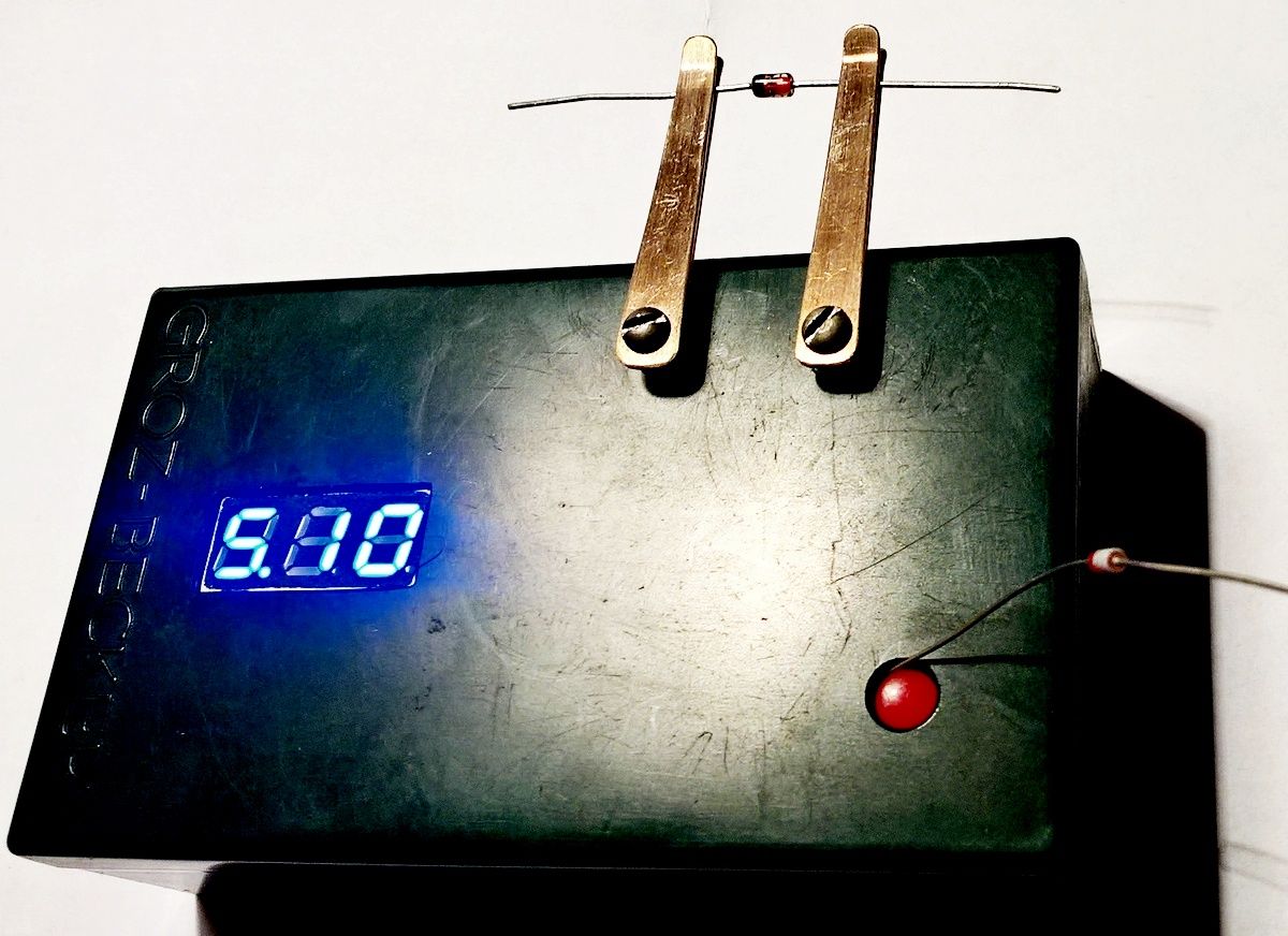

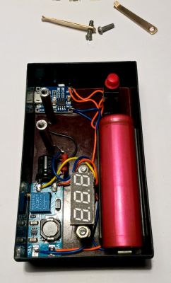

  • A simple Zener diode voltage measuring instrument uses three ready-made modules plus a resistor, a capacitor, and a few centimeters of cable.

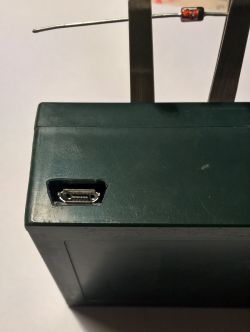

  • The circuit follows a diagram from a Russian-speaking forum and includes external battery charging.
  • It measures diodes up to 30V.
  • It works immediately after assembly, but the +, -, and U wires on the display PCB must be checked because lead colors and order vary.
  • Hello colleagues.
    I haven't published anything for a long time. I spend more time on mechanics in the workshop. Milling machine, lathe.
    Today, a simple meter, a Zener diode voltage measuring instrument. Diagram from the Russian-speaking forum. Both the simple diagram and the execution of the device. Three ready-made modules for a few zlotys and one resistor, capacitor and a few centimeters of cable. It has an external battery charging.
    It works immediately after assembly. Measures diodes up to 30V. One note when doing this
    check the correctness of + - and U wires on the display PCB. There are different colors and sequence of leads.

    This is called "Creative use of ready-made modules".
    Simple but effective and most importantly - cheap.
    Technical question:
    How often do you need to tighten loose screws of the contact contacts?
    And the second - more technical: What current do you measure the diodes with and is it matched to the diode power?

    I suggest using a converter with current stabilization. Lead the current adjustment potentiometer outside the housing. Draw it a scale or turn on a milliammeter and you can even play characteristics. This could test other diodes, from simple rectifiers to LEDs.

    I measured the diode measurement current, it is 10mA. If we mount the diode the other way around, it will measure us and display the voltage drop in forward direction. I do not tighten the screw. There is no such need because they do not loosen. While threading the posts for the contacts (phosphor bronze), I tapped M3 (2). The thread is tighter so the screw cannot be unscrewed. The contacts are in the so-called duckbill.
    But you can also put the diode on the contacts and the measurement is the same. Below is an attachment-photo for the tester up to ~ 100V
