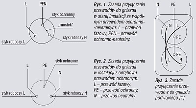

Yes—if that room is still on a TN-C section, you can zero the socket by connecting the PEN conductor to the protective contact and bridging it to the working contact; one reply also notes the phase should be on the left [#6804637][#6804655] Having a third wire in the kitchen or bathroom does not by itself forbid this, because a 1994 block may have a mixed layout with TN-CS in those rooms and TN-C elsewhere [#6808099] Do not use water/CO pipes or other random metal installations as a substitute earth, because PVC sections and breaks can make the protection discontinuous and dangerous [#6805081][#6805246] If you do not have a residual current device, the thread says zeroing is done this way [#6804637]

    For the TNC system, connect the PEN (zero) conductor to the protective contact (pin) and then jumper it with the working contact.

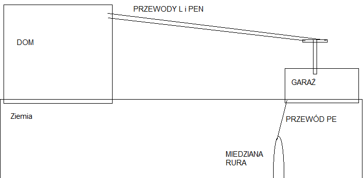

    I have the grounding shown in fig. 1 throughout the house. But in the garage I would like to have it as on the other one. Will such a grounding work?
    Is It Safe to Use Zeroing for Sockets With Only Two Wires (Blue and Black)?

    A completely different story is mentioned in a multi-sheet standard. It is about earth electrodes, not some "left earth". The earth electrode can be natural, ring, foundation .... If there are installations made of metal pipes, they are additionally connected to the equalizing rail and earth electrode.

    So me again. If in the bathroom and kitchen I have a third cable in the socket, and in my room I only have two cables, can I do the so-called reset? If so, is it safe, because when you read the website http://www.kablomedia.pulawy.pl/bezpiecz.html you can get scared :) . Help ...
    Let me just add that I live in a block built in '94 and I have no idea what network system was used.

    You have a mixed network layout, as in most of those years (94), kitchen and bathroom TN-CS, and the rest of the TN-C apartment. You can do zeroing, you've already read how to do it right.
    https://obrazki.elektroda.pl/68_1248179975.jpg Fig.1
    You can see the best here.

    and here (picture 1)
    https://www.elektroda.pl/rtvforum/topic1375269.html#6805207
    :arrow: Charles57
    I do not know if such a grounding will do the job, as nothing is known about it. You should do this as follows:
    at the entrance to the garage, the PEN conductor should be split into PE and N, and the place of separation should be grounded with a rod earth electrode. The earth electrode resistance must not exceed 10 ? under the worst circumstances. It is best to measure the resistance in summer, after a week of hot weather.
    Next, you can conduct a three-wire installation.

    1. How to separate this wire as only 2 cables go? L and PEN. I'm not sure if it's PEN, but I have PEN sockets all over the house, so it says PEN.
    2. Well, probably the stupidest question xd. How to measure the earth resistance? One multimeter cable to PE and the other where? Into the ground? I would have to dig wells.
    3. I just remembered. In the basement of the house there is a pipe that used to go to the pump and that was used by water from the well. Is the connection to this pipe enough? The well has not been used for a long time, because ... probably the water is poisoned or something ... I don't know, but I wouldn't drink this water;]
    4. After I'm going to dig a hole and put my earth electrode there. It will be best if it digs into the moist layer in the heat?
    5. Can the lightning rod be an earth electrode?
