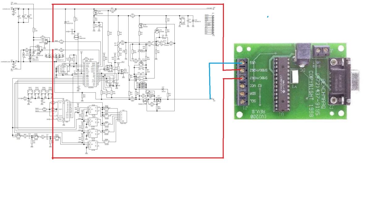

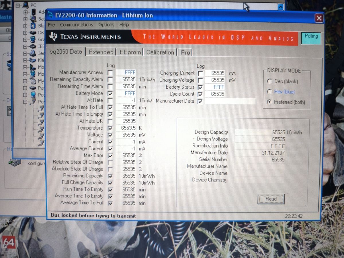

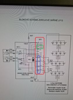

    Cześć,
    Potrzebuję porady, jak podłączyć baterię do urządzenia EV2200. Przesyłam zdjęcie schematu baterii i połączenia z EV2200. Czy jest ono prawidłowo podłączone? Czy EV2200 potrzebuje zewnętrznego zasilania, czy jest zasilany z portu COM? Dziękuję wszystkim.
    Laptop Battery Electronics 'Reset' FAQ >>7669060
  • #10 21602590
    misiozol
    Level 35  
    Posts: 2529
    Help: 230
    Rate: 638
    From what I remember it was SCL SDA, have a look at evaluation bq2060.
  • EV2200 reads battery data without external power
    #11 21602971
    Alex_8030
    Posts: 28
    Rate: 8
    Hi pavelicom.
    I can't make out any markings on the diagram. Except, perhaps, the SDA and SCL controller inputs. Yes, those are them. But connect directly to the connector, not to the BMS board pads.
    The last contact is "Ground", it is also taken directly from the connector.
    The pinout of your connector is not readable in the picture.
    No external power is required for the EV2200 if you just read the battery data. It is only required for additional Charge/Discharge operations performed by the EV2200. So forget about them. Everything should be readable, but only with the native TI EVSW2200-60 software.

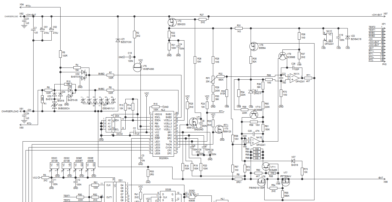

    This is the schematic from the bq2060 where it is reset by modifying 24c02, in the case of this design the communication pins are marked RT2+ and RT2-.
  • #15 21606421
    misiozol
    Level 35  
    Posts: 2529
    Help: 230
    Rate: 638
    I still don't understand the problem, what do you want to achieve? It couldn't be simpler, you have SMBC + SMBD marked right after the resistor R7 and R8.
  • bq2060 access via XP1 SMBD and SMBC pins
    #16 21606548
    Alex_8030
    Posts: 28
    Rate: 8

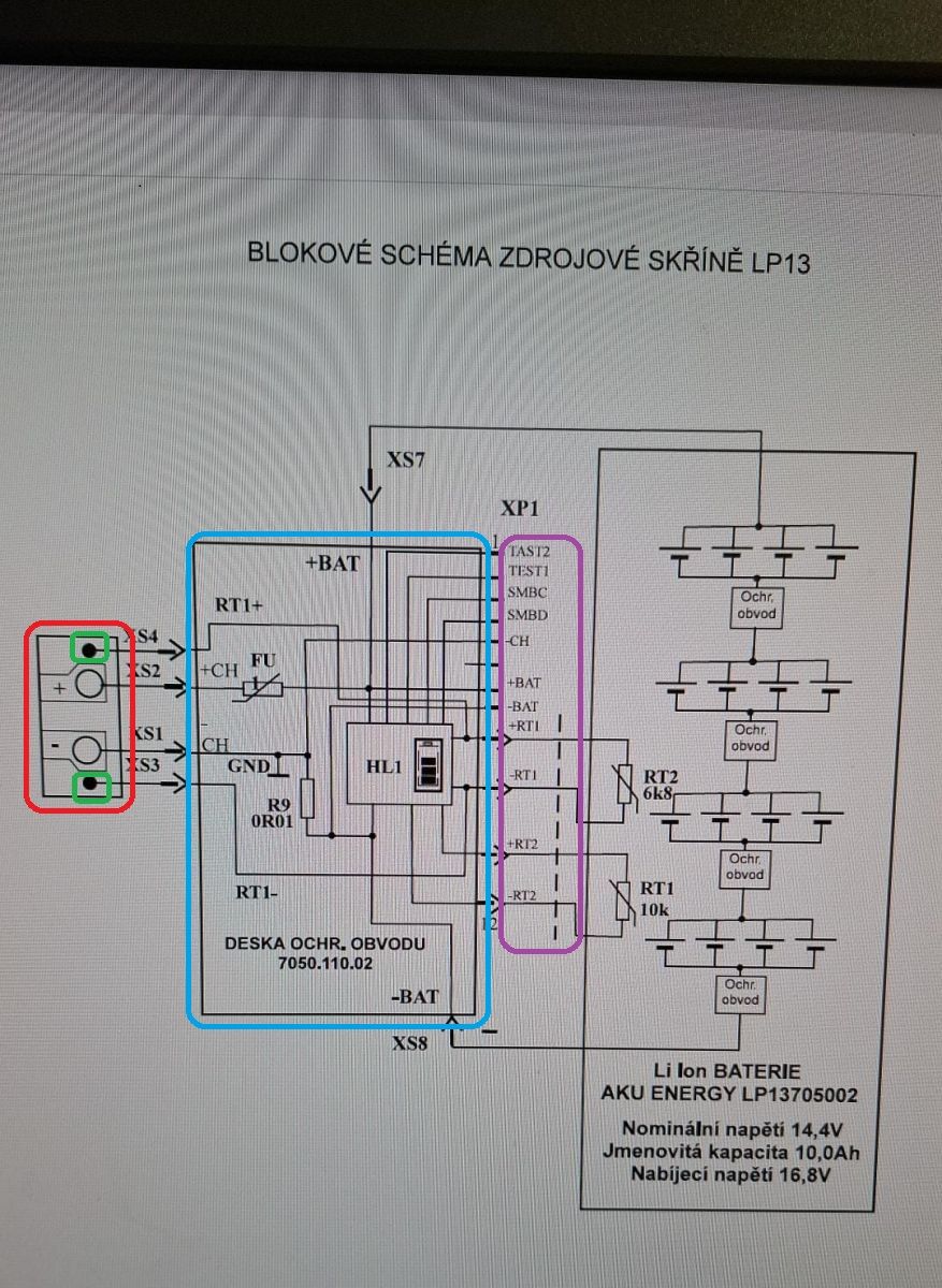

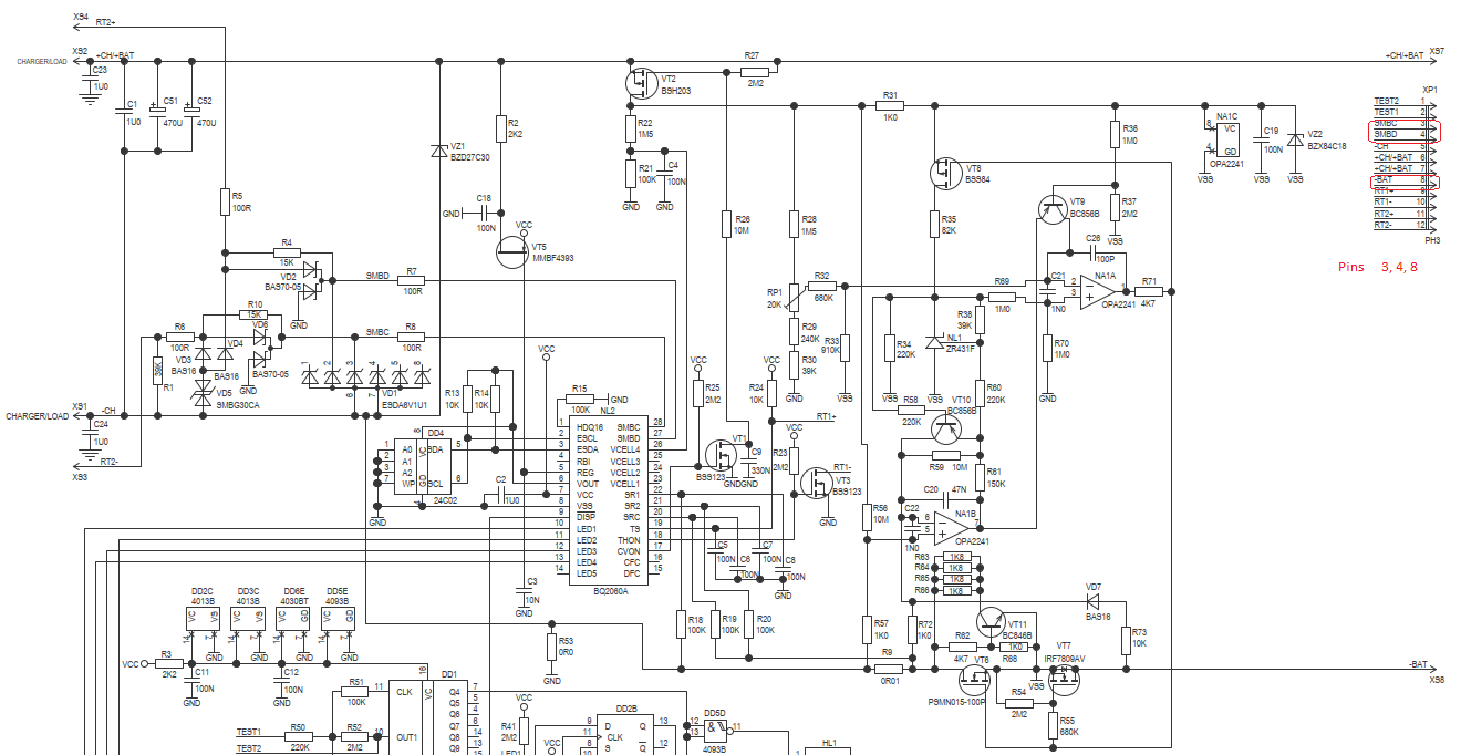

    Listen, there in the picture 1 is the internal part of the battery.
    If you want to reflash the EEPROM, you need to connect to the memory chip pins.
    If you just want to read the report from the bq2060 controller, you need to connect to the XP1 connector, to the SMBD and SMBC pins, and also to the B- contact
    I circled them in red for you in image 1.
    In image 2 of connecting to a laptop, I circled the connector itself in red. In it, I circled the pins -RT1, -RT2, +RT1, +RT2 in blue. You DO NOT NEED them (these are the pins for connecting to the battery thermistors). You need the SMBD and SMBC pins, which I circled in green.
    Laptop Battery Electronics 'Reset' FAQLaptop Battery Electronics 'Reset' FAQ
    Added after 12 [minutes]:
    Please upload for me again the circuit of your battery, only in the uncut form from below.
    I have a battery on bq2060, not as powerful as yours, but the circuit of connecting the chip may be similar.
    Thanks in advance!

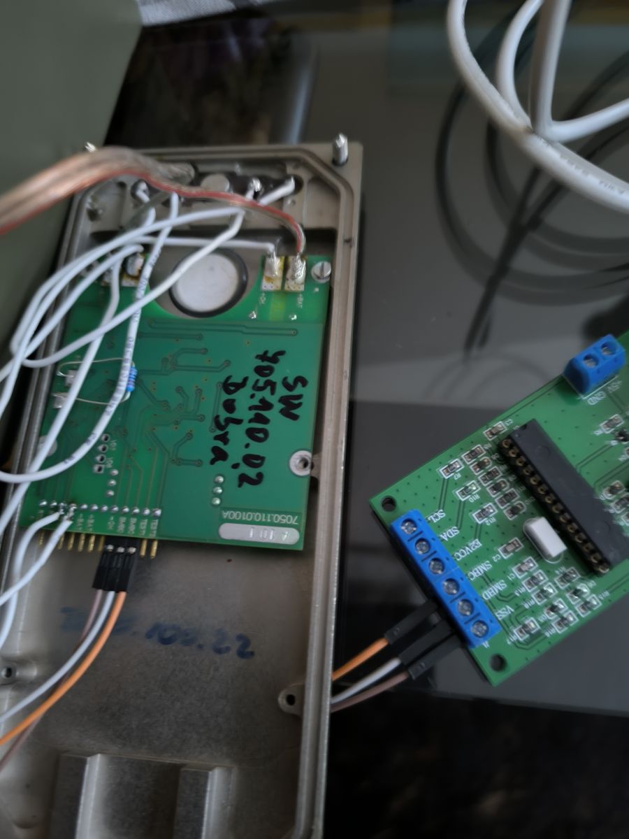

    pavelicom wrote:
    Hi,
    I need advice on how to connect the battery to the EV2200. I am sending a picture of the battery diagram and connection to the EV2200. Is it connected correctly? Does the EV2200 need an external power supply or is it powered from the COM port? Thank you all.
    This is wired correctly.

    What are the two power connectors on the EV2200 for? One is for the terminals and the other for the connector. Do I need to power the EV2200 or is it powered from the RS232 connector? Should I also connect the positive power supply from the battery to the EV2200, which is 16.8V?
  • #20 21609132
    Alex_8030
    Posts: 28
    Rate: 8
    pavelicom, you only need this EV2200 board, a cable to connect to the COM port (a complete 9-pin cable is required), and 3 wires to connect to the battery. Additional power is not needed, and the positive from the battery does not need to be connected to the EV2200.

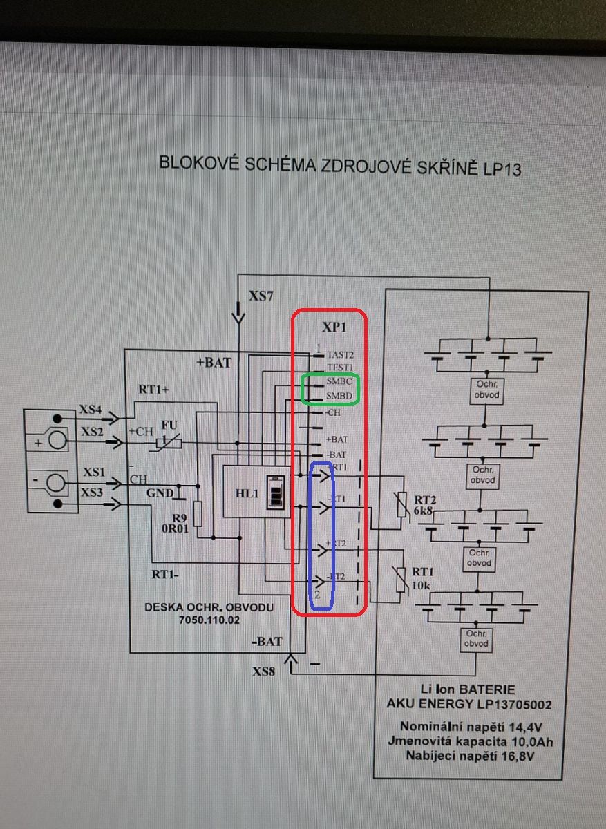

  • Corrected EV2200 connection points for BQ2060 battery controller
    #21 21612660
    Alex_8030
    Posts: 28
    Rate: 8
    Hello pavelicom.
    I made a mistake advising you, as I did not immediately understand the connection between the block diagram and the electrical schematic of the battery controller.

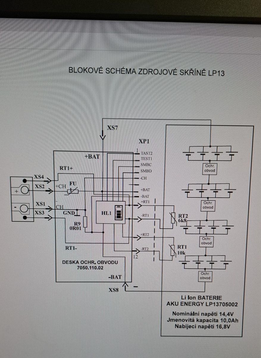

    I have uploaded two images where I have marked the connectors again, as I understand them now.
    In the block diagram (image 1), I circled in blue the part that I think is now depicted in the electrical schematic (image 2).
    The connector circled in red on the block diagram is obviously the input of your device powered by this battery.
    This connector has only 4 pins. There are only 2 pins that can be connected to the ev2200: pin XS4 (RT2) and pin XS3 (RT2-).
    The third pin "GND" can be taken from any point in the electrical circuit that is connected to 'Ground'.
    Alternatively, the pin can be taken from the connector highlighted in red on the block diagram XS1.
    However, your option - at the '-' point of the battery - is probably not quite correct, since there is no direct line to 'GND' there.
    Laptop Battery Electronics 'Reset' FAQ Laptop Battery Electronics 'Reset' FAQ

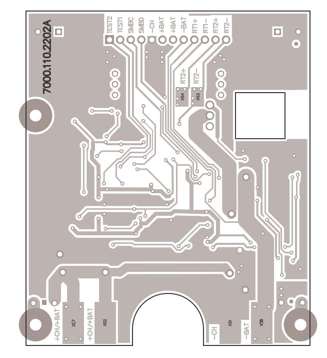

    In the block diagram, they are shown connected to the battery temperature sensor (though for some reason it says RT1 there, although it would be more logical to indicate RT2).
    Now, in the electrical schematic, the same connector shown in the BMS controller board schematic bq2060 is connected to its SMBD and SMBC buses, not to the temperature sensor.
    I believe this second option is the correct one, so I think you could connect to the pins circled in green on the block diagram.
    If you have the opportunity, you can also connect to the points on the electrical schematic, circled in green, as you originally intended, marked SMBD and SMBC.

    @Alex_8030 see post #13 , I omit that this diagram is somehow strange, for me they are 2 different devices or the diagram is incomplete.
  • Controller schematic shows only VCELL4 connected
    #23 21614707
    Alex_8030
    Posts: 28
    Rate: 8
    Misiozol, that's right, you pointed all this out in post #13.
    But the scheme is really strange. Everything seems to fit together, but there's a difference in the pin assignments.
    I agree with you.
    Pavelicom seems to have disappeared..., yet we are still discussing)))
    P.S.
    Notice, misiozol, in the block diagram, there are 4 cells in the battery.
    But in the electrical diagram of the controller, there is only one connection for the battery voltages - VCELL4.
    The other pins of the controller - VCELL1, VCELL2, VCELL3 simply 'hang in the air'.

  • BQ2060 lacks cell balancing and resistance sensing
    #25 21614784
    misiozol
    Level 35  
    Posts: 2529
    Help: 230
    Rate: 638
    Alex_8030 wrote:
    Misiozol, I agree, you pointed this out in post #13.
    But the scheme is really strange. Seemingly everything fits together, but there is a difference in pin assignment.
    I agree with you.
    Pavelicom seems to have disappeared..., and yet we are still discussing))))
    P.S..
    Note, misiozol, that in the block diagram there are 4 cells in the battery.
    But on the controller's wiring diagram there is only one connection for the battery voltages - VCELL4.
    The other controller pins - VCELL1, VCELL2, VCELL3 just "hang in the air".
    I've been doing this for looong time and schematics simply dont add up, they make no logical sense. I think we miss some part of it.
    pavelicom wrote:
    Does each battery have to be connected separately, or can all four batteries be connected in series as one battery?
    Yes you can connect them in parallel, plus in series, like 4 rows parallel + 4 series . However I would not use BQ2060 for it as it cant detect internal cell resistance nor has balance options, its very old IC from TI . Would definitively go with something newer like BQ40xxx series

    Are you building a battery "from scratch"? Or are you restoring an existing battery?
    I don't understand the question about the connection, as I thought you had the original battery.
    It should be done as it is, or am I missing something... ((

  • #29 21616336
    pavelicom
    Posts: 19
    I'm trying to connect the battery board to the EV2200, but it won't connect. The program says that the bus locked trying
    Circuit board with multiple wires connected to a connector and EV2200 module
    EV2200 screen showing “Bus locked before trying to transmit” message transmit. What am I doing wrong?
  • #30 21616377
    ostrytomasz
    Level 25  
    Posts: 494
    Help: 82
    Rate: 218
    pavelicom wrote:
    I am trying to connect the battery board to the EV2200 but it won't connect. The software says bus blocked trying
    The clock and data lines must be in a high state at startup, check.
