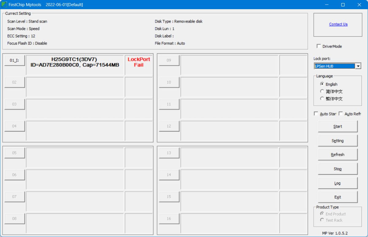

    No media but it's really 64 gig. I scanned with the FirstChip tool, took 3 hours and that took it from fake 2TB to "no media".
    Can it be fixed to be a 64 gig drive?

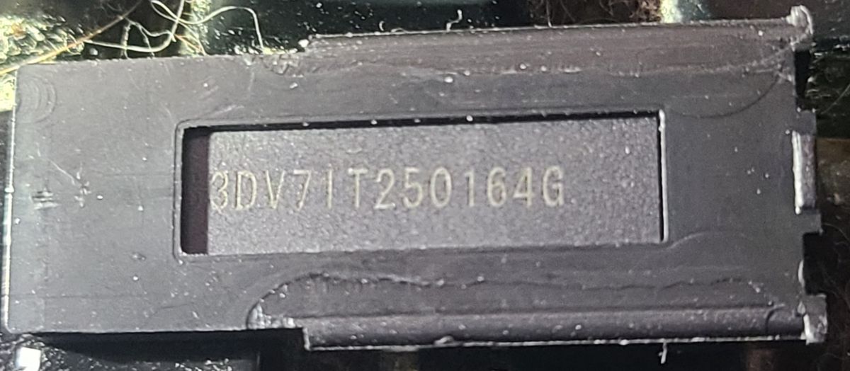

    Close-up of a black rectangular chip with the serial number 3DV71T250164G.

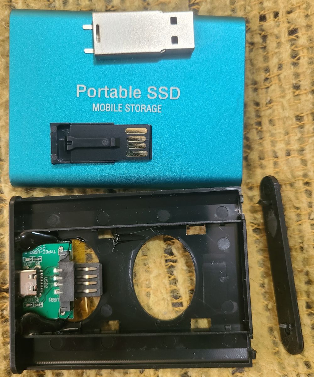

    Disassembled portable SSD enclosure with visible USB port and internal circuit board.

    Where do I set the mode or whatever? I click Settings and it wants a password.
    Screenshot of the FirstChip Mptools program showing a LockPort Fail error on a detected storage device.

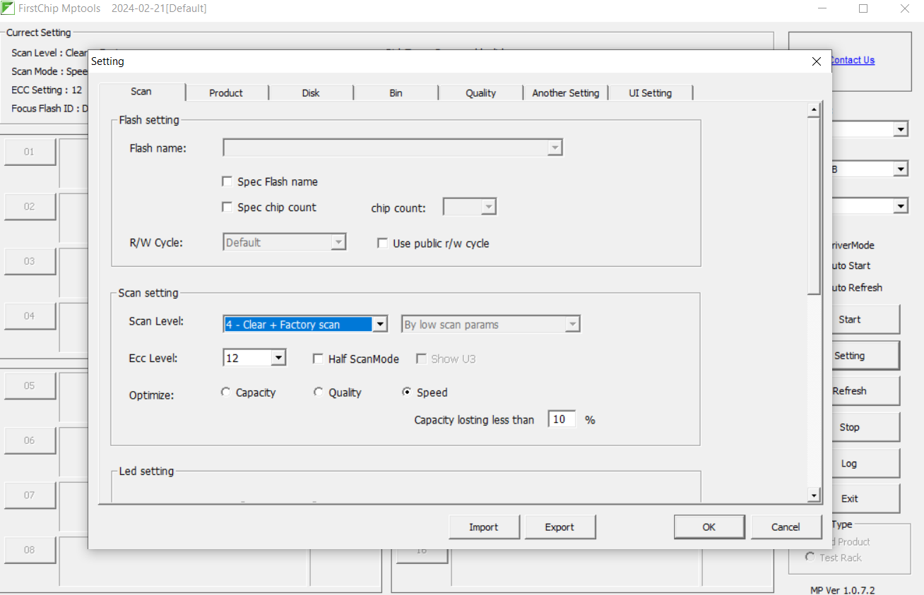

    There is no password, it's blank, just hit enter when asked to enter password.
    In settings, make sure under (Scan setting) to set level 4 (Clear Factory scan).
    FirstChip MpTools settings window with scan and flash configuration options.
    Wish you the best ✌👍
