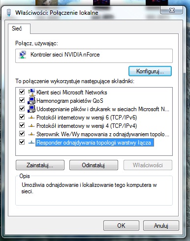

    How do I choose a protocol to change this data on the computer?
    Pentagram P631-4A + Asmax 1004G – how to extend Wi‑Fi to 2 floors?
    #16 9590632
    jlmrafael
    Posts: 195
    Help: 28
    Rate: 33
    Choose TCP / IP v4
