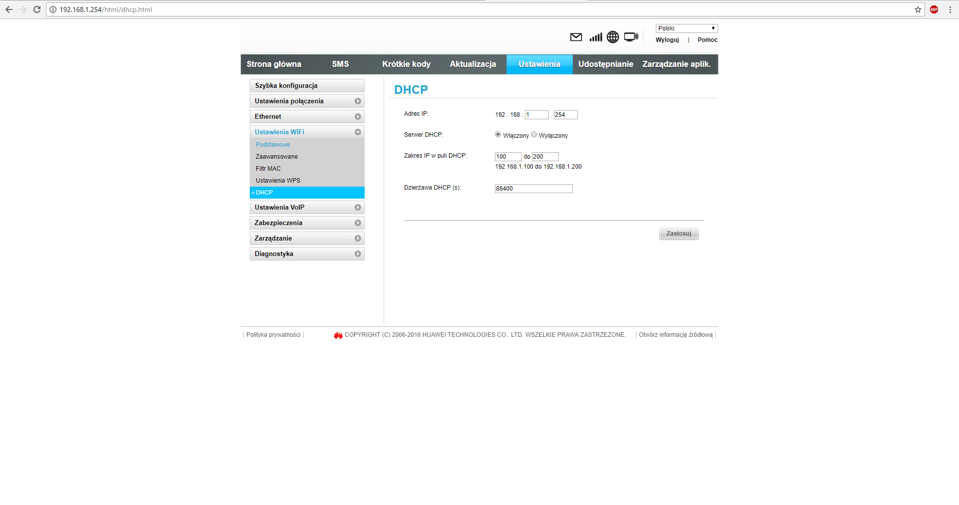

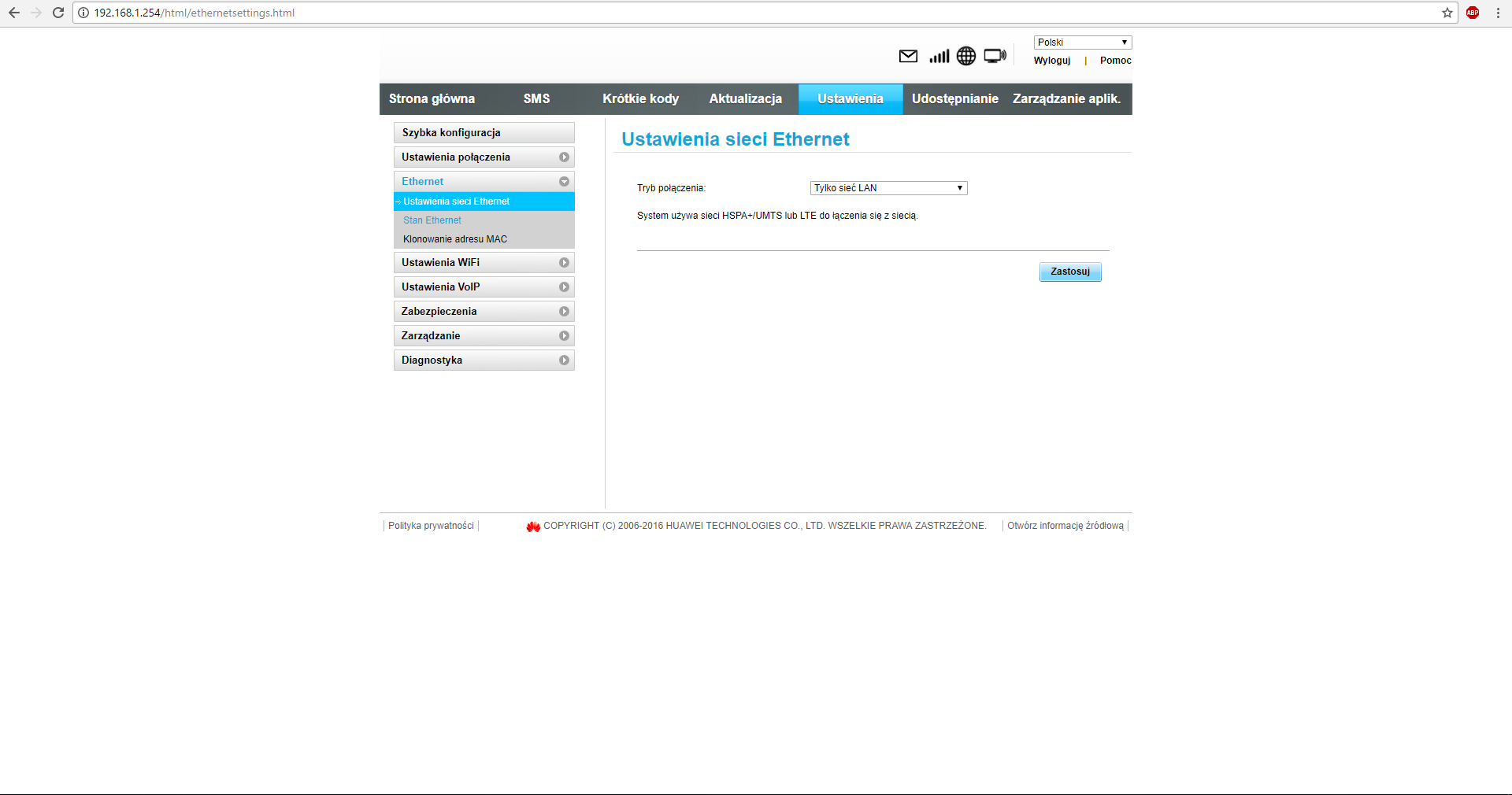

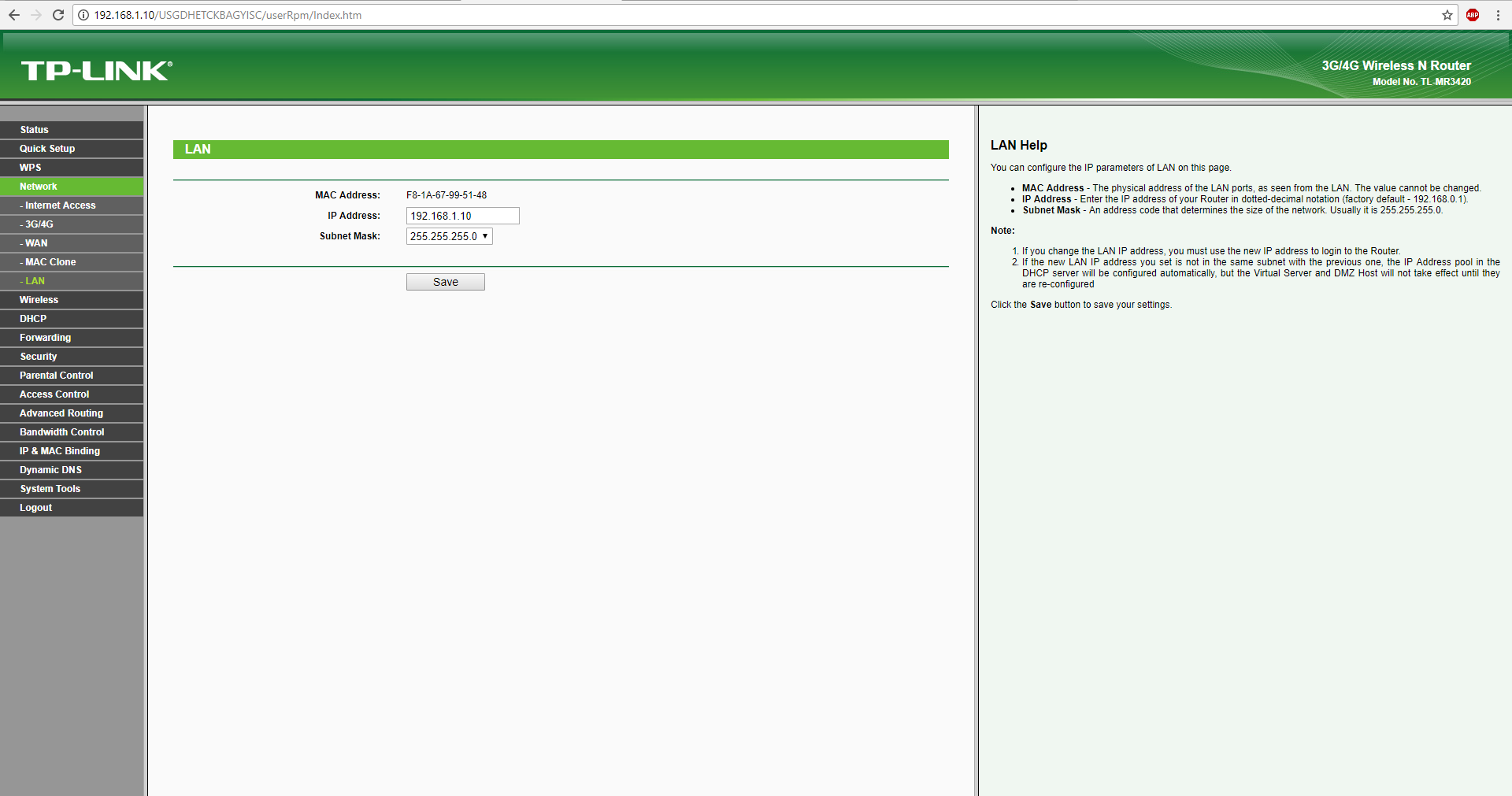

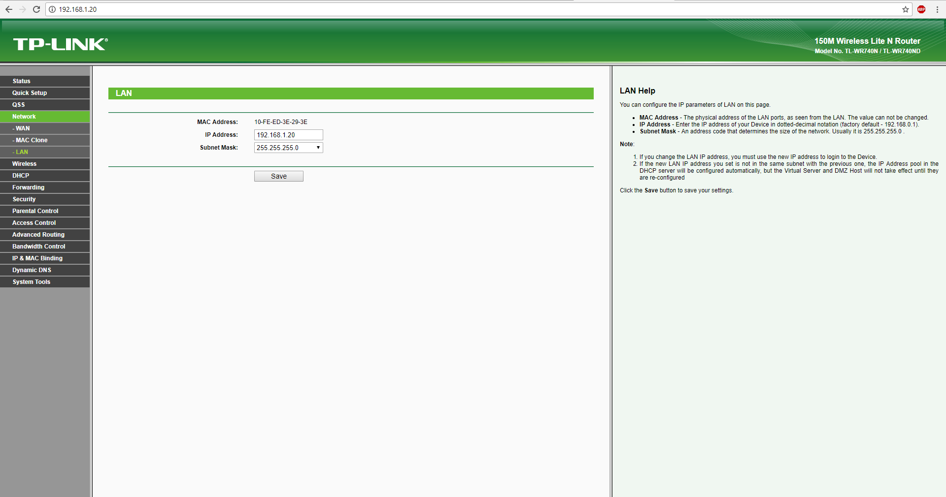

    I have been struggling for some time with remaking the wifi network at home, because someone constantly complains that it works poorly, although I have never experienced any problems myself, except maybe for a second breaking the wifi signal. I have a 2-story house, 3 routers and 1 swtich. I have Internet connected to the B315 router in the attic, which connects to the world with an antenna with an Orange transmitter (LTE internet). A switch is connected directly to the router in the attic. The router on the first floor and on the ground floor is connected to the switch via the LAN port on the router.
    Router configuration in the attic:
    Connecting Multiple Routers in One Network: B315 Router, Attic Setup, 2-Story House, LTE Internet

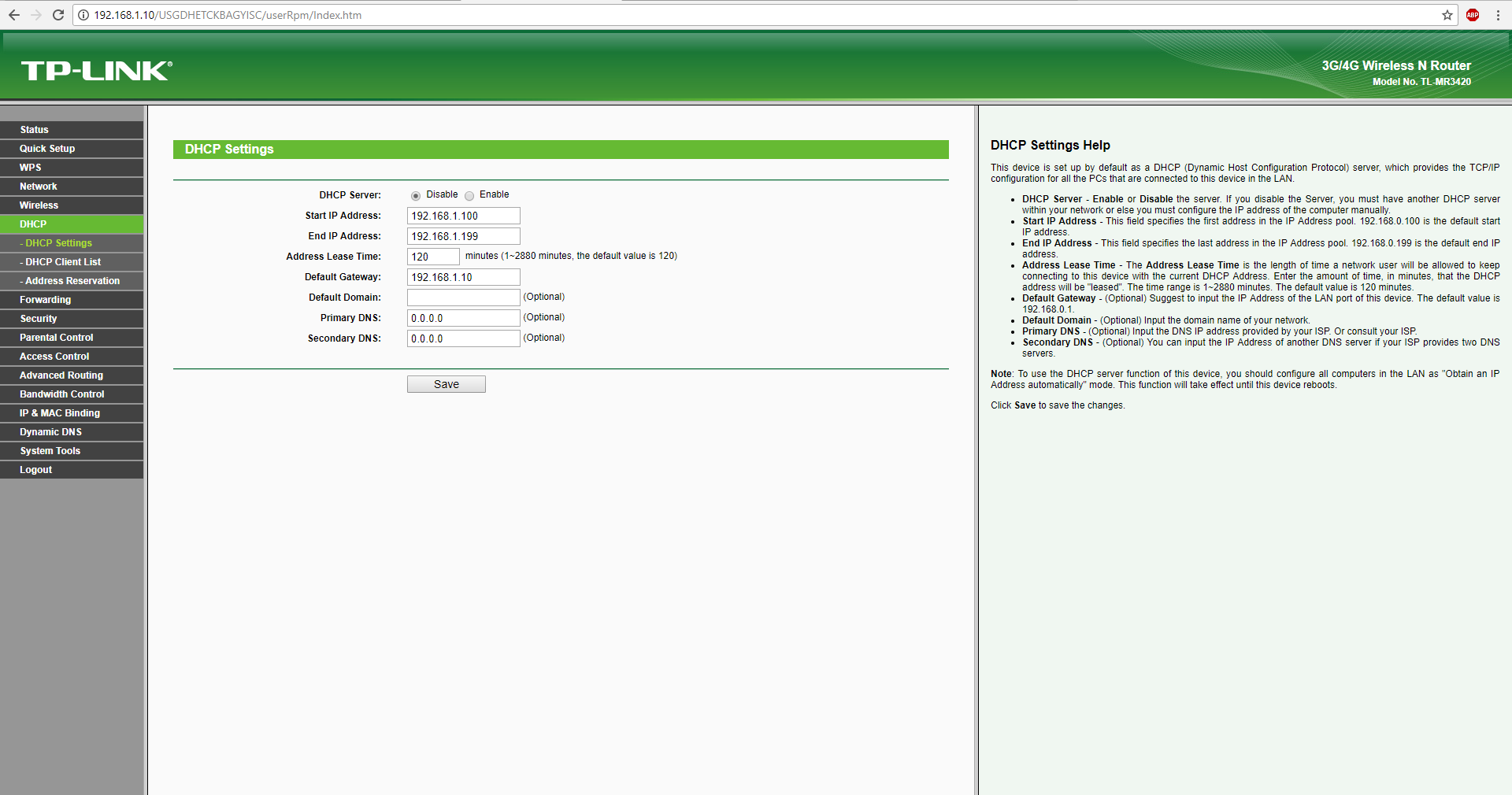

    Configuration of the router on the upper floor:

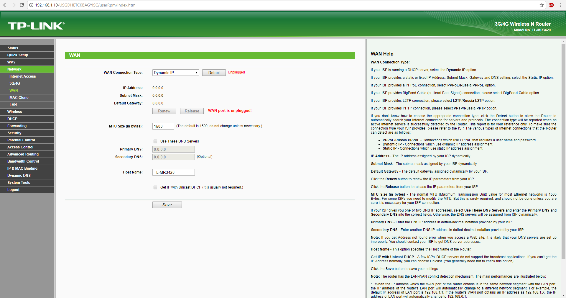

    Connecting Multiple Routers in One Network: B315 Router, Attic Setup, 2-Story House, LTE Internet (WAN not connected)

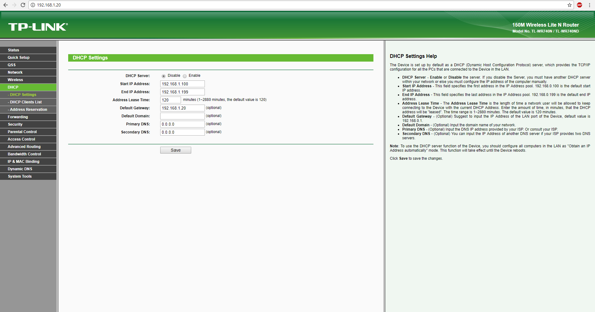

    Router configuration at the bottom:

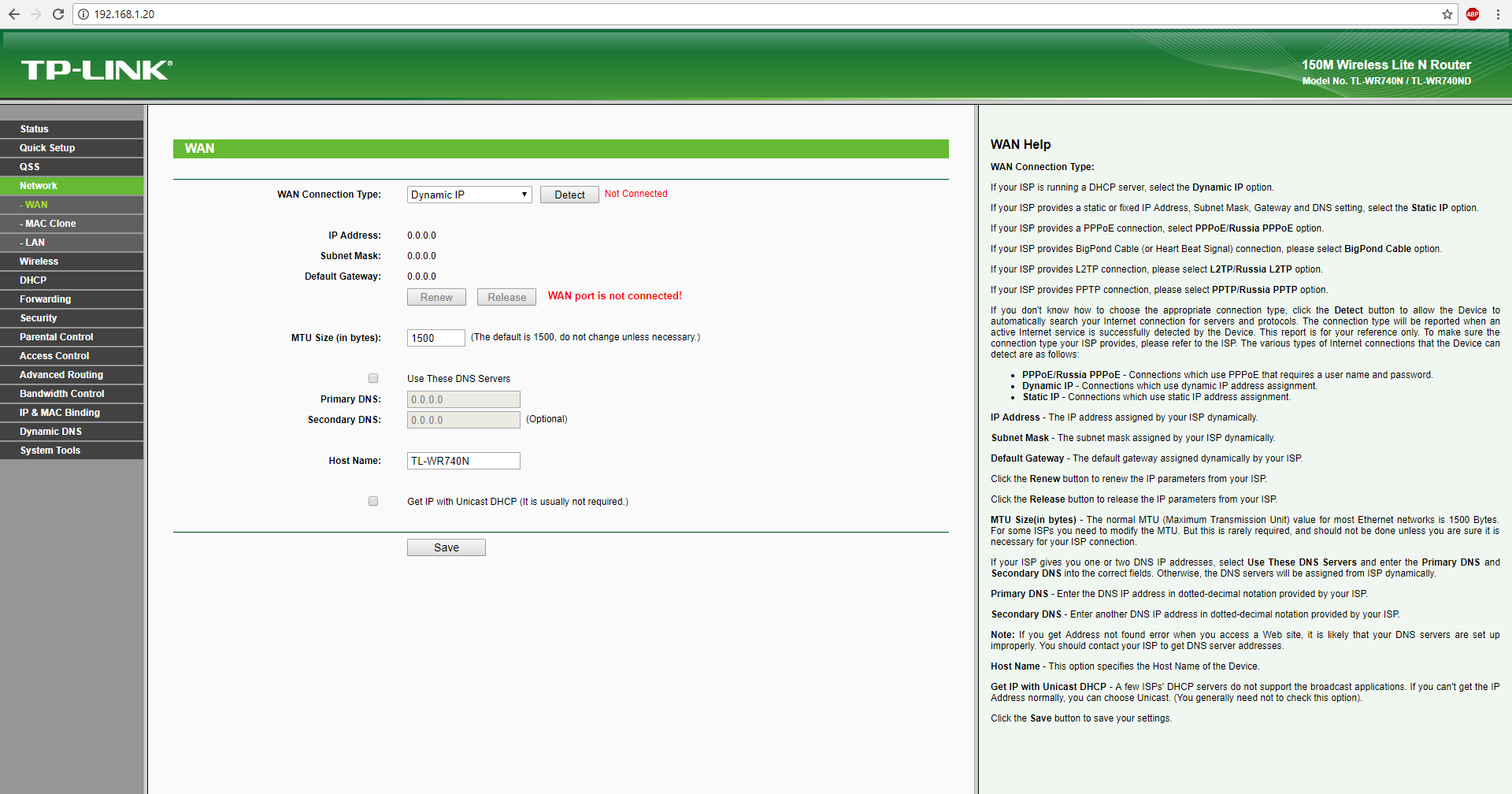

    As far as I know, the routers should be connected via WAN, but when I configured the network in this way, the internet did not work at all ^^. On such settings as it is now, the internet works on every device and every wifi, but sometimes something breaks (but only on wifi - the computer connected to the router on the first floor has no problems).
    I would like help with the configuration.

    Configuration https://forumsieciowe.pl/index.php?/topic/17-router-bbezpiecz wired-jako-ap-punkt-dost%C4%99powy/ Connection via LAN correct, routers work as AP with DHCP disabled. LAN addresses can be from the LTE router's pool and outside the DHCP range on it. The gateway setting is incorrect, it is the LAN address of the LTE router, i.e. 192.168.1.254

    Your settings are correct. If there was a problem with addressing, you can turn on DHCP on the other routers, you only need to enter the gateway address, i.e. IP B315
    If you want to be connected via WAN, set the LAN IP of the other two routers to e.g. 192.168. 10 .1 and 192.168. 20 .1
    DHCP is to be enabled on both routers. You set up WiFi so that the channels are not next to each other. e.g. downstairs 1 on floor 6 and in the attic 11.
    So what exactly needs to be changed, where? Because when it comes to Default Gateway, does it even matter when DHCP is turned off?
    Take a look at the first screen in the first post.

    rafor4 wrote:
    In the first screenshot I can't see anything about the gate: /
    A gateway is a router that has an "exit" to the world. In the case of your B315 it is the gateway and each device should have HIS ip as the default gateway address.
    His IP is described as "IP address"
