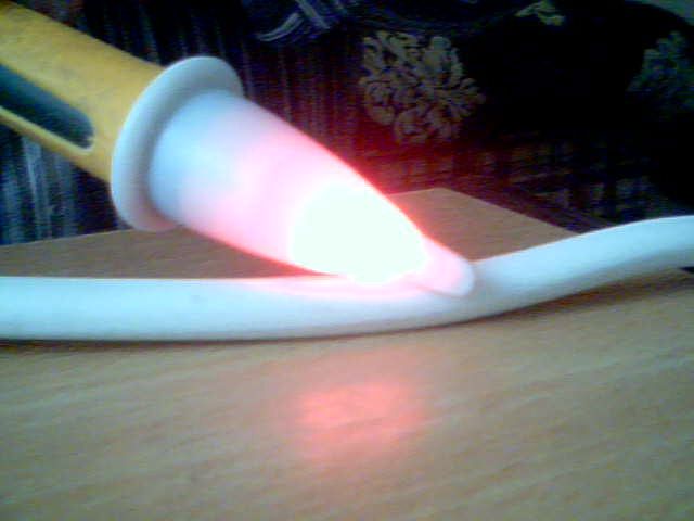

    The electrician should know that there are appropriate and simple tools for this to check whether or not voltage is present in the conductor before cutting it.
