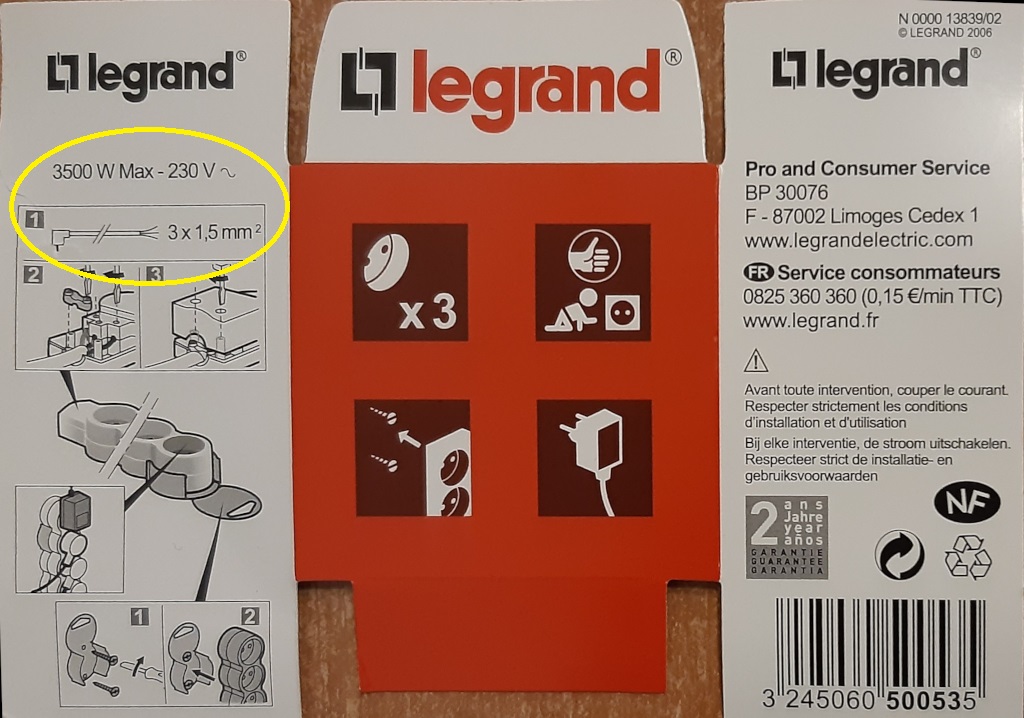

    I often make my own extension cords and will add some information to keep them in one place.
    Explanation for those who recommend "ready-made" and do not understand why you need to make an extension cord yourself: the folding box gives you the opportunity to make an extension cord exactly as needed - with an individually selected length (not from a series of types), plug (angled, straight, more grippy , ultra-flat, etc.), socket or sockets (multiplicity of branches, parallel, diagonal, transverse plug connections, visual matters) and cross-section (as well as color) of the cable adapted to the needs.
    Speaking of cross-section - advising 3x2.5 mm2 is an extreme, the more that the query started with a request for as flexible as possible medium power cable. Already 3x1.5mm2 is not very flexible, and besides, it barely fits in typical plugs and sockets of extension cords for assembly (I'm talking about accessories for amateur use).
    Currently, debt extenders are available in stores as standard. 5m on the cable 3x1.0mm2 with the given permissible load up to 10A (P max 2500W). For xenophobes - I mean "not Chinese", but a Polish manufacturer.
    In turn, from certificates issued by BBJ-SEP for debt extension cords. up to 10 m (also for a Polish manufacturer) you can find out that an OMY cable is enough to load 16A at 250V (which corresponds to 4000W power) 3x1.5mm2 (i.e. the certificate was issued for an extension cord with such parameters).
    I will use the example of a fairly well-known brand (as in the picture - attachment, it is not a "Chinese no-name"), where the triple socket is to handle the power of 3500 W, with power supply via 3x1.5 mm2 wires. In this case, the 3x2.5 wire really does not fit, it even "tears" the connection terminal of this socket.
    At the end, a curiosity - a comparative photo of the cable from the old extension cord (factory "no name", non-detachable, 10 A) and the new 3x1.5 cord. I think it gives food for thought what we buy in stores. The flexibility of the cable from the factory extension cable is simply due to the use of visibly thin wires. It is worth noting that the manufacturer assumed that the zeroing wire (the blue one) can be even thinner than the working wires. This is our reality: little copper, a lot of plastic (insulation) - as long as the business is good. The client won't even notice...
