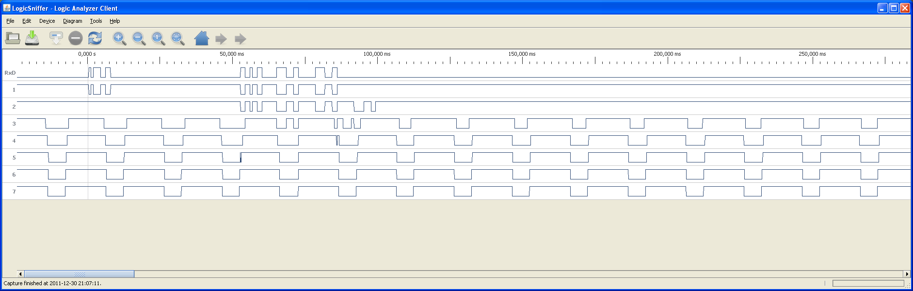

    [Edit]
    [stm32] [rs485] ST485CDR Interface, Voltage Converters & AVTMOD-03 Module: Communication Issues
    channel 0 and 1 is RS485
    channel 2 is tx uart
    Okay, all right - I just looked at it today.
    Thanks for the help.
