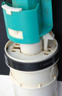

    I have a GEBERIT cistern installed in the toilet, art. No. 110.302.00.1, year of purchase around 2003 (unfortunately my bill has been lost somewhere). It is probably a Geberit Kombifix for the toilet, which is due to the number of the article stuck inside the tank, although one of the sellers during a phone call claimed that it was a Duofix.
    Geberit 110.302.00.1 / 240.622.00.1 – dual-flush valve not working?
    Installed toilet flush plate Twist (cut egg):

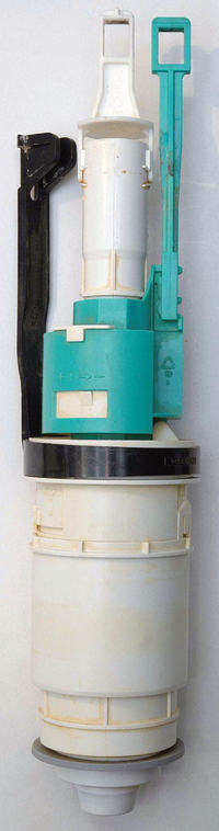

    There is a 2-way drain valve in the cistern which does not function properly.
    From what I found out in the materials available on the Internet, this is art. no. 240.622.00.1 Download
    The hooks visible at the top are for draining the water. The one on the right of a small number, and the one on the left - a large number.
    The problem is that by pulling the one on the right to flush a small amount of water, the hook can be pulled all the way to the top of both the tank and the flushing does not take place. The one on the left is working fine.

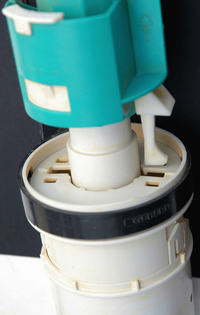

    Geberit 110.302.00.1 / 240.622.00.1 – dual-flush valve not working? Geberit 110.302.00.1 / 240.622.00.1 – dual-flush valve not working? Geberit 110.302.00.1 / 240.622.00.1 – dual-flush valve not working?

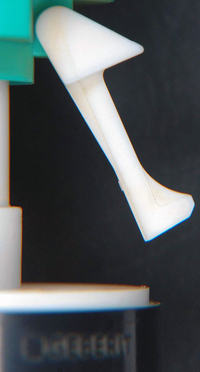

    There is a hook in the mechanism, visible in the photo, which, in my opinion, should catch in the visible hole when rinsing with a small amount of water, but it pops out of it.
    I watched it carefully:
    but no damage is visible on it.
    Please let me know how the flushing mechanism works with a small amount of water and what is the cause of the failure.
    I think that if I know how these parts should work together, I will remove the failure without any problems.

    In the 2nd photo - the middle element with a square hole at the top (such a cone) has two hooks securing it to the body below in 2 places (left and right). It should be disassembled with sensitivity (because it is plastic), pry so that the hooks pop out of the holes. The same applies to the element with a square hole on the right and then you will be able to tilt the entire valve and pull it out of the hole in the bottom of the flush at an angle.
    You have to reduce the length of the valve (height) or it won't come out.
    You will see for yourself what will stand in the way of pulling out.

    Broken catches. You can't see it, but at 99.9% it is. The situation is the same as for me. The valve to be replaced with a new one - unfortunately expensive.

    That's right, these plastics tend to have tiny tears that are dense and hard to see.
    If it does not function properly even though all components are in place, there is a slight crack somewhere - a damage that is difficult to locate.

    Old topic, but after reading it, I made an attempt to fix it.
    The green tongues at the top of the cup break and lift the entire white central pipe. I found only one, the second one has probably been flushed with water a long time ago.
    I drilled 2 holes on both sides and tightened the screws. After putting the green cup on the white pipe, I unscrewed them slightly so that they hooked and lifted the pipe later.
    It flashes like new and saved several dozen zlotys.

    The white hook at the bottom must be slightly hidden in the opening of the outer body - otherwise, after flushing, the water does not fill the tank and flows freely into the sewage system.
    Therefore, in place of broken plastic hooks, the screws should be screwed in as high as possible (even slightly slanted) - so that the white hook remains hidden in the external body.
