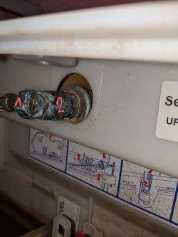

    Thank you very much for your answer! It complicates the situation a bit because I do not know if I can handle this task, i.e. replacing the valve that closes the water supply. I have no idea what parts and seals / tow (?) Should I buy to replace the valve at this point. This is a bit of a question of the genre: please make a list of things that I need to buy in the nearest store :)
    This is what the water shut-off valve looks like in the photo:
    Fixing Geberit Cistern Leakage: DIY Troubleshooting & Repair Guide (Photos Included)
    Is it about replacing the marked element in photo 1 or also 2? (whole)

    Hello, you only need to replace the float set, you do not forge anything, you do not regenerate it, such a set is not expensive, you only need to know the model, unscrew the hose from it and replace it, remember to turn off the main valve before replacing it. Regards.

    I'll try to do it as soon as I can get that fill valve. I just have no idea what thread I have if 1/2 or 3/8 ''. There are two versions on sale, and I wouldn't want to buy something that doesn't fit. Is it possible to determine after these photos that I have posted?
