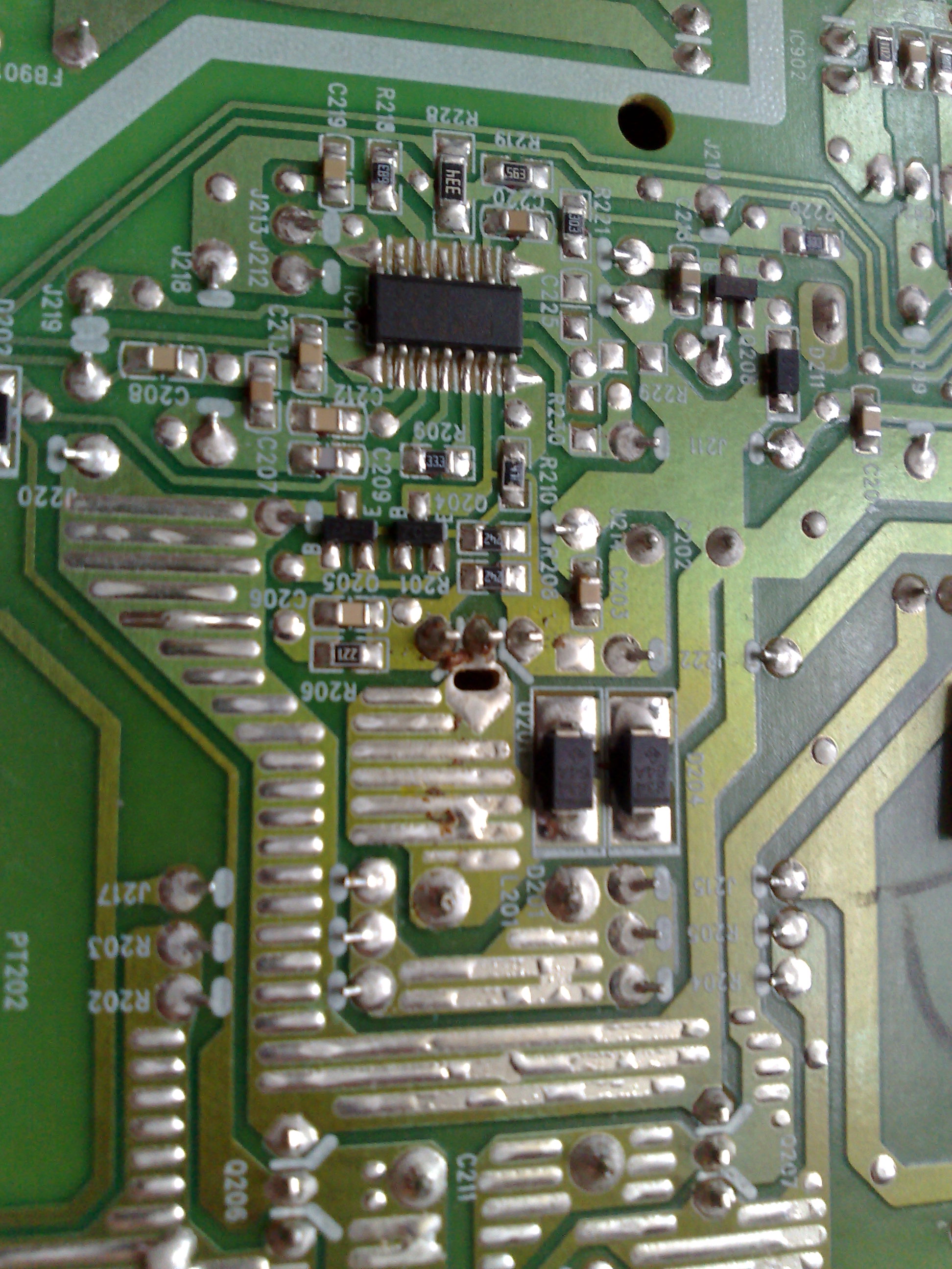

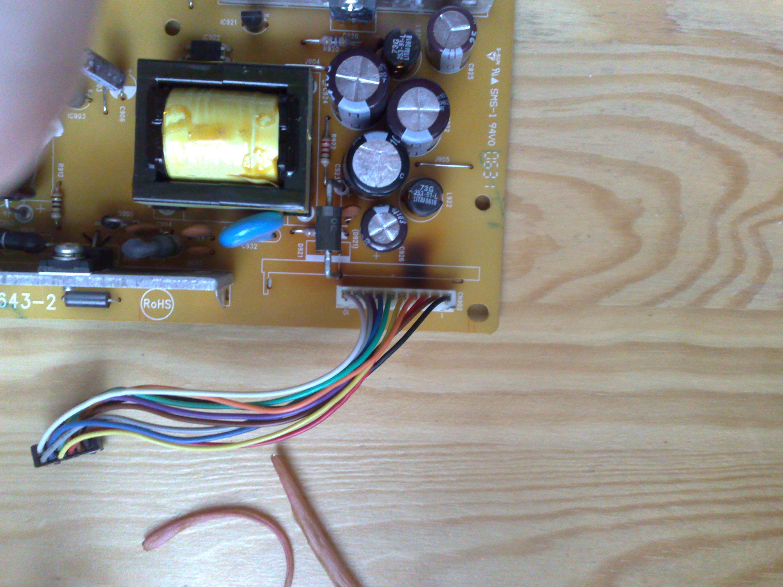

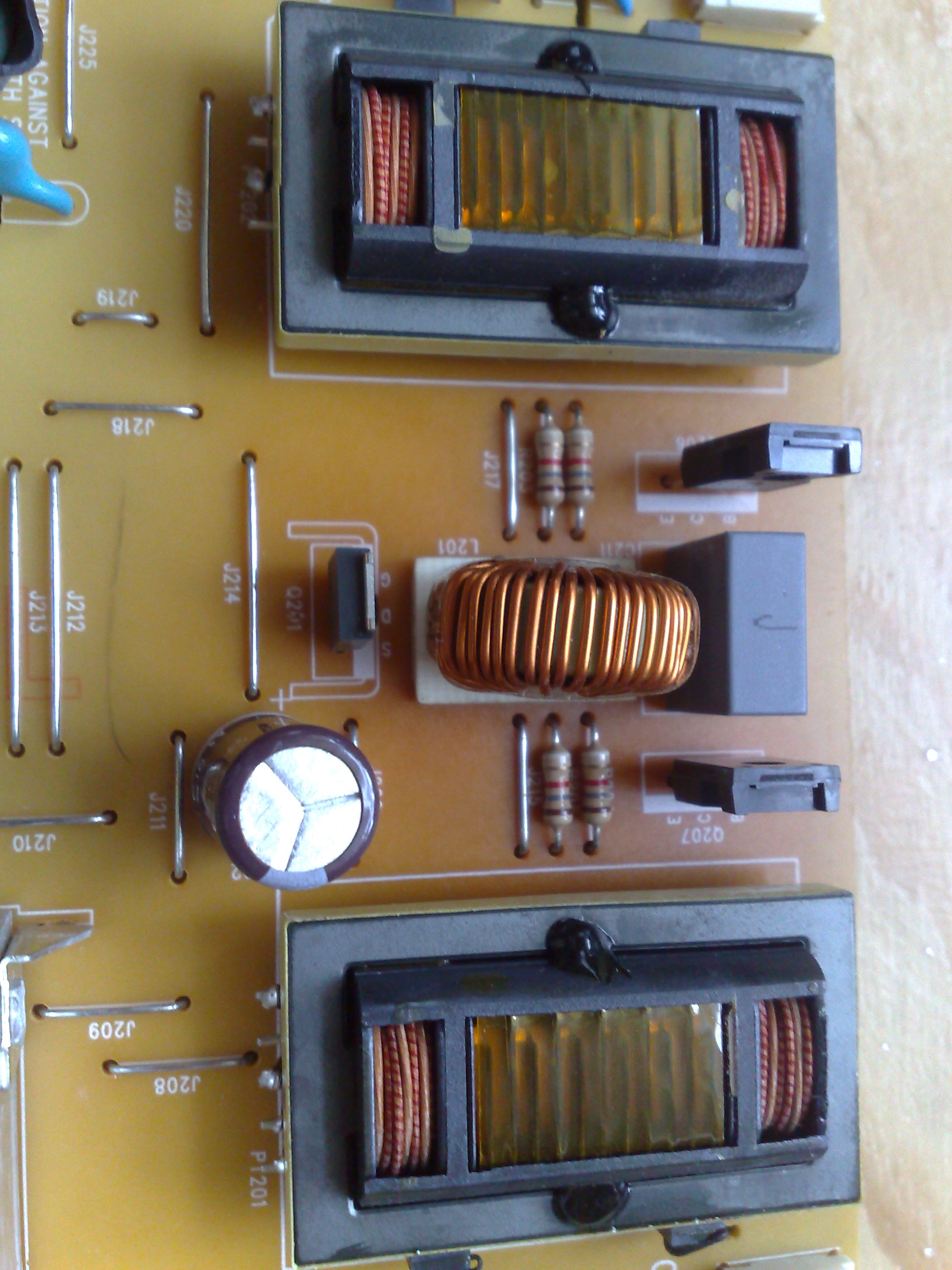

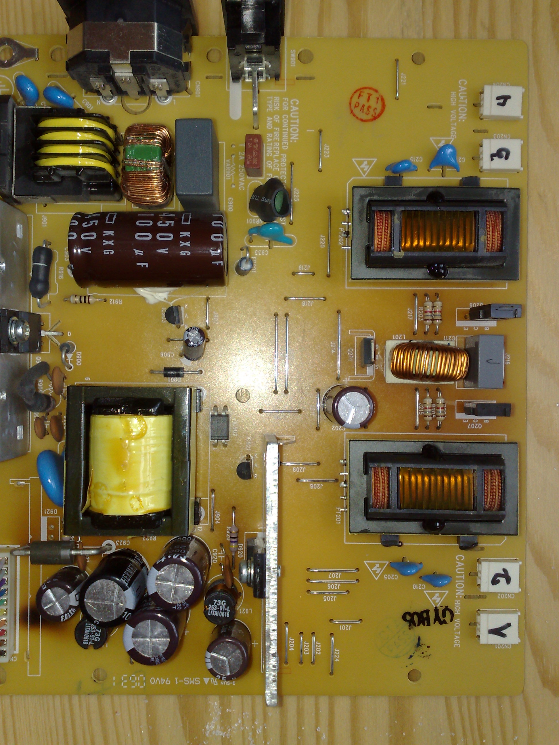

    Hello, I recently bought a used monitor on the allegro Fujitsu Siemens ScenicView P19-2. The monitor came from 3 weeks and was used about 6 times after which it stopped turning on and the blue LED was constantly flashing. I undressed it and found a burnt element marked on the power board (S.18 64). The coil plate slightly changed color and a little tin melted from the bottom. I attach photos and I am asking for the name of this part and marking, I will look for the Allegro or go to the electronics store, buy and exchange.

    It is a zener diode, what voltage you need to see what is supplied by the pins behind it. Waste it and measure the tension at its soldering points. If she was so hot, there must be a fault in the line that she protects.

    Today, I desoldered this diode, in total it crumbled in my tongs and desoldered the rest. On the line where there was a diode everything looks fine but I can not find my meter for china and I can not measure anything right now. I saw here on the forum that someone had a similar problem and maybe this is the solution for me?
    https://www.elektroda.pl/rtvforum/topic1062016.html?sid=0192dfd116a6d290404cbd37be54d938 my diode mark is ZD920, maybe a friend did a typo and it's the same?

    Cool, I still do not know what to do. The main board of the monitor looks good, the elek do not swell the whole paths, in that area my friend used a 7.5V diode only which I can solder 0.5W or 1.3V because I do not know which order.

    And what is the question and where from this symbolism
  • #10 11123210
    Raiz3n
    Posts: 427
    Rate: 76
    On allegro I found diodes with the given power of 0.5W and 1.3W hence the symbolism. Can I solder sod80 instead of diode in sod123?

    Today, the diodes come, however, after soldering the problem remains, the diode shines only a little brighter or it seems to me, after the power supply is disconnected, another 5 seconds is flashing. I do not think it's my strength and I leave the monitor to a professional, thank you for your help.
