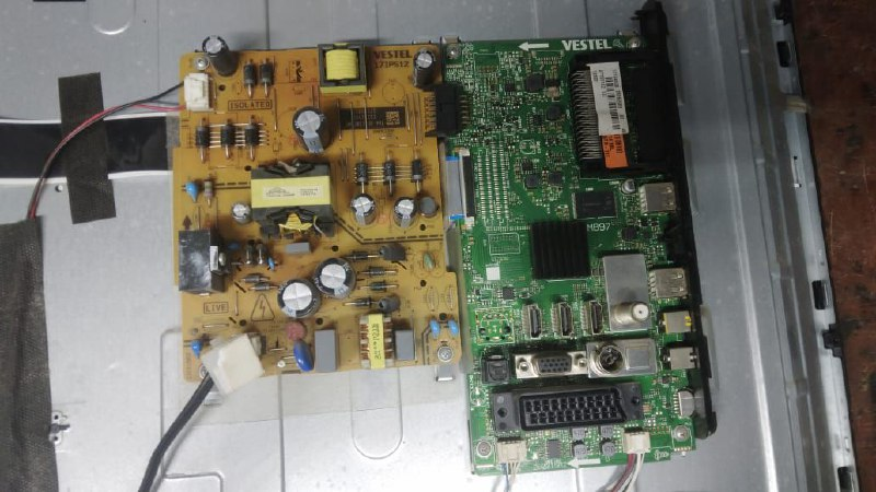

    problem in toshiba 49 mainboard 17mb97 power 17IPS12 blinking 6 times
    Printed circuit boards with electronic components on a metal base.

  • #3 21490438
    ammar_hesham
    I After a lot of trouble, I solved the problem by canceling the inverter IC protection by connecting pin 12 to the ground.
