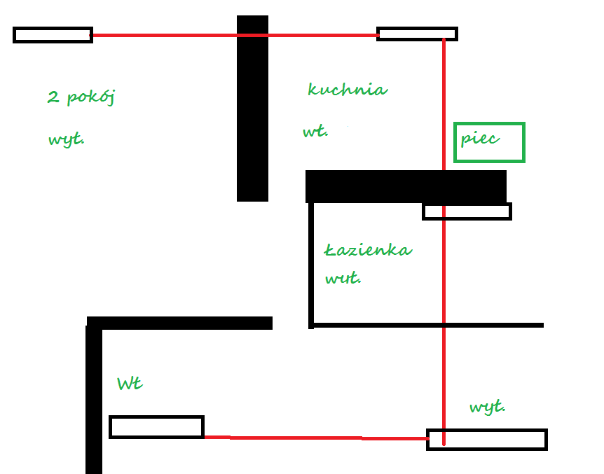

    Hello and welcome. I have a question for you. I have a gas stove, which is responsible for heating the apartment and water. I don't like to use gas excessively because bills in winter are huge. As you know, in 2-3-4 months the heating period will start. I wanted to ask, according to the information contained in the subject, whether only 3 radiators in rooms where I am not staying will help me save some money in the winter? Will the fact that 3 radiators be turned off will reduce gas consumption significantly?
    I will add that these are the type of radiators link

    If you have thermostatic heads, turn them by 1 interval, but not much, because the heat will still escape through underheated walls.

    More heat receivers - more consumption - more consumption. But let's not go to extremes. Aluminum radiators are highly efficient. The bill won't kill you. Unless you are heating a bottomless well, e.g. a garage

    If you reduce the number of radiators, and the air flow between the rooms remains, you can even count on increasing gas consumption, because the boiler will then work to the max to heat it, and then it has lower efficiency.

    And I would stick to these heads myself. Specifically, their absence. Install it and you will see the difference. And maybe some kind of room regulator. This helps you save.

    I'll write like this. The stove automatically heats the water in the radiators from time to time.
    I usually set the temperature of the stoves to the minimum, up to 45-50 degrees.
    Yes, there is actually 1 radiator in the small bathroom. This one will be disabled.
    The 2nd radiator is in the kitchen it is turned on and another one in the 2nd room where no one is staying is such a room that I will write so for a picu.
    I have 2 radiators in my room, but for certain reasons, 1 was mostly covered with a wardrobe, which at the moment I can't get out because there is no wallpaper on the back and we know what it would look like. I'll be painting it next year, so I'll reveal it then. And above the bed I practically have 1 large radiator and I want it to heat only it.
    can provide a diagram for formalities.

    In each room, it should be opened minimally so as not to cool down much because of moisture and mushrooms :D . Well, besides, with 1 or 2 radiators, the boiler will be HIGHLY clocked.
