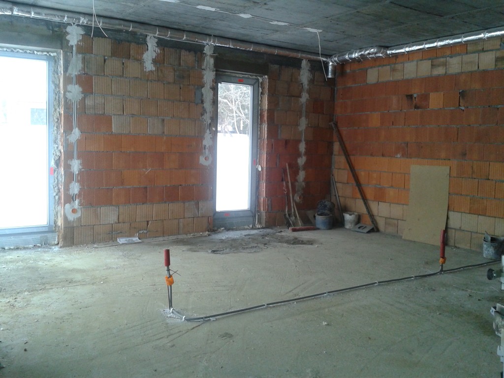

    So far I managed to get out of running UTP cables in the floor, but this time I have no choice (the devices will be in the center of the room). In addition, there will be underfloor heating. What solution do you propose? I thought about a hard PVC pipe, but it can complicate the heating, while the conduit will be less resistant, although more "configurable" in terms of its track. The second thing - it makes sense to use a tube or conduit (apart from protection against physical damage in time before the screed), since the concrete will get there anyway through the ends (you can possibly protect with foam, but the part outside the tube will be flooded anyway). The only plus I can see is the protection against stretching / shrinking of the cable, which will not have direct contact with the concrete, but the matter of short sections from the end of the tube to the top of the floor remains.

  • #6 12307532
    Volt-rom
    Posts: 81
    Help: 5
    Rate: 42
    The heated floor makes it easier to guide the pipes or a conduit, because polystyrene is laid. Of course, this must be done before laying the heating pipes. You have to think more about the number or diameter of tubing you will need.

  • #8 12307574
    jimasek
    Posts: 35287
    Help: 3783
    Rate: 2681
    I usually stick a metal rod 50-70cm long into the floor and hang the ends on it (making a circle from the stocks). You will have all above the level of the spout placed. On the walls, the installation is usually terminated with installation boxes together in the 230V segment.

  • #10 12307702
    jimasek
    Posts: 35287
    Help: 3783
    Rate: 2681
    Jacek28 wrote:
    There will be sockets in the middle of the room,
    I am talking about it exactly, in the place where the socket will be, you drive the rod (or whatever you want) and attach the wires to it (tape or band). The cable protrudes above the target floor and does not get tangled up between anyone's legs. You will have access to it yourself after installing the central heating and laying the floor.
    Something like here:
    UTP Cables in Floor with Underfloor Heating: PVC Pipe vs Conduit - Pros, Cons & Installation

  • #16 12308745
    Jacek28
    Level 19  
    Posts: 565
    Help: 5
    Rate: 46
    Now I know what you meant (one picture replaces a thousand words). I thought you wrote about hammering a rod against a wall.
