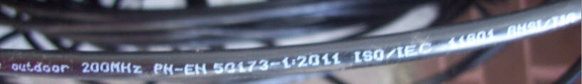

    From what I have read, the description on the cable is as follows:
    GetFort GF-5UTP-UU U / UTP 4x2x24AWG (0.5) cat.5e outdoor 200 MHz PN-EN 50173-1: 2011 ISO / IEC 11801 AHSI / TIA
    The person who sold the cable said it could even lie in the water.
    Below is a photo of this cable:
    Location of the twisted pair in the ground in the pipe or without?
    Can anyone provide links to stationary and online stores where he bought a cable that is actually adapted to be laid in the ground?

    Do not take a picture of the entire disc of the cable, because it will not help. Take a clear picture of the marking on the cable.

5. How do I confirm my cable is truly ‘earth-grade’?
Check printed markings for “outdoor”, “direct burial” or standard EN 50173 with gel specification; peel back sheath—gel should coat pairs and an Al/Moisture foil should be present [Elektroda, mariusz77_, post #17183531]
