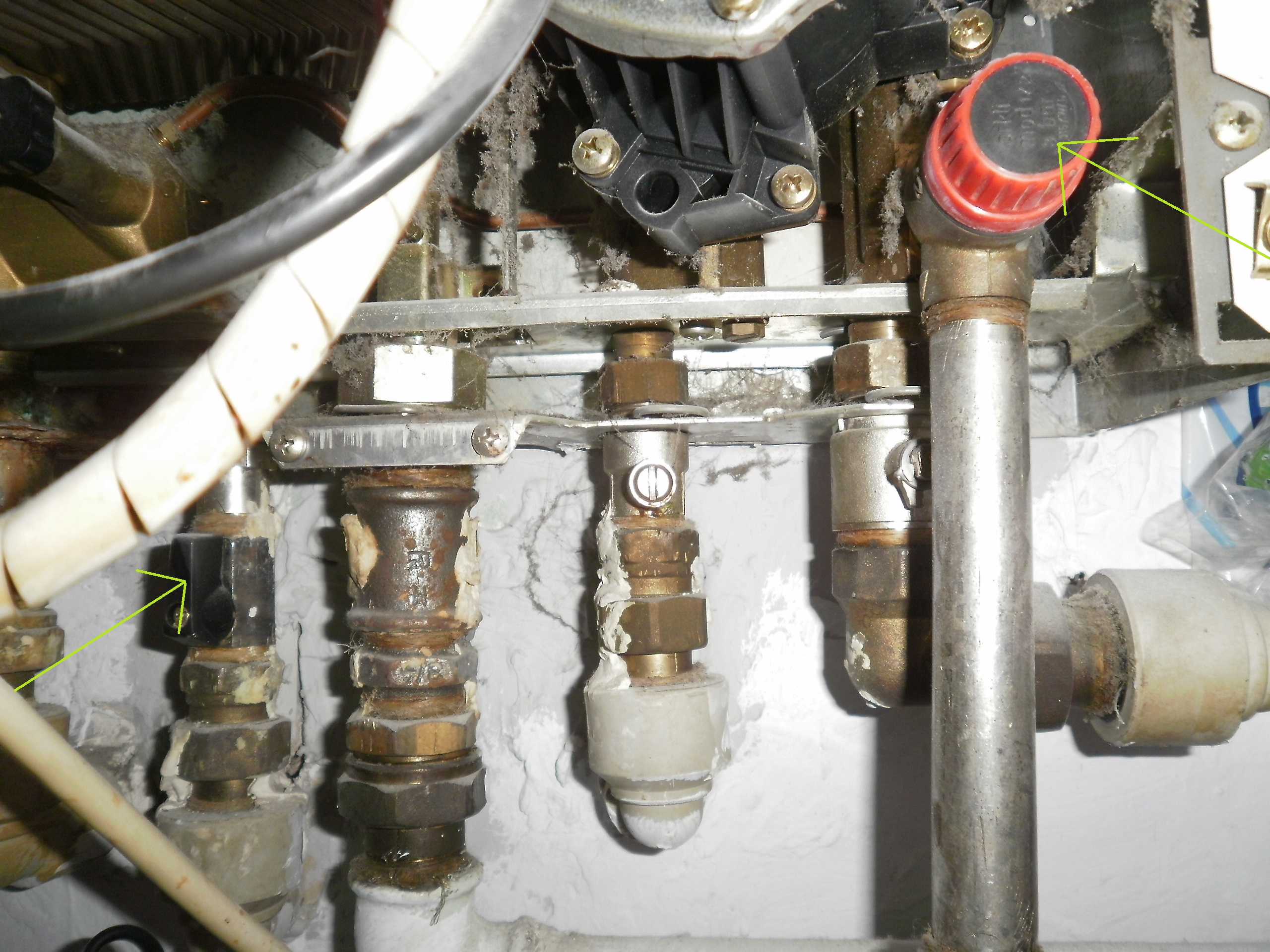

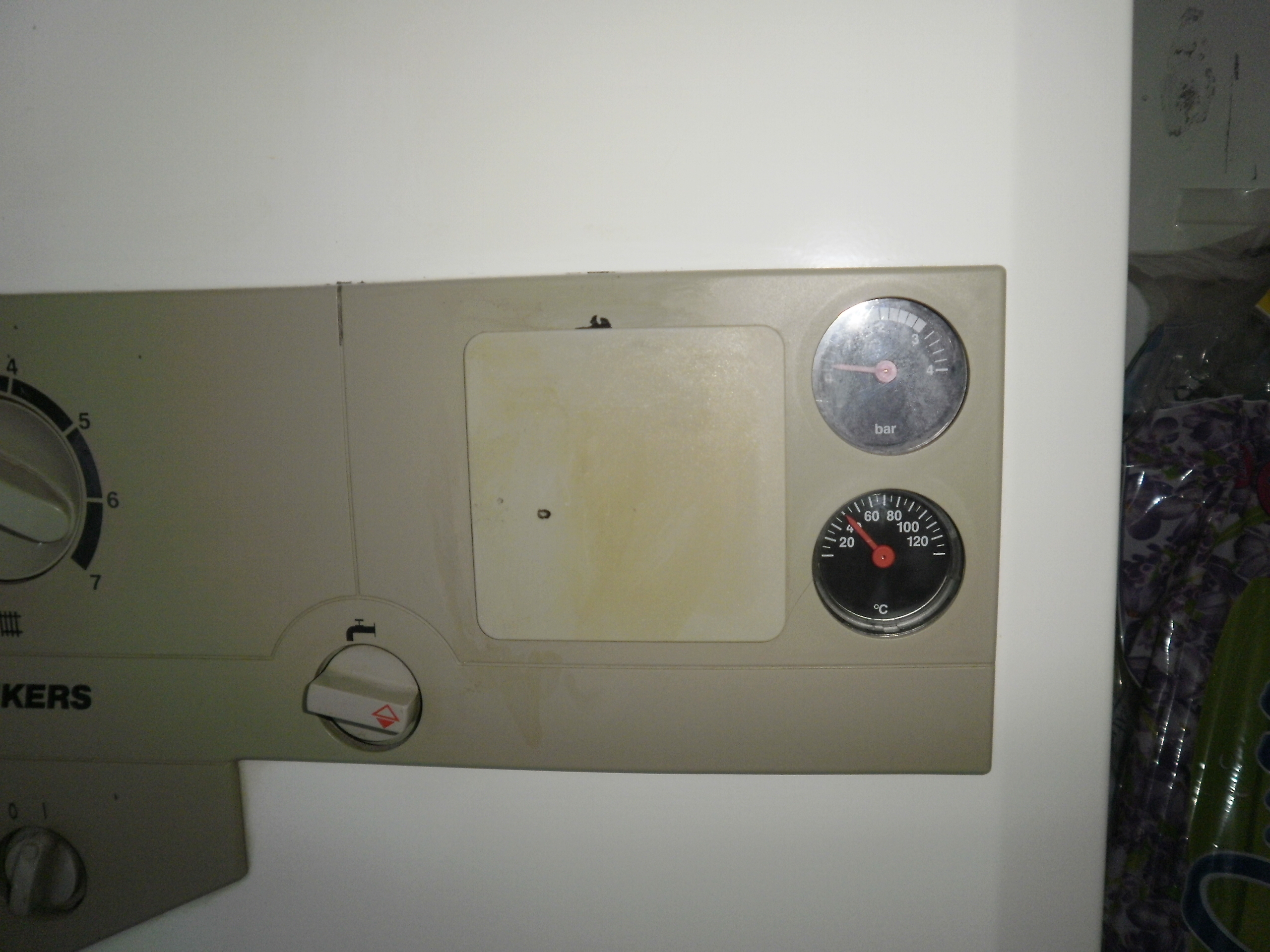

    I wanted to turn on the heating today and unfortunately I have a problem. I turned on the JUNKERS gas stove and so: 2 radiators are hot 2 slightly warm and the bathroom is hot at the bottom, cold at the top (I have already vented all of them, the bathroom was the only one that did not start dripping water after a hissing sound). I have noticed that the pressure on the stove is very low (less than 1bar). How to increase them, how to add water to the stove? Is adding water enough to make the radiators warmer? I am sending you a photo of the valves under the stove and I am begging you for help because I am freezing. I am a layman, I do not understand what is in the manual, please indicate any valves that I should unscrew in order to increase the pressure in the furnace (I only see 2 black on the left, red on the right, marked with arrows). Thank you very much

    Hello, if I am not mistaken, the supply of water to the system is in this case on the left side of the boiler, take a photo of the entire bottom of the boiler.

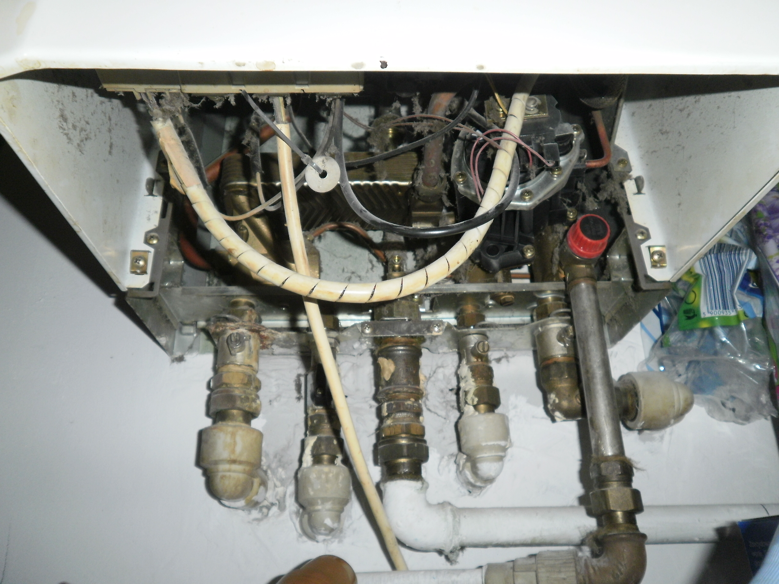

    here is a picture of the entire bottom :( no other valve can be seen here except the red and black one. The manual says unscrew the valve 38, but it is not known where it is: http://www.serwisjunkers.pl/pliki/instrukcje/...otla%20Junkers%20Novatherm_od_AB_Solution.pdf

  • #4 12812043
    W0jtek92
    Posts: 3852
    Help: 469
    Rate: 1258
    Hemm. The valve seat is blinded to my eye. It's weird. But maybe you have a valve installed in the installation somewhere?

  • #7 12812607
    zyzia3
    Posts: 21
    Rate: 37
    thanks Magister for seeing it. I understand that I have to turn off the stove and turn this valve to the left until the pressure is high. Then turn on the stove and bleed the radiators again?
  • #8 12812660
    Magister_123
    Level 36  
    Posts: 2893
    Help: 378
    Rate: 974
    Exactly. When the pressure jumps up to bleed the radiators. Allow water to reach 1.5 bar.
    Check that after adding water and restarting the boiler, the pressure on the pressure gauge does not exceed three.

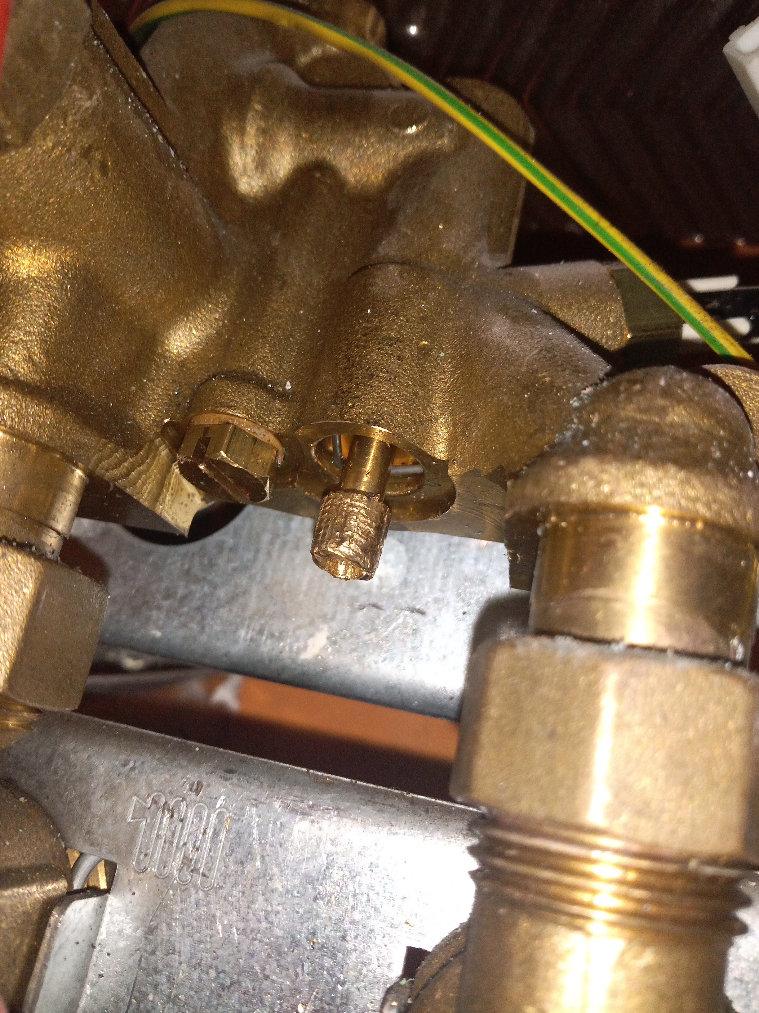

  • #9 12812676
    zyzia3
    Posts: 21
    Rate: 37
    unfortunately, when the stove is turned off and the valve is unscrewed, the barometer needle will not even vibrate (the stove does not make any sounds)
  • #10 12812755
    Magister_123
    Level 36  
    Posts: 2893
    Help: 378
    Rate: 974
    This is 100% feeding water into the boiler. Maybe you have something clogged up. The barometer also likes to freeze.
  • #11 12812768
    zyzia3
    Posts: 21
    Rate: 37
    I succeeded. Thank you very much :)

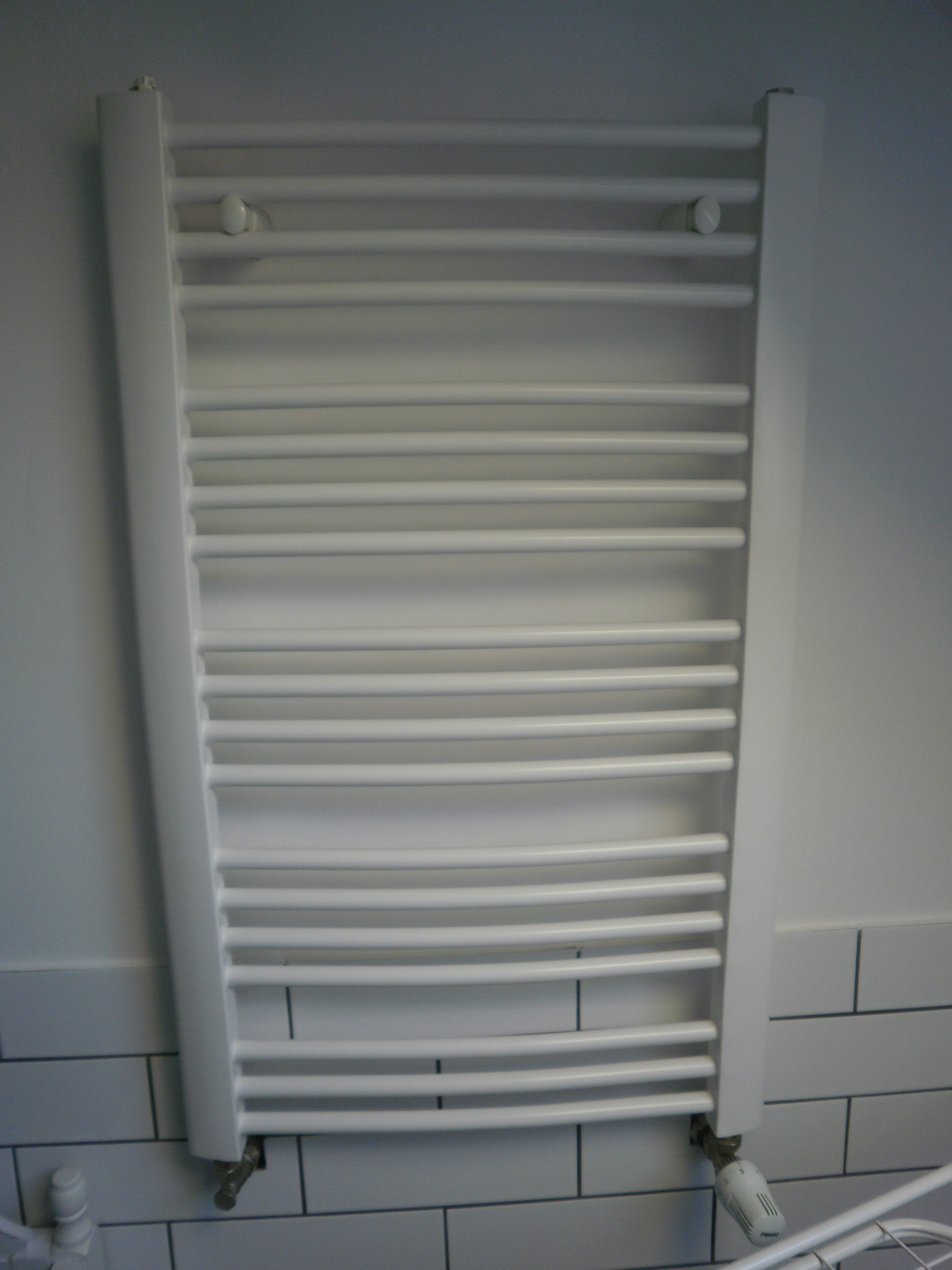

  • Check radiator valve and system balancing for poor heating
    #12 12813392
    zyzia3
    Posts: 21
    Rate: 37
    top-up water, the radiator in the bathroom heats up. The only problem is that it seems to be the last radiator in circulation, it is in the bedroom and it is only lukewarm on the entire surface. Bleeding it didn't do anything. So is there anything else I can do with it? Increase the pressure even more so that hot water can get there (the water that flows out of the vent valve is only slightly warm)? Unscrew something at the radiator?
  • #13 12814440
    Magister_123
    Level 36  
    Posts: 2893
    Help: 378
    Rate: 974
    Gently twist the heaters closest to the boiler.

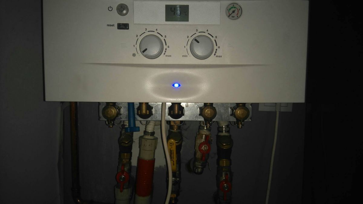

  • #18 17010092
    Psycho_Boy
    Rate: 8

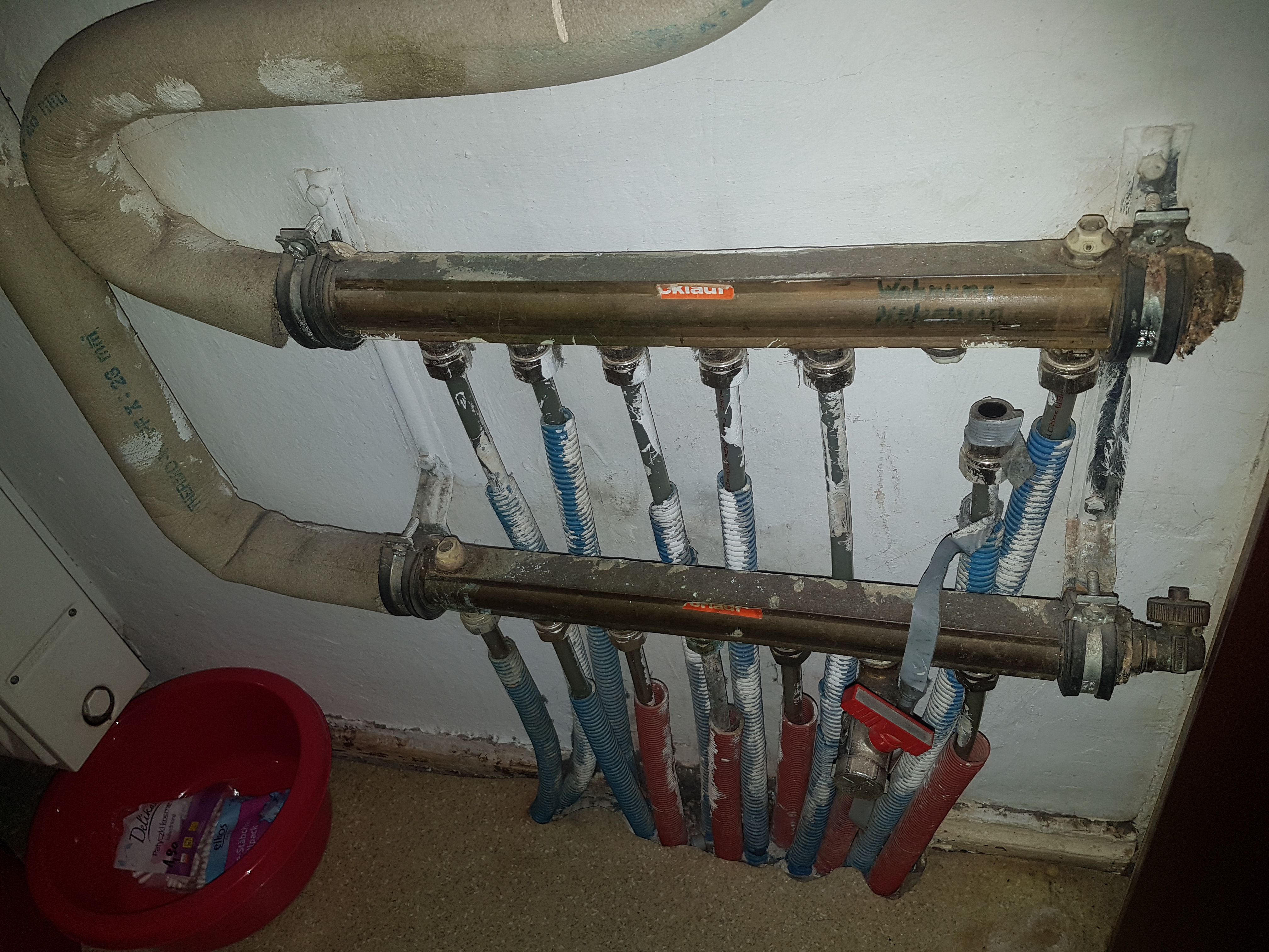

    Hello, can anyone tell me where I am allowed to use water? No pressure, heaters cold :(
    • JUNKERS ZW/ZS 20 KE – pressure below 1 bar, how to add water? 15176776406251353547252.jpg (3.92 MB) You must be logged in to download this attachment.
  • #19 17010175
    Magister_123
    Level 36  
    Posts: 2893
    Help: 378
    Rate: 974
    I wrote back to PW that you are looking in the wrong place. More photos in the glue pipes under the boiler.

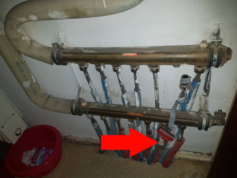

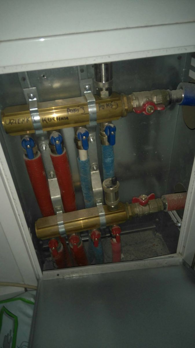

  • #20 17010600
    Psycho_Boy
    Rate: 8
    Is it about these pipes?
    • JUNKERS ZW/ZS 20 KE – pressure below 1 bar, how to add water? 15176887051861222467014.jpg (4.42 MB) You must be logged in to download this attachment.
    • JUNKERS ZW/ZS 20 KE – pressure below 1 bar, how to add water? 1517688689958493303787.jpg (3.89 MB) You must be logged in to download this attachment.
  • #21 17011097
    Magister_123
    Level 36  
    Posts: 2893
    Help: 378
    Rate: 974
    99% of it is the valve marked in the photo. Of course, there should be a hose with properly fitted couplings.

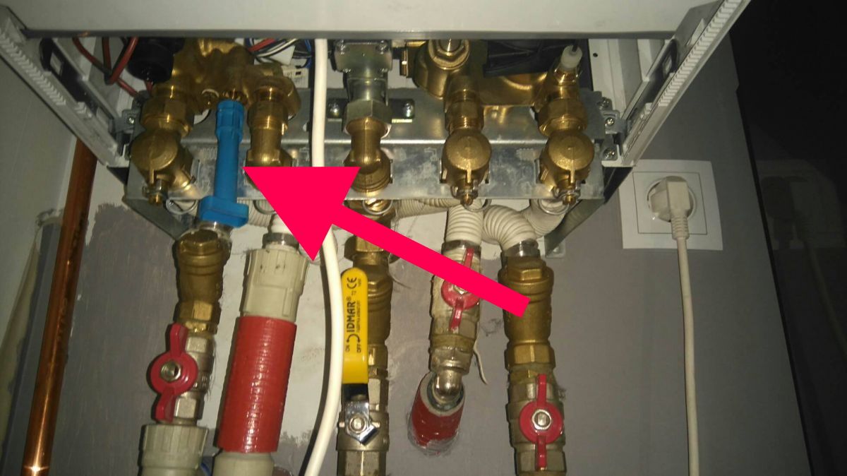

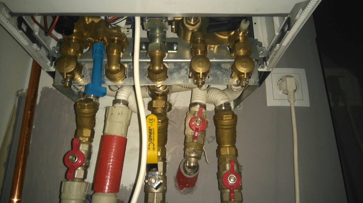

  • #23 18385168
    mikimouse12
    Hey, my stove pressure is too low too. I tried to locate where the tributary is, unfortunately it was not possible. The stove is Junkers Ceraclass. Thanks in advance for your help
    JUNKERS ZW/ZS 20 KE – pressure below 1 bar, how to add water? JUNKERS ZW/ZS 20 KE – pressure below 1 bar, how to add water? JUNKERS ZW/ZS 20 KE – pressure below 1 bar, how to add water?
    #24 18385202
    Magister_123
    Level 36  
    Posts: 2893
    Help: 378
    Rate: 974
    @ mikimouse12 In the third photo: BIG BLUE KNOB.
  • #25 18385308
    mikimouse12
    [quote = "Magister_123"] thanks :) indeed it was it, only that blue handle was frayed on the thread and it wasn't twisting the screw. Made with an hexagon :)

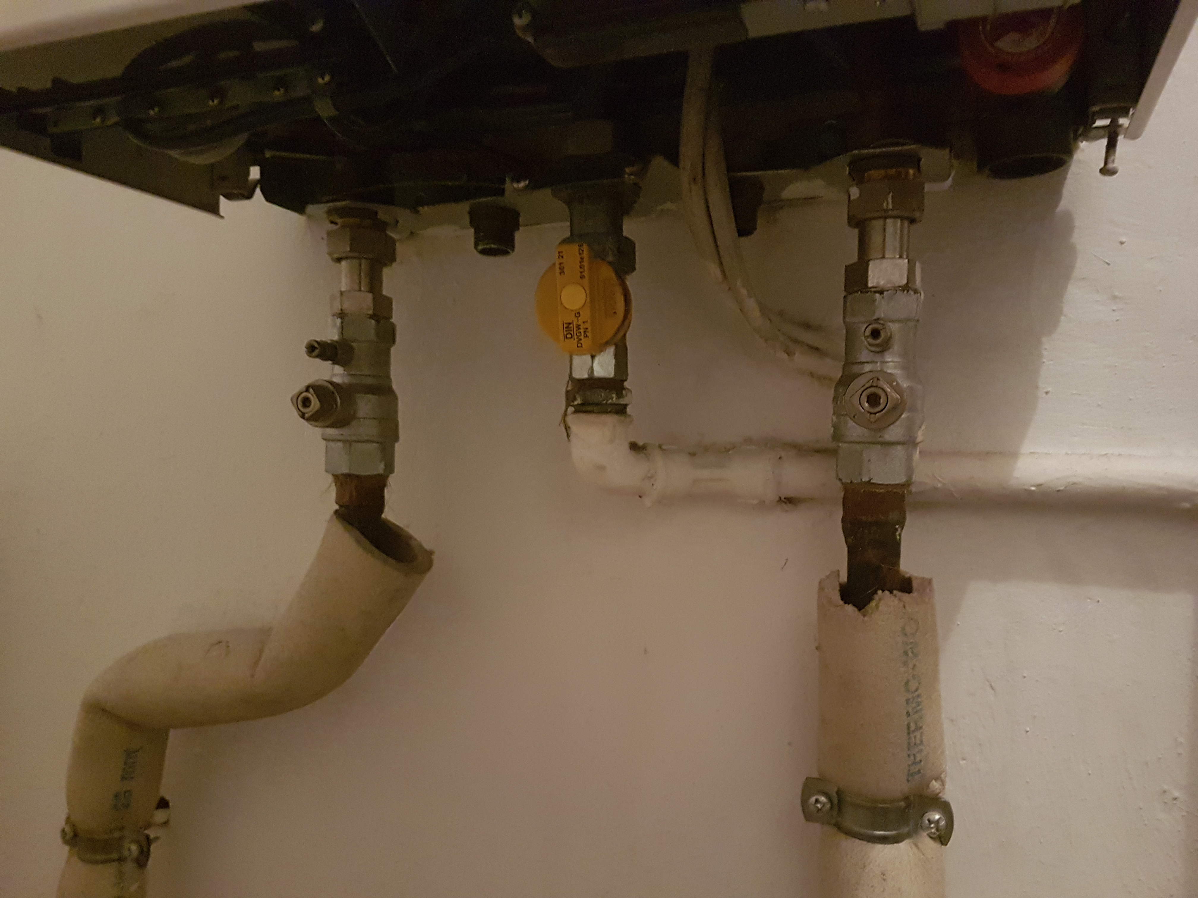

  • #26 18744697
    pixar7
    Hey, I have this screw sealed, the hex keys, the French can't cope. Is there any other way to release water?
    Thank you in advance for your help
    • JUNKERS ZW/ZS 20 KE – pressure below 1 bar, how to add water? IMG_20200607_155636.jpg (2.81 MB) You must be logged in to download this attachment.
  • #27 18744740
    serwisszulborski.pl
    Heating systems specialist
    Posts: 1846
    Help: 360
    Rate: 1448
    I do external release of the tap to the heater. There can be many ideas here, you just need a long hose and appropriate plumbing fittings.
