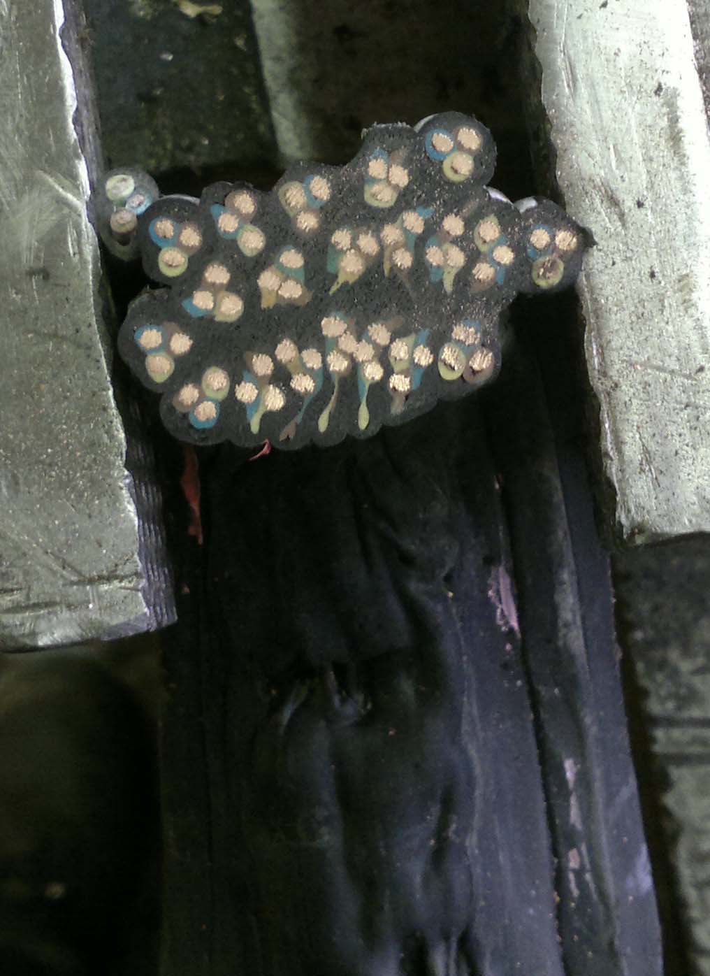

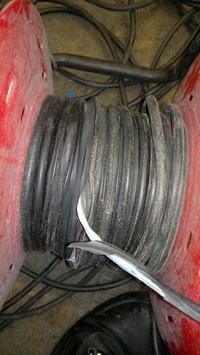

    15kVmaciej wrote:
    kkas12 wrote:
    During use, the extension cord should (read: must) be fully uncoiled.
    Best Extension Cord for Charging Car Battery: 50m Cable Recommendations & Affordable Options Best Extension Cord for Charging Car Battery: 50m Cable Recommendations & Affordable Options Best Extension Cord for Charging Car Battery: 50m Cable Recommendations & Affordable Options
    2kW vacuum cleaner was powered for about 3-4 hours
    It stuck to Maciek.
    These Angolans do such weak extenders ;-)
    kisses
    - GIFT-

    elpapiotr wrote:
    Such for example: The link will probably be ok?
    It may not be OK. It is also a 1.5 mm? wire. Manufacturers bend them evenly to make money.
    Even such they produce -
    Everything is good if the user knows what such an extension cord is suitable for and what can be powered with it, because if it is the mentioned vacuum cleaner, it will happen faster here than in the attached photos.
    Buddy, you write that you will let go of the mountain not to walk on it and the trees, do not take into account the conditions / damage this cable will be exposed to ??
