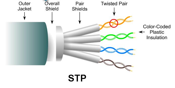

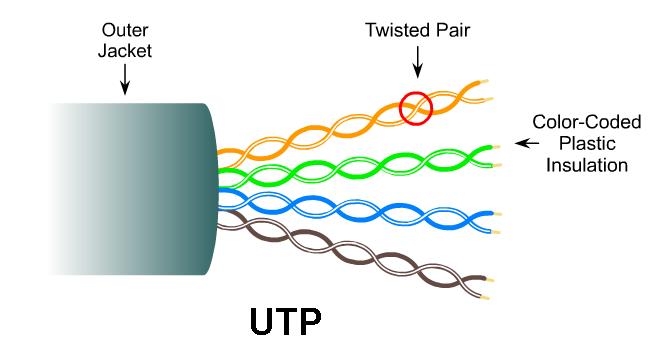

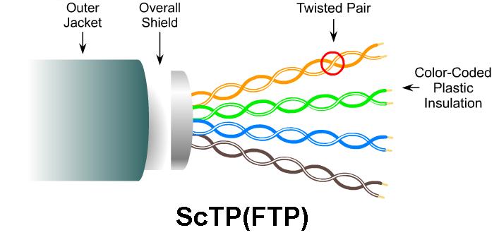

    I would like to add that if you do not ground any shielded cable, the effect will be opposite to the intended one. The screen will simply start to act as an antenna, catching all the noise in the environment and between the cables, and instead of leading them to the "ground" it will accumulate and amplify them, the effects are probably obvious ...
    And one more thing, a shielded cable is considered a bit slower than UTP, but it only matters at speeds of Gbps.
    To visualize the matter, I present a few photos in the attachment
    PS -> adamjur1; are you sure about this SSTP? It seems to me that STP also has a common screen, apart from those on pairs.
