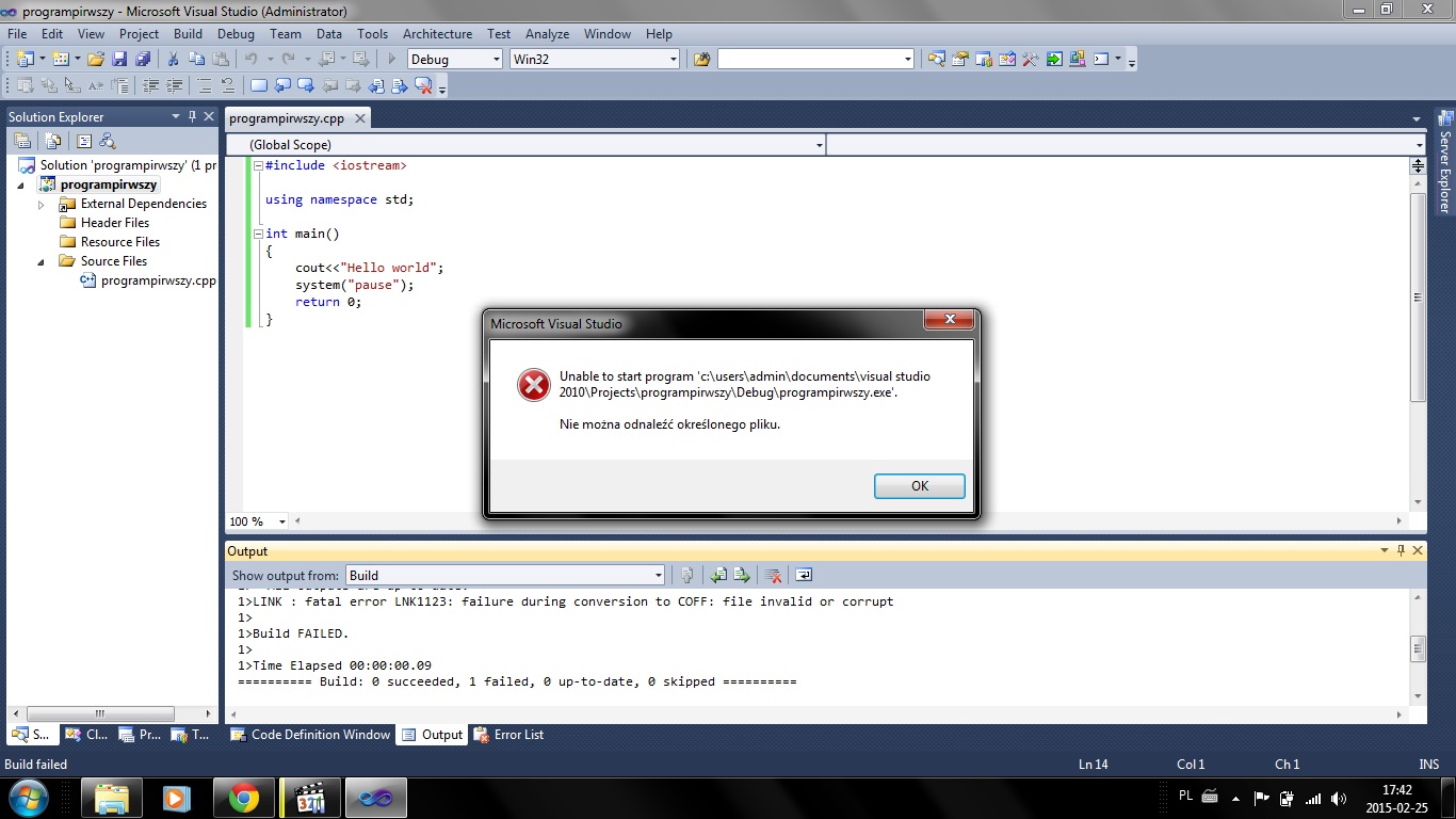

    Hello. I`m switching from Codeblocks to Visual Studio. (2010). The university allows me to download the Ultimate version from dreamspark. Everything installed and I get the following error:
    • Switching from Codeblocks to Visual Studio 2010 Ultimate: File Not Found Error gsdfgsdfg.jpg (228.22 KB) You must be logged in to download this attachment.

    After all, you have a bull at the bottom that the compilation failed, so the program is gone...
    Paste the compilation log.
  • #3 14477008
    Ins0maniaC
    Posts: 353
    Rate: 10
    Meh, zapomniałem to dodać
    "Error 1 error LNK1123: failure during conversion to COFF: file invalid or corrupt c:\Users\Admin\documents\visual studio 2010\Projects\programpirwszy\programpirwszy\LINK

    The error indicates that you have added a library that is not compatible with VS.
  • #6 14481279
    Ins0maniaC
    Posts: 353
    Rate: 10
    I didn`t change anything in the installation settings. I didn`t add anything. Try reinstalling?

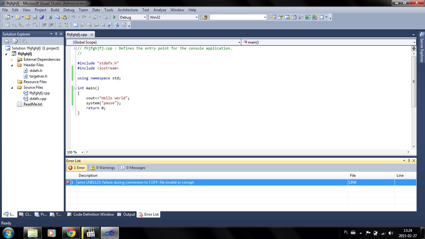

  • #7 14481362
    LED5W
    Posts: 2302
    Help: 264
    Rate: 162
    Do you have VS2010 SP1?

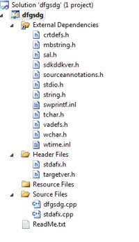

    Edit: Now I noticed that the author has these folders empty. Have you created a new win32 console application project? This is what it looks like for me:

  • #12 14482920
    Ins0maniaC
    Posts: 353
    Rate: 10
    This time I didn`t make an empty project and the folders are actually full, but the error still appears.

  • #13 14483143
    -psiak-
    Level 32  
    Posts: 1185
    Help: 259
    Rate: 107
    To me it looks like an argument with another compiler, e.g. Borland or GCC.
    I recommend uninstalling Visual and reinstalling it.

  • #15 14483582
    Ins0maniaC
    Posts: 353
    Rate: 10
    This is the Ultimate version. No Service Pack 1.
    @Edit:
    As my colleague LED5W advised, installing Service Pack 1 helped.
