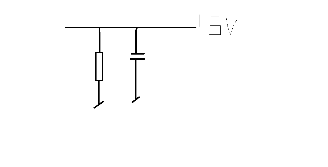

    My question may seem trivial and quite "stupid", but I am not able to find the answer to it on the internet.
    Well, the point is that I know that ground is where the potential is zero, so the voltage is zero volts. I read that physically it can be any element that conducts electricity but has a zero potential, such as a bulb screw or a car body.
    During the electronics classes in college, we connected the masses with each other with a resistance-free cable. On one page I found a definition that the mass is simply a simplification of the diagram to make it more readable and that we simply connect all the grounds together and connect the whole to ground. It is understandable.
    So I do not understand how it relates to this car body. According to this definition, the mass may even be, say, a piece of lamina. How does it relate to connecting the masses with a resistance-free cable?
    Another question is about the zero potential. I quickly drew a fragment of the circuit. If, as in class, we connect the ground wires with each other, will there still be a zero potential at this point?
    Thank you and best regards.

    The ground GND is the reference point for the remainder of the electrical circuit.
    The use of this term improves the readability of electrical diagrams.
    These points are physically connected to each other.
    Car body serves as the common ground return conductor
    Of course, you connected in your thoughts, because in practice resistance-free cables do not exist ;)
    The car body is just a piece of the plate (a bit larger) to which all the points that we consider to be connected to ground are connected - negative battery pole, negative alternator terminal, negative starter pole, one transport of most bulbs, etc.

    The most important thing is mass contractual reference point, we assume assuming that it has 0V because it's a very convenient assumption :)
    Therefore, the mass does not have to be connected to any sheet metal, neither to the ground, nor to the negative of the power source, if you assume that the plus of the battery is the mass, it will be your choice, some old cars had that, in systems with germanium transistors, plus was usually taken as a mass .
    In the car or in the plane, the mass is not connected to the ground, and if the plane is hit by lightning, even if it is hundreds of kV in relation to the ground, the mass in the plane is still 0V, because that's what we assumed.
    Earthing is used for safety reasons, often the ground is connected to the protective conductor of the network.
    The car body in the car acts as a return conductor and, by the way, is a 0V reference potential.
    In the diagrams, the mass symbol improves readability - it eliminates all the lines with which the masses would have to be connected, and the power supply is also marked with the appropriate symbol (circle, old or thin horizontal line with a description) for the same reason.
