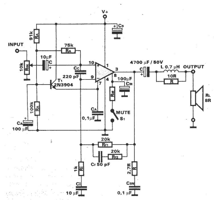

    I will cut in on the topic.
    in this diagram, where there are dashes next to the capacitors is the mass, should all the dashes on the board be connected with each other when we assemble such a system, and do we connect it to any of the poles? or maybe we just leave it connected with each other? :D
    What is the difference between “mass”, ground and minus in electronics?
