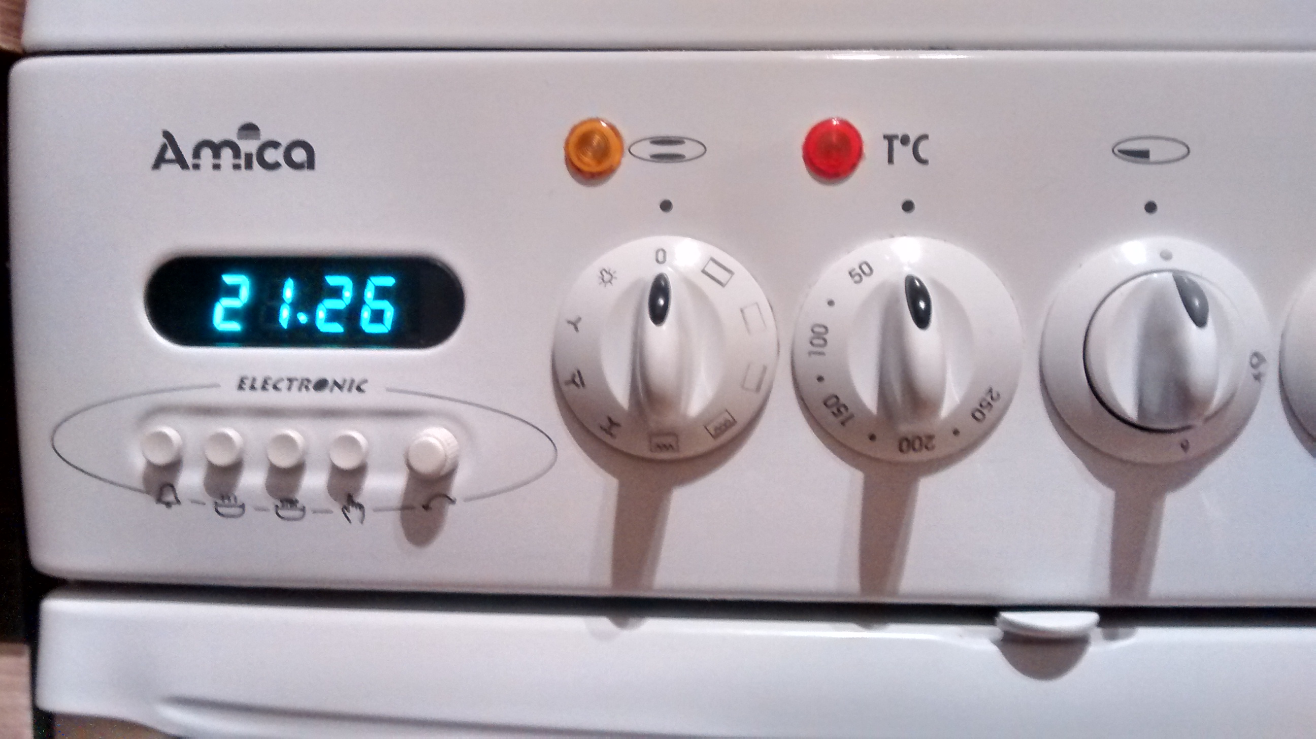

    Hello!
    I moved into an apartment with a free-standing Amica Supernova cooker and I have a problem with it, unfortunately I don`t know the exact model.
    The stove burners work, the display works, but the oven does not work. From what I found out, you need to "program" the oven somehow. I looked for the user manual on the Internet, but I can`t find it anywhere. Can you also tell me how to set the clock and what these buttons under the display are for (I am attaching a photo - in the photos the oven is disconnected from the electricity).
    I`m new to these blocks, so I`m asking you for help :)

    You press the two buttons on the left at the same time and turn the knob. After setting the appropriate time on the clock, you release the pressure on the buttons.

    I agree, the clock looks broken, call someone knowledgeable to skip the clock and then start the oven.

    The clock is working. The first two photos were taken when the oven was unplugged. I just plugged it in, held down the first two buttons and set the clock. The oven also started working (the bulb is on and the convection mode is running). I understand that by setting the time the oven will now also work properly?
    (The set clock is attached)
    If someone could tell me what these particular buttons are for, that would be great!
    Thanks so much for your help!
