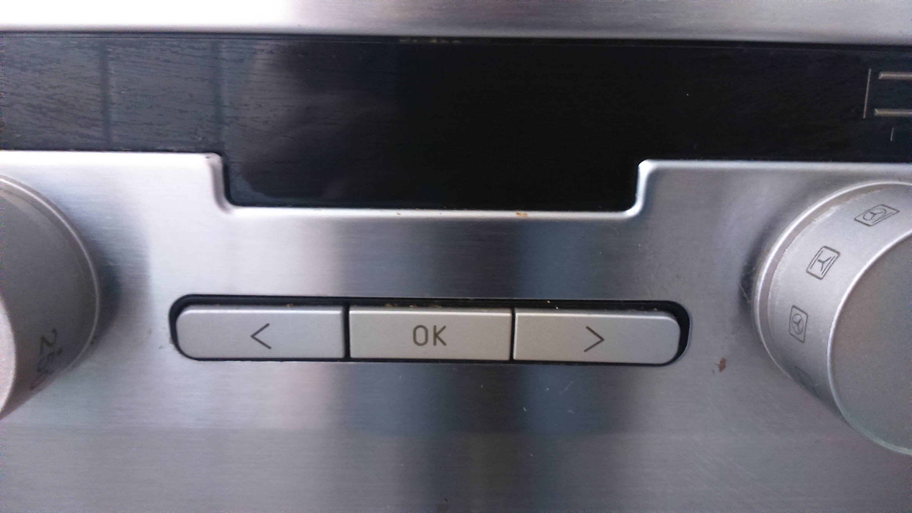

    I have a problem with setting the clock in the gas stove, the oven without it does not work. The "0.00" is always displayed and the bell is flashing. I am asking for any help and thank you in advance.

    Which oven model?
    What is written in the user manual for setting the clock?

    Try the two extreme buttons at the same time until the dot starts to flash and then you set the clock with the arrows.

    Unfortunately, it does not give anything

    I have a stove from the same series and this way is correct. When you press two arrows at the same time, nothing happens? It should be a "peak" and the dot should begin to pulsate. If it does not give anything, it may be damaged.

    I would rather bet a "stuck" (constant press) of one of the buttons. Even if I do not know how to take care of the stove, it will always get dirty in knobs and buttons.
