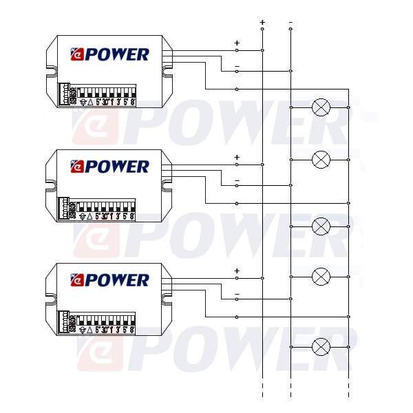

    The question is probably simple for the people who do it, but I have no idea about it. As in the topic, I would like to illuminate the stairs with a led strip with connected motion sensors. When climbing or descending stairs at night they have sensors to activate the led strip. I don't know anything about electricity, so in order not to hurt myself, I want both detectors and LEDs to work on 12v from the same power supply. I have a power supply of 60 W and it is socket outlet As far as I know how to connect a cable with a led strip, I have no idea how to connect motion detectors to this so that everything works and does not hurt myself :) Everything should look like in the drawing I added.
    I will be grateful for your help and possible drawing on the project how the detector cables are to be connected and what the cables are to be.
    greetings

    This motion sensor probably has an output with a relay (you did not provide the model ...: ')), with this relay you "cut" the red wire from the power supply, the relay in NO mode, when the sensor is triggered by the relay, the red wire will be connected again and the leds will light up . Both sensors (their relays) must be connected in parallel, then no matter which one works, the LEDs will light up.

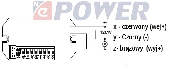

    NE-PIR12-M sensor model from the auction site :)
    The sensor has 3 inputs
    red +
    black-
    brown +
    In the led cable I have + and - so I have to connect red and black, and what about brown?

  • #4 15850143
    perch
    Posts: 861
    Help: 119
    Rate: 260
    From power supply to sensor: black to black, red to red. From power supply to leds: black to black. From sensor to leds: brown to red.
  • #5 15850178
    edziolekos
    Then it should be like this? what about red to ledow ?: Connecting LED Strip Lights with Motion Sensors for Staircase Illumination: 12v, 60W Power Supply
    Regards
  • #6 15851278
    janek1815
    Posts: 4513
    Help: 372
    Rate: 1062
    You connect the brown sensors, as a colleague wrote above, to the red LED terminals.

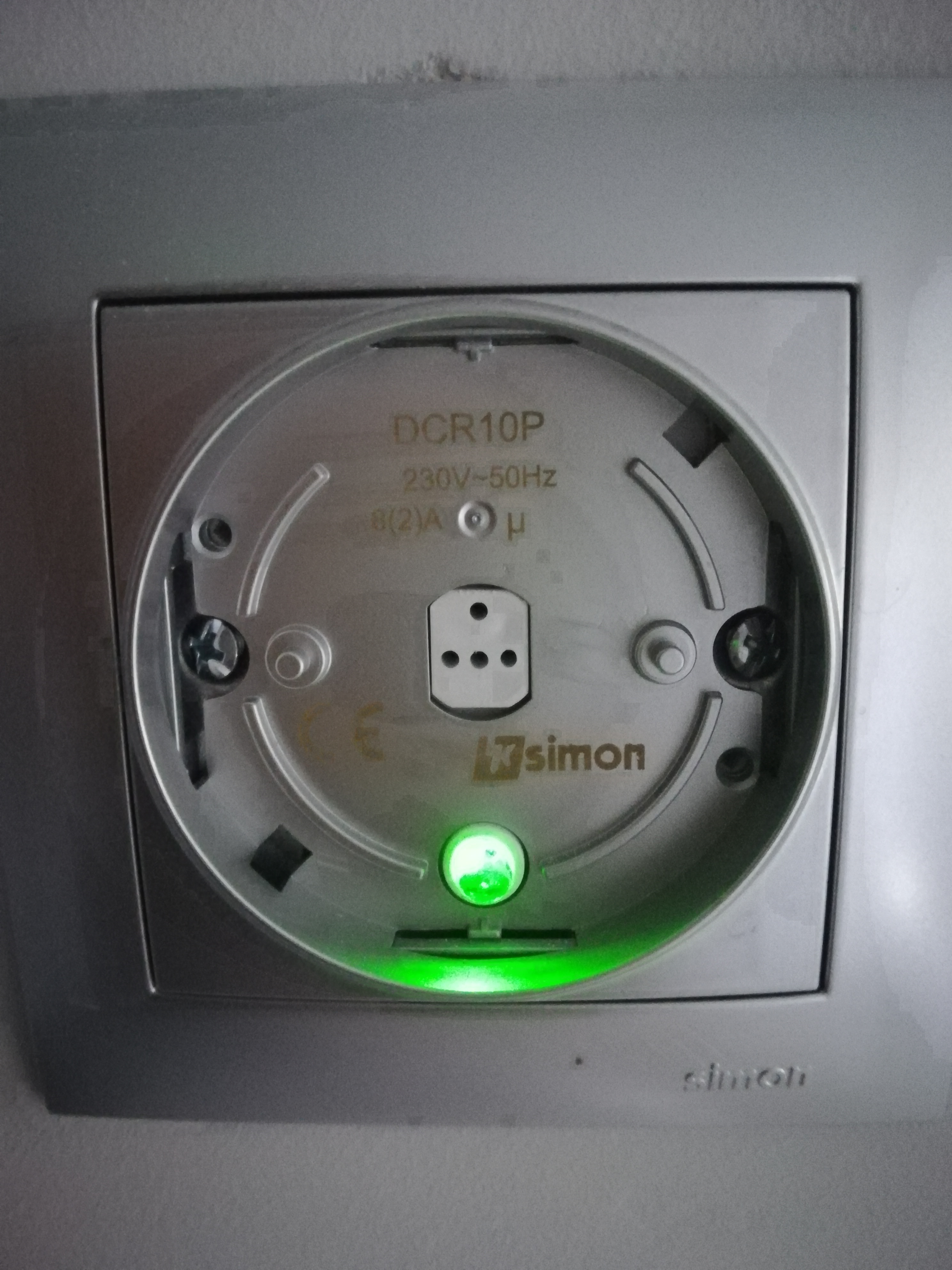

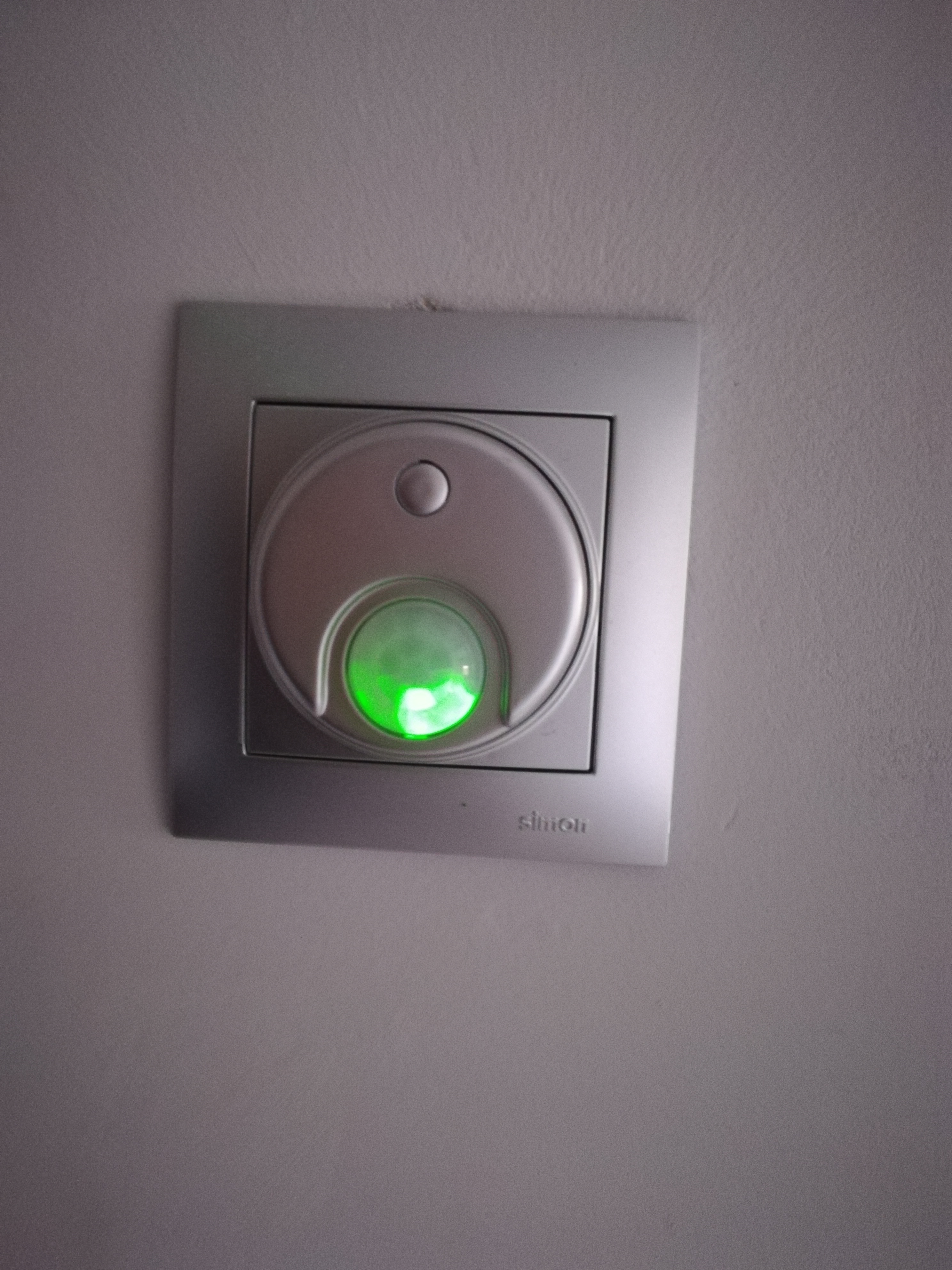

  • #15 16783917
    jarek2402
    Posts: 10
    I am interested in the system with the detector from Simon because this is what I will have a socket system and a switch. The photo shows the watch I have at work. And, unfortunately, it is done there so that the 2nd detector, after splashing, the movements extend the time of blessing. As a last resort, I was thinking about the bell switch and time stamps.

  • #16 16783925
    krzysiek7
    Moderator of Electricians group
    Posts: 4880
    Help: 678
    Rate: 1953
    Did you read the topic I gave? Attempts to eliminate this extra glow will do nothing. The effect will be, for example: the light will turn off when someone is in the middle of the stairs, which you probably wouldn't want.
    This way, the most correct, two bell switches and a time watch.
